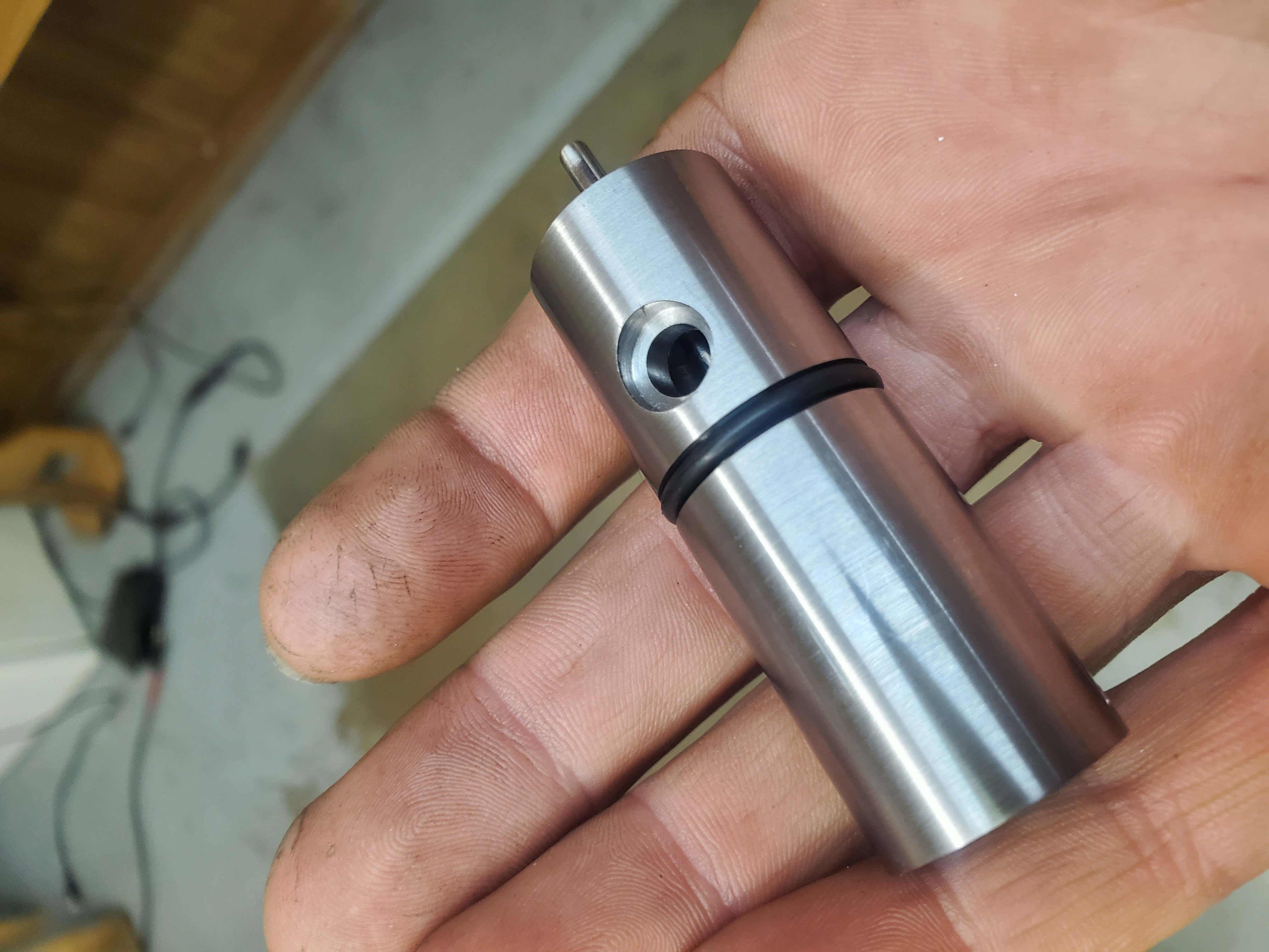

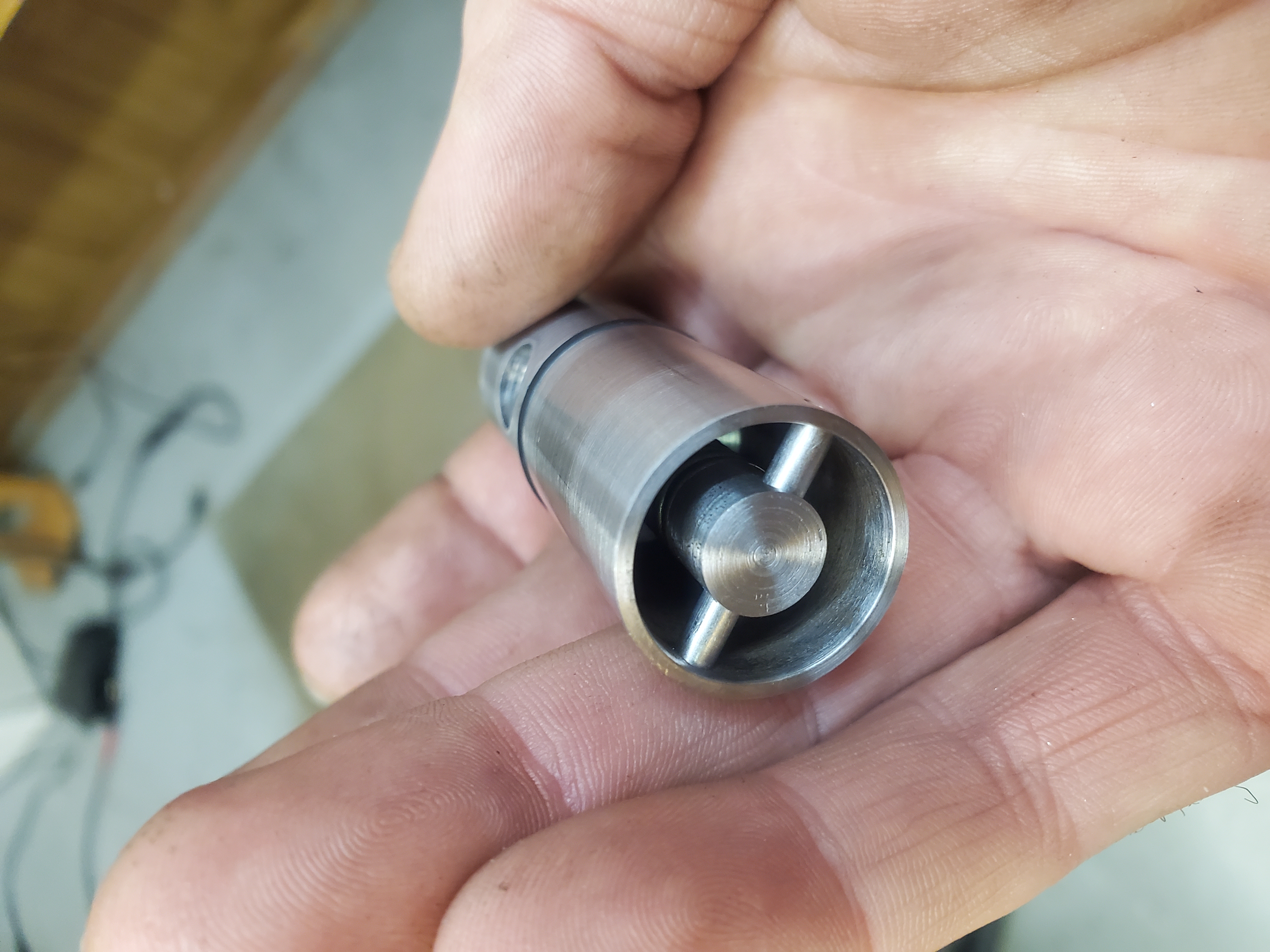

I'll be using the valve thats giving me so much power in my 50 caliber so this thing should really scoot. It's also a design that's easier to manufacture and therefore more affordable. I have a bunch of green mountain 308 blanks in 41t0 so I'll be turning those down for use.

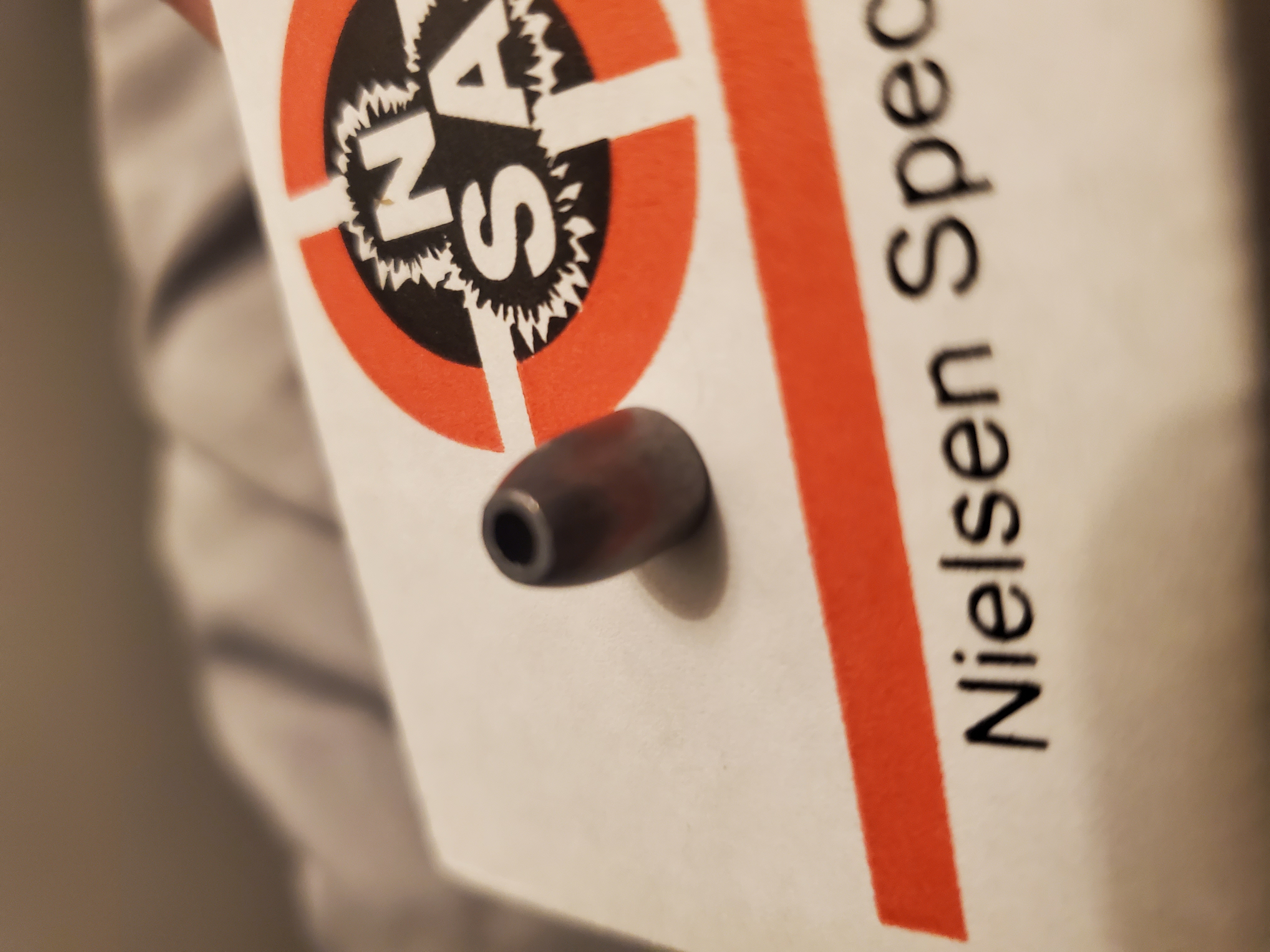

Here's some 65 grain 308 airgun slugs for reference. I'm hoping for 1800fps and the mags hold 8 rounds. A fill should be able to give at least 8 regulated shots.

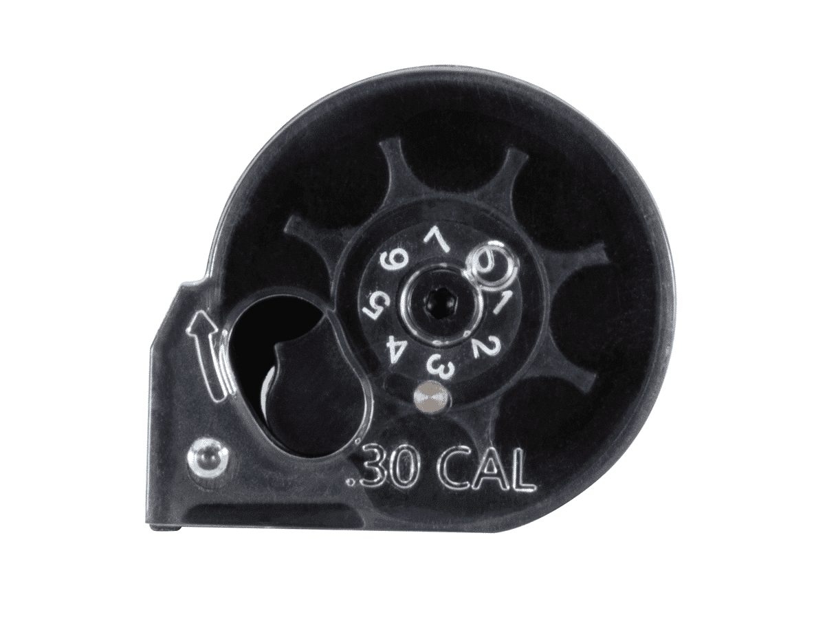

Well, the magazines are kind of strange and of the rotary type but they're not bulky and they work fantastic.

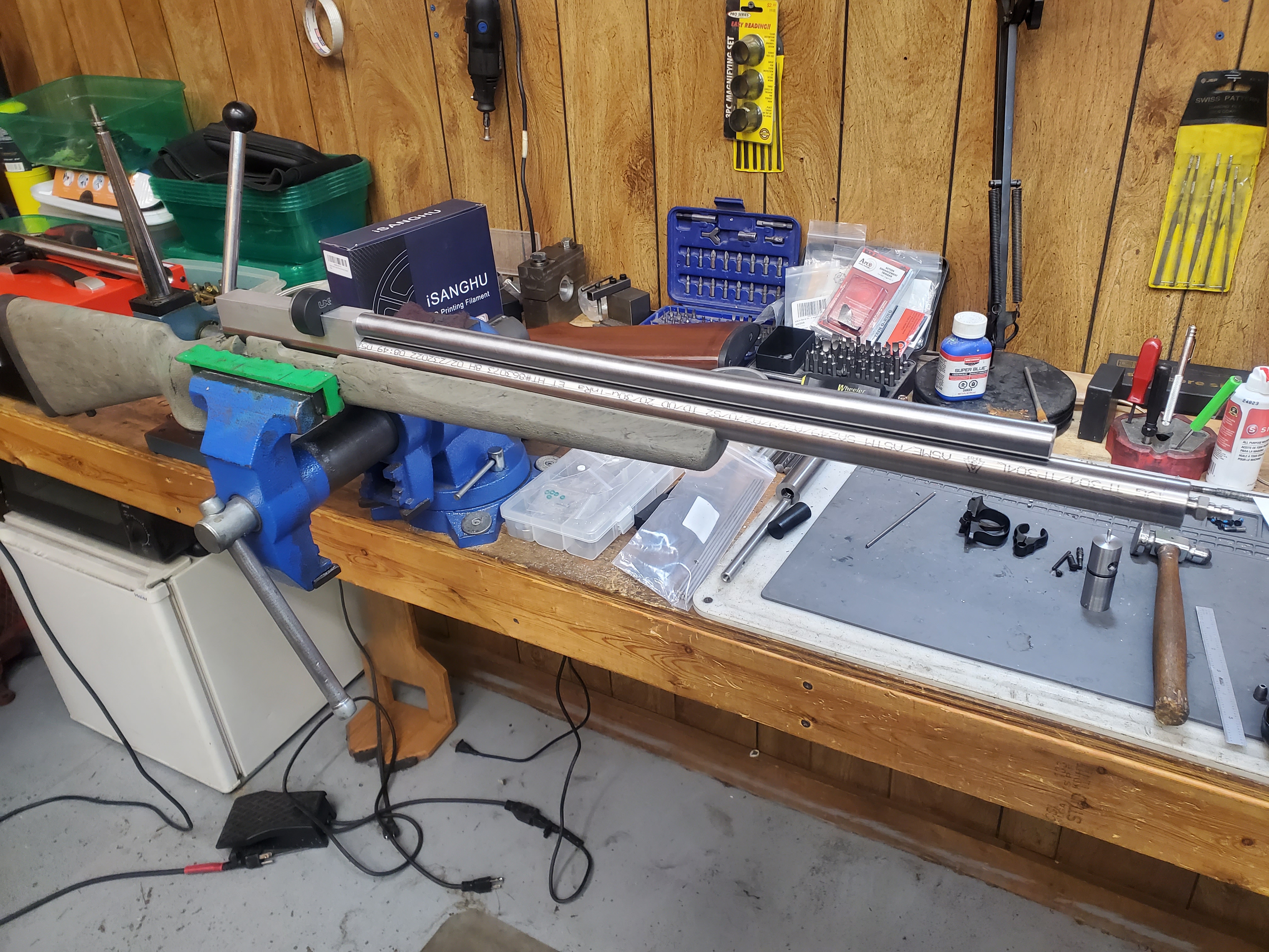

Got a bit further. Just a mock up.

Dude, you are one hell of a machinist
That project is looking good
In a couple weeks we probably see that thing make bug holes at 200.

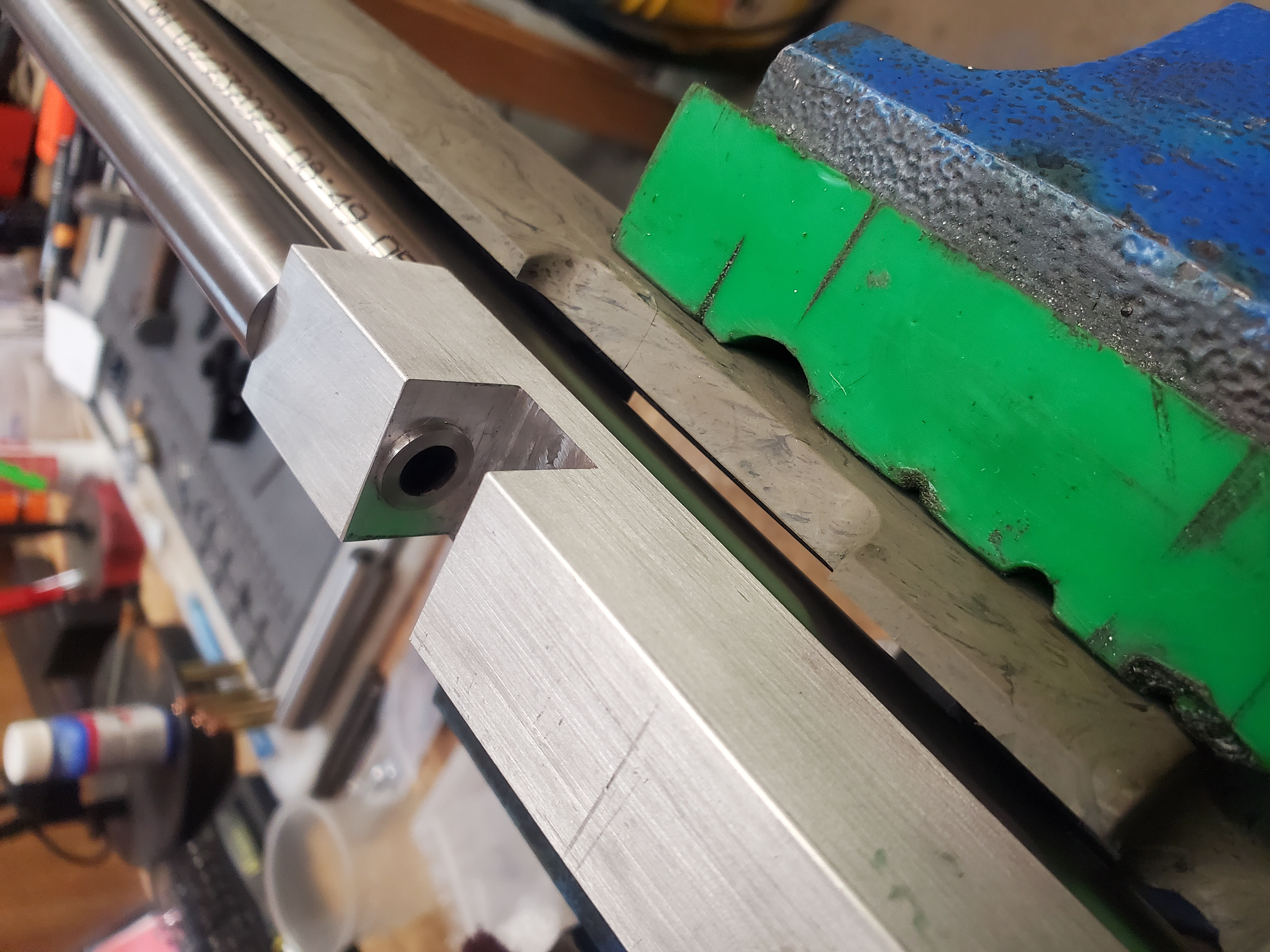

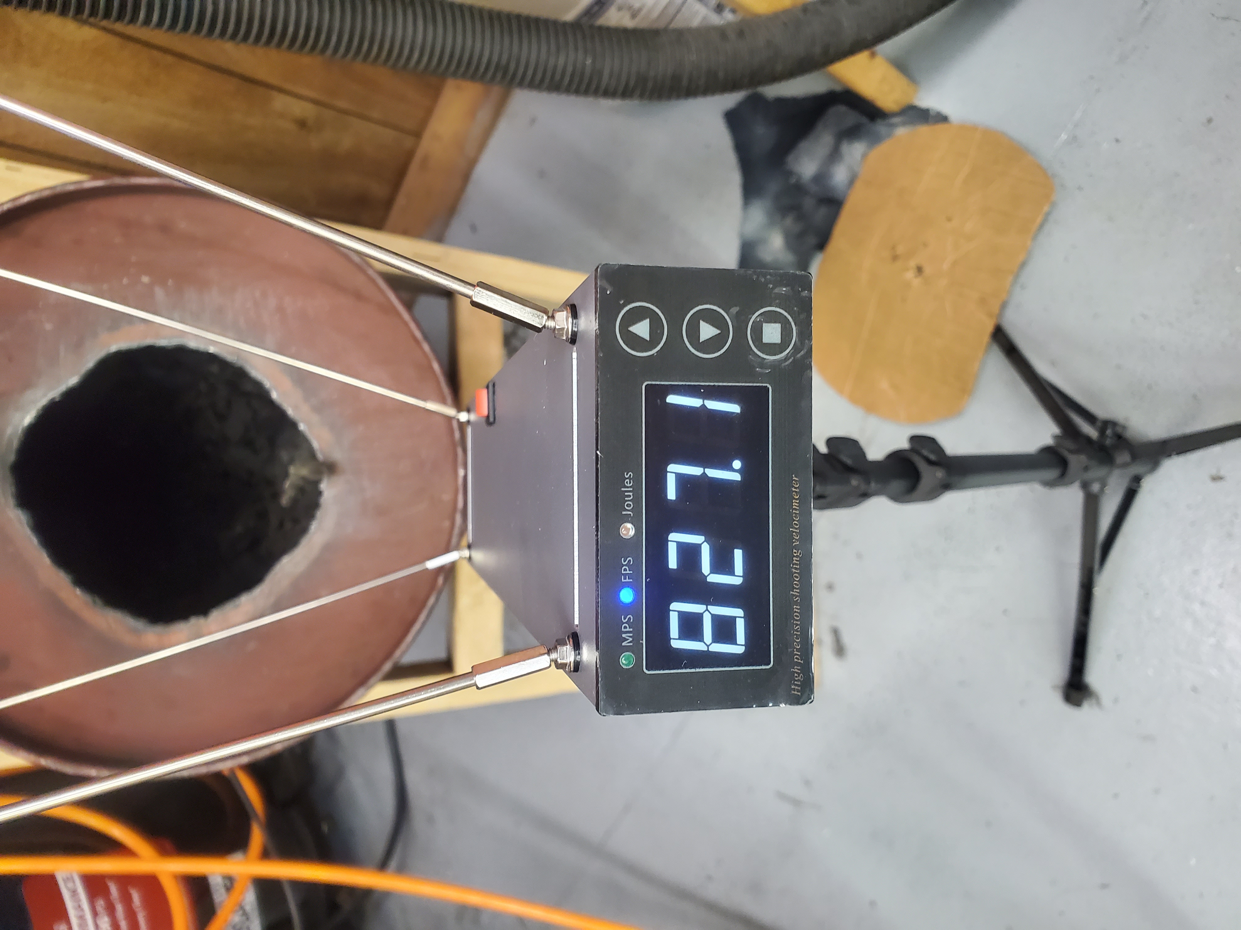

Well, I've yet to pin the valve in place which is what keeps it from blowing out the back and into my body, preferably not my skull but the hardened steel transfer port is pretty strong and it sits between the pressure tube, upper reciever and valve so I figured I could take it up to 1500psi for testing. It works and works good! I got 739fps at that fill and it's rated for up to 4500psi so it'll scoot when I'm done. Don't mind my clamp for "testing purposes."

I also did some testing today. For one, it held pressure overnight with no leaks and I tried it at 1700psi. It will also be tunable.
