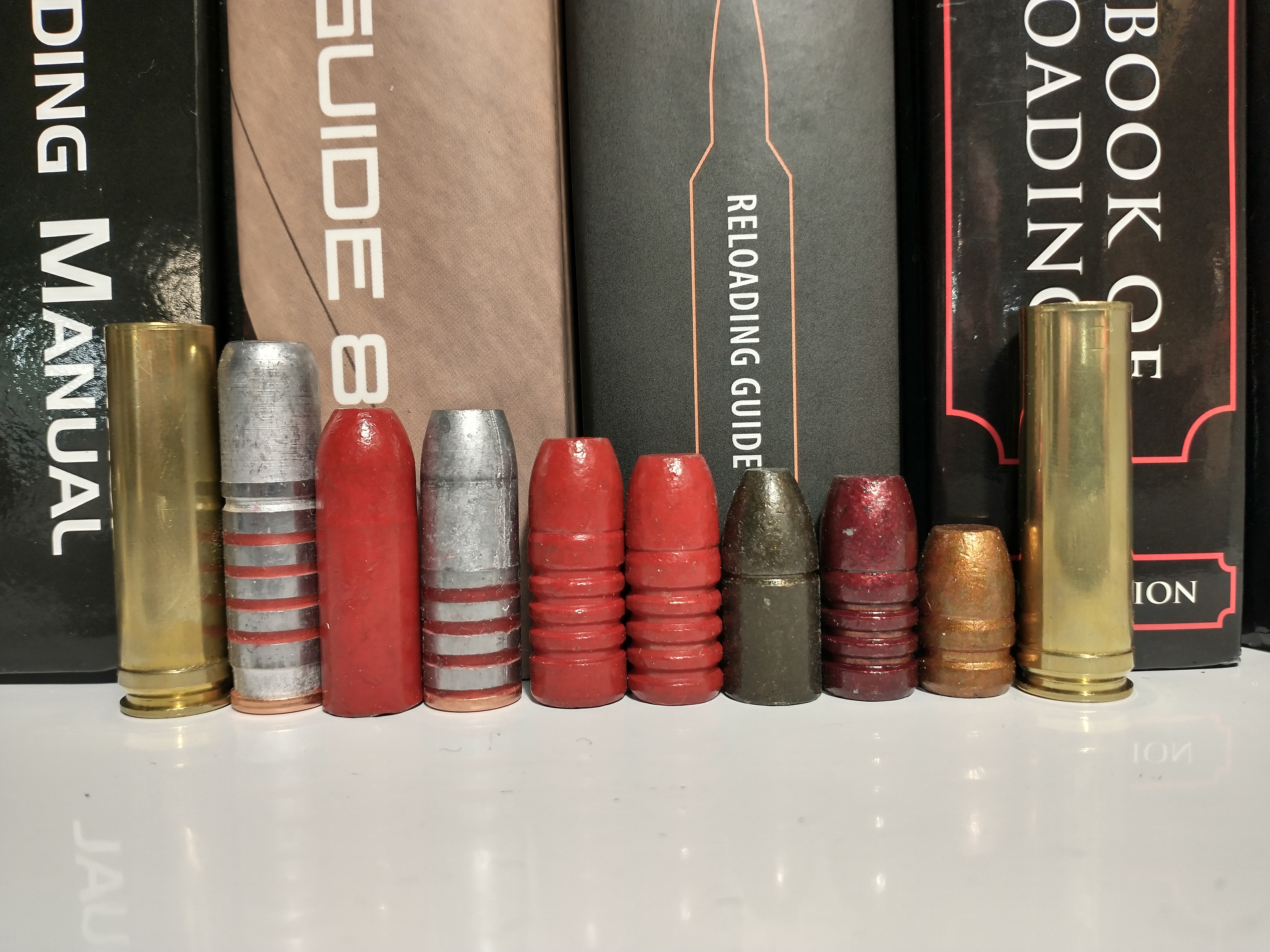

This is my collection of .458/.459 lead bullet options. Powder coated bullets seem to leave less fouling in the barrel, except the ACME 576gr likes to leave a ring of lead in my chamber (.458x1.8 and .458 WM). After about three rounds I have to go in with a brush to snag the ring. That bullet is the only one that seems to do it so far, but I have not tried either of the Matt's Bullets options yet. With the exception of the ACME 576 I have only shot the lead bullets in my .458x1.8. I do at some point plan to shoot them in the big boy .458 though.
Left to right is:
Matt's Bullets 730gr GC WFN .458"
ACME 576gr PC 458 SOCOM .459"
Matt's Bullets 575gr GC LFN .459"
ACME 500gr PC 45-70 RNFP .458"
ACME 450gr PC 45-70 RNFP .458"
MBC 410gr PC RNFP #1 SOCOM .459"
MBC 405gr PC RNFP #1 BUFFALO .459"
MBC 300gr. PC RNFP #2BUFFALO .459"
.458x1.8 (1.790" case length) on both ends.
