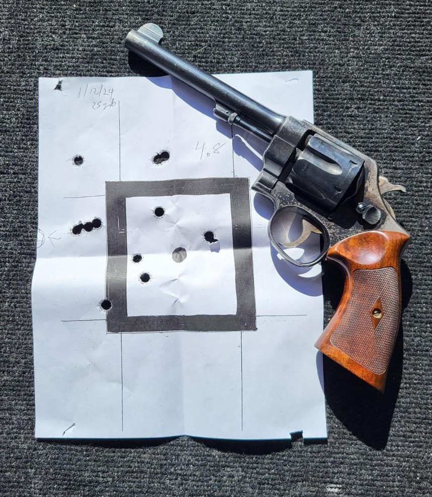

Work on the old Smith .44 Special continues. Got the load figured out at 4,8 grains of Titegroup behind my custom 255 grain bullet for right on about 710 fps:
2nd H.E. 29.1.jpeg (308.12 KiB) Viewed 1710 times
As before, point of aim was the 6:00 edge of the square at 25 yards. We're hitting a bit high there, but pretty much dropping to be about level with the sight at 50 yards. For trying to figure out a bench hold on invisible WWI sight while doing the progressive lens bifocal lean, I'm pretty happy.

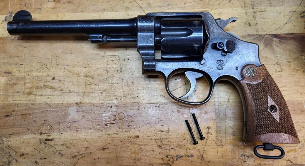

The reproduction lanyard loop landed a couple weeks ago. That needed a little shortening of the topmost surface to get the groove for the pin to align correctly. The "mostly authentic" grips arrived from Altamont yesterday:
2nd H.E. 25.1.jpeg (126.58 KiB) Viewed 1710 times
The correct grips for this 1921 gun would not have had the medallions, but Altamont says their blanks come with the medallion holes pre-drilled. No biggie - I'm OK with it looking like one of the WWI British service .455's.
Altamont was thoughtful enough to include three different lengths of screws for their grips. Nice of 'em. . .

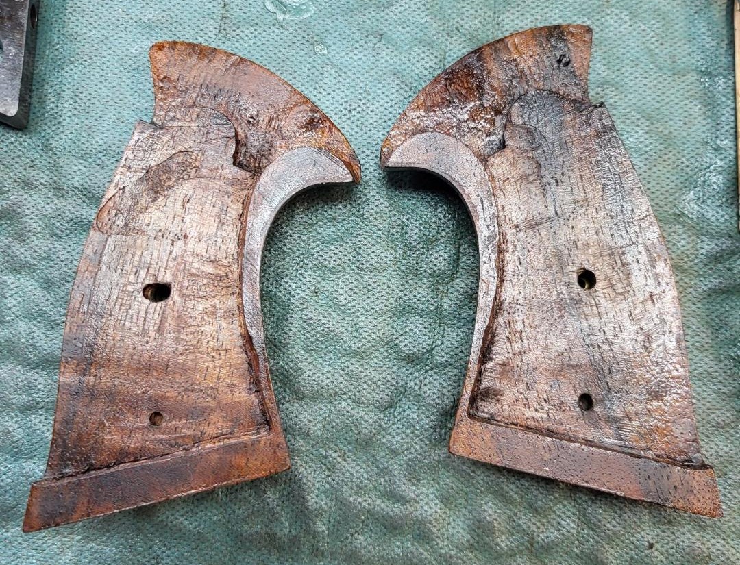

What are the plans for the other grips ?
And did you post a picture of the inside of then ?

Second page of the Dr. Jones thread, but here ya go:
2nd H.E. 19.1.jpeg (423.08 KiB) Viewed 1625 times
Probably a hand-done job, and a VERY nice one, but no identifying marks I could make out.
Mothballed for the moment, but as I seem to have a thing for old N-frames, they'll stay in reserve in case I latch on to a classic that some barbarian decided to put a set of rubber grips on.
