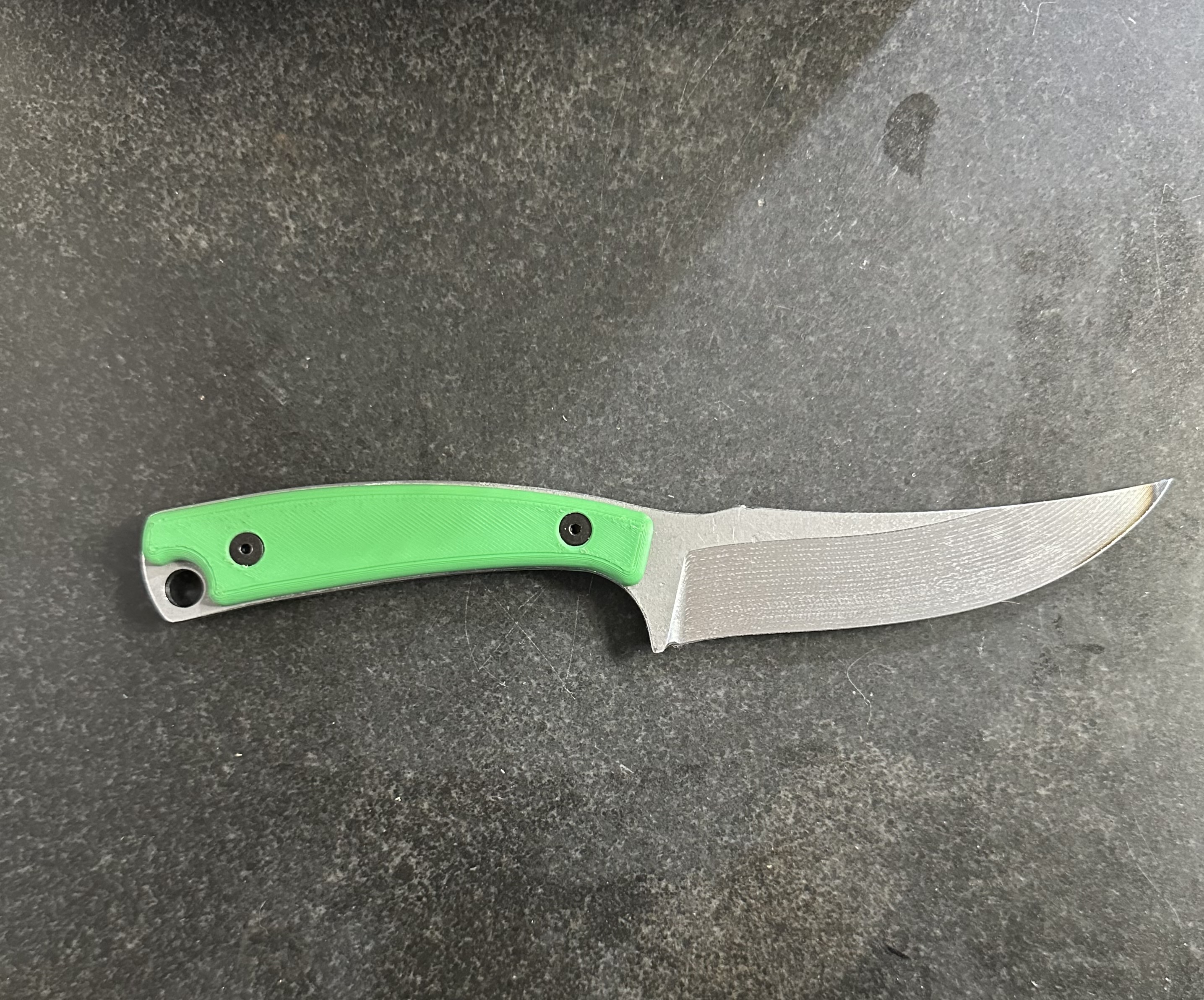

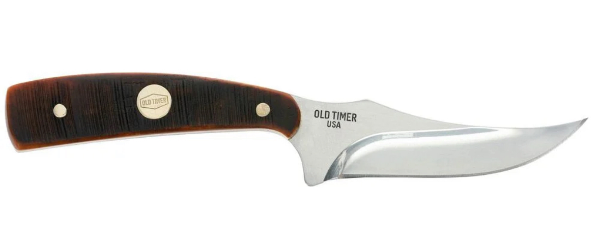

Posts: 4254
The US made Sharpfinger (bottom) and the China made.
The grind line on the USA model….what the French, toast?
Anyway, mine looks better I believe. Not sure if I should call it the Sharpmiddlefinger or the Stinkyfinger.

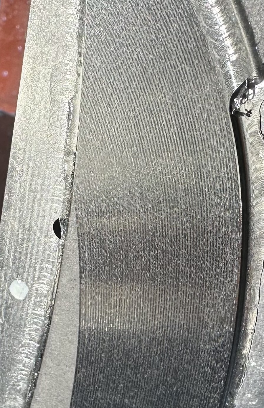

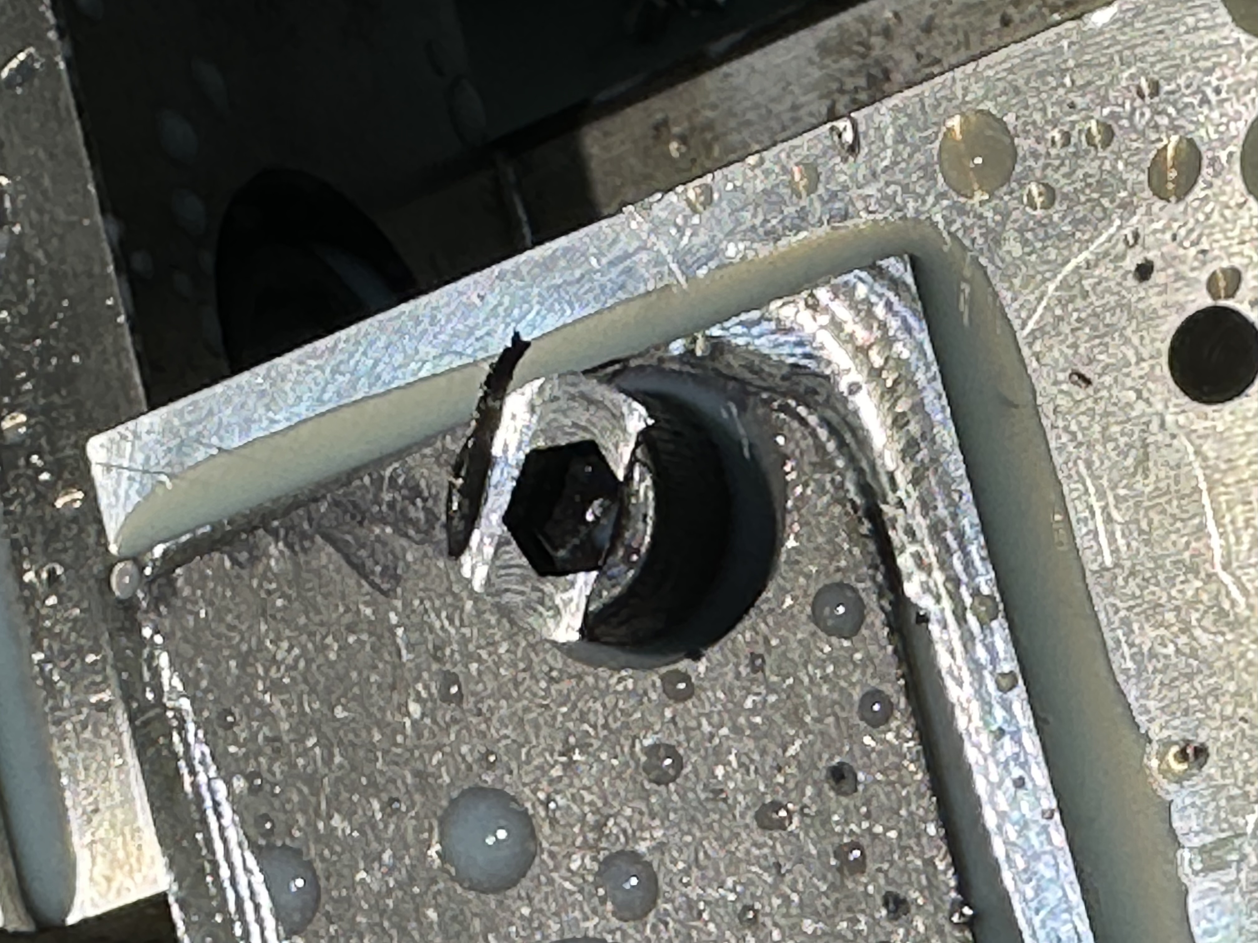

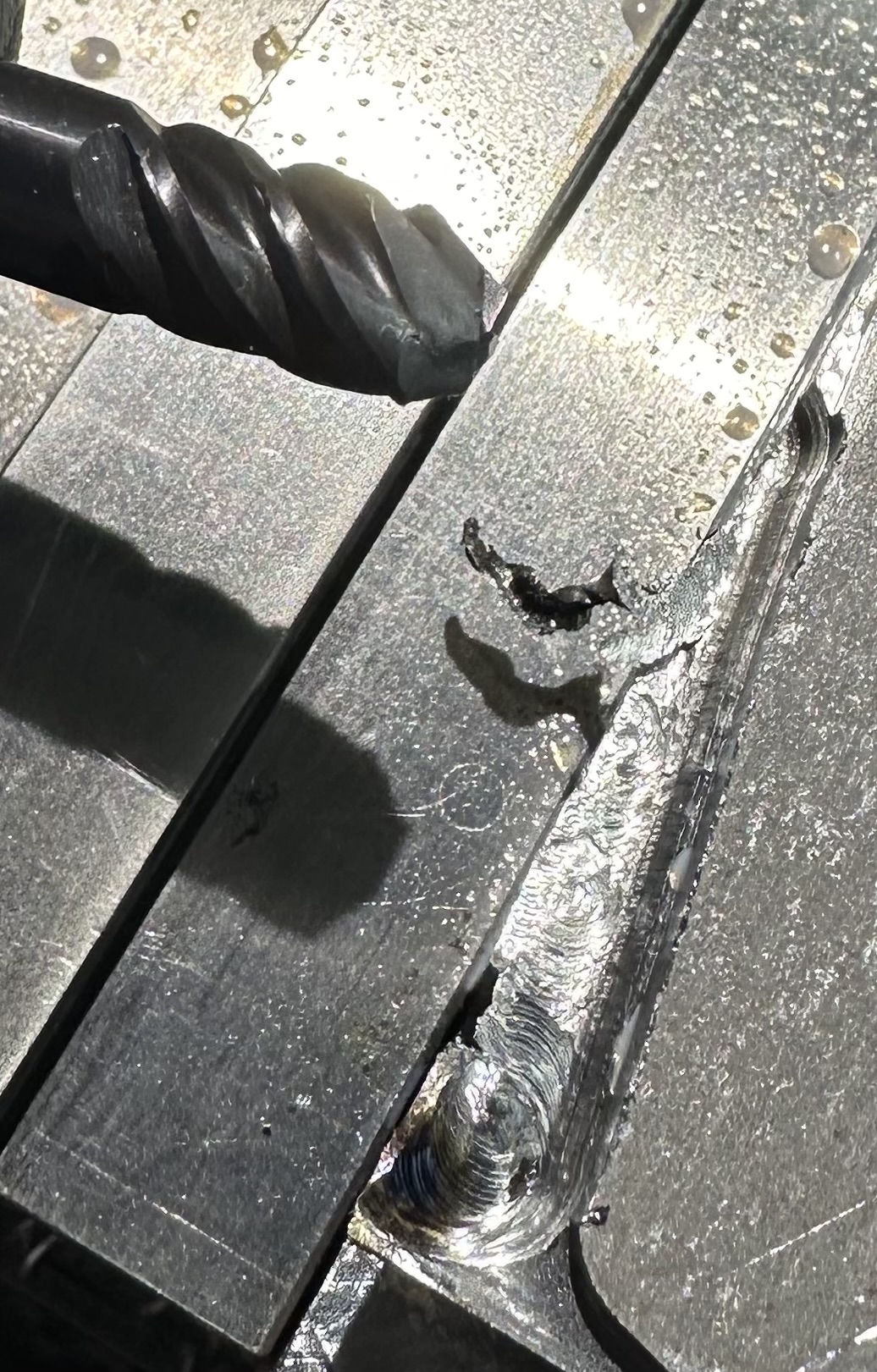

I’ve kind of enjoyed making them. My machining advisor sent me a new program. I’m doing everything step by step, proving each operation as I go.
As the cutter moves across the fixture, it’s *supposed to raise the tool ABOVE the screws holding the blank down.
I caught that on the first program. Missed it on this one.
But the machine didn’t miss the hardened cap screws. Plowed right though them. 🤣

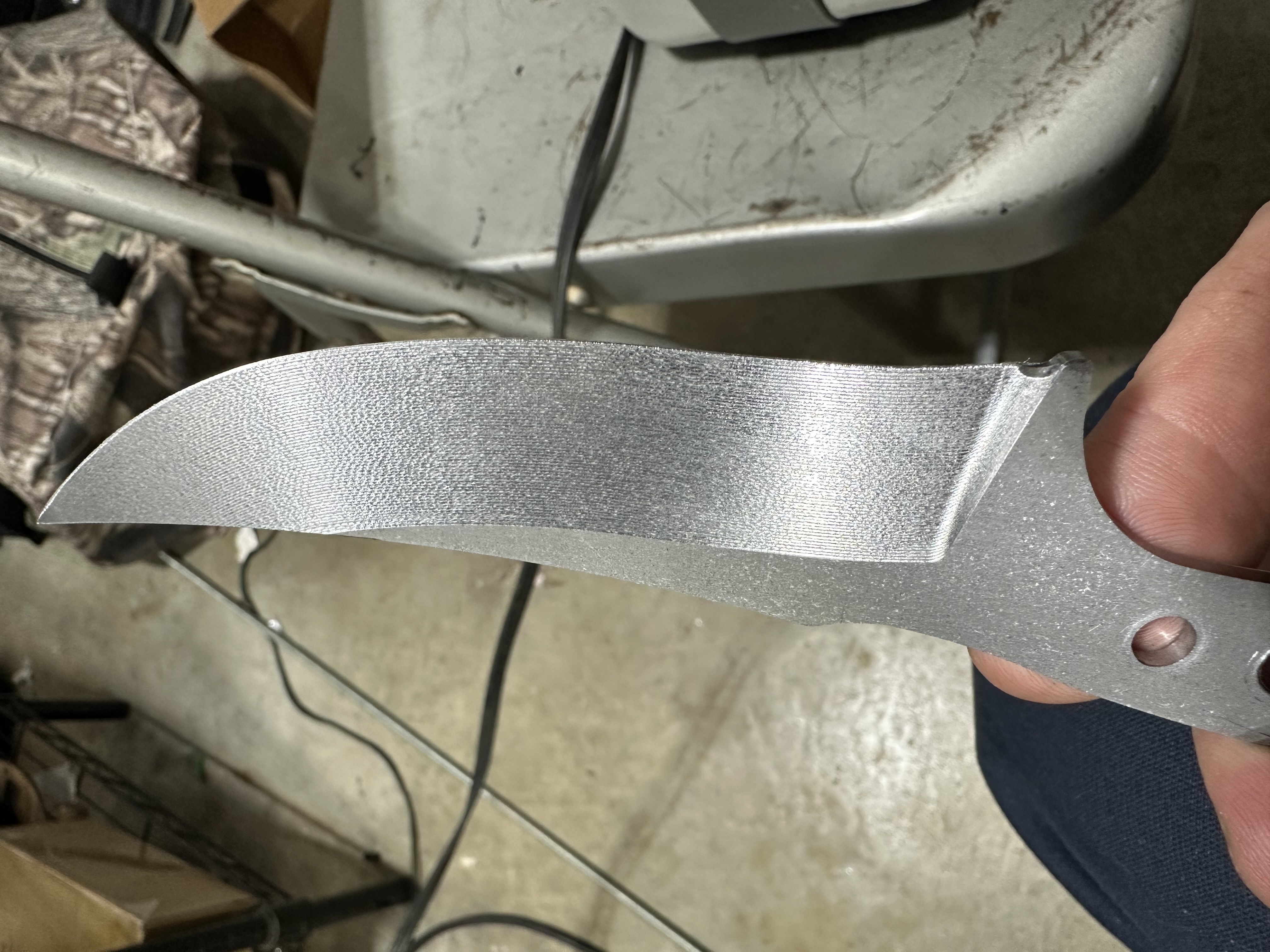

Posts: 4254
Cost of business.
Only takes about .0069 seconds to burn a 20 dollar bill.
Posts: 4254
Grinding bevels is for SUCKERS.

Posts: 4254
Number two practice blade. Have a few tweaks still. But overall it’s working. One more practice tomorrow. Hopefully one more.
