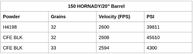

He was asked about the cartridge drawing and said it's being drawn up, so no drawing at the time of request. He was asked how he came up with the reamed chambers or the special reamer and no response. A friend came to his defense and began singing the praises of his new cartridge but when asked just to take a cellphone photo of the cartridge and post it -- no response.
I guess you can see why there's a lot of skepticism.

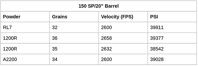

He claims to be achieving these near 308 NATO velocities with regular powders.
According to the inventor the pressure numbers are from a man using a strain guage. At another special lab (I forget the name), using piezoelectric measurements the pressures where closer to but not exceeding 52,000 psi.
Even if what he says is true, it seems a bit disingenuous to post the lower strain guage numbers instead of the piezoelectric ones.

Dunno. . .
Making the most apples to apples comparison I can find on Hodgdon's site - CFE Black pushing a 150 grain Hornady out of a 20" barrel 7.62x39 - probably an SKS - they're listing a max charge of 24.5 grains at 2,156 fps and 43,200 CUP (which doesn't really translate to PSI)
On the PSI scale however, we have a lot of .223/5.56 loads operating in the 53,000 to 55,000 psi. Given the overall smaller bore volume of .22 vs. .30 cal, what this guy is claiming for his new wunder-cartridge will be well within the limits of Eugene Stoner's basic mechanism. If I recall correctly, 5.56 pressure in the AR has dropped to something like 20,000 psi at the gas port. Expanding even that same initial 50K chamber pressure into the larger .30 cal bore should make for a gentler cycling gun - given same port size and location.
Still highly dubious of the speeds, but the guy may not be completely full of poop. His video surely doesn't hold up to the Court of the Well-Informed.
