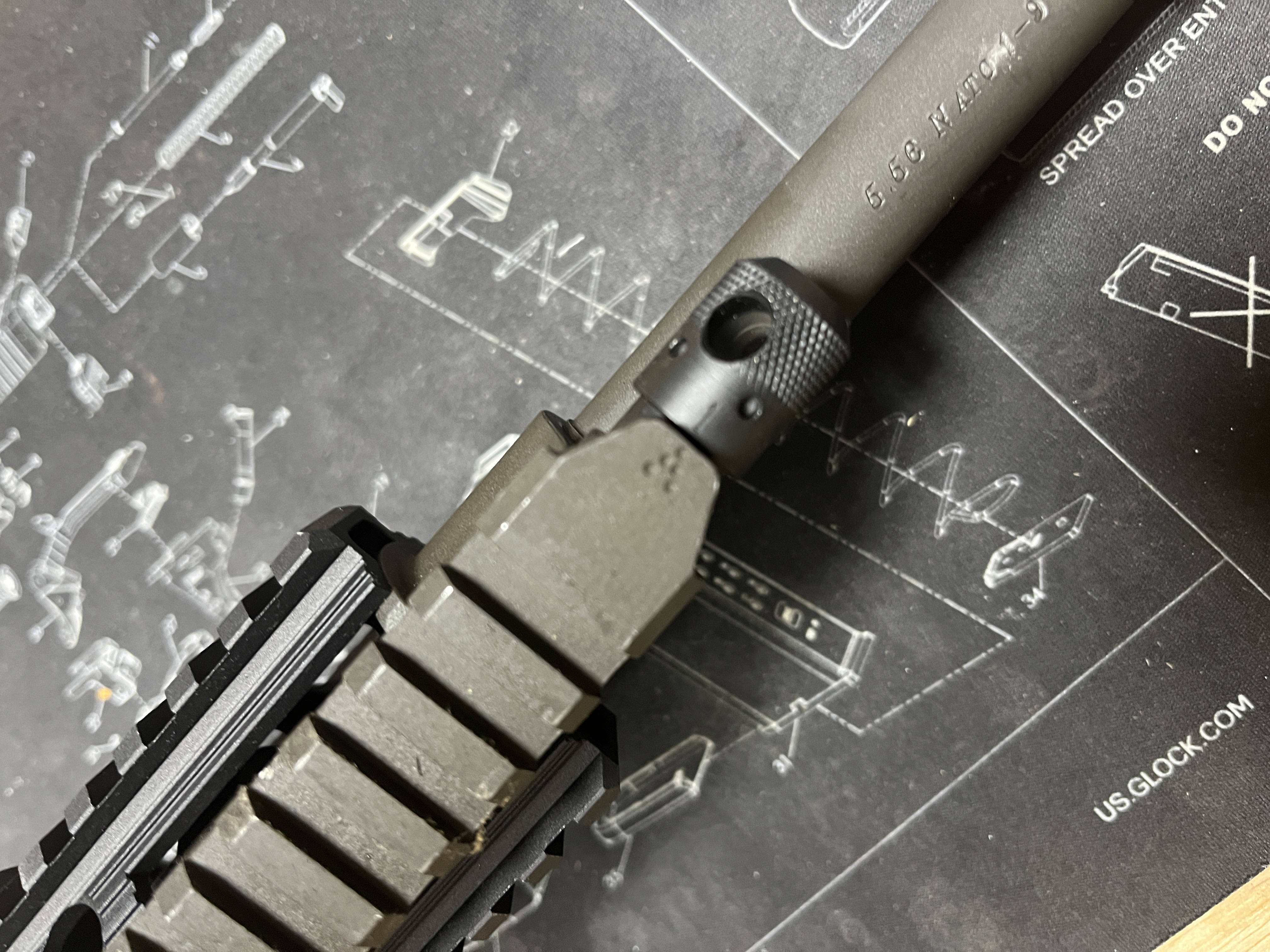

I have an Aero, and a couple Seekins.
Aero is much better. It has detents. It comes with a really long allen wrench, you can adjust it without removing the handguard. If you remember to bring the wrench.
