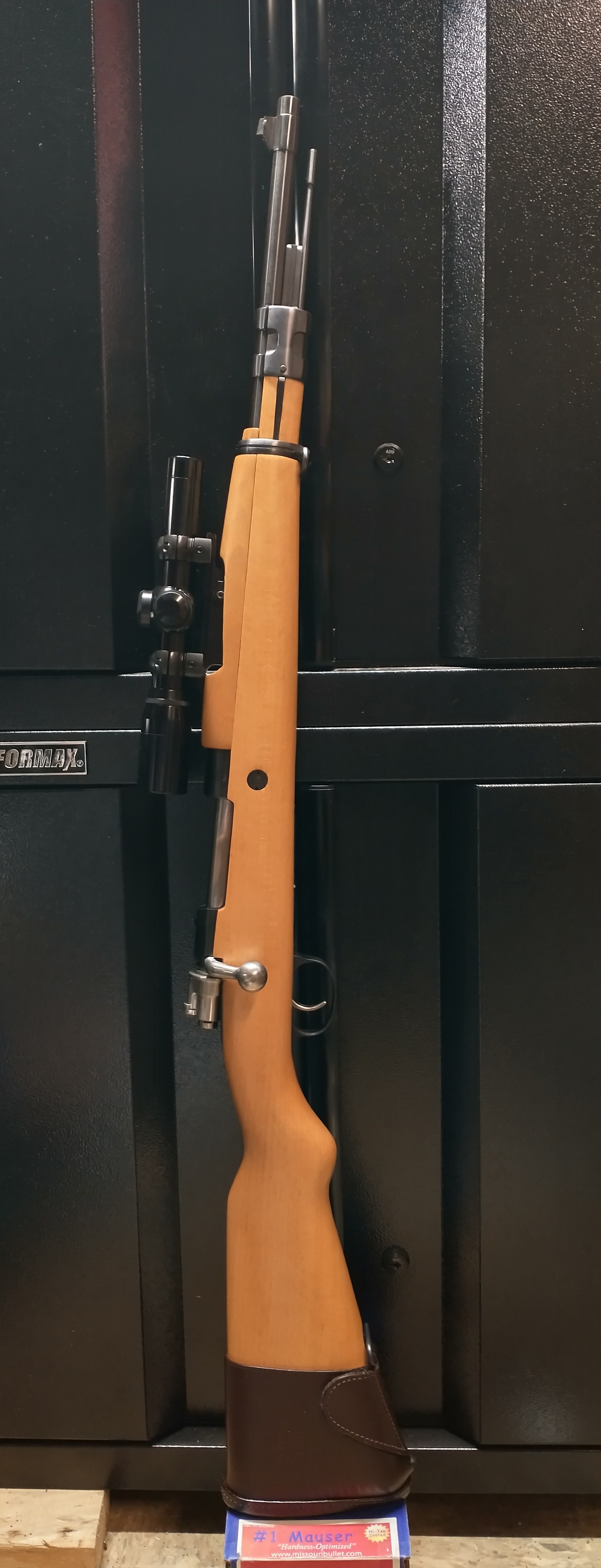

This is the rifle. I'm not concerned about overall build as it's manufactured by Zastava. They were made for Mitchel's Mausers long after they would have possibly been used for the supposed purpose they were built for. It needs a Timney trigger something fierce.

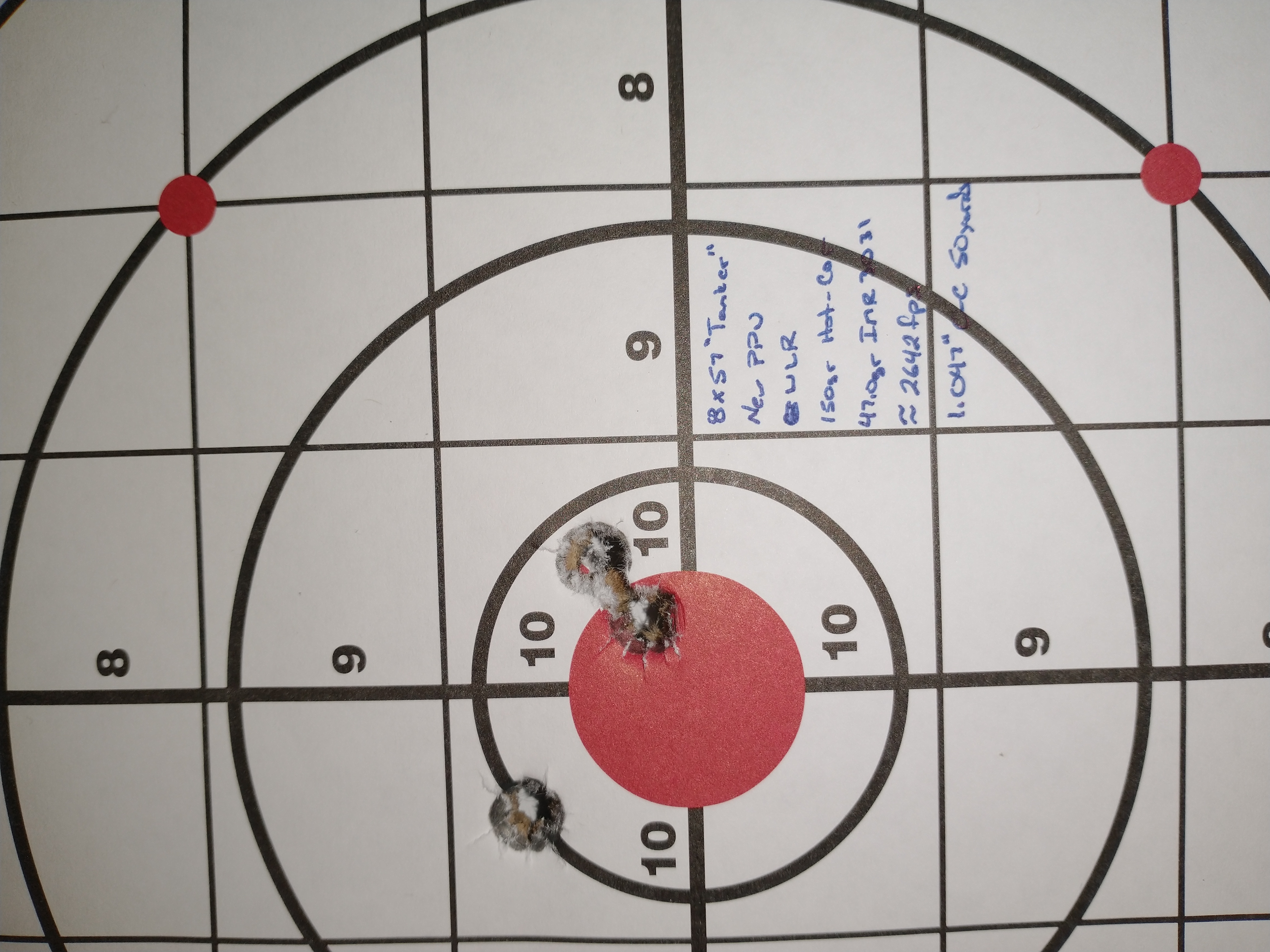

Well, I tried one cast load today and velocity was higher than expected and at 50 yards it had about an 8" spread. Back to the drawing board on this one. The scope set up takes some getting used to and the trigger is horrendous. I will be looking to put a Timney in it. On a side note it didn't do too bad with the first jacketed load I tried in it. It's only 50 yards, but that's about all the further I want to be shooting at a 1" dot with a 2x forward mounted scope.
