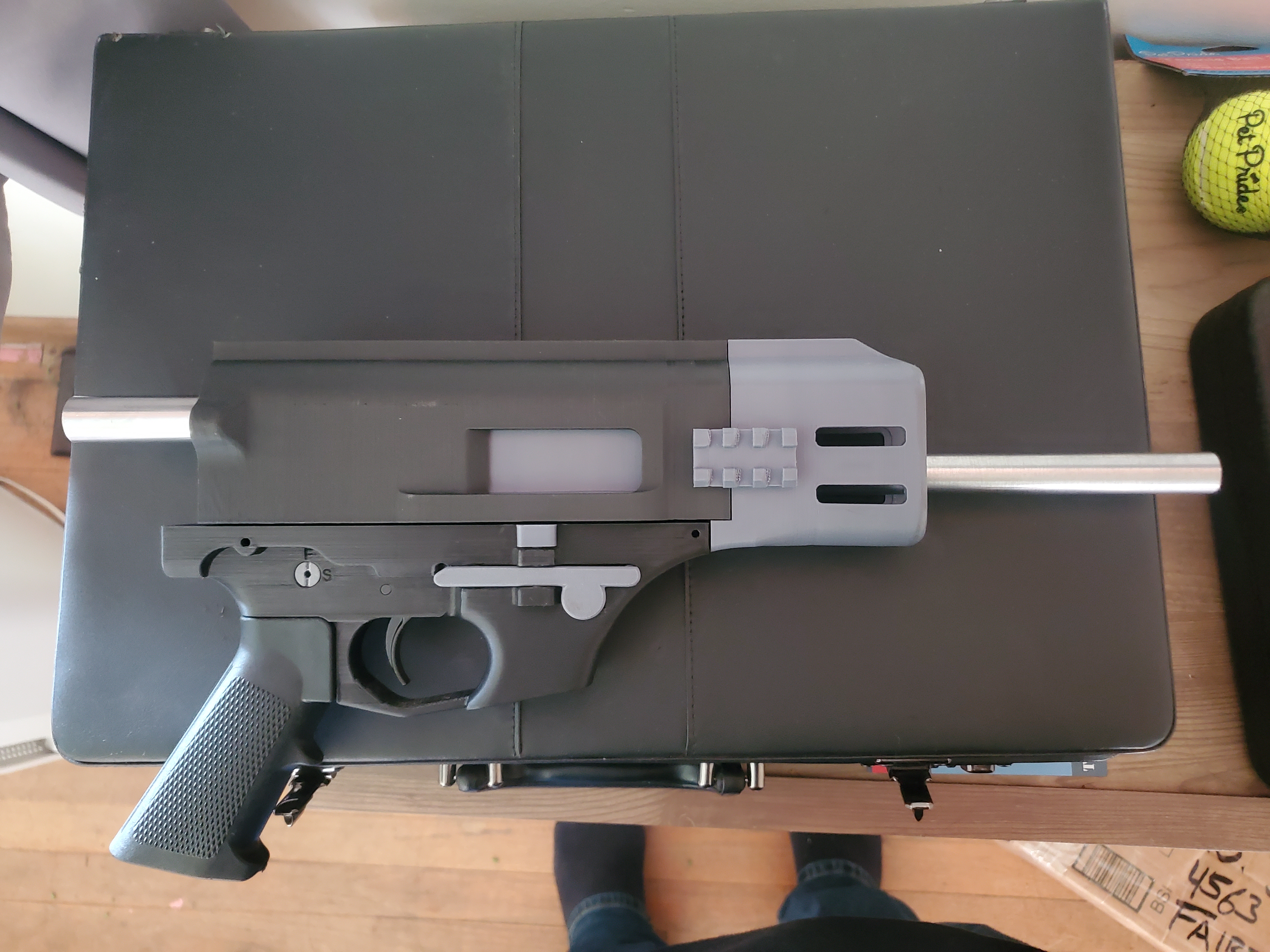

On a different note. 3D printers are fantastic. I give you the FGC-9. Stands for Fugg Gun Control. Whole thing is 3D printable with few metal parts that can be epoxied into place. People rifle their own barrels with reverse electrolysis and a 3D printed mandrel but I'll just turn down a rifled blank. Takes glock mags too.

Posts: 1803
Nice JSD, need a range report when you are done please.
Posts: 1339
Chiro1989 wrote: ↑Sat Apr 27, 2024 3:41 pm Nice JSD, need a range report when you are done please.
Will do. Theres a good amount of videos on YouTube of the same build but it's mostly just people doing mag dumps to show how well it works. I'll also post the rest of the parts as I print them and get it together.

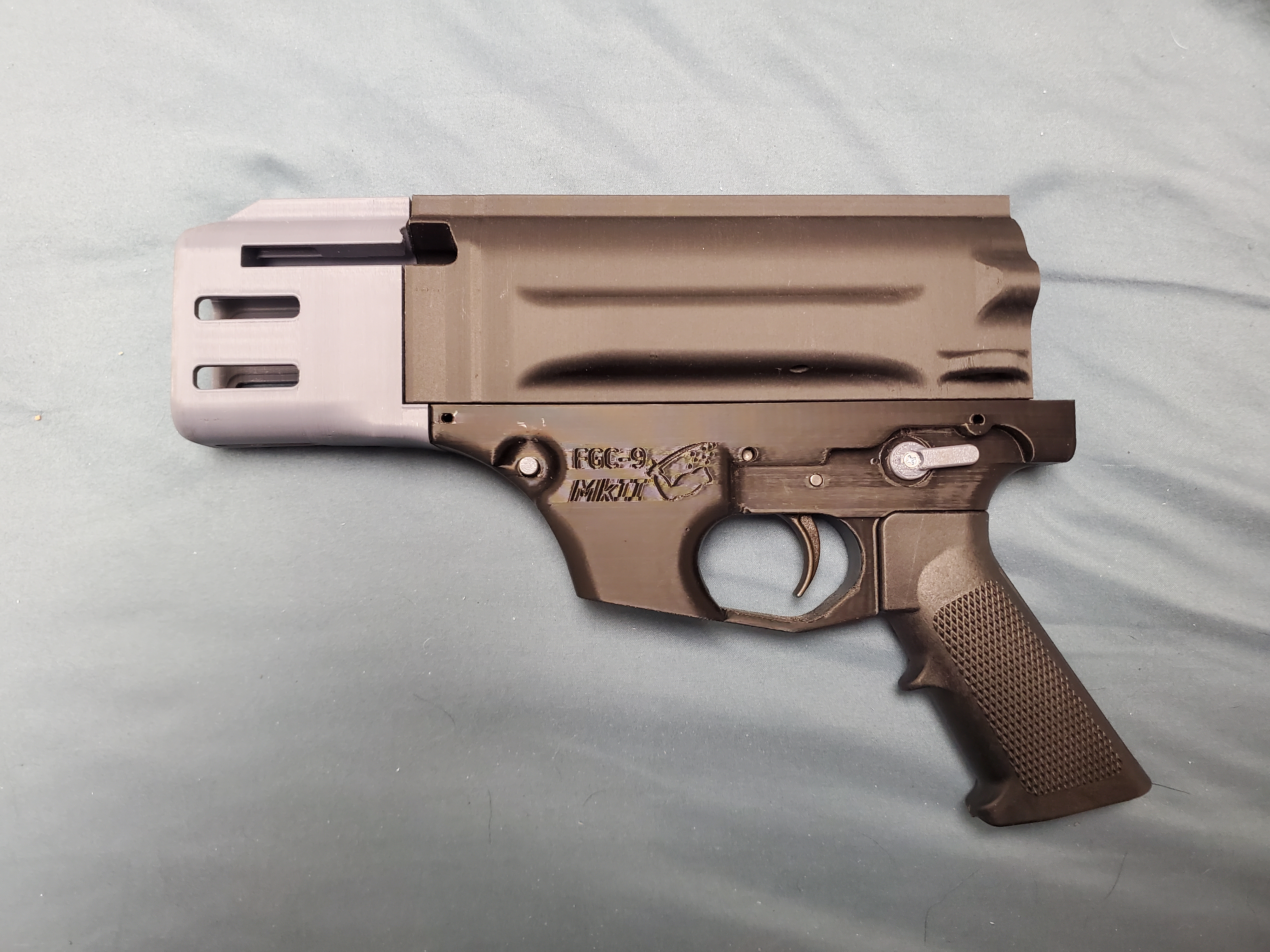

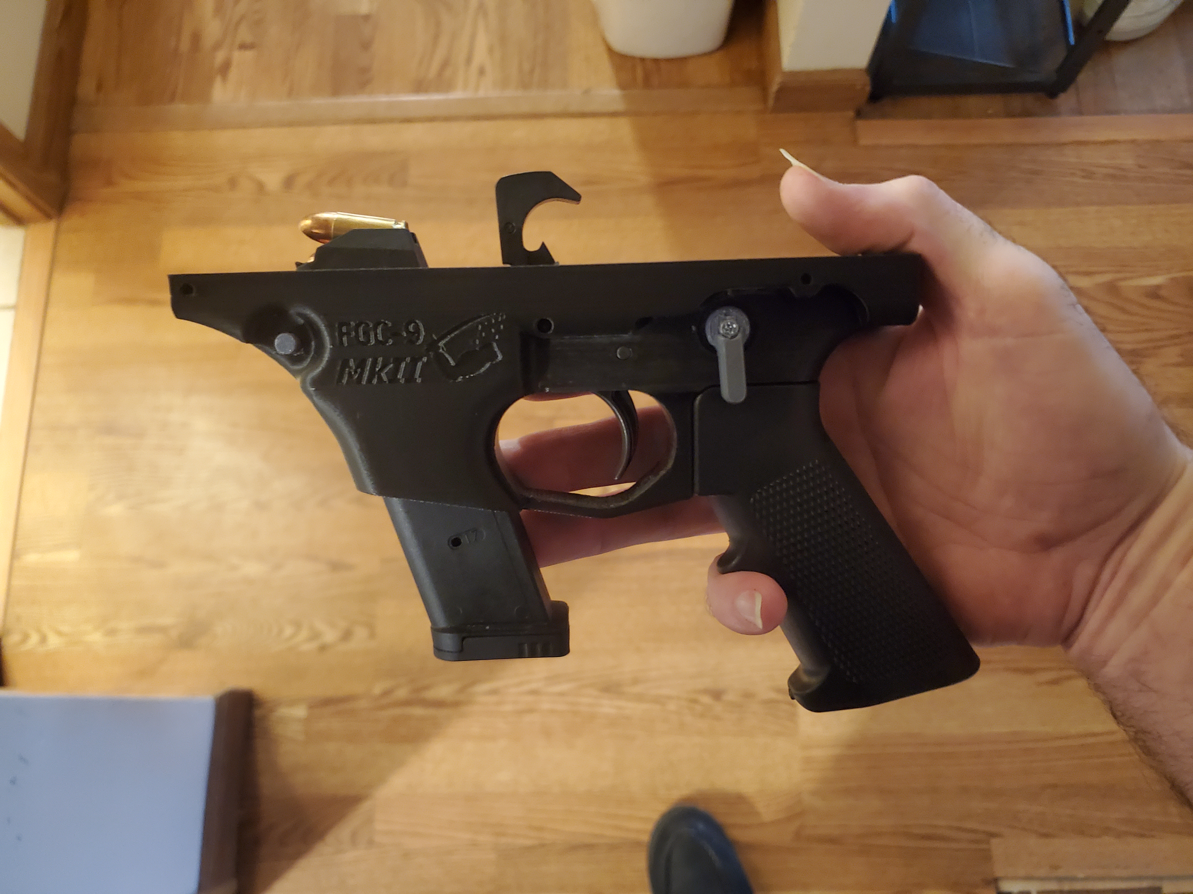

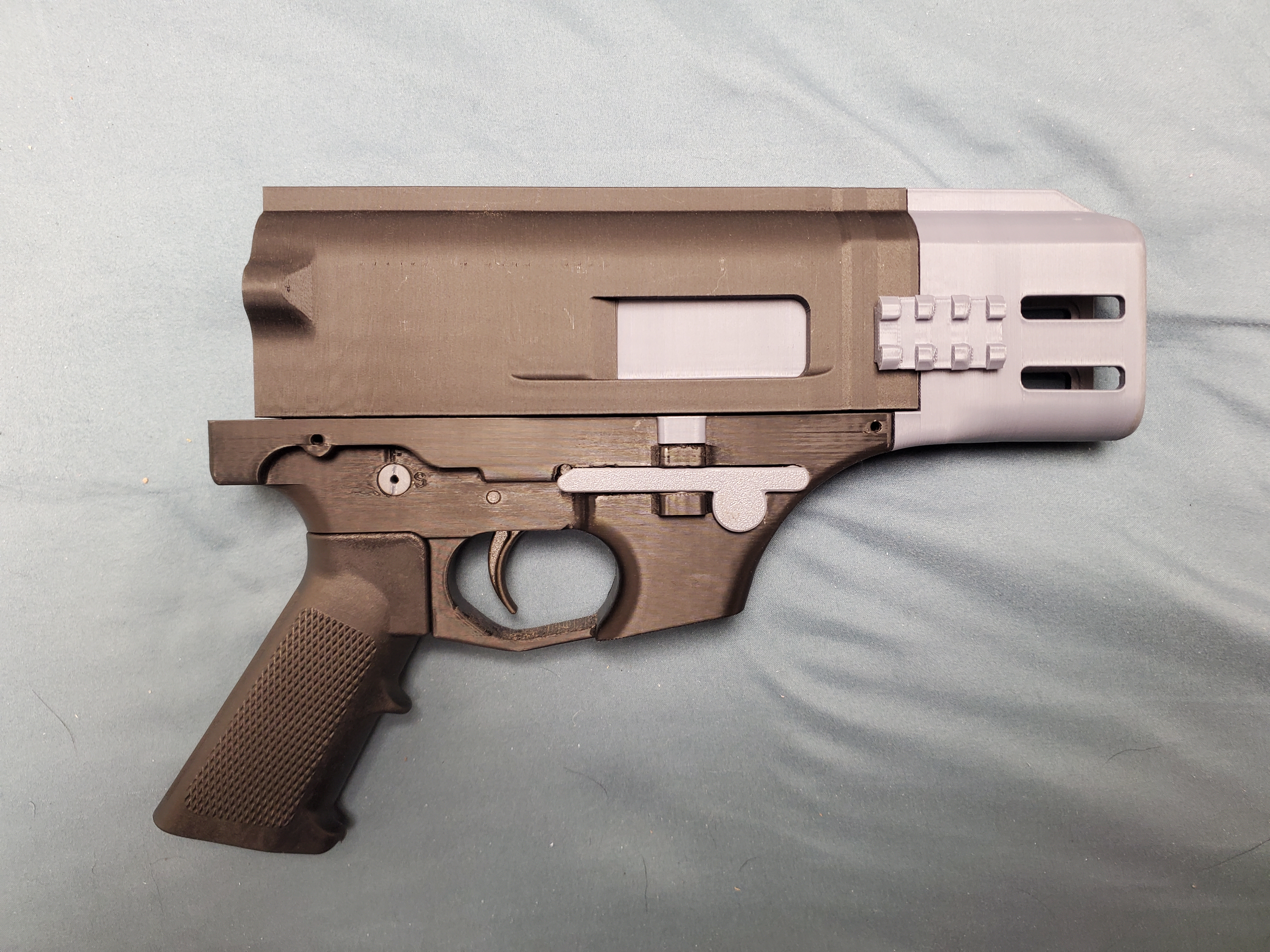

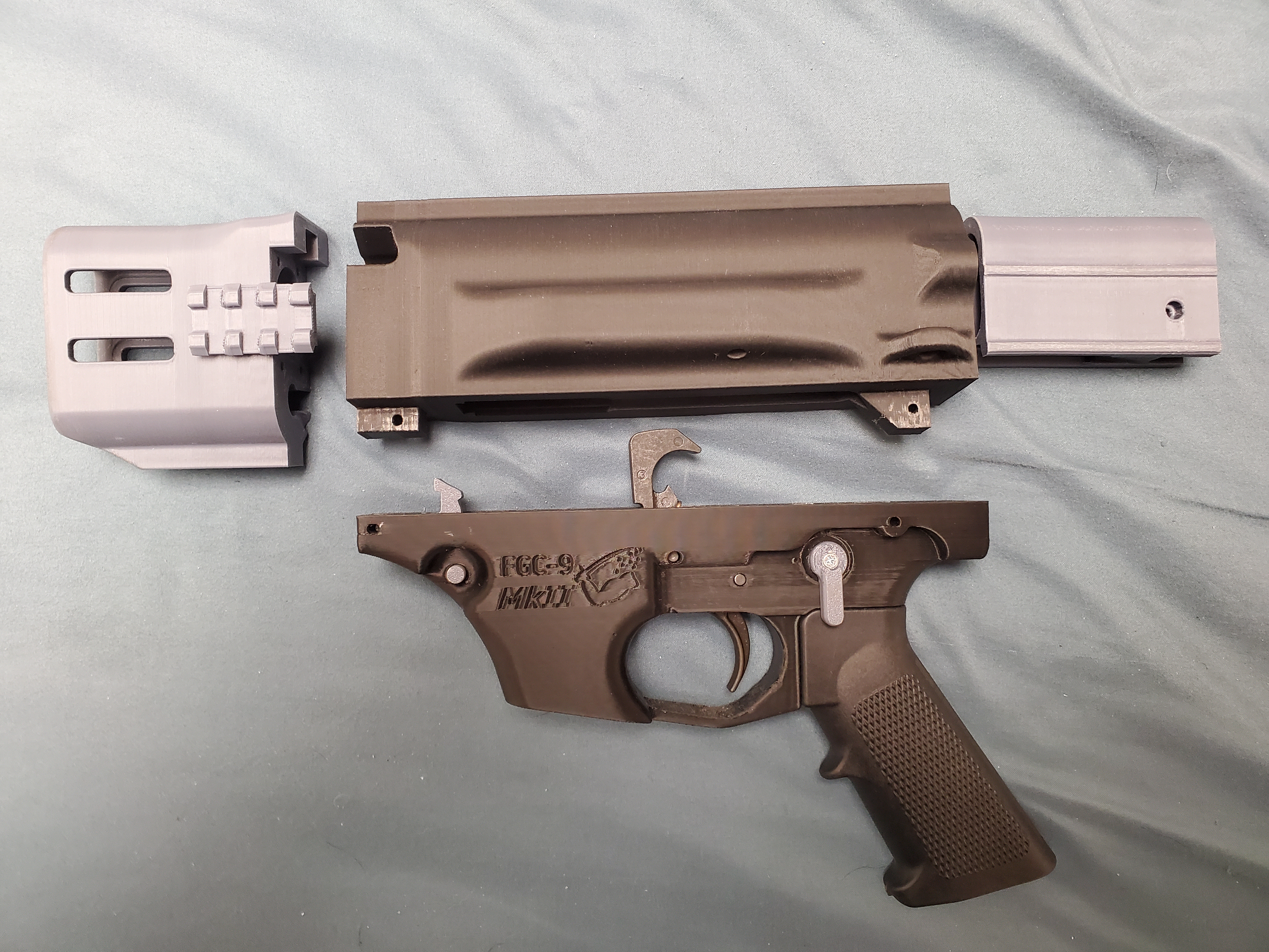

Posts: 1339
Few more of the other parts. It doesn't look proportional without the buffer tube and barrel.

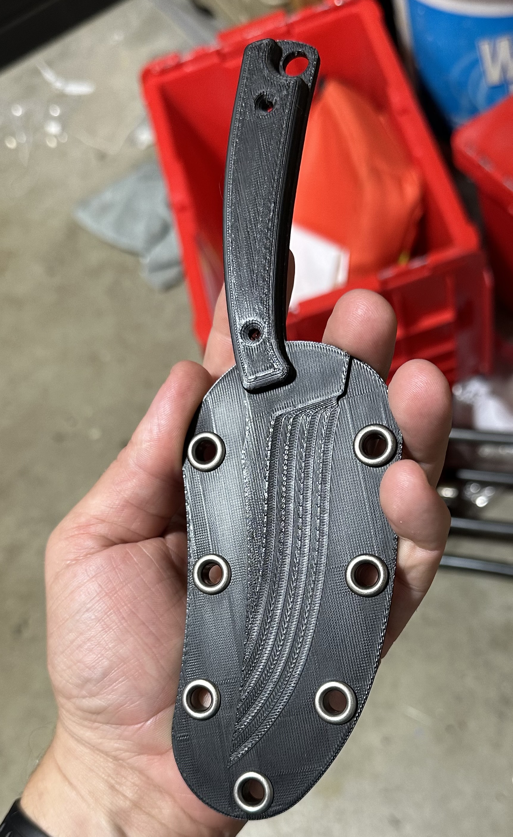

Posts: 4242
Printed representation of what the kydex sheath for the Sharp Middle Finger Skinner will look like. Missing the clip, that’s on the way.
Posts: 2339
looking good
Posts: 597
Awfully cool!
Make a few and I wouldn't be surprised if you sold the design. (or got Walmart'ed).
I'm in for a first run!

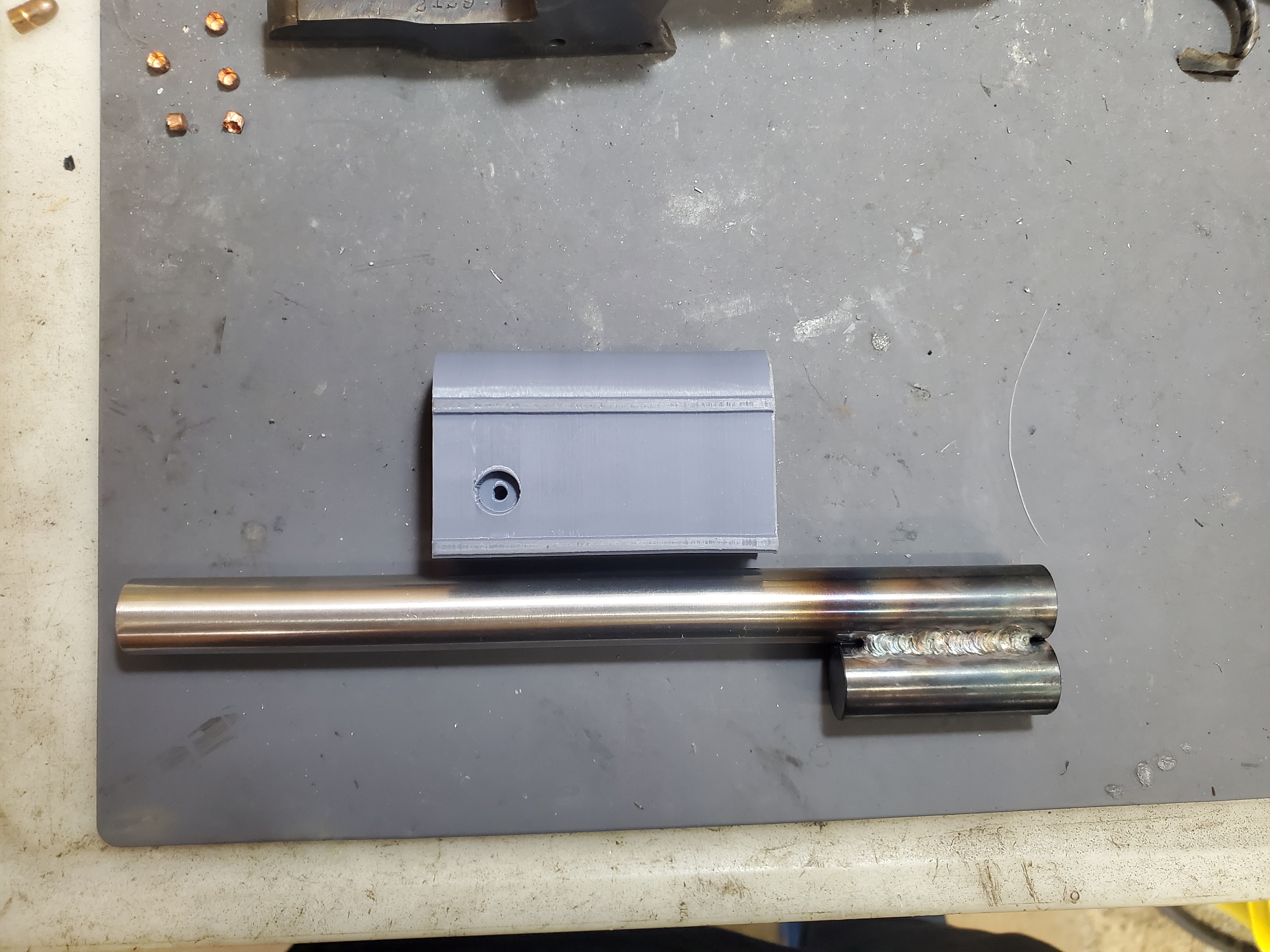

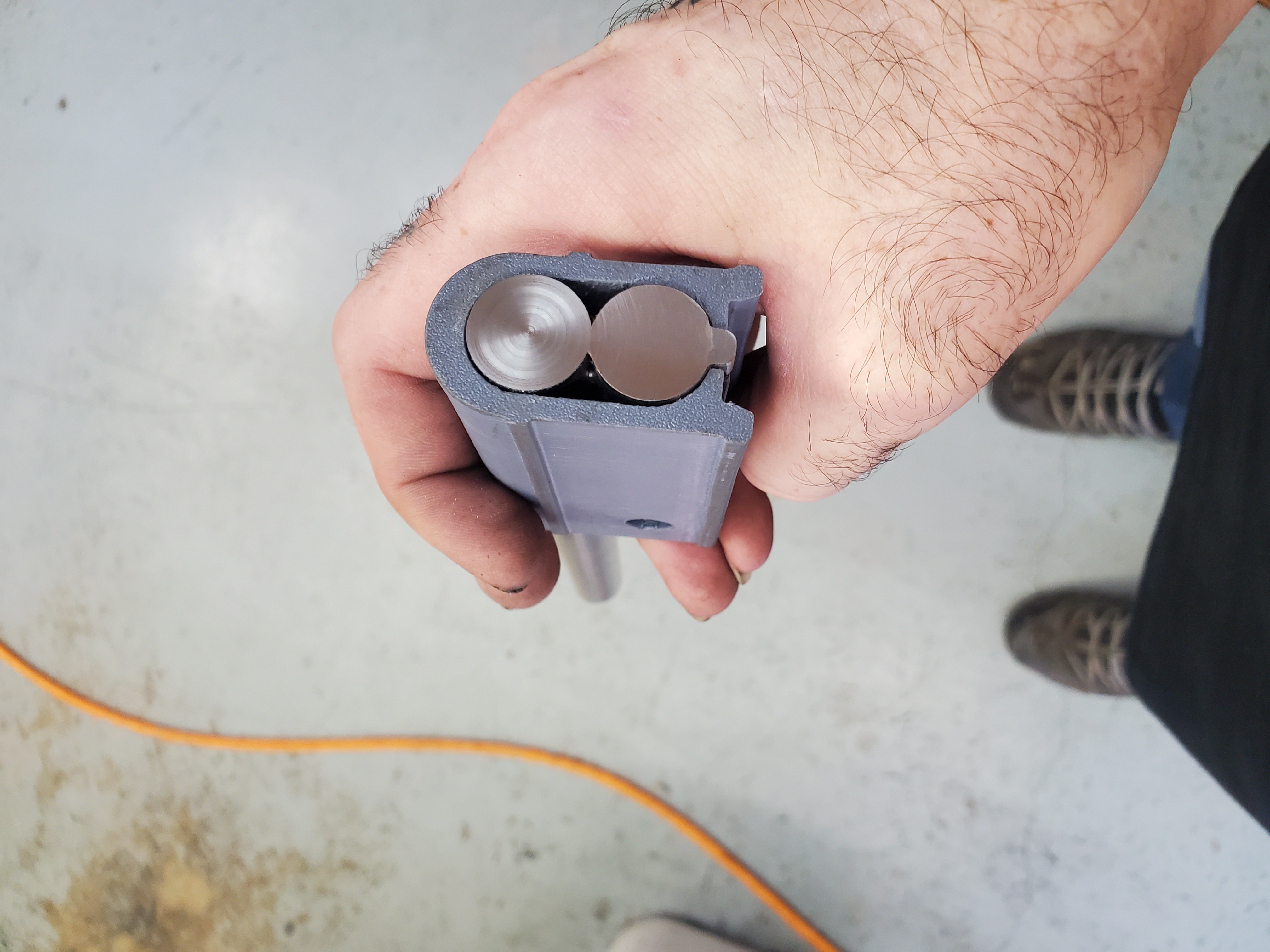

Posts: 1339
Got the FGC9 bolt mostly finished. It's pretty ingenious and easy to make.
Posts: 2339
Cool JSD
Posts: 597
Nice work!
Posts: 1339
Thank you both. The designer of this gun made all the parts and measurements in metric and the rod for the bolt is 18mm which nobody carries in local hardware stores. Ended up ordering it from eBay and it came from England. It's mild steel but their 1018 is soooo much nicer than our 1018. It machines like drill rod and finishes really well.

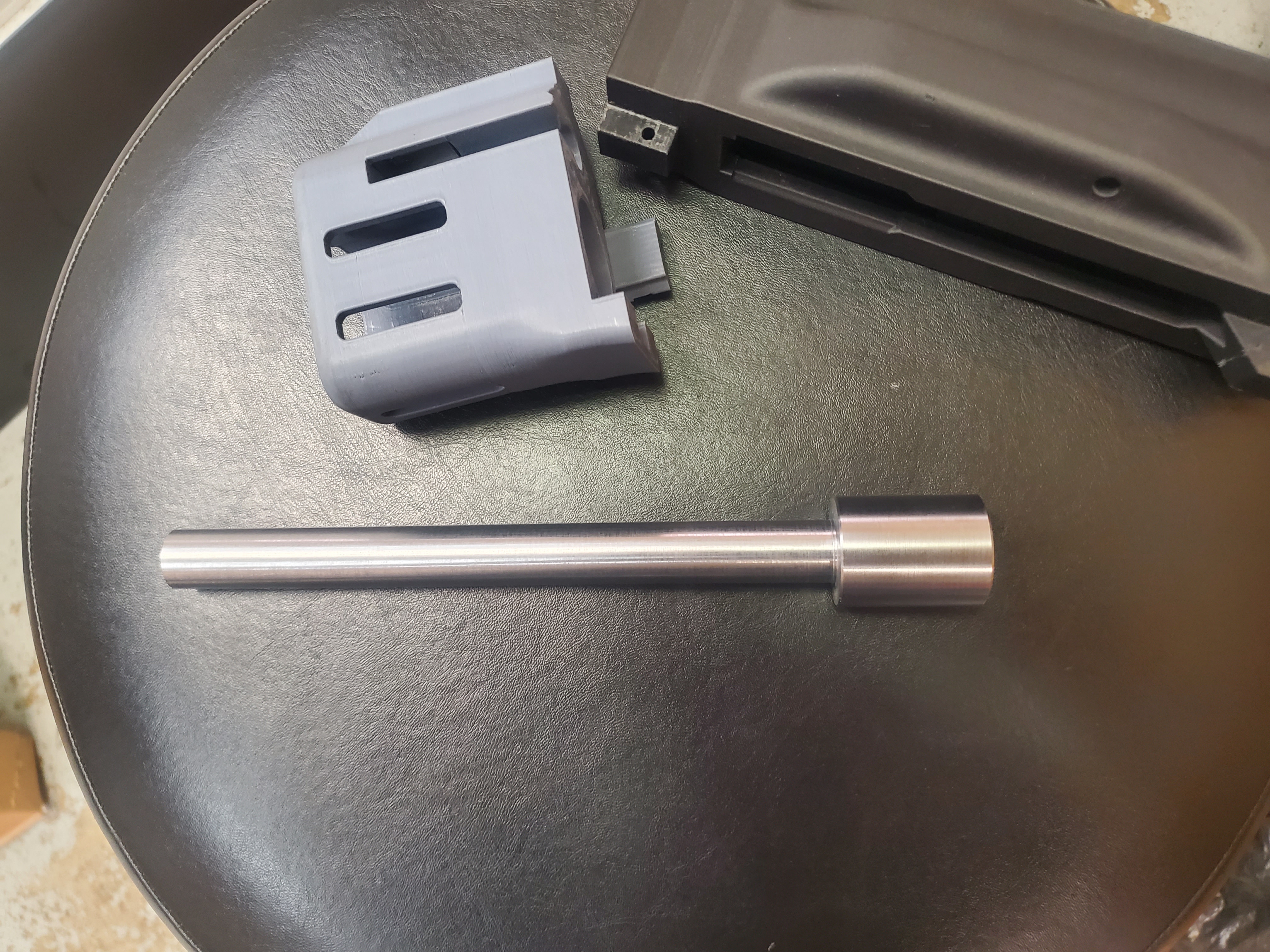

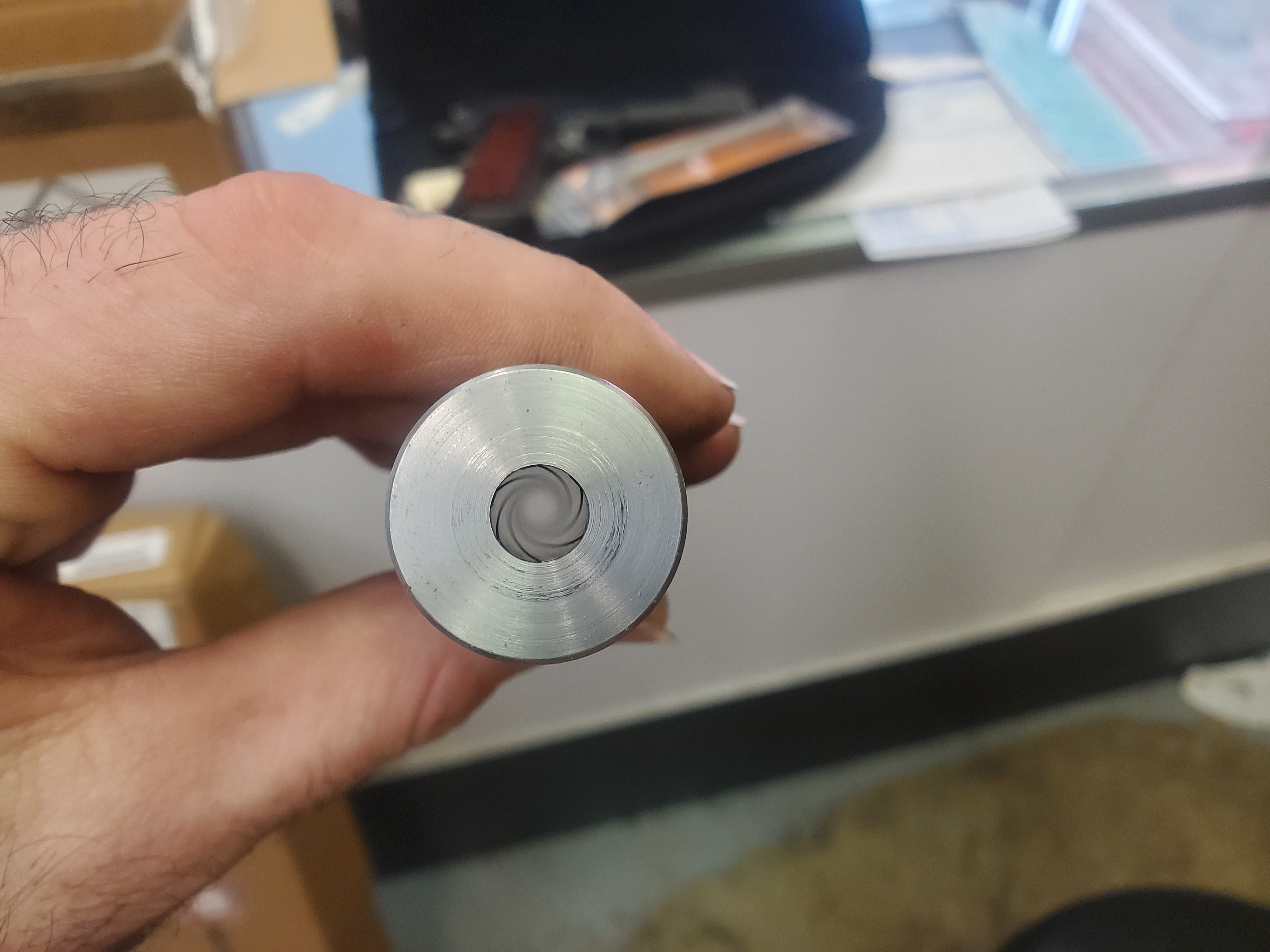

Posts: 1339
Barrel done, besides reaming the chamber.

Posts: 597
JSD, how did you rifle the BeeBeeL?
