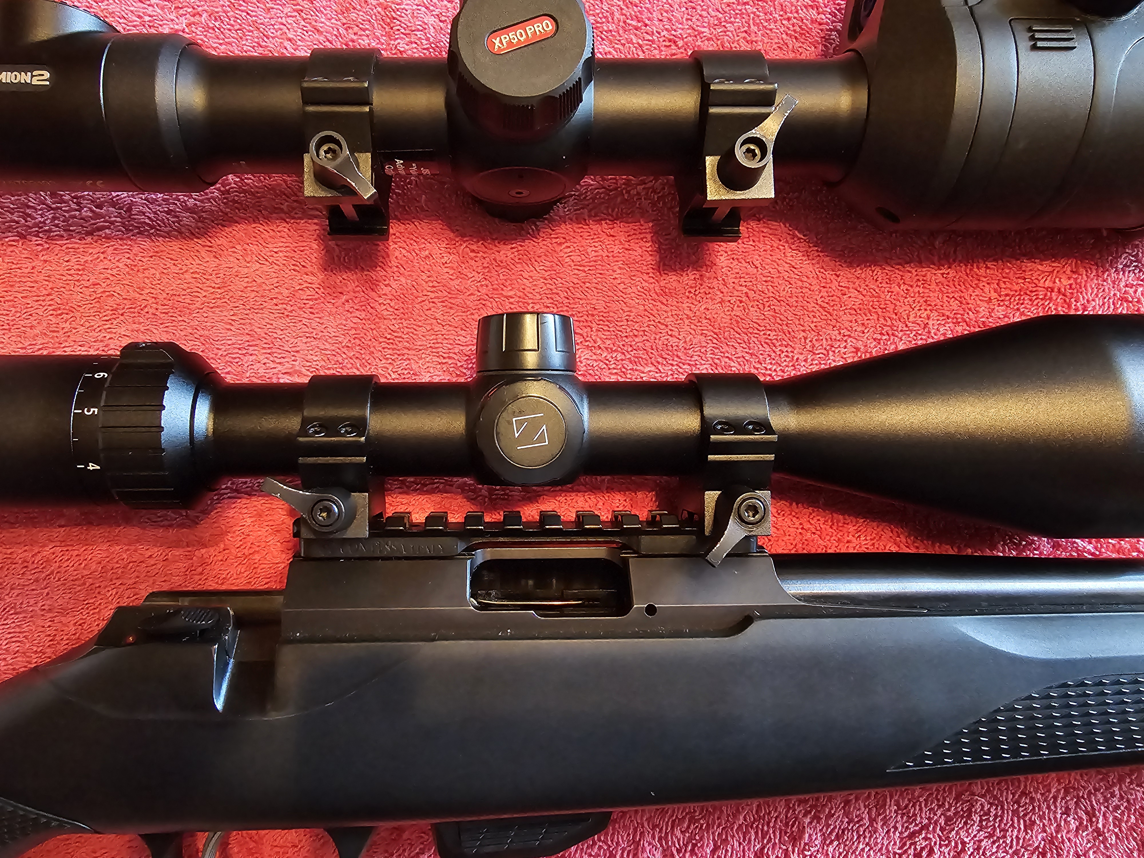

I use my Pulsar thermal on 3 different rifles and interchange it daily with scopes most outings when doing pest destruction.
My observations are as follows.
1. Buy the best quality Pic rails you can afford and use the same brand on all your rifles you want to play 'Switcherydoo' with.
2. Buy the best quality QR mounts you can afford and use as above.
Because we are limited in choice down here, I went with Contessa rails and Leupold QR mounts.
3. Eye relief is important. ( Well it is to me cos of eyesight problems.)

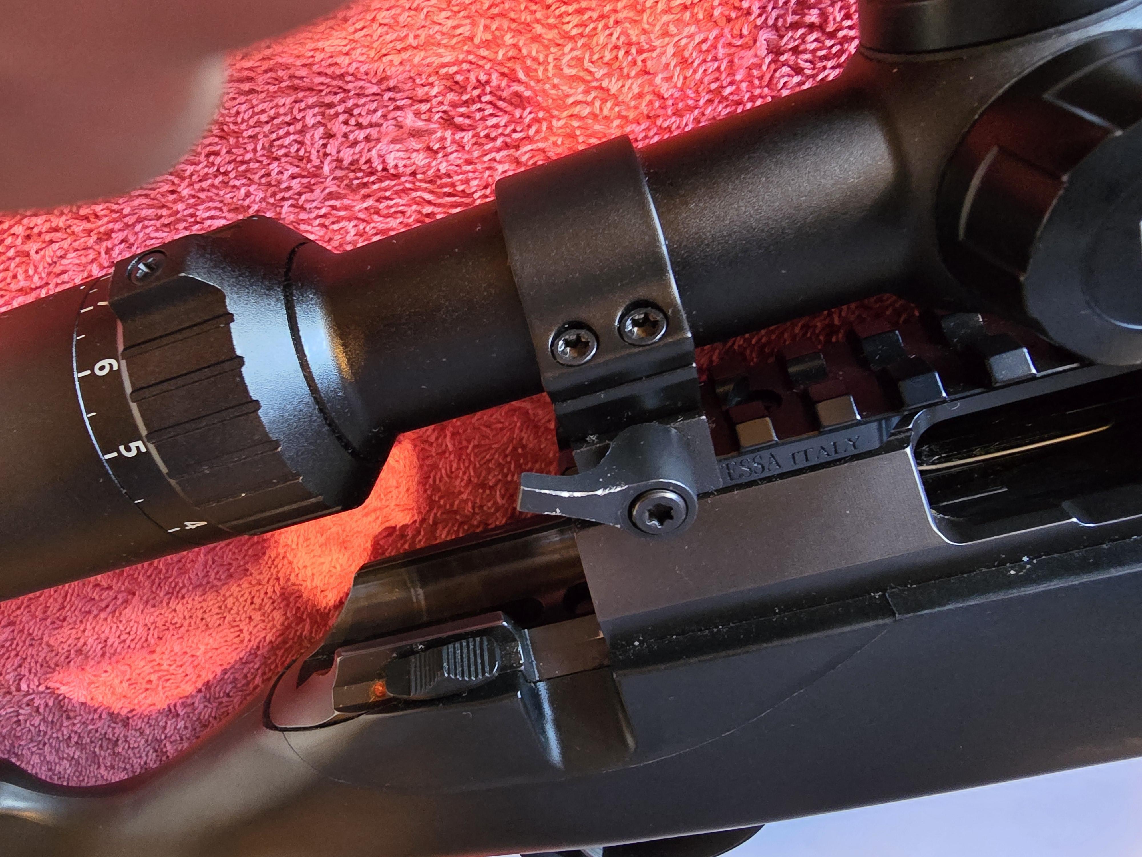

What I did was fit the pic rail to the chosen rifle, then mount the scope and sight it in.
I then placed the thermal as per the attached pic and lined up the rear with the scope mounted on the rifle to 'set' the eye relief.
Rifle shown is my T1x in 17HMR
Note that the QR mounts are using the rearmost and front slots on the rail.
When I sighted the thermal and scope in at 100m, I removed and replaced them numerous times to check the repeatability of the zero. I found that the point of impact varied by up to 2 inches or more. I didnt think that was satisfactory and came up with a hillbilly solution.

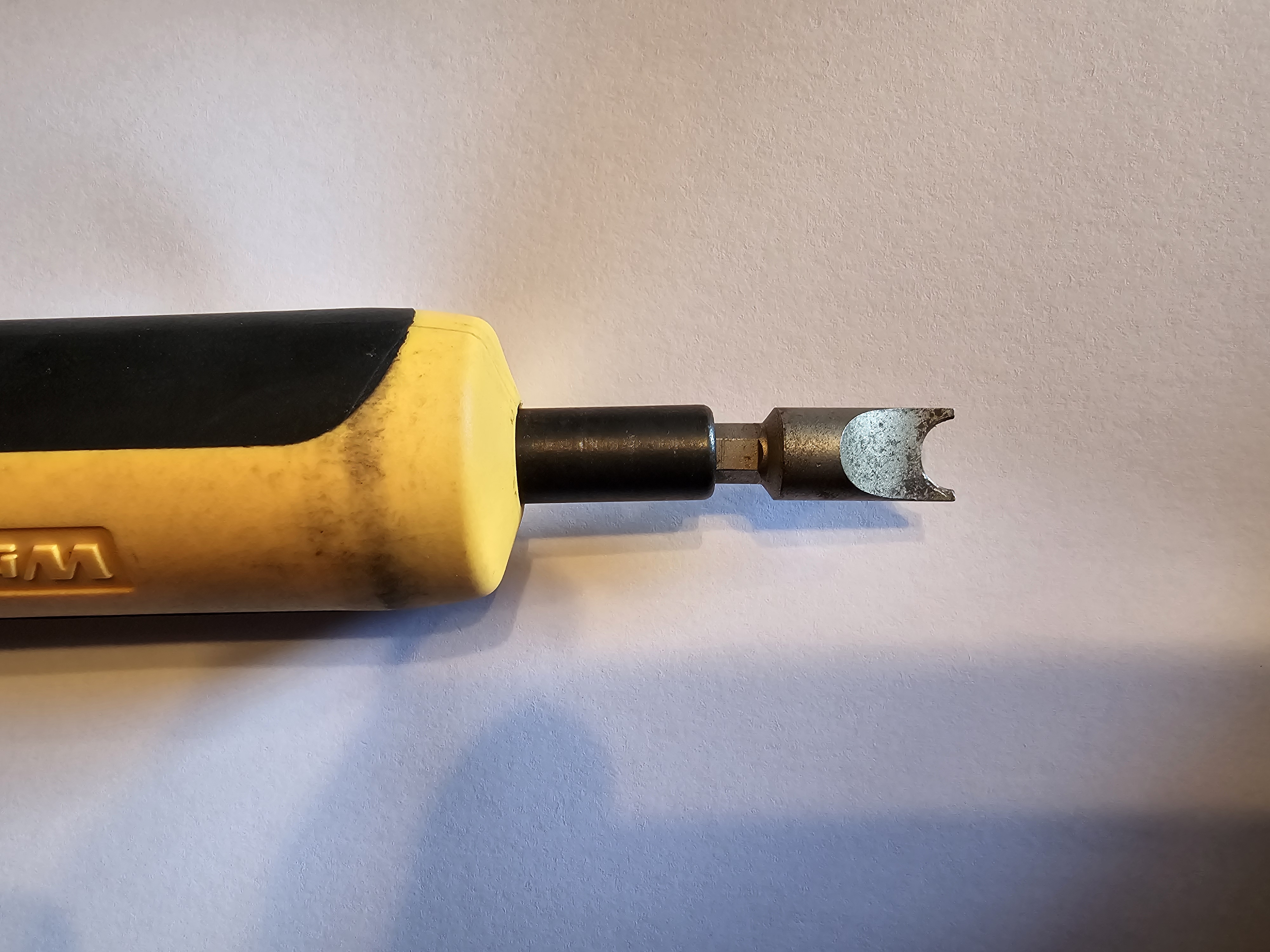

Here it is..... I used my Wheeler Fat torque wrench and one of the unused 'bits' from my Wheeler Screwdriver set. After experimentation I found that 15 Inch/pds was the setting that gave me the best repeatability.
To swap the thermal for the scope I do the following.
Use the wrench to loosen the scope QR mounts and wind them right out with my fingers. Place the thermal in place and push it forward against the pic rail with hand pressure while tightening up the QR mounts finger tight..... doing the front mount first. When both mounts are finger tight and still keeping the forward pressure on I use the torque wrench to tighten them until the wrench lets go......again doing the front mount first. I can do the changeover in less than 2 minutes.
Repeatability of zero for this method dropped the groups to within .5-8 of an inch with both the scope and the thermal.
The QR levers are a bit scratched as using the wrench is metal to metal but I am not worried about it...see next pic On thurs afternoon I was up at the farm shooting magpies at ranges up to 140m with the scope fitted...most were head shot using a solid rest. When it got dark I switched to the thermal and was shooting rats and possums out to the same distances. In the morning I switched back to the scope and knocked off a few more magpies before moving cattle took priority.
