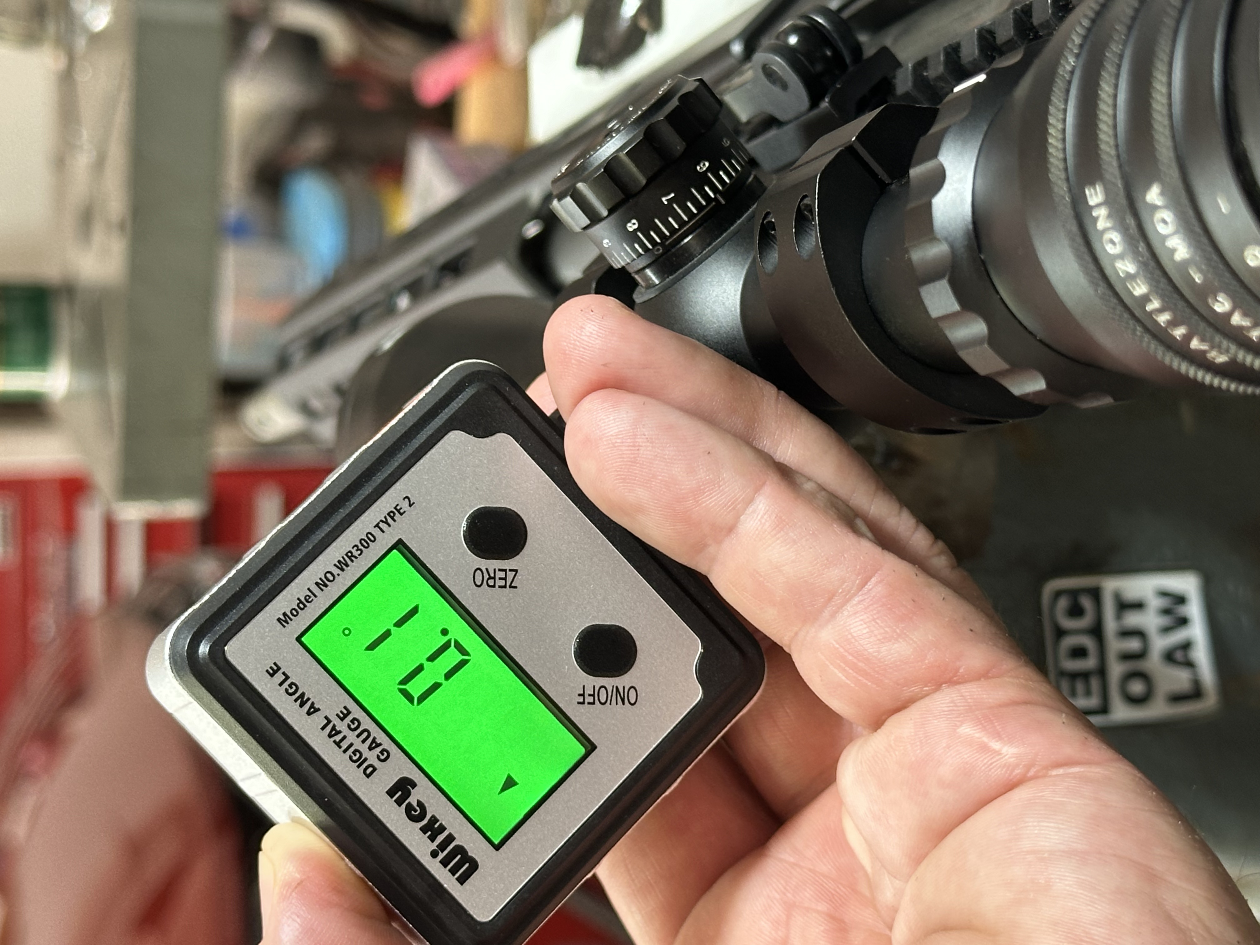

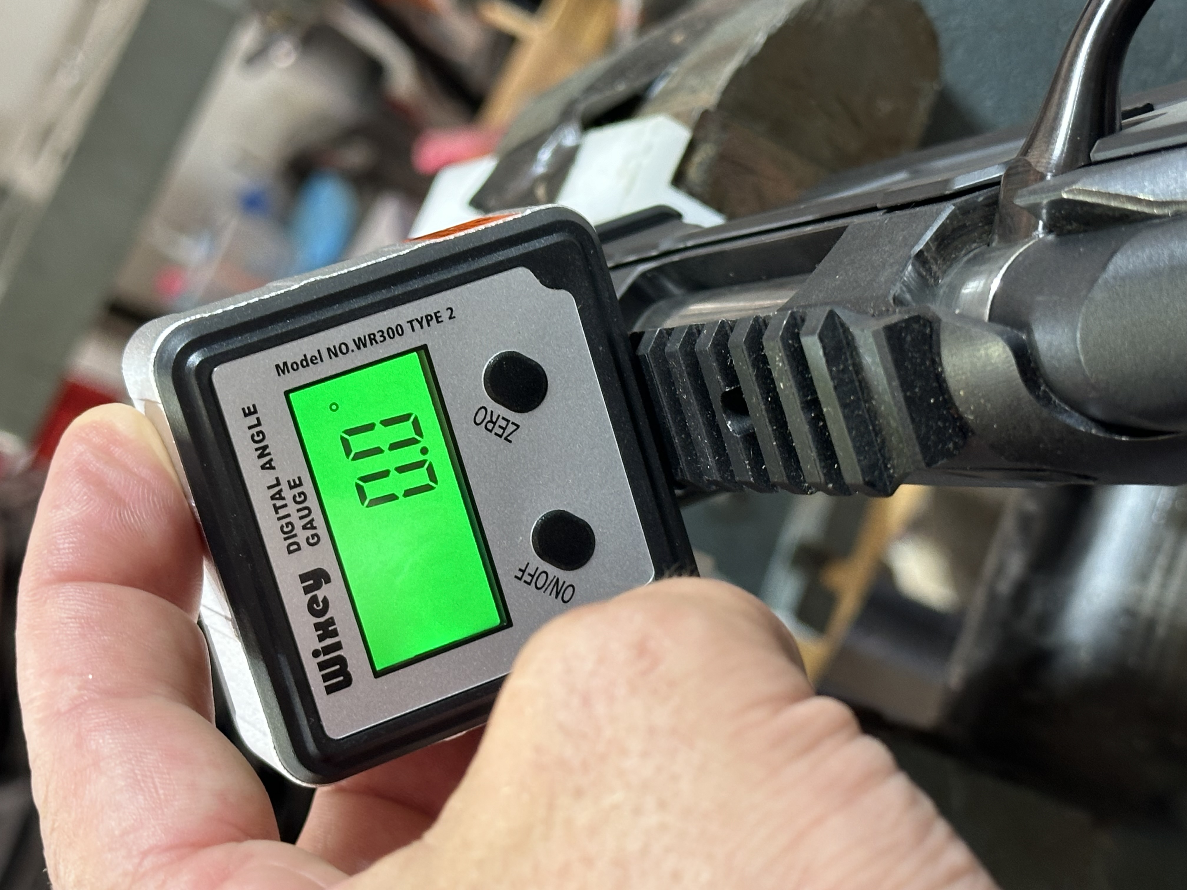

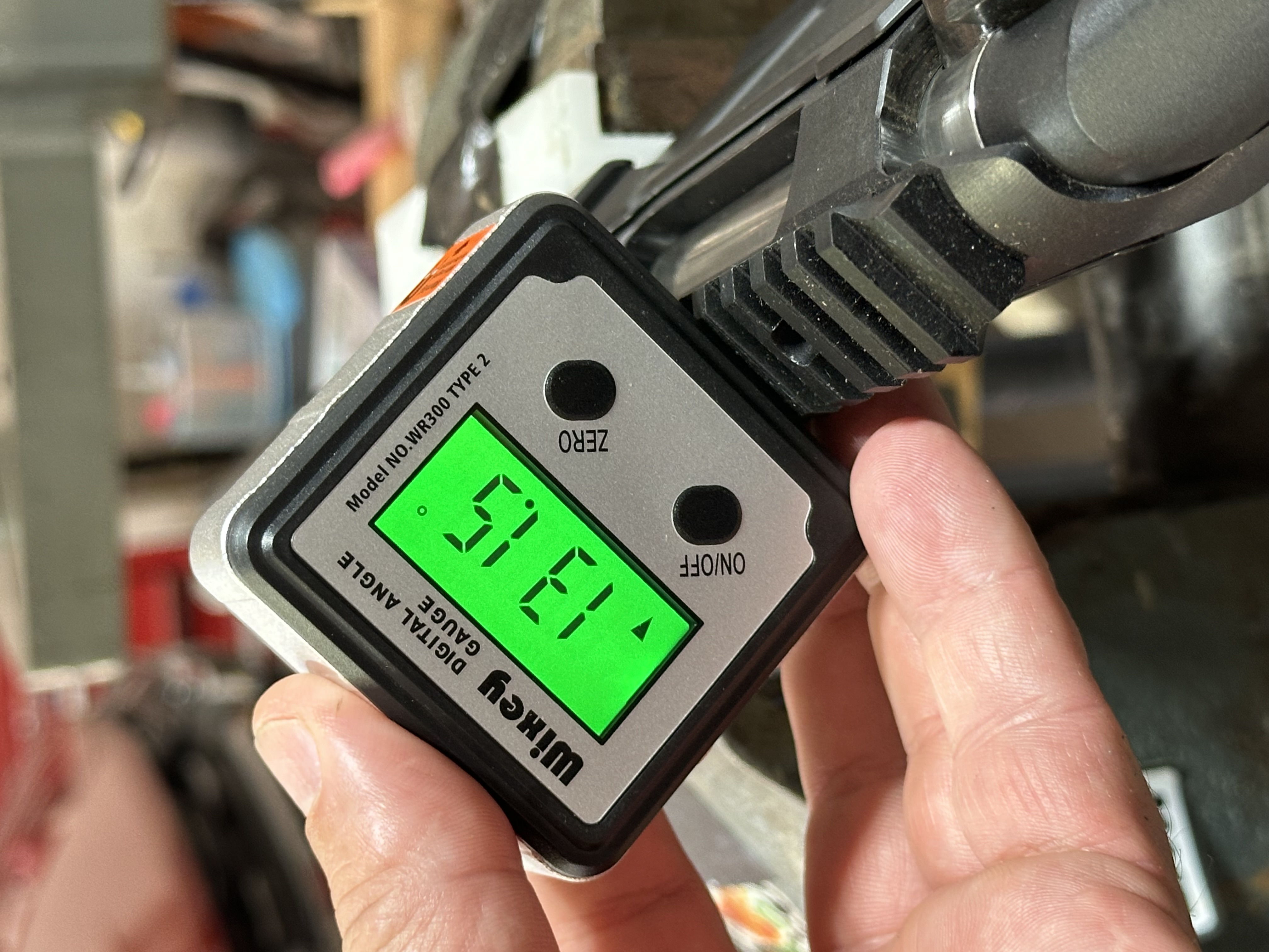

You get your self a digital level. Oh my God it’s battery powered! And digital! The horror!
So anyway, you can clamp your rifle in any angle you desire, no need to get fussy about making sure it’s level.
Put the gauge on the rail, and zero it. Now it’s referencing the rail, and not “true” level.
Slap the scope in, place the level on top of the cap and adjust till it reads zero. Easy peasy.
They are accurate to within .1 of a degree, which is better than most eyeballs are gonna be able to judge with traditional scope mounting type levels.
Wixey WR300 Digital Angle Finder... https://www.amazon.com/dp/B00T6YZ0K6?re ... b_ap_share
I purposefully placed the rifle at a stupid angle just for illustration. Pics are in reverse order. But you get the drift.

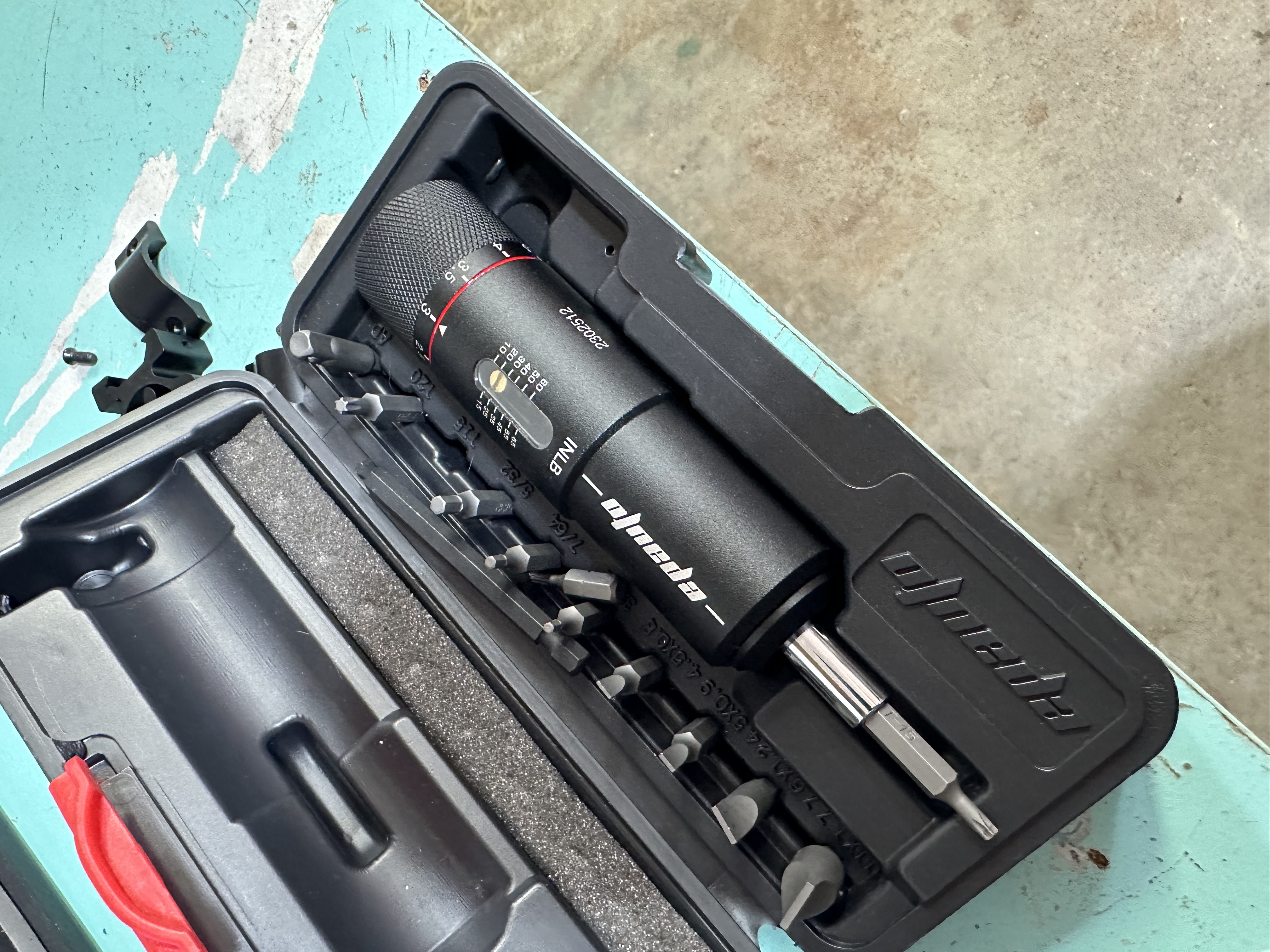

I use this torque driver. $39 and beats hell out of the wheeler fat wrench. All metal housing, and made in Taiwan instead of China. Typically Taiwanese tooling is better quality.
https://a.co/d/62uIIkz
And yeah, the QD AR mount looks a little goofy, but I was trying a cheapass QD mount.

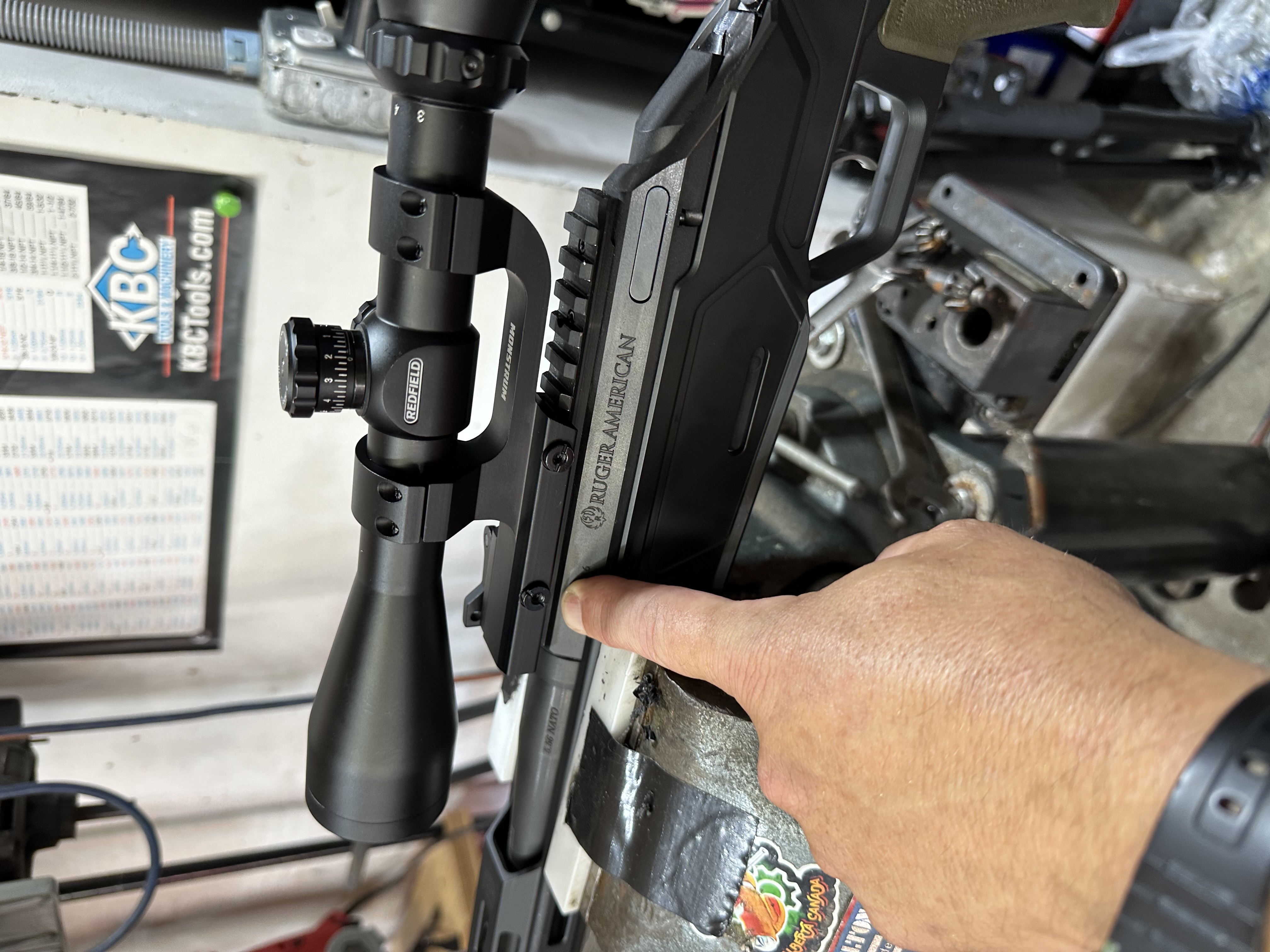

Scope mount
Monstrum Slim Profile Series... https://www.amazon.com/dp/B07MJCT11L?re ... b_ap_share
