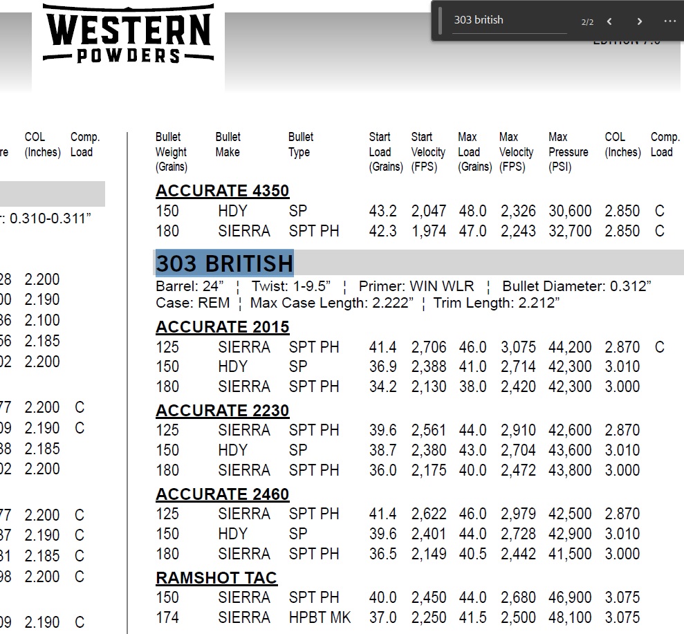

looked in an older Western Powder PDF manual (pre hodgdon buying them) and they DO list TAC in the 303Brit with 150 and 174gr bullets

In my experience, Western Powders' ballistician had a habit of pushing pretty hard, so I'd work up carefully
