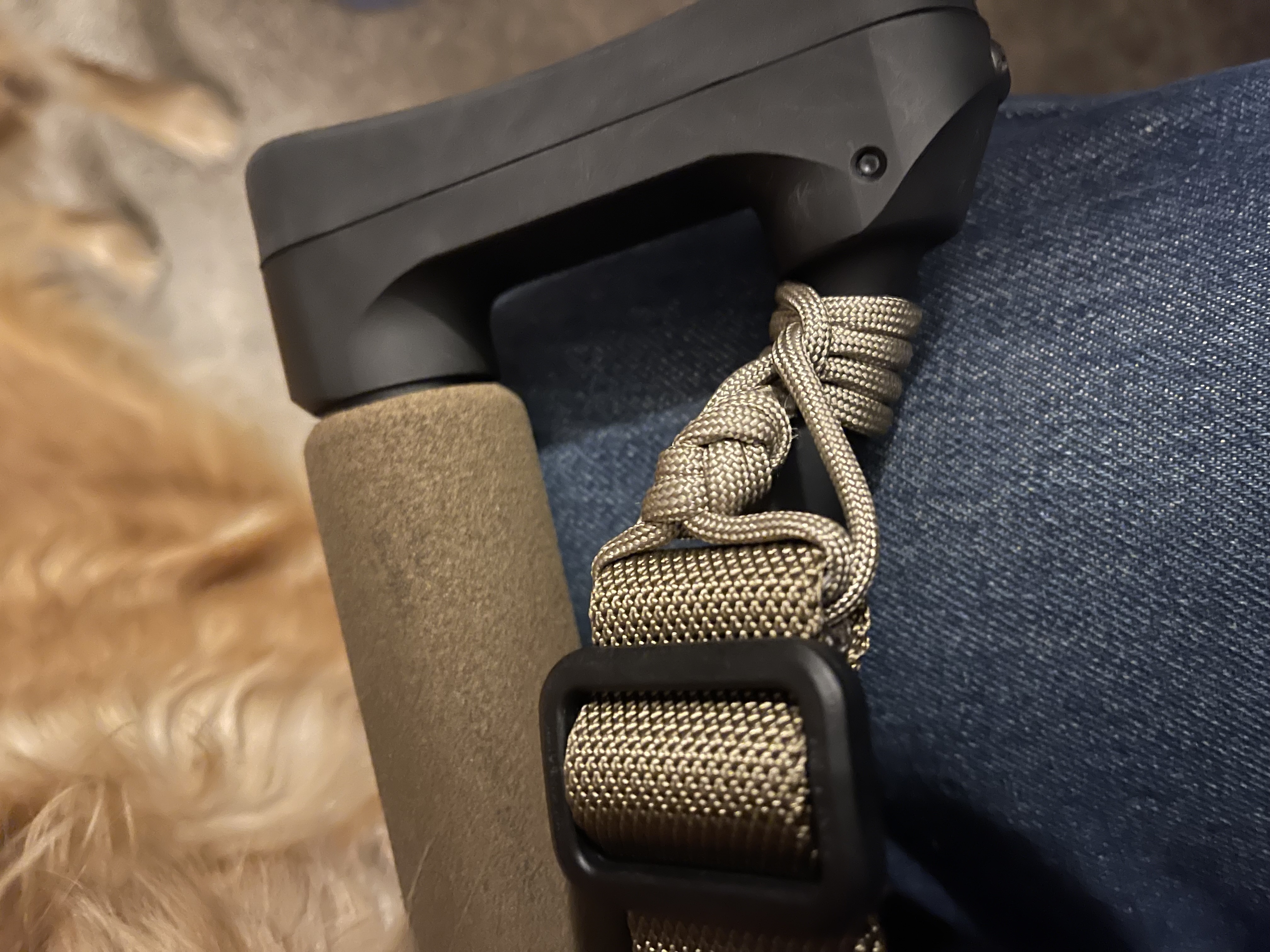

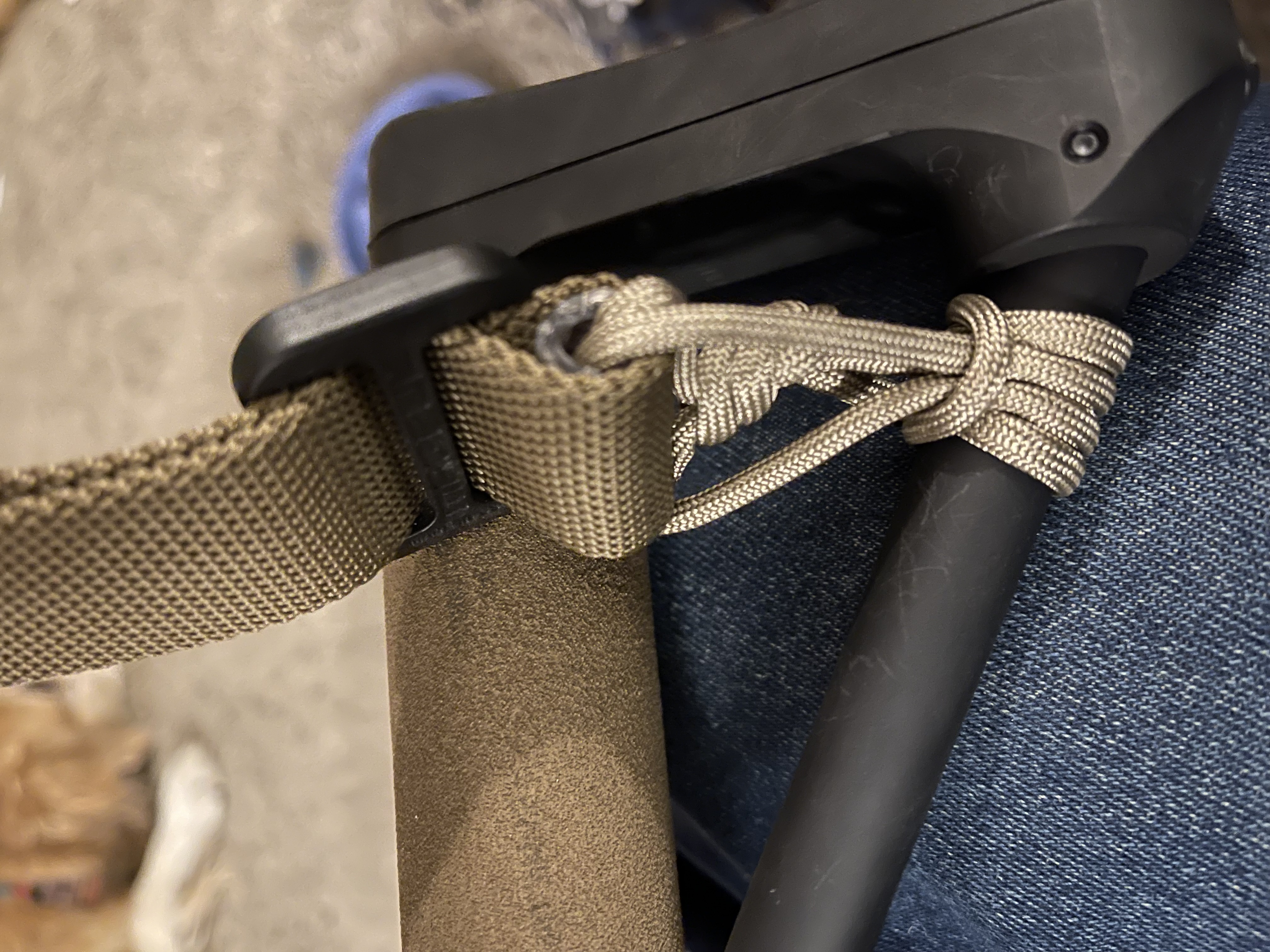

Oh, what’s a carbine without a sling, so I fixed that too. I found a Magpul MS1 on eBay for 20 bucks with shipping, it was even coyote brown! I had a front mloc QD set from the afore mentioned “random cheap AR junk” box but no rear swivel or QD socket. Para cord to the rescue. I worked up a rear attachment point, it works great so far….threat is a slightly modified Prusik knot. When weight is applied tonic it will bind onto the tube and not move, but remove the weight is will slide around. It stays put when the rifle is hanging doing. There is a section of reinforced tubing that the para cord runs through to support the sling and reduce any wear spots with the para cord running on the sling. It is working great so far. We shall see.
