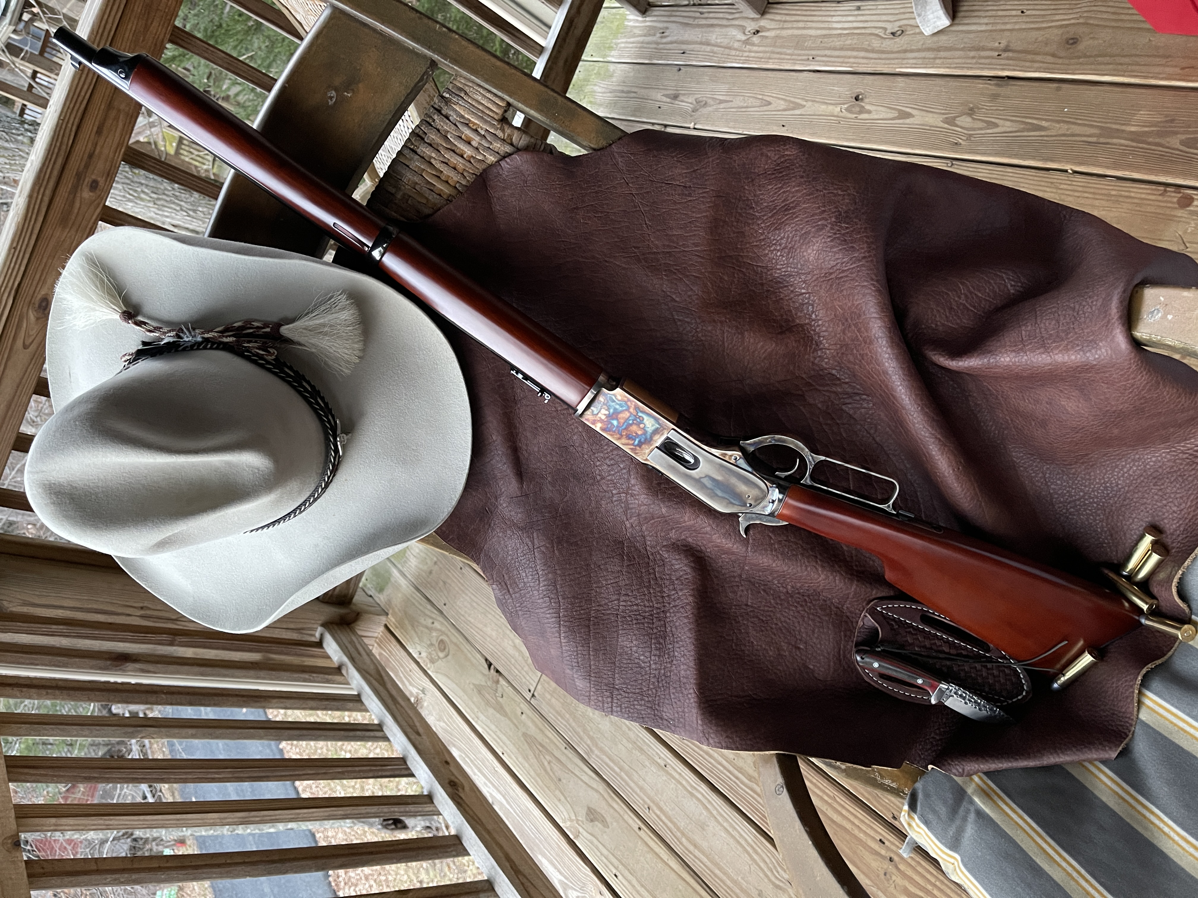

I just want a vintage lever action option and I keep thinking that an 1886 would be nice BUT I LOVE my Centennial 1876 musket and I don’t know that I’d ever take an 1886 off the rack if the 1876 is there wanting to get out…
Besides I have the hat to match it 🤠
