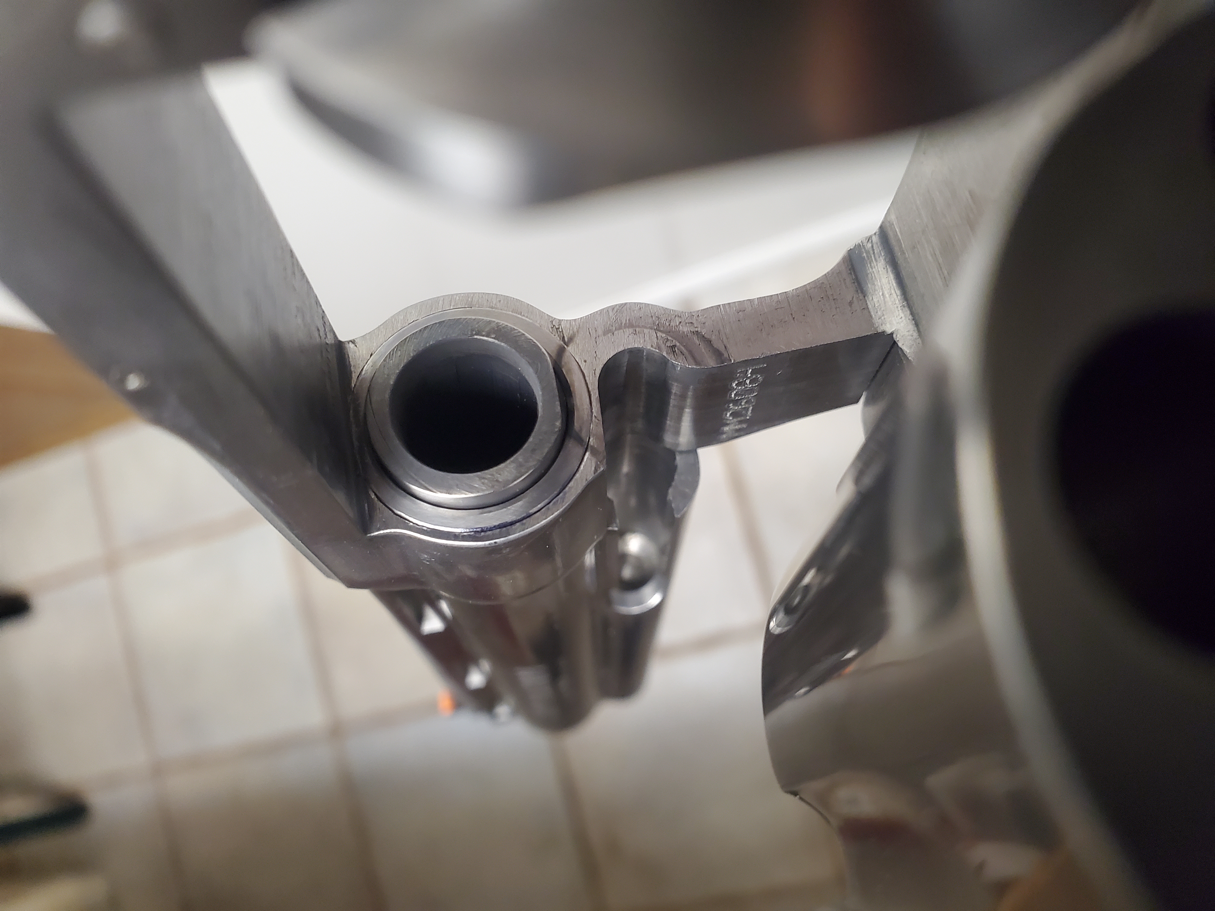

Thank you. I probably could have afforded to have cleaned it up a bit before taking the picture though.

That is a lot of work!!
Curious is the frame cast? I wondered if this was an original manufacture error.

I dont believe that it was cast but I could be wrong. As far as I can tell they machined the front of the frame out of square and also the threads were crooked. It was hell to make a guide tool to indicate the frame in based off of the cylinder being installed but it worked really well by having that tool stick out of one of the front cylinder bores with the cylinder installed and locked in place.

I believe Colt experimented with frame castings years ago, but didn't really put it into production. Ruger, I believe is the only major company who uses frame castings.

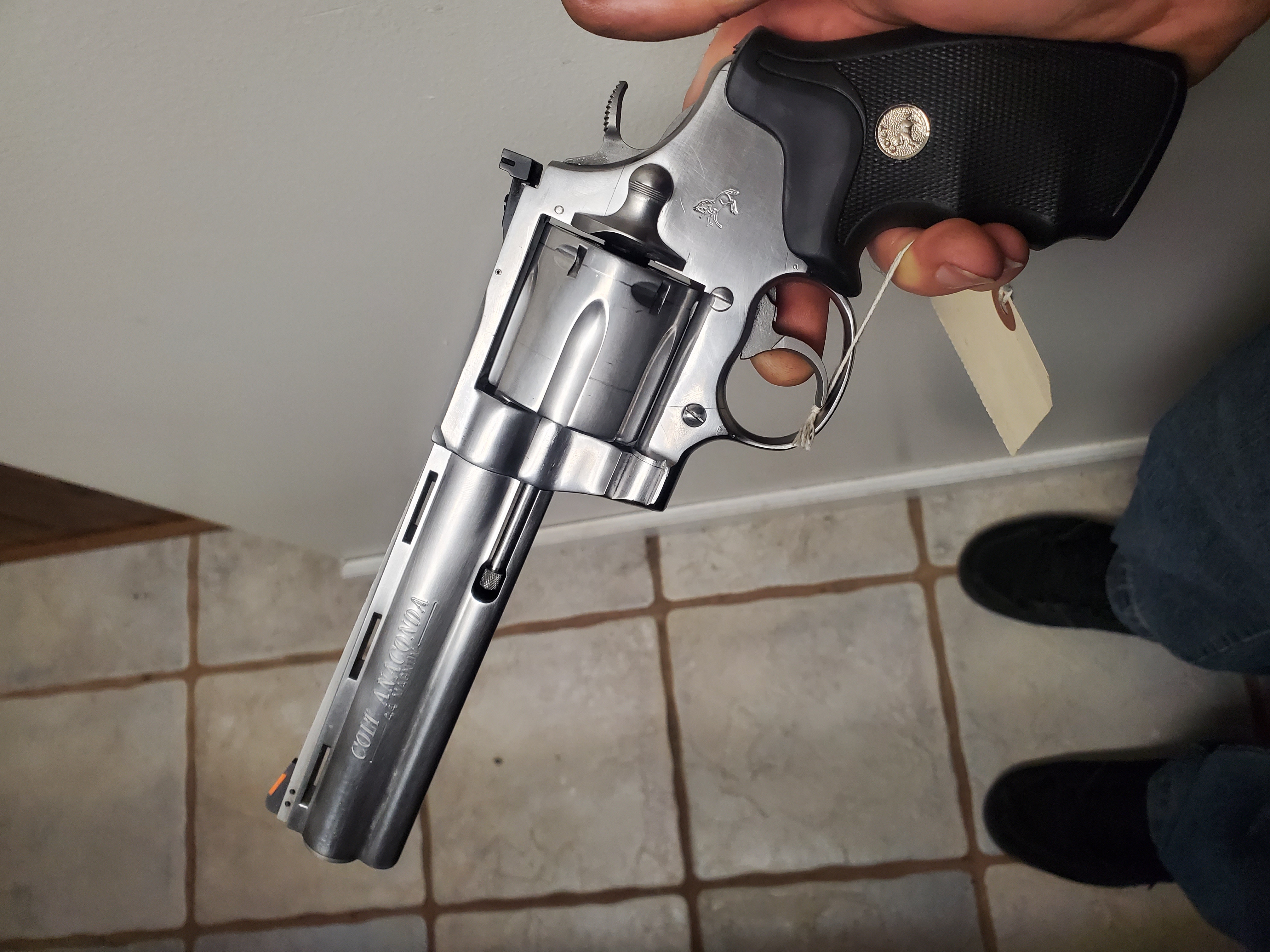

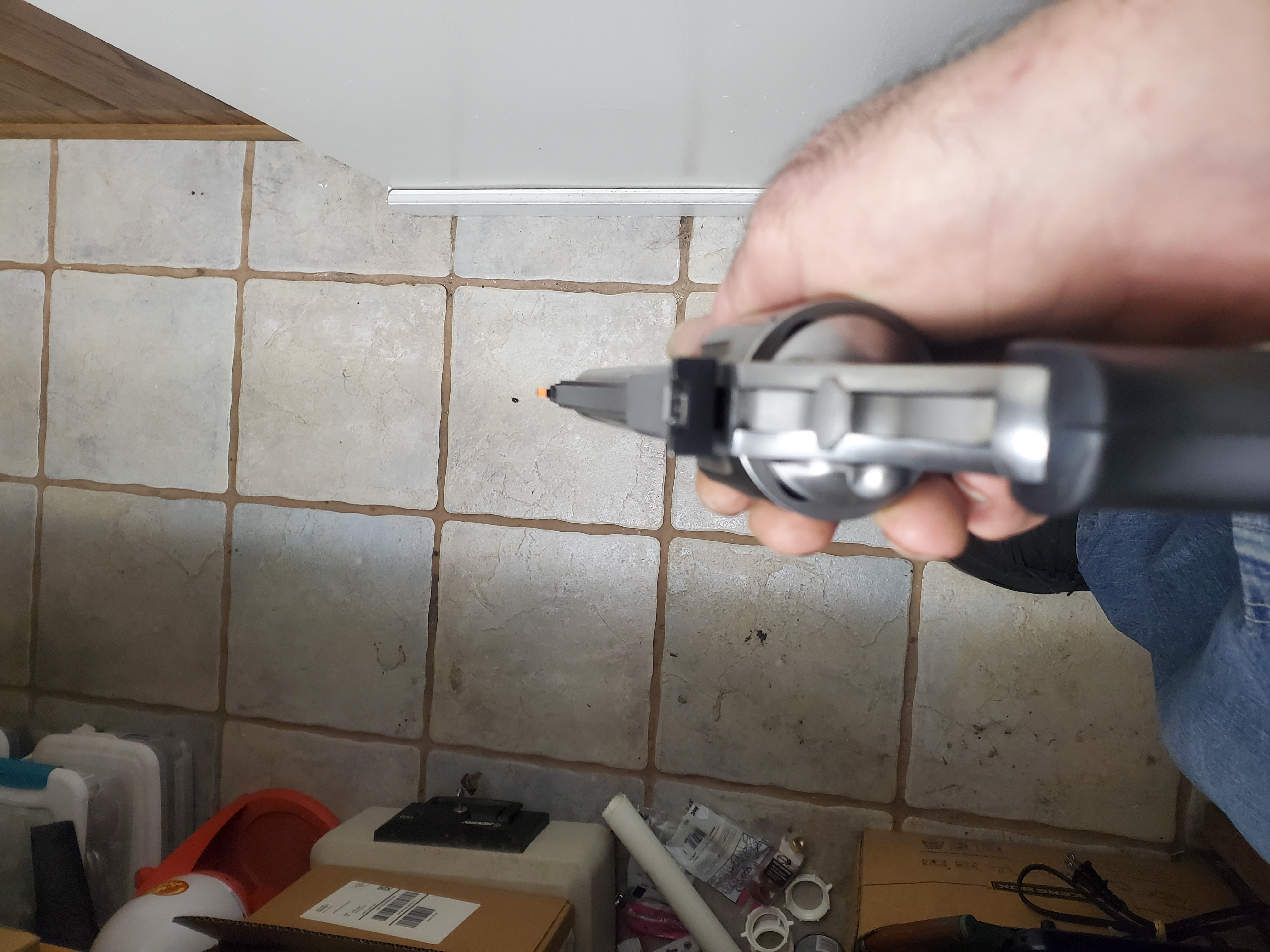

At least you guys have your voice-mail set up. I'm griping about the morons that send me to voice-mail and it's full or not set up and then I have to store their guns which at times can cause me to have to decline work (my safe stays that full) and its money and time I have tied up just sitting there. Oh, on another note, I did finish the Colt Anaconda and test fired it today. It's superb. The barrel was so crooked to the left that the rear sight was jacked so far to the right that the adjustment screw was almost falling out.

That is Maestro level work. Just is.
