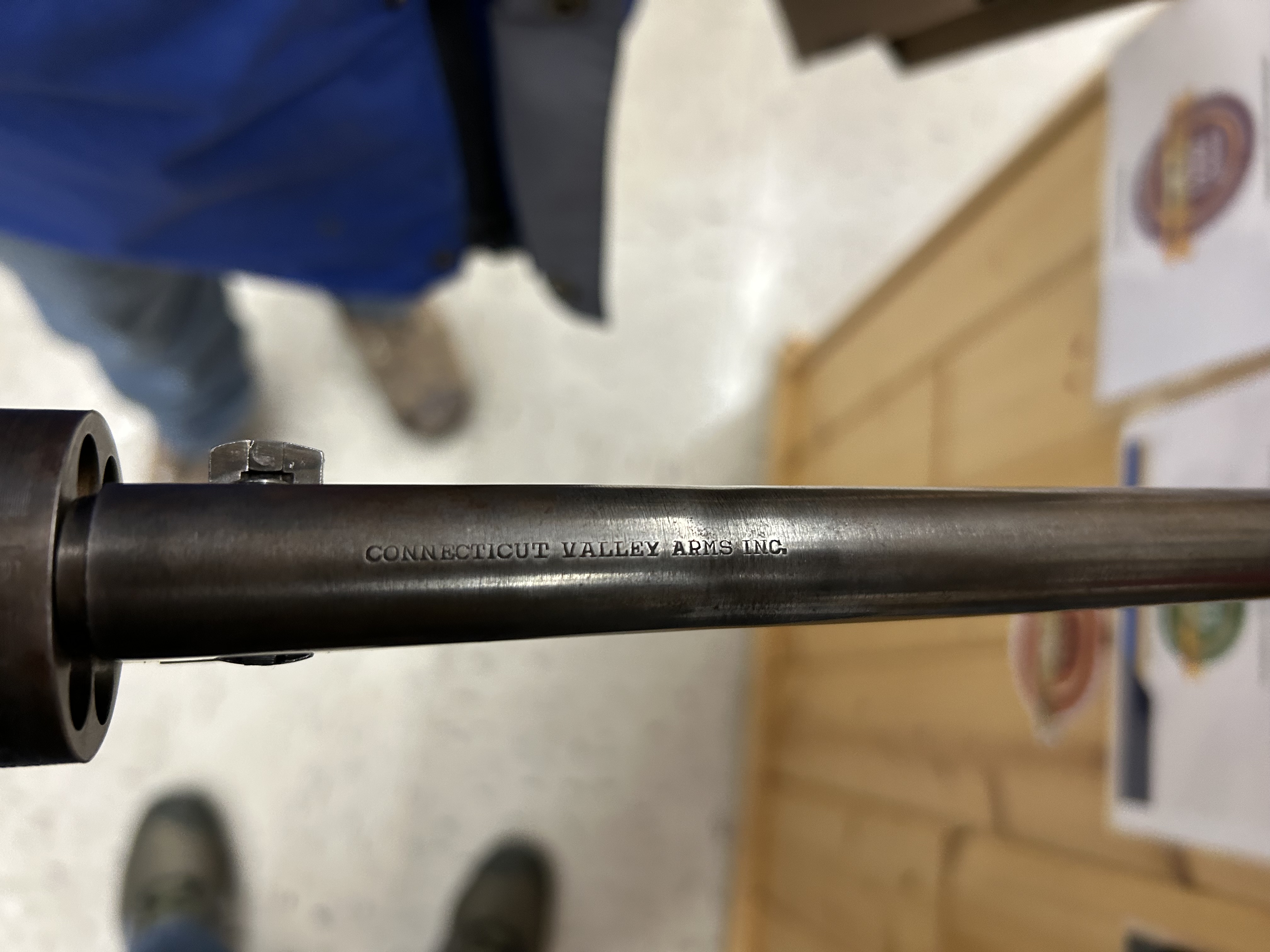

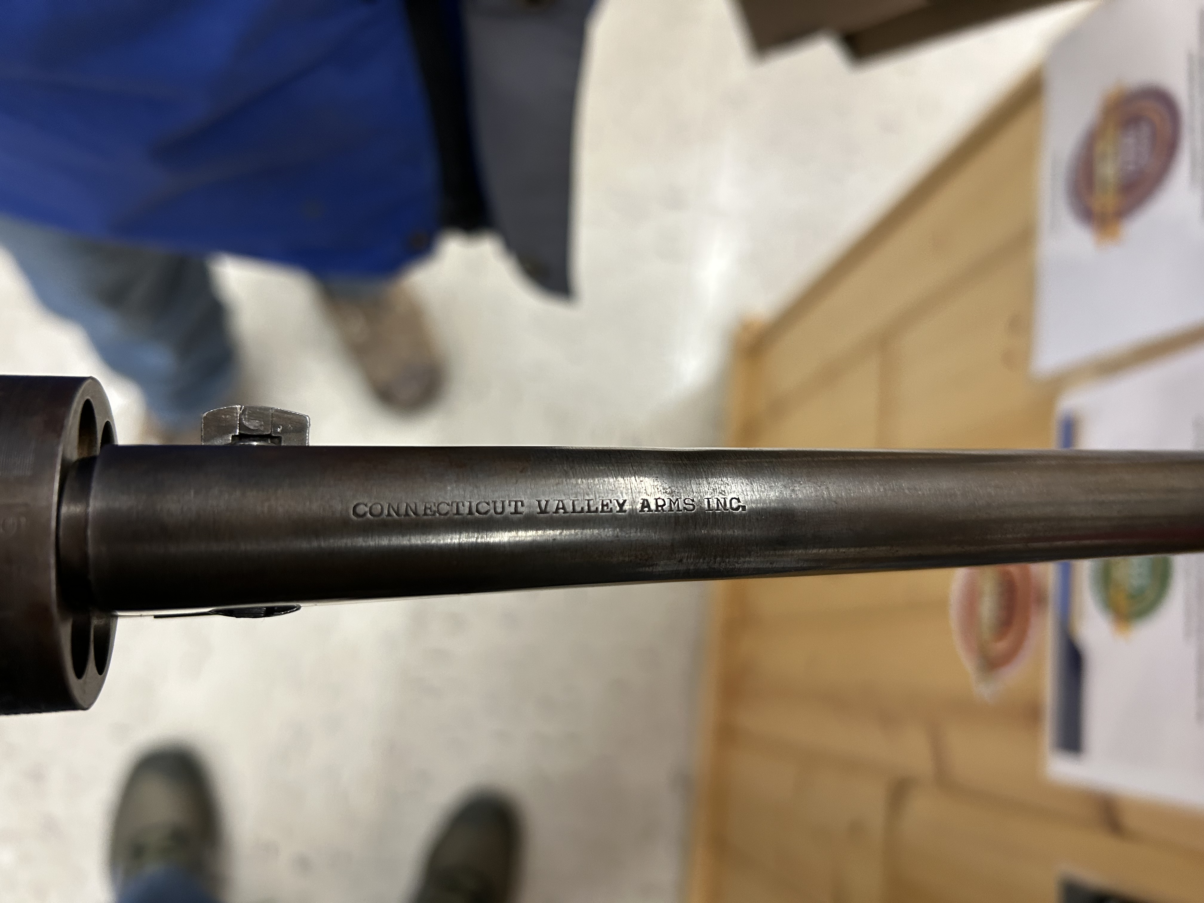

Friend says his dad got this at a sale a few years back, I think it is a Uberti, no caliber markings
Slug it? Measure the muzzle diameter or the cartridge holes in the cylinder ?

It’s a CVA.
Says so. Right on the barrel.

CPJ 2.0 wrote: Sat Nov 30, 2024 9:20 pm It’s a CVA.
And the frame.

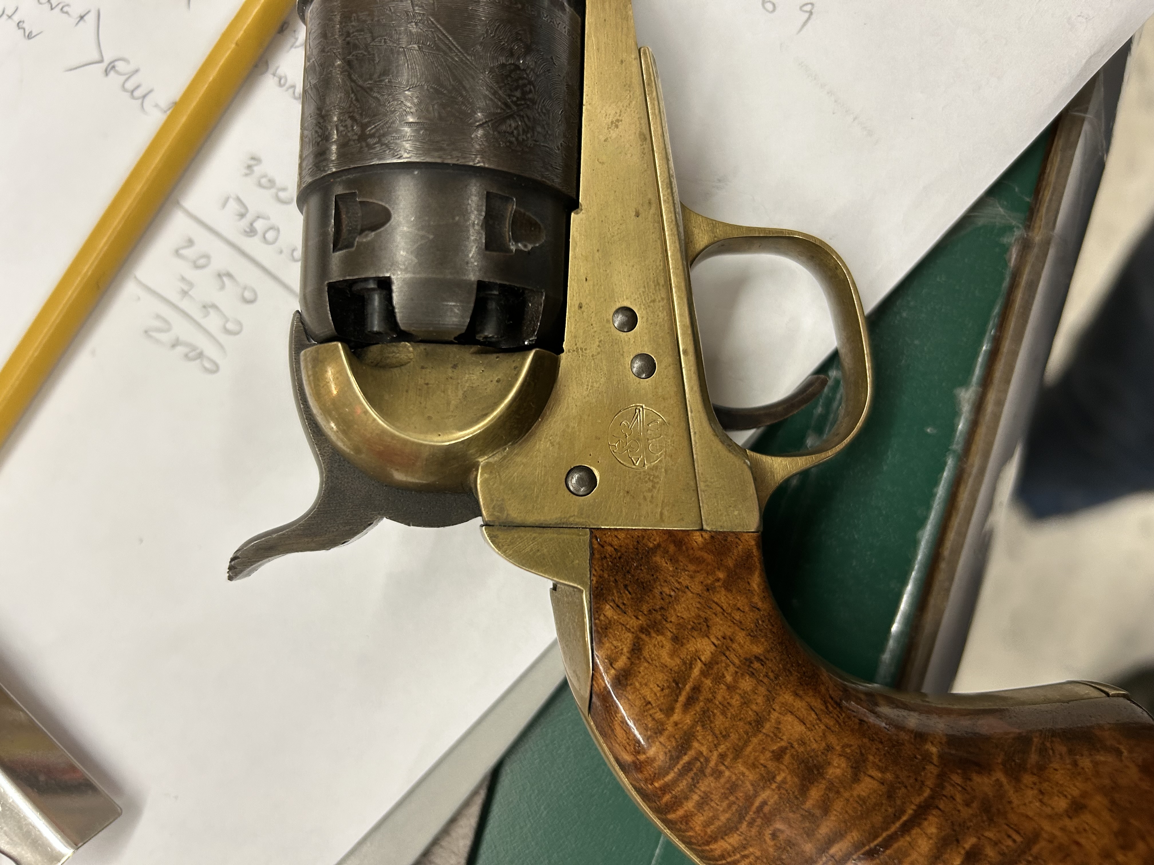

I'm guessing. 44, as that rebated cylinder seems pretty indicative of an 1860 Colt Army.

had one very similar years ago, also a CVA. It was 44 cal

See if it's got any markings under the loading lever. . .
But it's looking like a .44 1860 Army to me. Load with a .454 (ish) round ball & it'll shave off a ring of lead as you ram it home.
The 1861 Navy would have be a .36 and not have that thicker front section of the cylinder.

Most .44cal cap & ball revolvers use either a .451, .454, or .457dia pure lead round ball. Those are the most common. Measure the chamber with a caliper and use a lead ball about .005 over that. When you seat a proper size lead ball, a thin sliver of a ring should be shaved off the ball. Too small it will not seal and you have the danger of the ball moving under recoil, and a flash-over ignition. Too big it will be hard to seat. Use a grease like Crisco over the ball.
