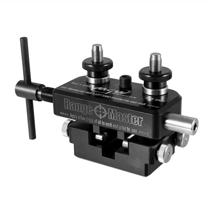

Many of Springfields front sights are centered up with a roll pin driven through them. Knock that out, pull the Allen screw from the rear, then drift out the sights to the shooters left. If you have a pusher, great, if not, brass rod.
