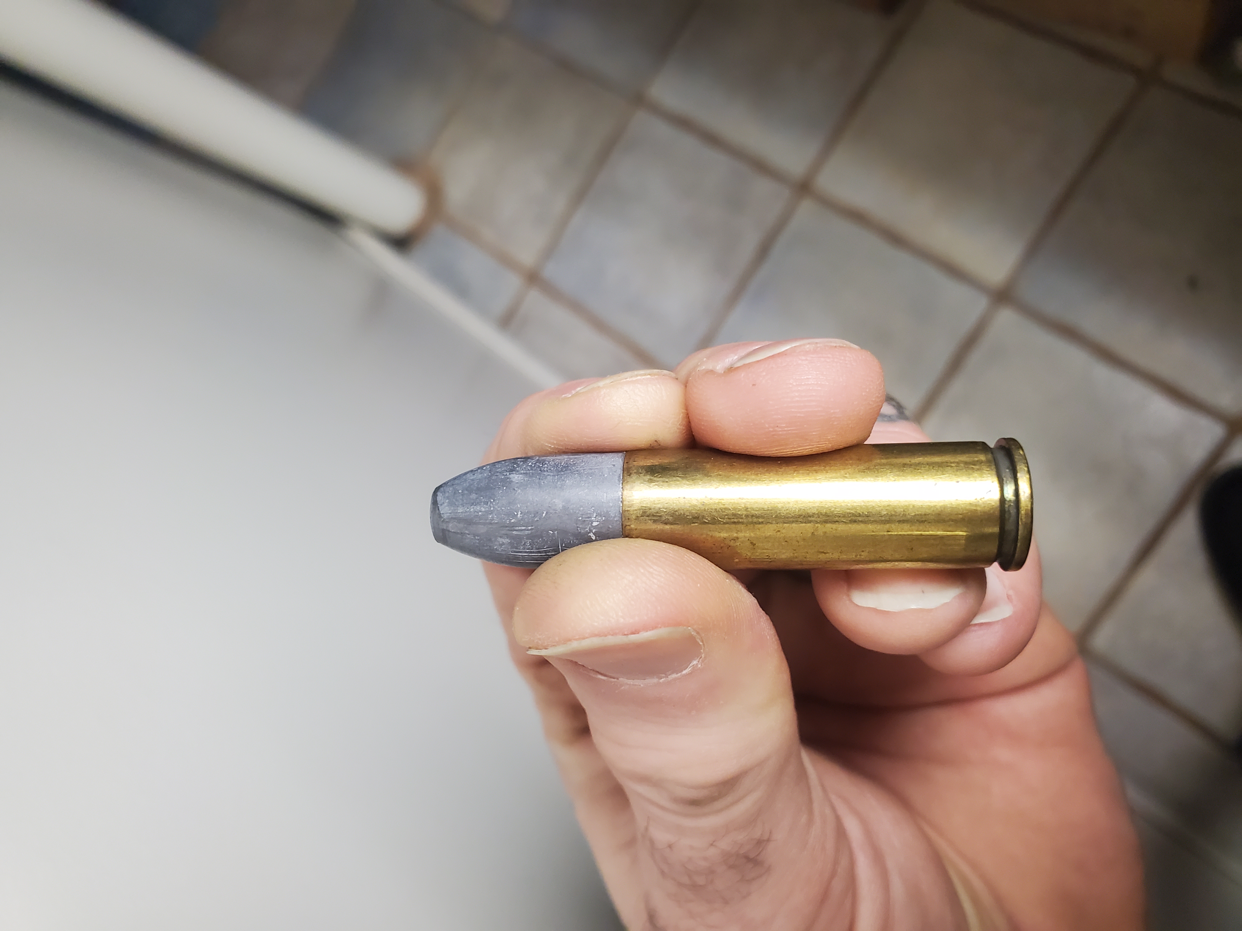

Dicking around again today. Made this with 500s&w brass. The bullet is just for show. I'd use the 404 grainers that GrapeApe linked to. With the 404 grainers, it'll hold 60 grains of FFF powder. So I guess a 50-60 pinfire it is Also found a wooden stock that I'll be able to cut and use instead of working one from scratch so now I can order my materials for the reciever with the width measurements.

NEAT!
That NOE mold of Grape Ape's looks like an upscaled copy of Keith's .45 Auto Rim bullet - the Ideal/Lyman 452423.
Lefaucheaux pinfire of the 1850's meets Elmer Keith bullet of the 1930's meets S&W X-frame brass of the 2000's. . .
