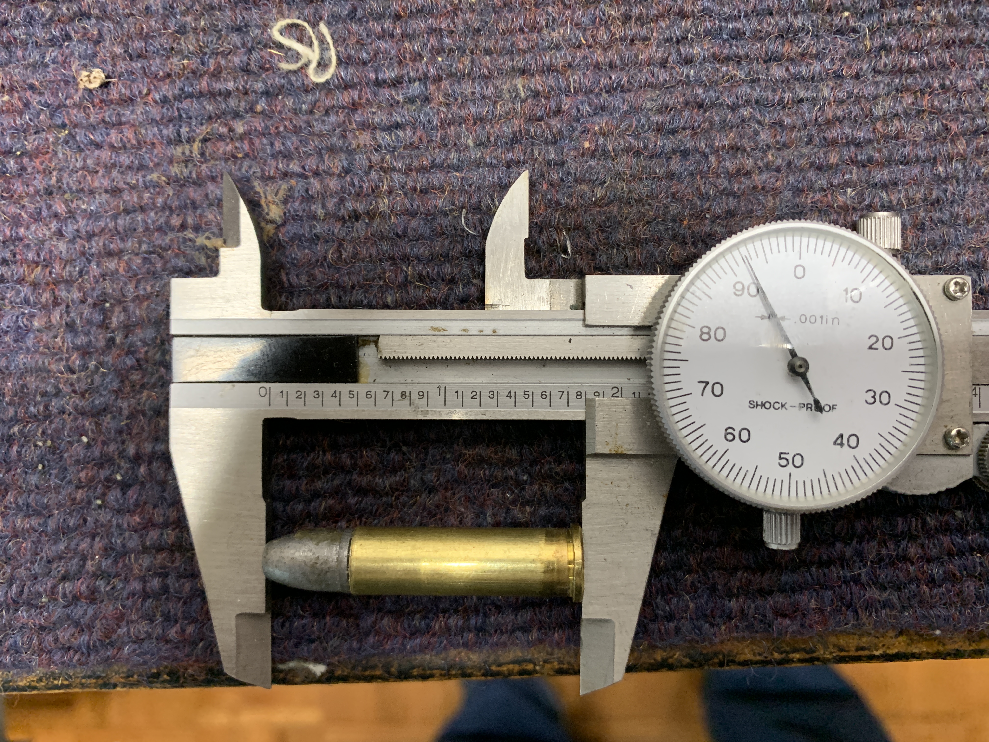

I've got a bunch of those oregon trails 180's as well. may have to try that 205 in a 38 case to see how it shoots.

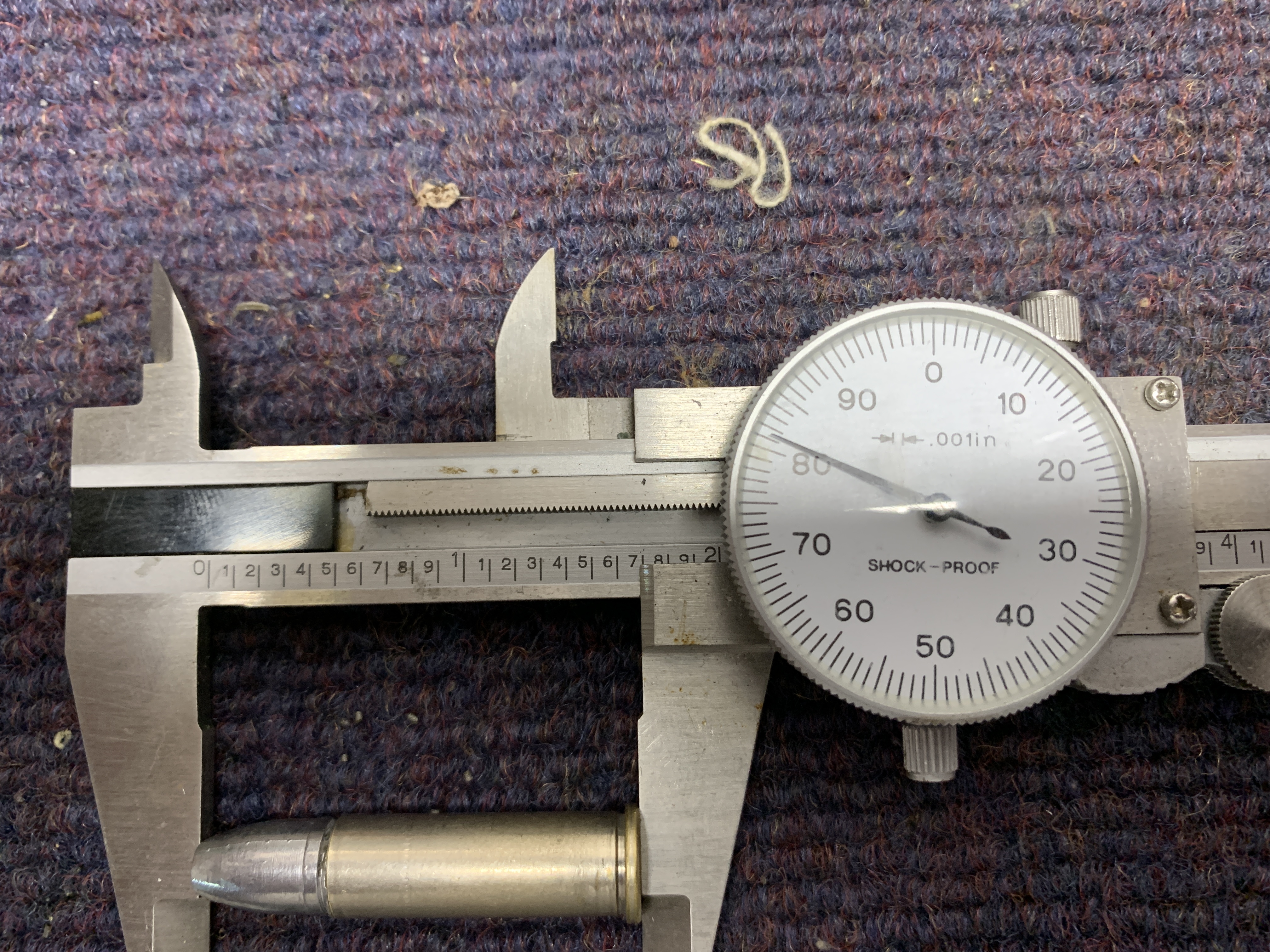

Re: A neat update on the Ruger Redhawk…
Same bullet in a 38 case.
Actually not the same bullet. That one is a 200gr plain base bullet.

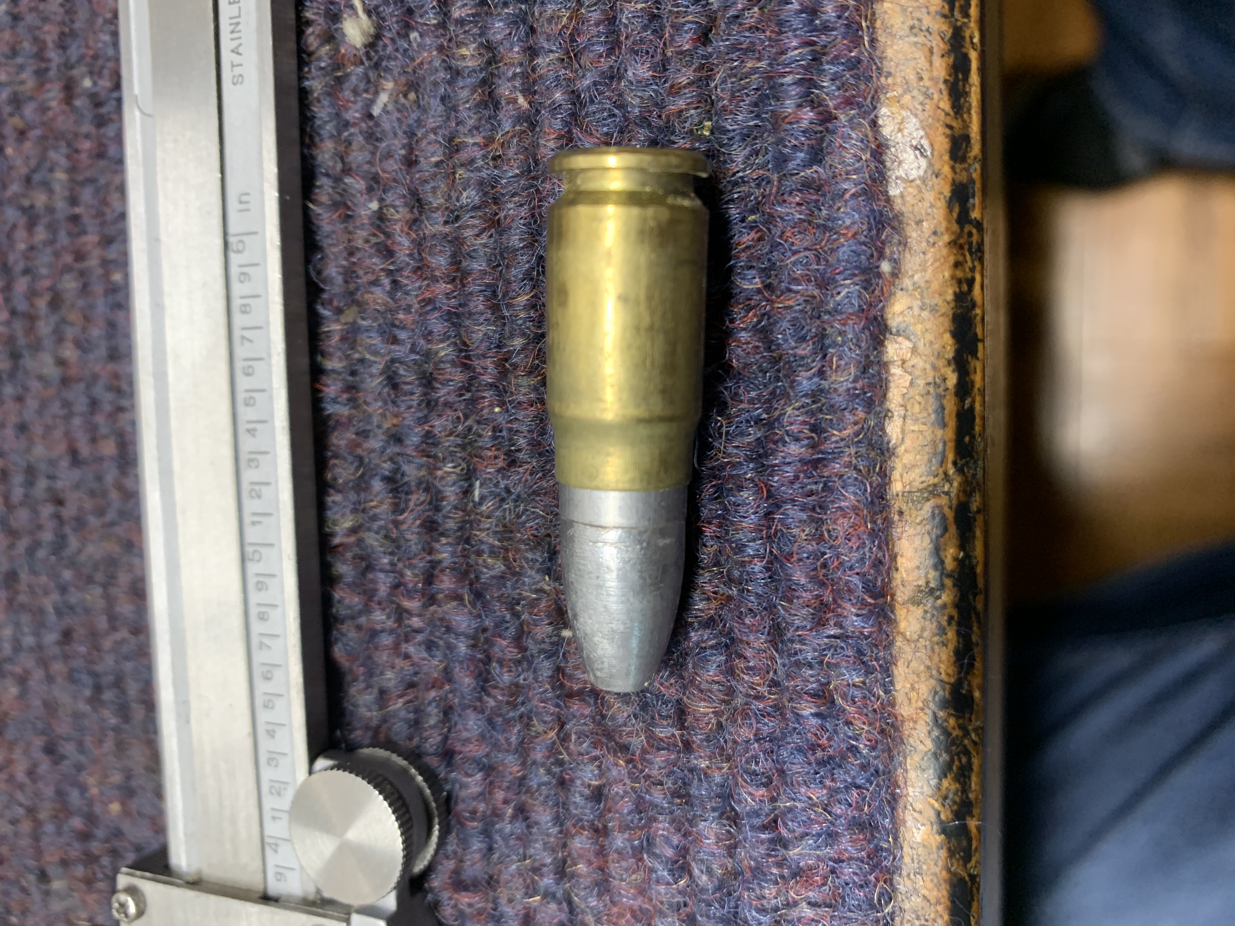

And just for giggles, a 357 Sig :lol:

I wonder how many water jugs that will penetrate 😁
Posts: 4107
sakodude wrote: Sun Feb 23, 2025 3:28 am IMG_2226.jpeg
OMG that looks like a a little ICBM 🤣

They will fit my Ruger Blackhawk in the 38 case. Guess I'm going to have to buy some 296 and experiment :o

sakodude wrote: Sun Feb 23, 2025 3:38 am They will fit my Ruger Blackhawk in the 38 case. Guess I'm going to have to buy some 296 and experiment :o
Be careful though, IIRC, 38spcl cases aren't made as strong as the magnum cases.
Posts: 1179
GrapeApe wrote: Sun Feb 23, 2025 4:20 am
Kinda depends. . .Starline says the only difference between their standard and +P .38 brass is the headstamp, and by extension, they also say the .357 is basically a lengthened version of the .38 Special. A lot of their business model operates around making "families" of cartridges that were/are identical in all respects but for overall length, such as .45-70, .45-90, .45-100, etc... The method for that is gonna be obvious - build them all with a case head for the hottest thing it might encounter, and just cut them off where you want the mouth to be.
I've read that some of the ammo factories have used a dedicated case for light wadcutter match loads that has a differing internal profile - presumably thinner walls farther back from the mouth to accommodate the 148 grainers seated fully inside the case. A cannelure around the case is the common indicator.
But more to the point - there is a time and place to load up with brass you scrounged at the range. The loads we are talking about on this thread are NOT it.
