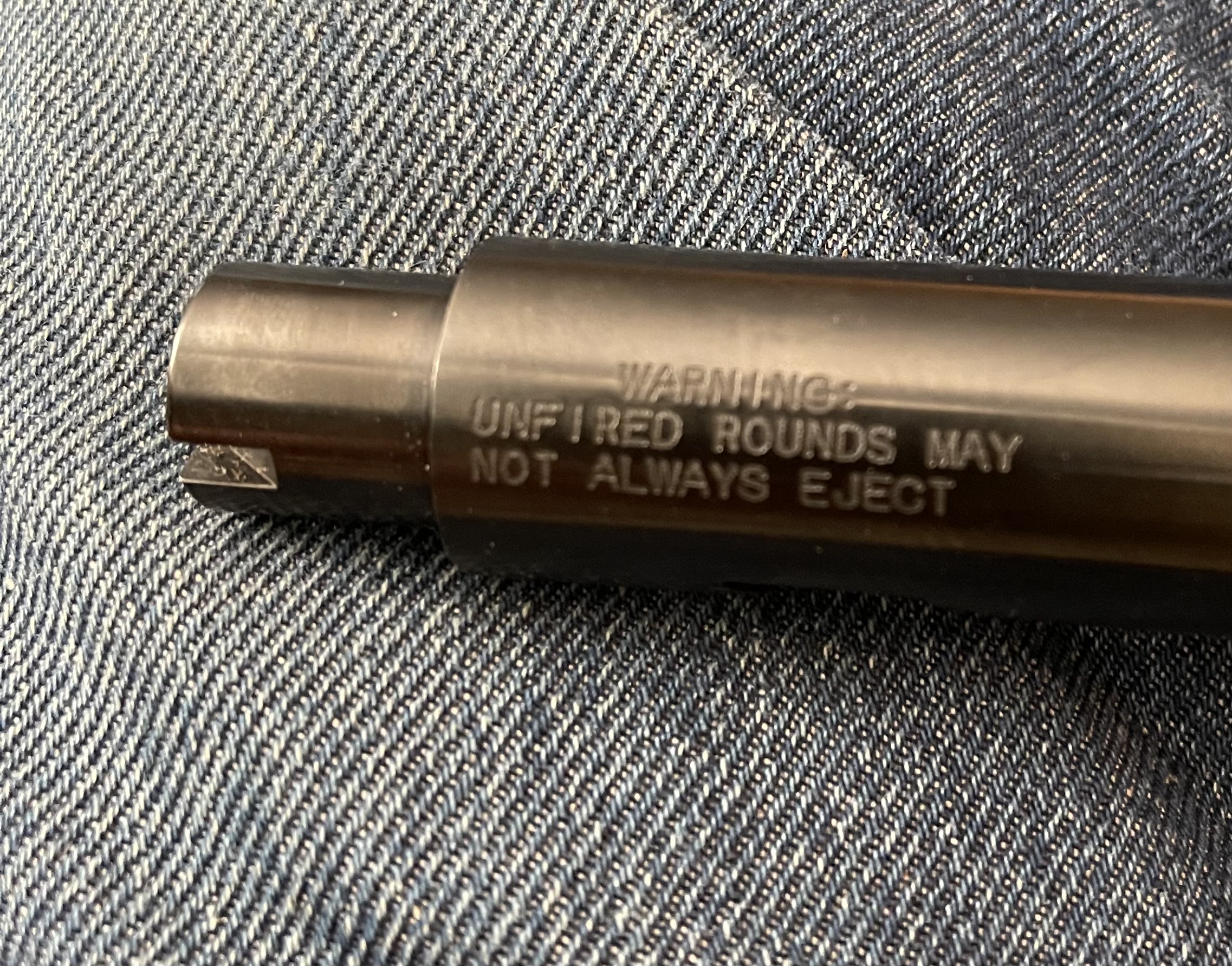

"WARNING: UNFIRED ROUNDS MAY NOT ALWAYS EJECT"
Seriously? WTF?
I wonder if the guys who work in nuclear power plants have to deal with warning labels stating that the shielding protecting them from plutonium might expose them to lead. :roll:

I'm guessing it has a Bentz chamber, which is slightly shorter that SAAMI spec

Bigslug wrote: ↑Sat May 24, 2025 3:03 pm "WARNING: UNFIRED ROUNDS MAY NOT ALWAYS EJECT"
Seriously? WTF?
Has nothing to do with safety warnings. It’s just a fact. It’s a tight match chamber.
They also won’t shoot CCI Stingers because eve case is longer.
Seriously? WTF?
Yes Bentz chamber, it’s tight.

I'm well familiar with match chambers but that would drive me nuts. I'd be reaming that out to a standard chamber if it were mine.
There's a few manufacturers (Walther comes ro mind) that have European cut chambers. Apparently their 22lr is a bit smaller and those guns hardly function with our ammo until the chamber is reamed out. I actually just did a P22 a week or so ago now that I think about it.

My Magnum Research barrel wouldn't eject rounds until I put in a Volquartsen Sharp Edge extractor. 100% now.....
