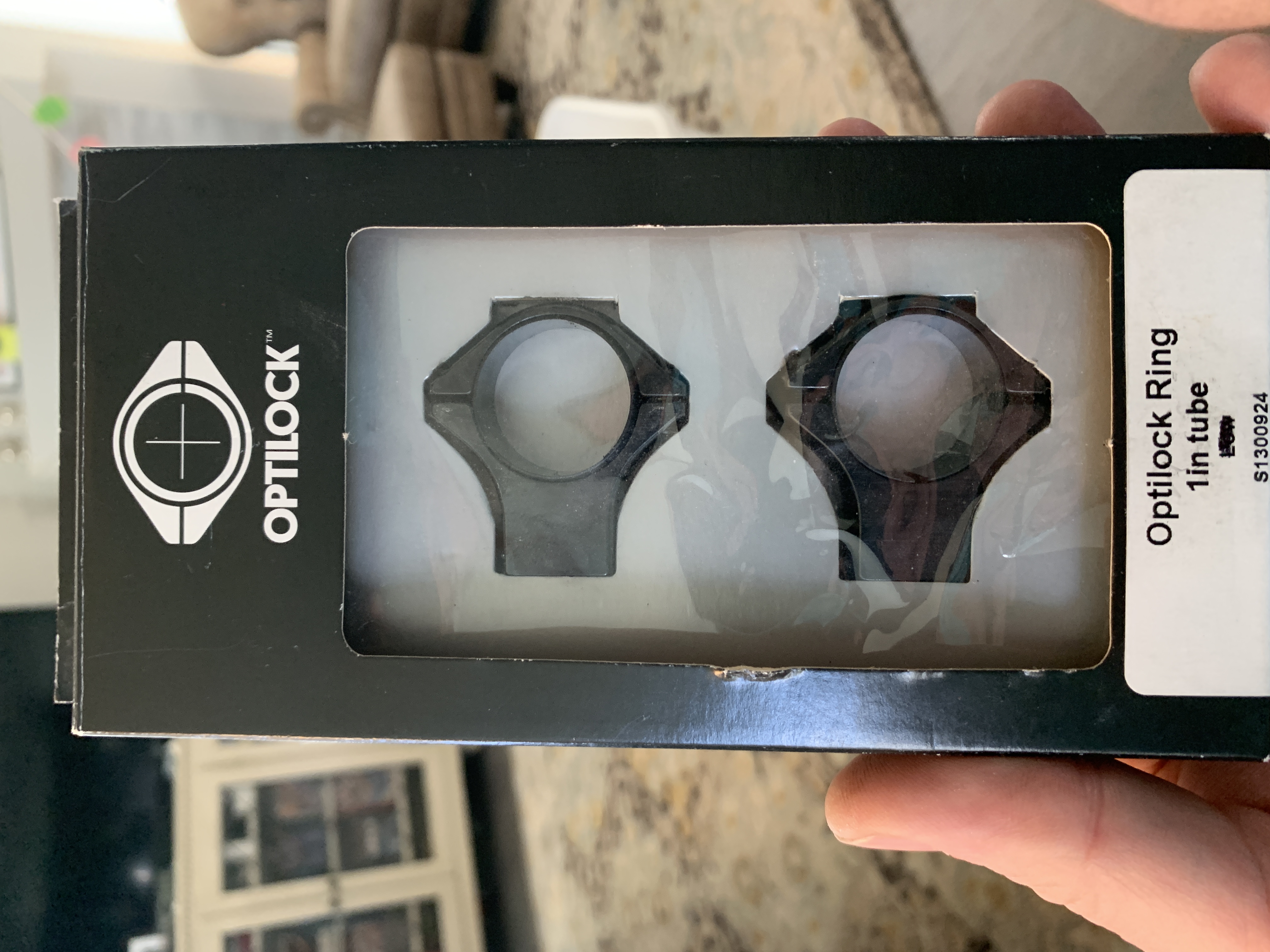

These were on a 7mm I had some years ago. If you can use them, they are yours. thought I had the bases as well but can't find them.
No idea if they are any lighter than th QD you had but thought I'd offer.

sakodude wrote: ↑Sun Jun 22, 2025 12:44 am IMG_2306.jpeg
If you can use them they are your.
Are those bases and rings or just rings? And how high are they? I think I need a medium height as I have a Zeiss 3x15x42. If those will work for me, I'd gladly take them. If you want the EAW 1" quick release mounts you can have them, I understand they're pretty expensive but I have no use for them.
Posts: 899
Re: Sako AV scope mounts.
Went back and edited the post, no bases but they are available on amazon I see. Rough measurement is 0.610 without taking the centering insert out.

Sako, I appreciate the offer but I finally figured out what will work. After some questions on the Sako collectors forum, it appears CPJ was mostly right about most models being similar. I actually spoke with Leupold, Talley, Sportsmans Warehouse, Brownells, and Midway and they all appeared to be reading from a chart that listed which mounts were required for which models and they were all inaccurate. Talley gave the best info of all of them but they were still off a little. In spite of the guy at Leupold telling me that they don't list anything for a Sako AV, I'm going with the Leupold ringmounts as they're simpler and weigh less than half of the EAW mounts that I have.
Posts: 899
No worries, glad you worked it out. those rings were just collecting dust.
