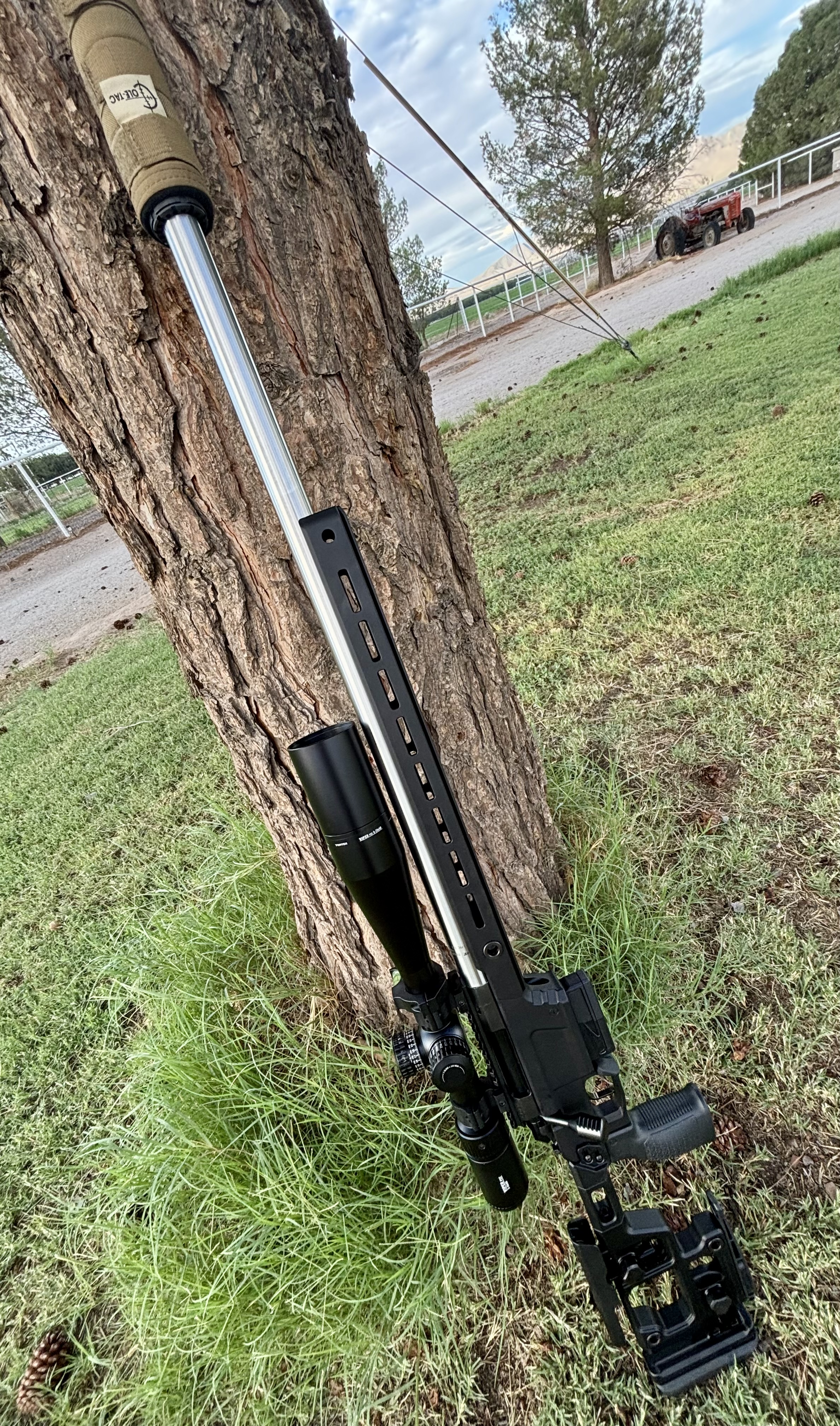

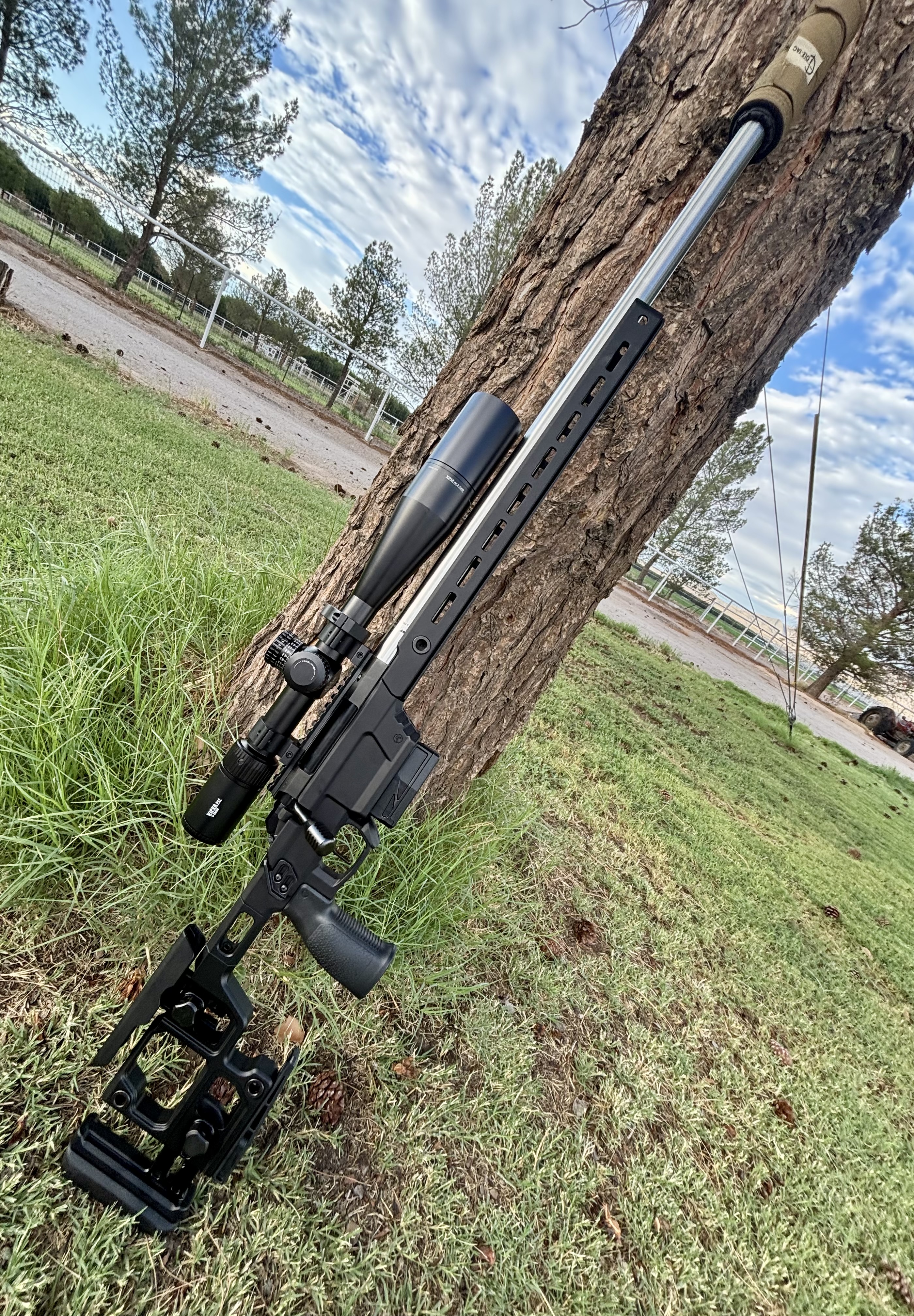

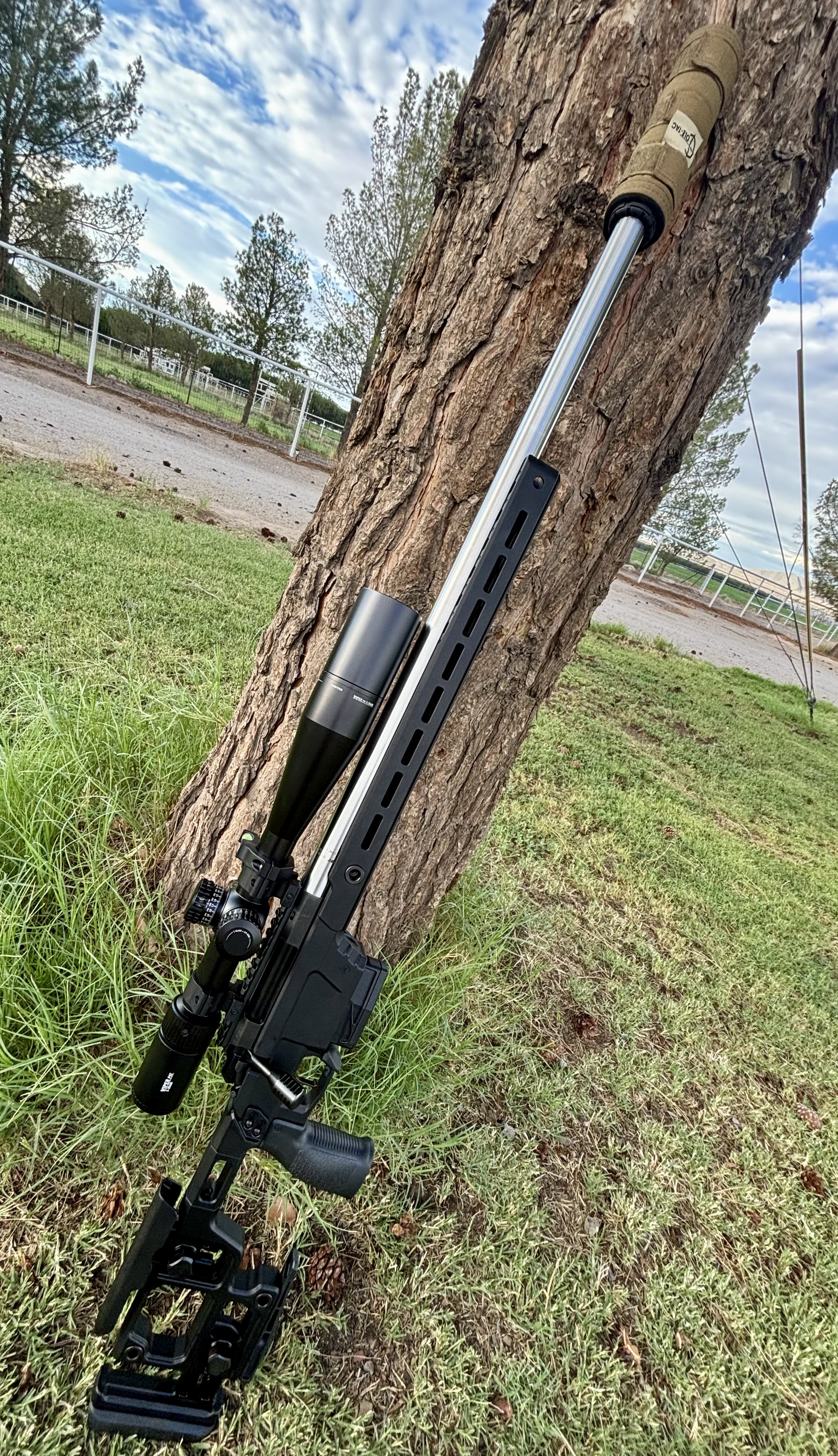

The Big Beautiful Retirement rifle is complete.
Jay
Posts: 413
Re: New project underway
Post by Jay »
Quick rundown of the final build, to recap;
Aero Precision Solus action.
Aero Precision Competition chassis
Proof Research Competition profile barrel (1.25” shank, just over 1” at the muzzle), 26” in 6.5 PRC
Trigger Tech Primary trigger. Set at 1.5 pounds. Not the greatest, but it feels very nice.
Vortex Viper PST gen 2, FFP, 5-25x50 on Leupold rings. I’ll probably change to a better mount later. This will do for load work.
Also wearing a SilencerCo Harvester EVO
Final weight was a bit lighter than I calculated using internet specs. It came out to 17 pounds, 7 ounces with the suppressor and empty mag.
Still need to check headspace and get components for making ammo. To be continued…

It’s not difficult to put the action on the barrel. I did buy the Solus action wrench. Just clamp the barrel in a barrel vise, put some anti seize on the threads, screw the action to the barrel and use the action wrench to torque it. The barrel is supposed to be machined to be pre fit to these actions. So headspace is set. I still want to check it with headspace gauges, just to be sure.
