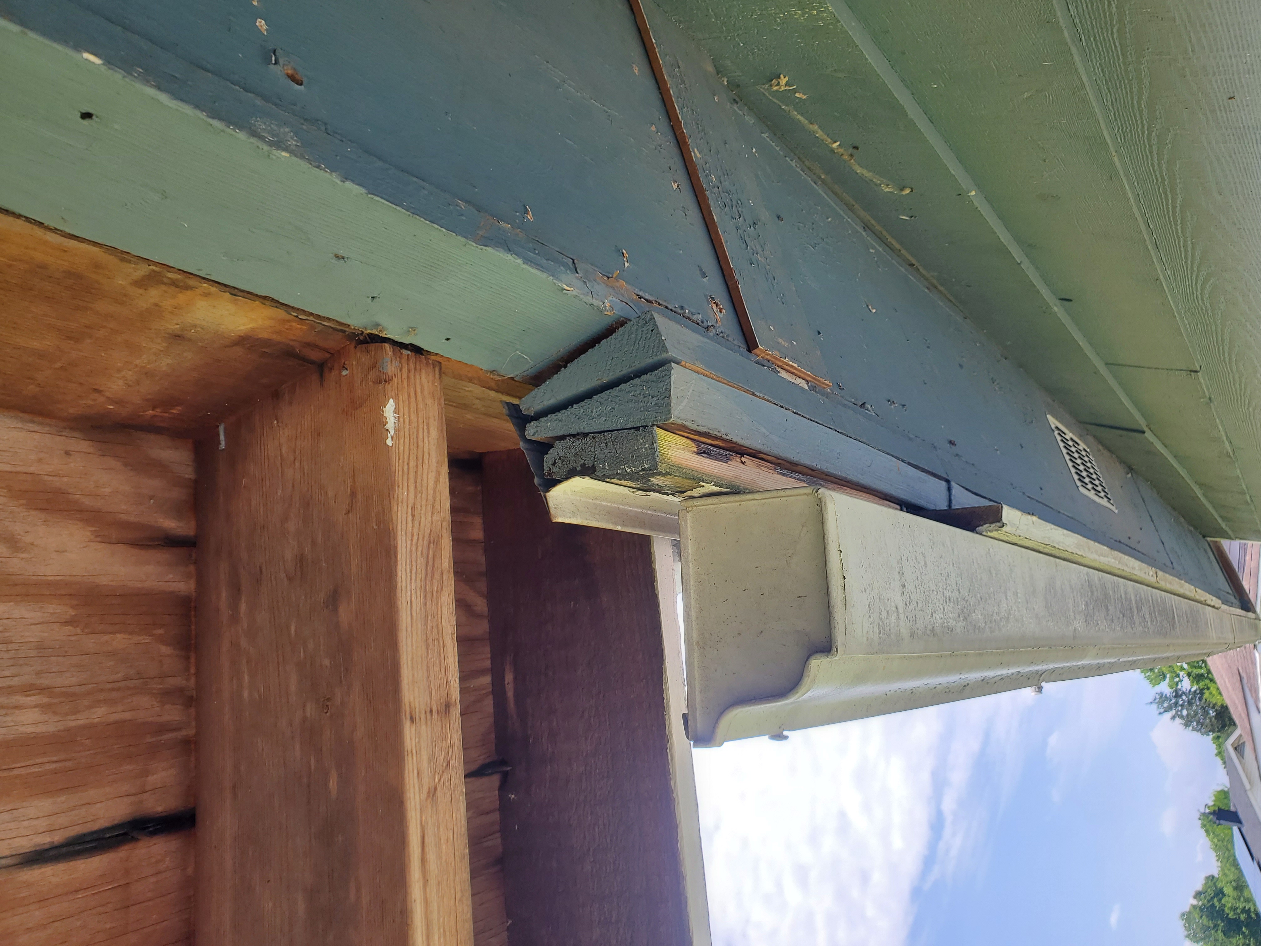

Let me first preface by saying that I'm not Bob Villa, and that the siding is the same color blue as the eaves so I'm not sure why it looks two toned.
Anyhow, the poop that we bought the house from who was the same DIYer that did the deck also did the siding, roof, gutters and wrap around porch. The house gets hotter than it should and it took me a while to realize the AC is doing what it should but the attic can't breathe because it's not vented at all. He covered all of the soffits with no vents, removed the gable vent and according to my neighbors house, only has 2 of 4 vents on the roof peak (can't think of proper term). Basically the attic is hotter than Satan's butthole and it heat soaks into the rooms below. I plan on fixing the eaves/soffits the right way but for now I'm just putting the vents in them and got to looking at his handy work on the gutters. Can anyone explain why in the hell he used three triangular cuts of board on the fascia boards? Maybe to get them perpendicular to the ground for the gutters because they are angled without them? And if so, is it normal for the fascia boards to sit on an angle and the gutters just rely on the long nails to keep them straight? I sincerely have no idea. It just looks like absolute dog shìt.

Not sure what code is for your area but there should be a whole lot more venting than that little square. Probably should also have a ridge vent. Surprised the inspector didn't point that out when you purchased the house.

My Father in law used to call that "N" riggin'. And by the way those joists should probably be hung in metal brackets too. Looks like a really bad DYI job.

It's gonna get 12 of those vents, and yes the ridge vents is what he only installed 2 instead of 4. I couldn't remember the name for them. Ironically I never got a home inspection because I got burned on the first one I got for my first house. The guy pencil whipped his clipboard and missed everything so I assumed that's how they all went.

EVERYTHING the guy did is/was just like this.Wambli Ska wrote: ↑Mon Jul 07, 2025 6:24 pm My Father in law used to call that "N" riggin'. And by the way those joists should probably be hung in metal brackets too. Looks like a really bad DYI job.

That joist thing sucks because if they are not on brackets normal movement/flexing from wind etc will constantly open up the nail holes until they just slip out and THEN you'll have a BIG problem.
The good news is that brackets are cheap and you can slip them over the BS nailing job he did and stiffen up the whole thing to avowing an issue down the line. Some bracing pieces between the joists would be a good idea too and easy/cheap to do.

Those rafter tails were cut square to the rafter and not plumb to the ground. In other words the rafter tail has a back pitch to the house. Those boards were added to keep the gutter straight up and down, not pitched back to the house. The easiest way to repair this would be to screw a short tail with the correct pitch to the rafter tails. That means removing all the soffit which may not be a bad idea considering the lack of ventilation.
The other way would be to start all over with a new roof. Remove the soffit, cut the rafter tails correctly, add roof ridge vents and soffit vents with the correct vent inserts to prevent insulation from clogging the vents.

There shouldnt be ridge vents, there should be a ridge vent. Everything but about a foot on each end. Just had my junk metal one replaced along with the roof (20 years and done) Opened up the hole and put a ventsure sky runner https://www.homedepot.com/p/Owens-Corni ... /301902702
Selling point was its whats on the roofers house.
More air the better so as many soffit vents as you can fit.

He didn't cut those boards. They are just scrap he used to replace the original wood that probably rotted.
If there are any gable vents. Put a fan with a thermostat in it.

What sort of insulation in attic space? Proper venting is important but if not well insulated it's a losing battle.

Definitely planning on installing one of these. Do they come with a standard "On" temperature for the thermostat or is it adjustable? I honestly have no experience with this kind of stuff. I think that alone with the vents I'm installing will make a drastic difference.
The attic is insulated very well which means he must not have messed with it lol. It's cellulose insulation.
