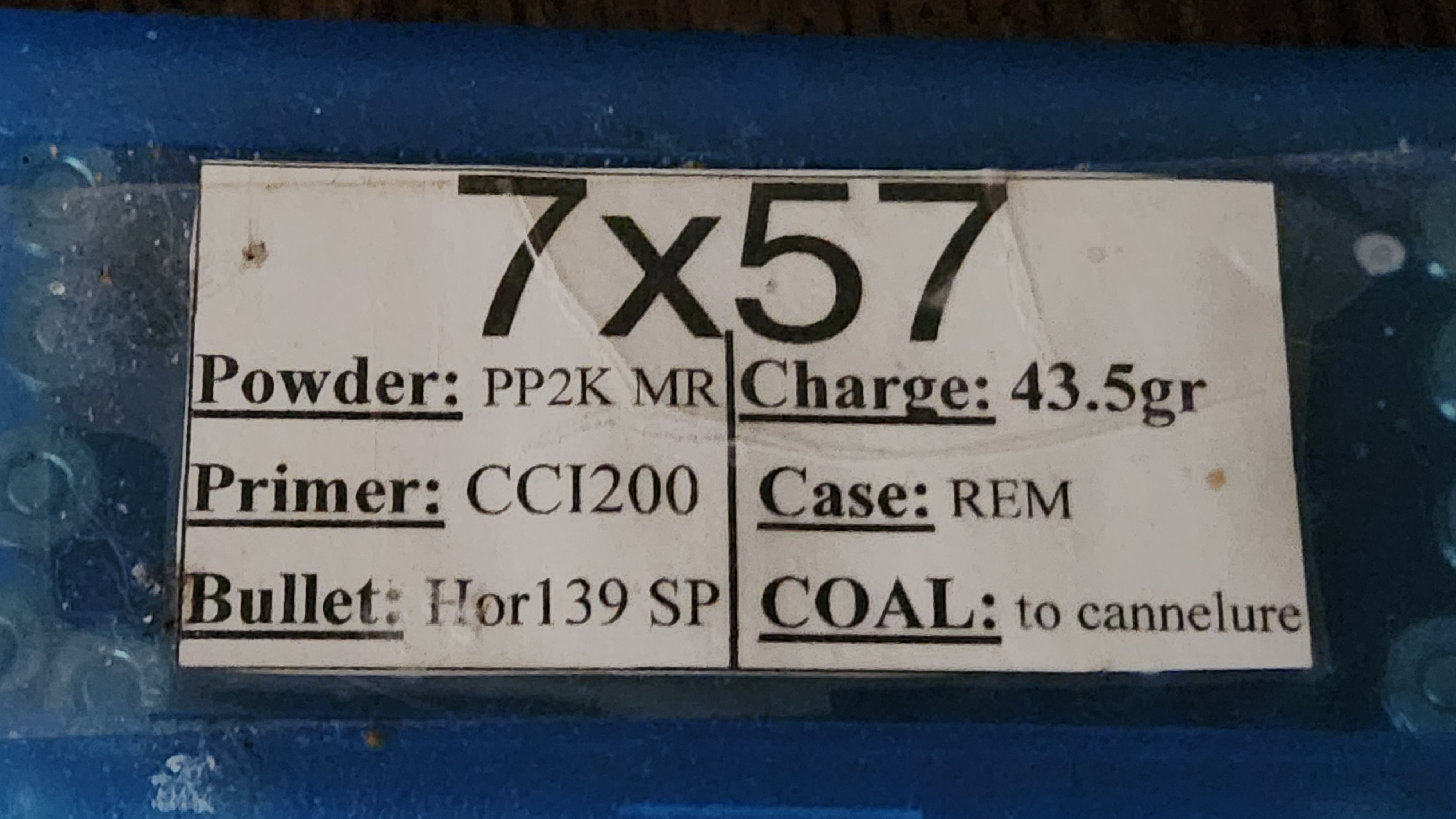

I print "label" on regular paper and then tape it to the top of the box with 2" tape.
Here's the first box I had handy for a pic.
It doesn't list the velocity. I normally do that for subs and suppers w/ 300bo and if they're loaded for the 8.5 or 16"
I use some abbreviations. PP2KMR IS Power Pro-2000MR

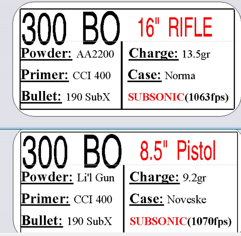

Here's how I differentiate loads for different firearms.
If you notice, average MV is only 7fps different between them, in their respective barrel length. The Noveske brass for the 8.5" is "Black Nickel" while the 16 incher's Norma is "regular" brass. So I have an OBVIOUS visual cue which load is for what bbl length, if I just find a mag loaded with the Sub-X 300BO.

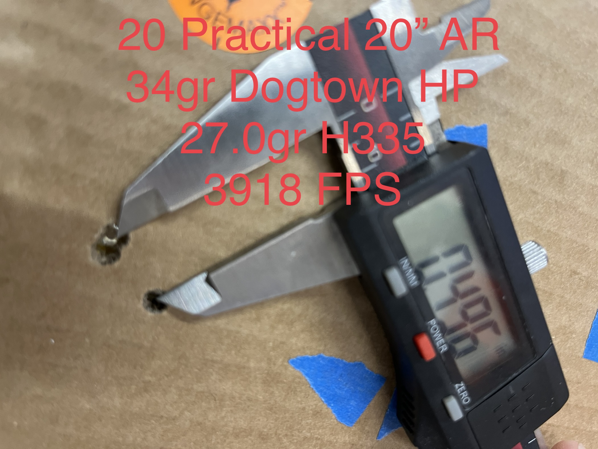

I keep a note pad for load work. I measure new brass to the datum point and measure after firing so I know where the shoulder went and how much I want to bump it back on the next load. I also measure seating depth to the ogive. Once I’ve found a load that I want to stay with, I use my own load data tags in my ammo boxes that contain all the info I need to recreate that load.
I’ve also went digital on load work. I used to cut out the groups on my target, measure them and save them in a binder with their data. My phone does that for me now.
