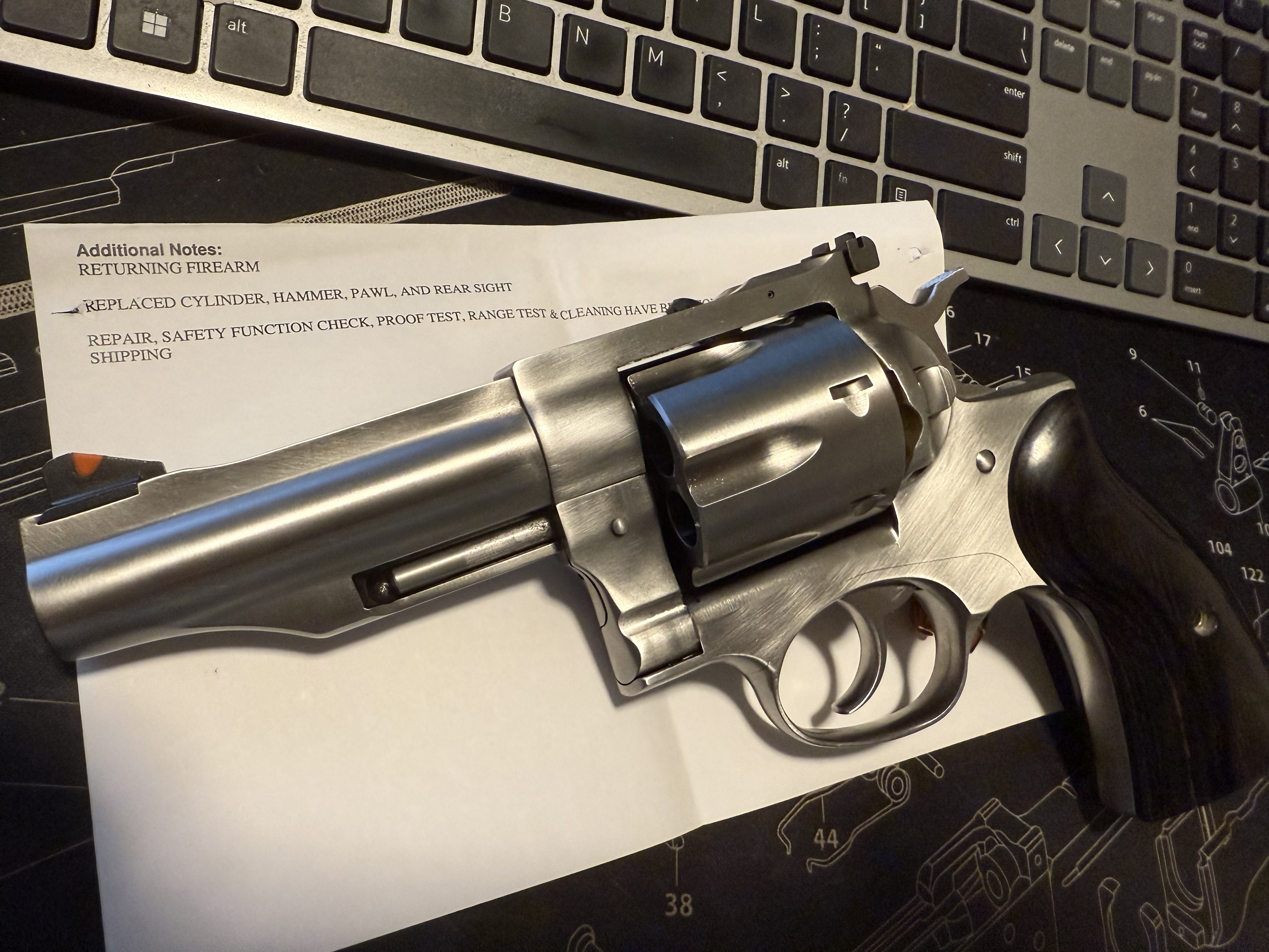

Been shooting the blue SP-101 a bit, and got tired of the sticky extraction on factory loads. Finally called Ruger after doing some research online and finding that it’s a bit of a “known issue” with the .327s. So, when I was on the line with Ruger’s CS, I mentioned my Redhawk was having a weird issue with the trigger and hammer locking up periodically. The super nice Dude sent me a label, worked up two RMAs and had me ship them in. They are going to FedEx today, and we will see what is done and how fast.

The Redhawk made its way home yesterday. Ruger replaced the Hammer, cylinder, pawl and for some reason- the rear sight.
I have to say that this thing has a SWEET (for a ruger) trigger now. Very smooth DA with just a slight bump before the break where you can stage the trigger. I’ll try and get to the tangs next week and test it

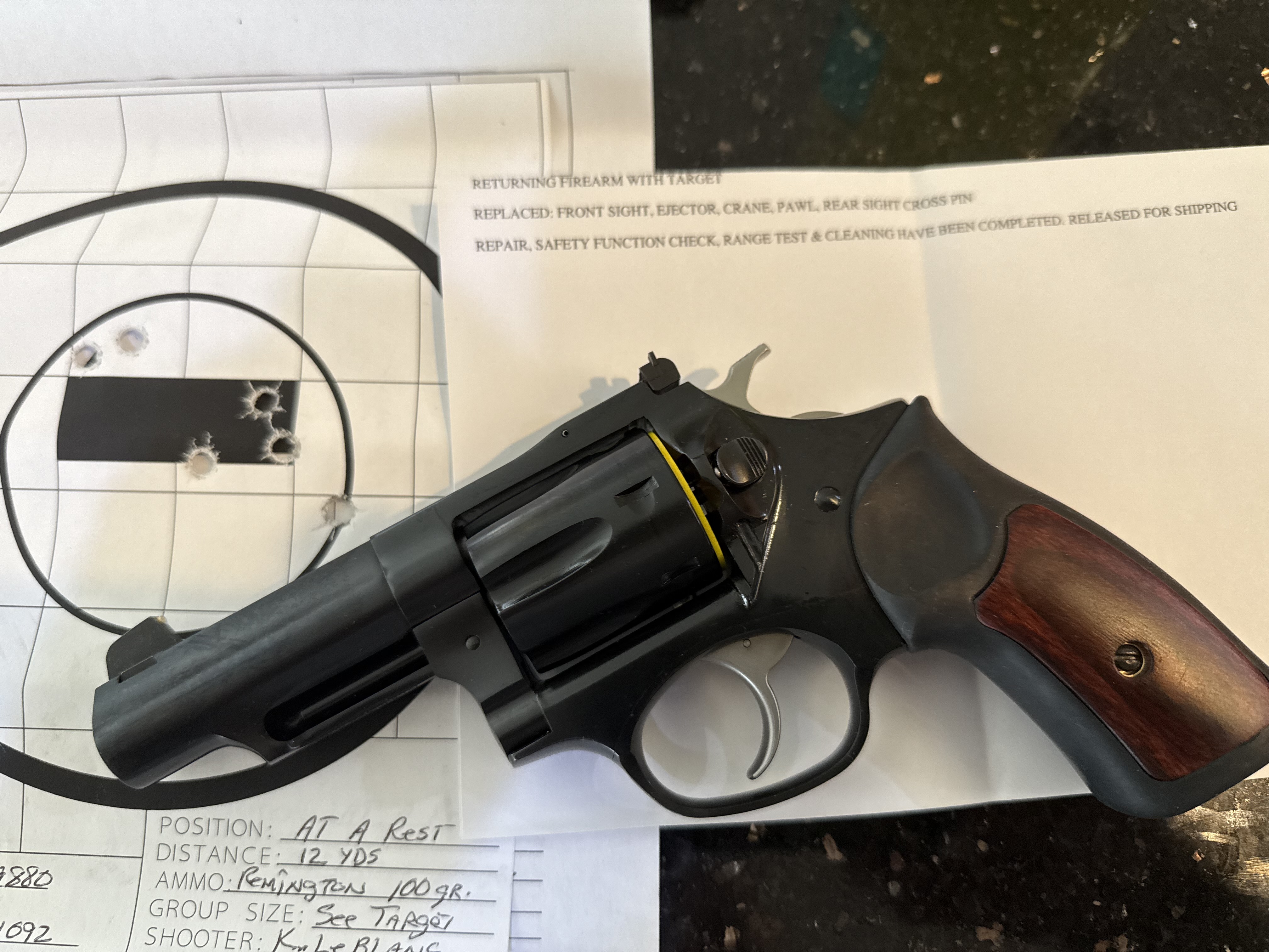

The SP101 has not made it yet. Got an email that work has been completed, but no tracking yet

Look what just came home!
