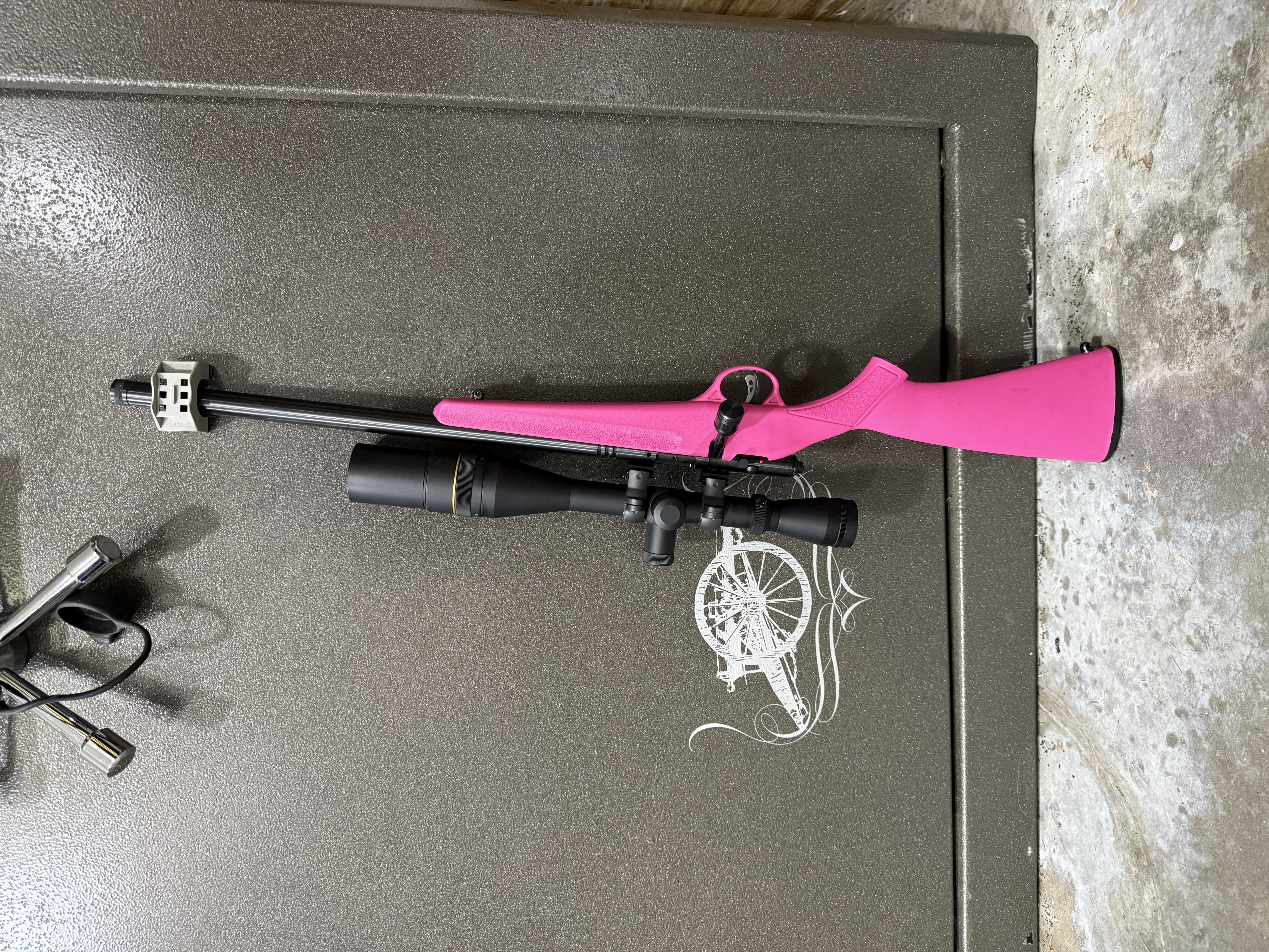

I’ve seen these Savage Rascals for years. Always wanted one. Why did I want a single shot kids rifle? Dunno. Just did. I saw the heavy barrel version with a fatass bolt handle while out in Utah last week. Hmmm. $325. Naw. Don’t want it that bad.
The regular barreled ones are around $180.
Do a little looking around, ordered one from a local LGS and it was like $175. Seems REALLY cheap compared to the one in Utah. Overheard one of the owners saying they lost money on this one, they had it priced wrong. They weren’t mad, and didn’t say anything to me. Cool.
Anyway, it’s got an accutrigger that came adjusted at 2.5 pounds. Low as it goes. I’ll address that. Add some trigger shims to remove some side play. And a few other tweaks. Eventually it will be put in a chassis. I’ve got some ideas for a different twist on the “traditional” chassis. Being a single shot makes that process easier, no mag to deal with.
Scope choice? VX-2 6-18 with stupid super fine invisible to old man eyes crosshairs. Why? Why not!? Actually I’m doing some scope swapping and figured this would be perfect what for testing this rifle.
As to the color? The stocks going anyway, and it happened to be the cheapest color. 😬
I’m still half tempted to get one of the regular barreled versions to make an ultralight pack rifle.

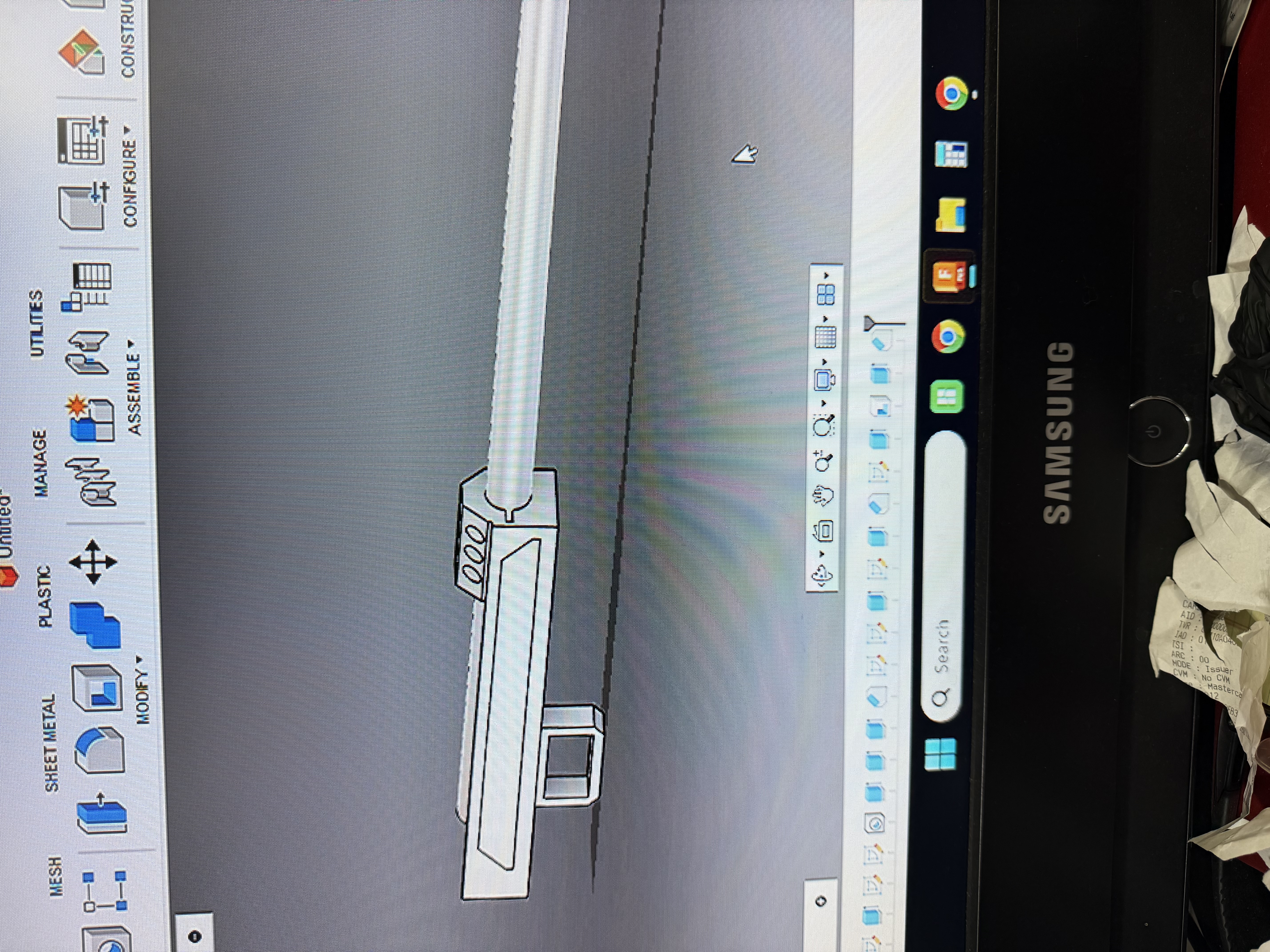

Then throw it in the chassis. Which, my original idea…I think I can still make work but there’s a single shot follower that wraps under the bottom of the action, and under part of the barrel. I’ve got an idea, but need to measure.

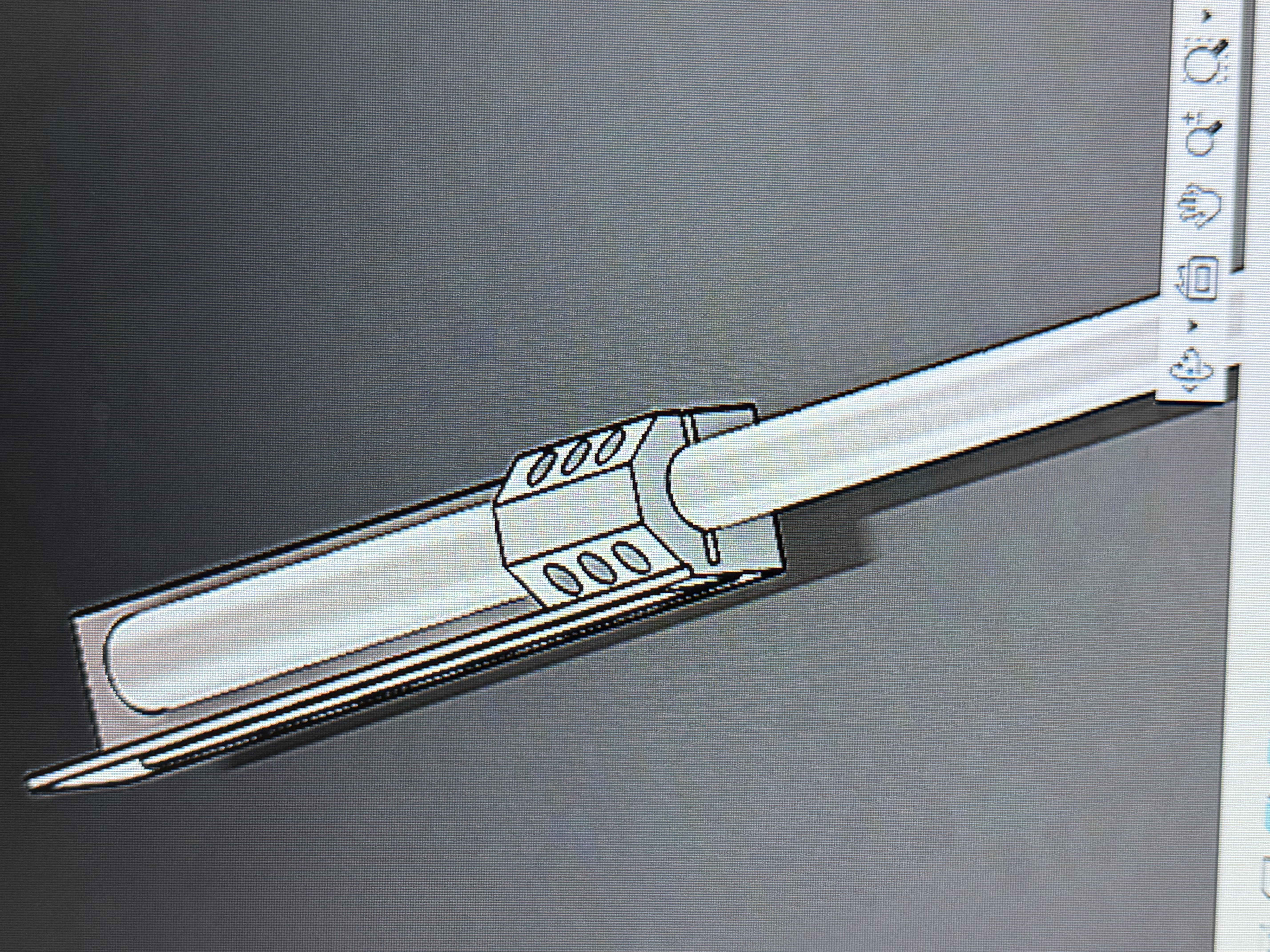

EXTREMELY rough idea of what I’m thinking, I was farting around getting ideas. . Clamps on the barrel thereby floating the barrel and action. I’ve seen it on some bench guns.

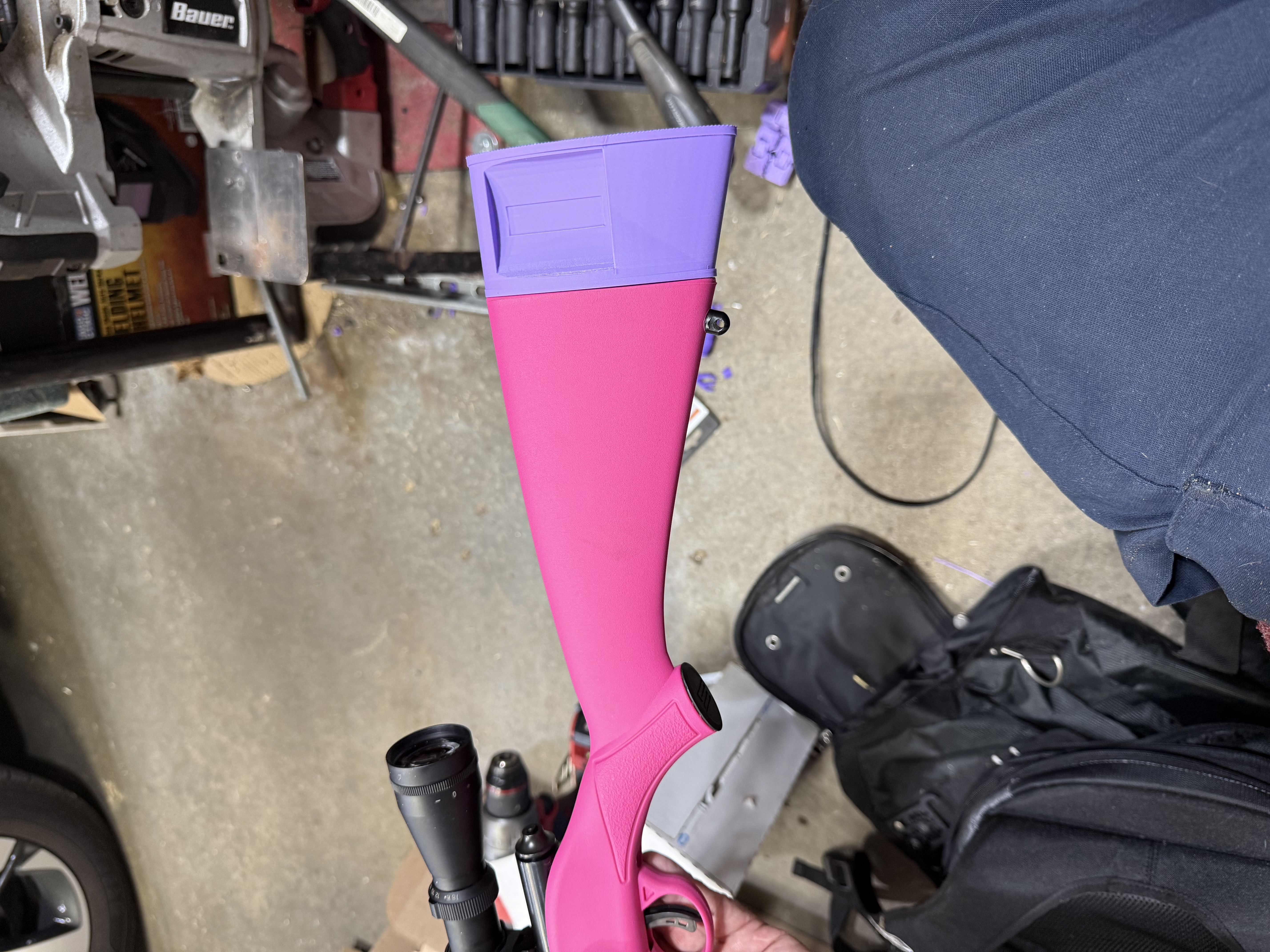

I need to put an extension on the stock.
Posts: 4303
Re: New .22.
Well.
That will be easy.

Using purple.
Why? I’ve got two rolls, and one is currently installed in the printer.

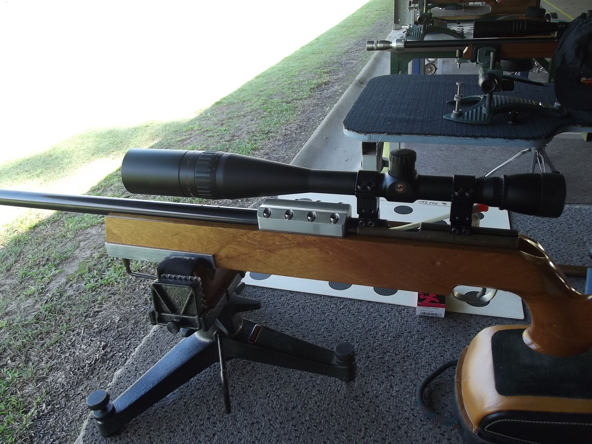

Are these things a clamp-in barrel? Seems like that .21 Sharp concept could be explored for. . .I don't know. . .reasons.
