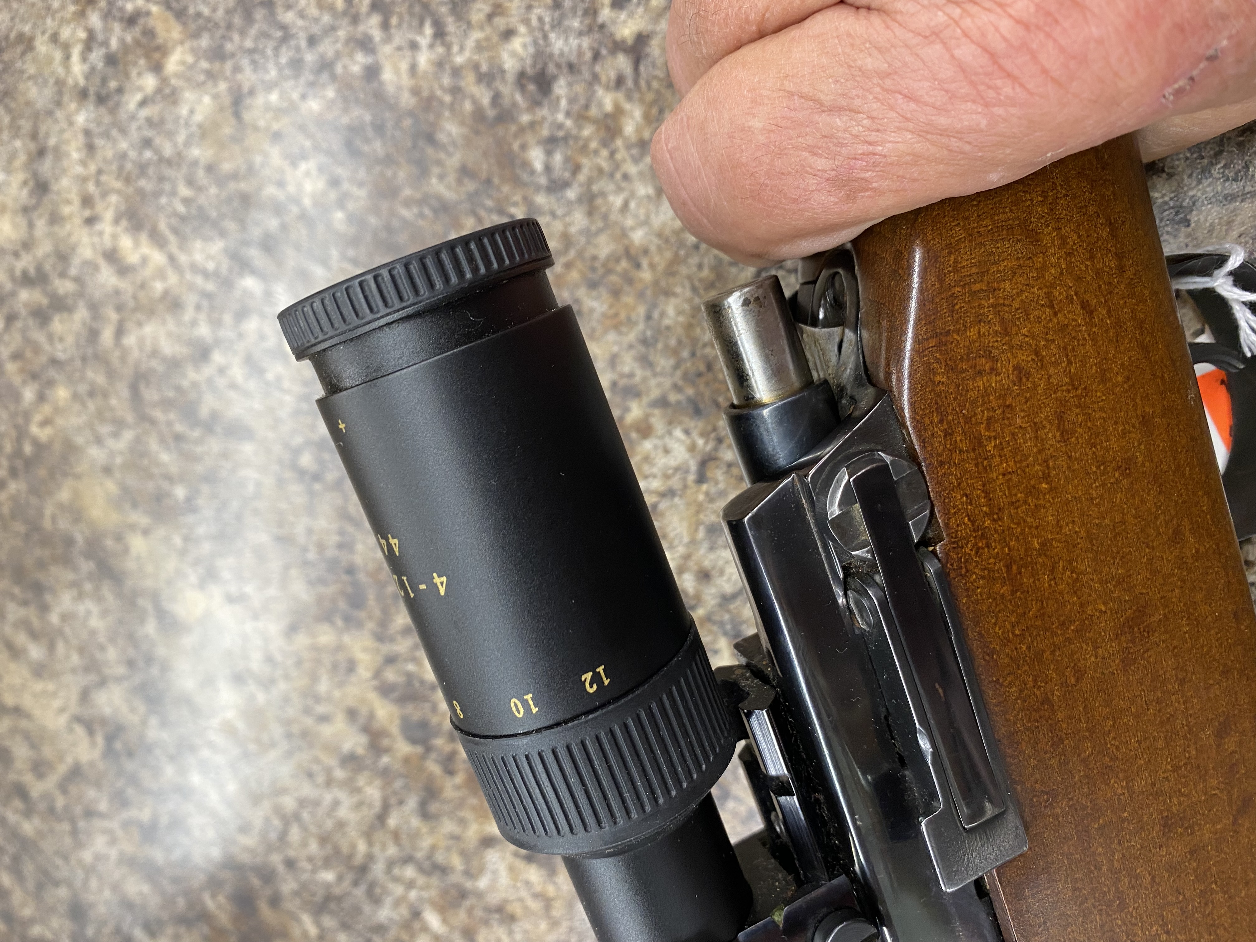

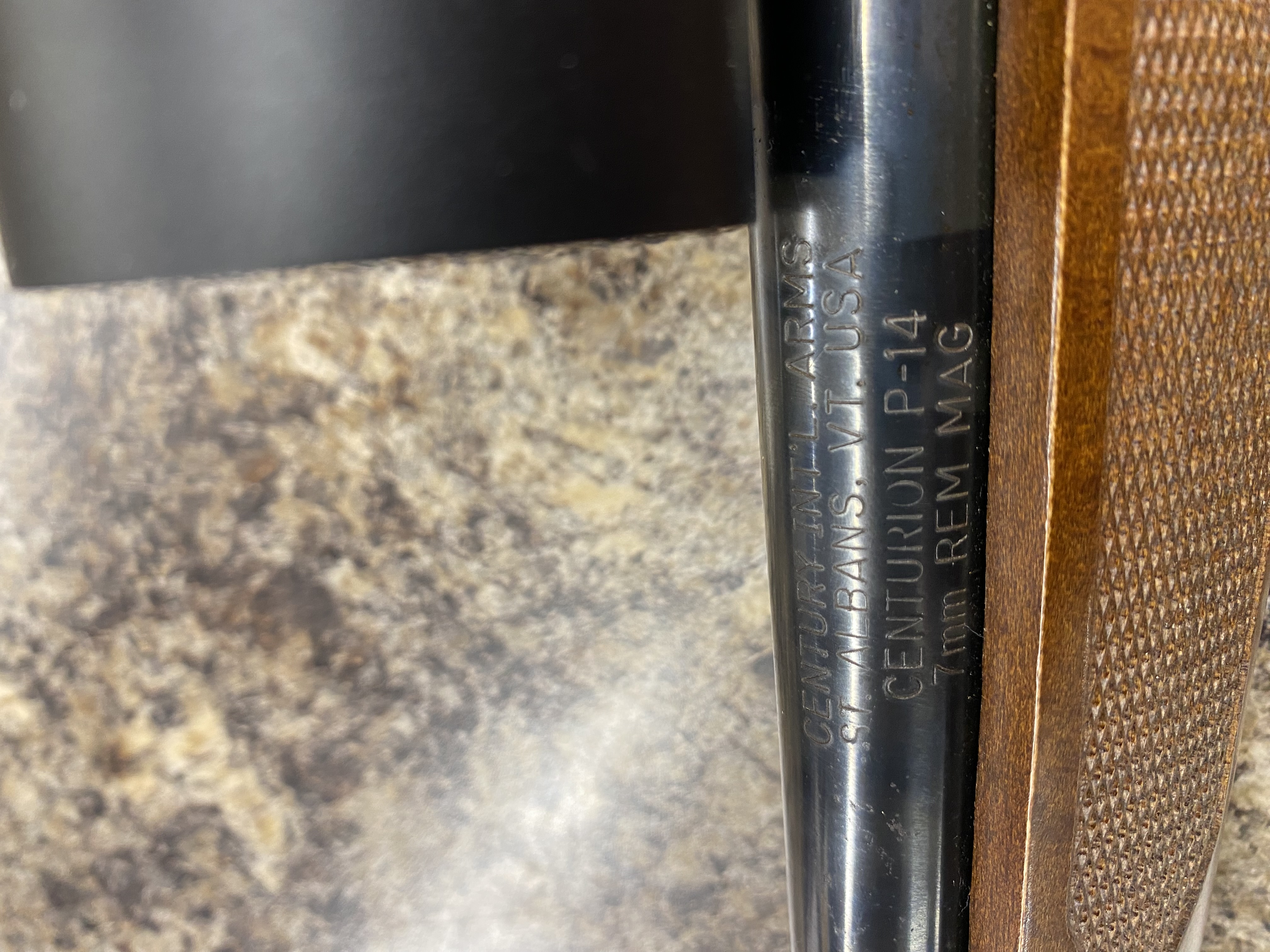

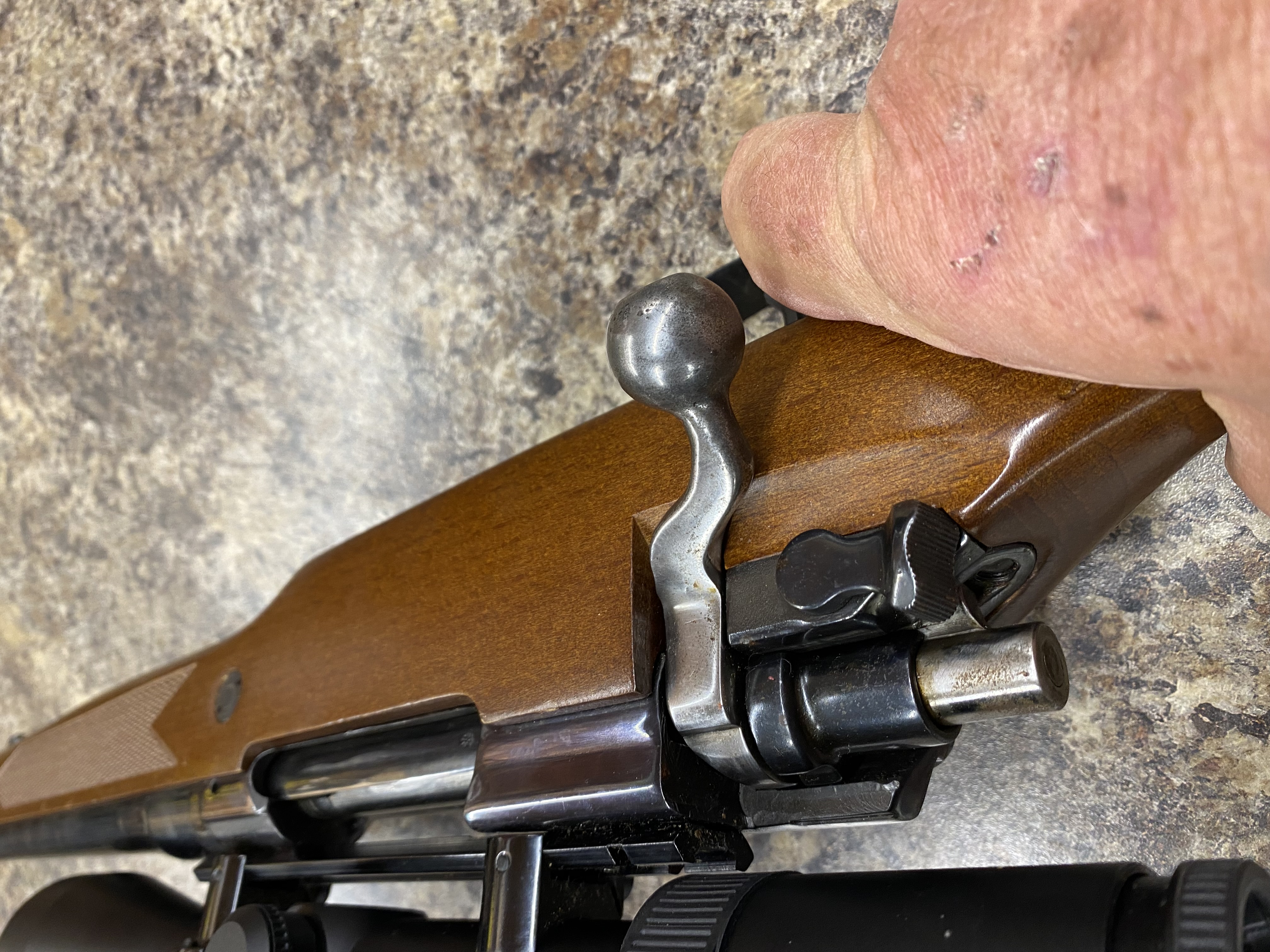

My LGS has this rifle in 7 mag for sale. Can anyone tell from the pictures what brand action this is?

1914 Enfield, which the 1917 Enfield is based on.

According to the interwebs it has a 1:10.5 twist, which is kind of slow.

Re: Enfield or Mauser action
BUT, that is a GREAT action for a custom. And all the heavy work is already done. Needs a barrel, good trigger and a nice stock.
Re-chambering this to the smaller case means cutting a bit of metal off the chamber side of the barrel and since you need to get rid of pretty much the whole chamber you’ll be losing inches off the total length. IF someone would take it on the job you also have to get a new bolt since the face is too big for the Mauser rim and fit/head space…. More $$$$, Plus you’ll end up with a really ugly gap between what’s left of the barrel and the stock because of barrel taper.
If it’s a good deal that’s a great classic sporter in a desirable round that you could download to what your looking for. Or it’s an easy rebarreling proposition and I’d take the opportunity to build a kick ass .338 Win Mag and sell the 7mm REM Mag barrel to help fund it.

The action itself will have been made by Winchester, Remington, or Remington/Eddystone, but you'll have to pull the scope base to find out.
The P14 makes sense for a belted magnum conversion because .303 British shares the same .532" case head diameter as all the .300 H&H descendants, but that's a bad place to start for the .473" case head of the 7x57 - - you'd want the U.S. M1917 version for that.
Cheaper path would be to search GB for one of the Ruger 77's - they're out there.
