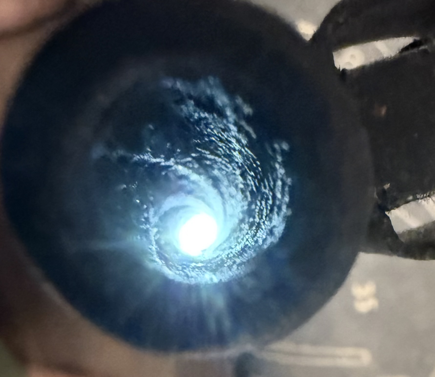

Unexpected Yugo 8mm Mauser
Posts: 4470
Re: Unexpected Yugo 8mm Mauser
Wambli Ska wrote: ↑Tue Dec 09, 2025 7:18 pm
Zee wrote: ↑Tue Dec 09, 2025 5:12 pm That bore looks like a train wreck!!! Hope is not corroded.
I think that’s just packing grease and hopefully will just punch out with the first pass through the bore.
Well so much for my hoping… 🤣
Posts: 911
I bought an Enfield years ago, N1 MkIII that had a bore like that after cleaning. I actually shot decent after a few shots. Don't give up hope yet.
Posts: 2985
Ouch!! Be happy if the bullets on target aren’t sideways.

I've gotten a few of those over the years. Wrap a bore brush you don't care about with coarse steel wool (hey you have nothing to lose) soak in solvent and punch through the barrel back and forth a bunch of times. Keep doing it until no more junk comes out of the bore. I alternate between copper solvent and carbon solvent. The rifling looks like it's still strong so there is a chance it will shoot.

Somebody long before you made that barrel junk. No sense wasting time, effort or money on it. The bore determines the condition of the rifle. If the bore is bad, it doesn’t matter what the rest of the rifle is, at that price point. That’s an action with junk currently attached to it. New barrel, stock and trigger. Go from there. 8-)

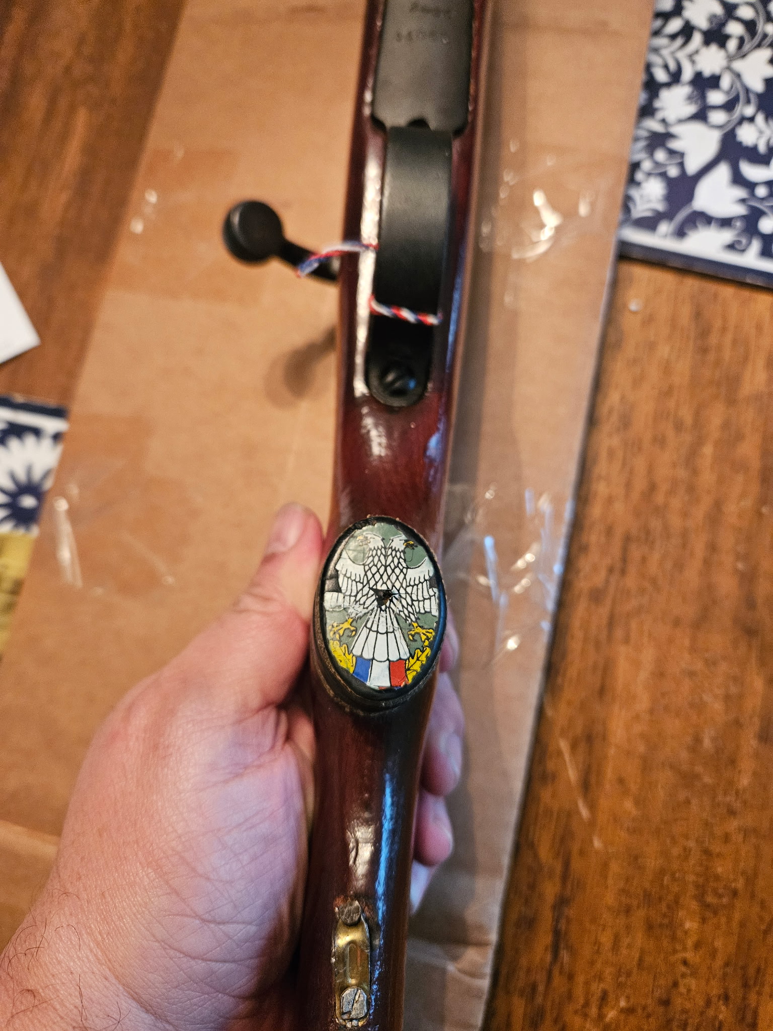

My buddy that got me into this met me at the range with HIS rifle, which externally is in “better” shape, and internally is only slightly better. His bore also looks like a 100 year old iron sewer pipe, but externally looks like this:

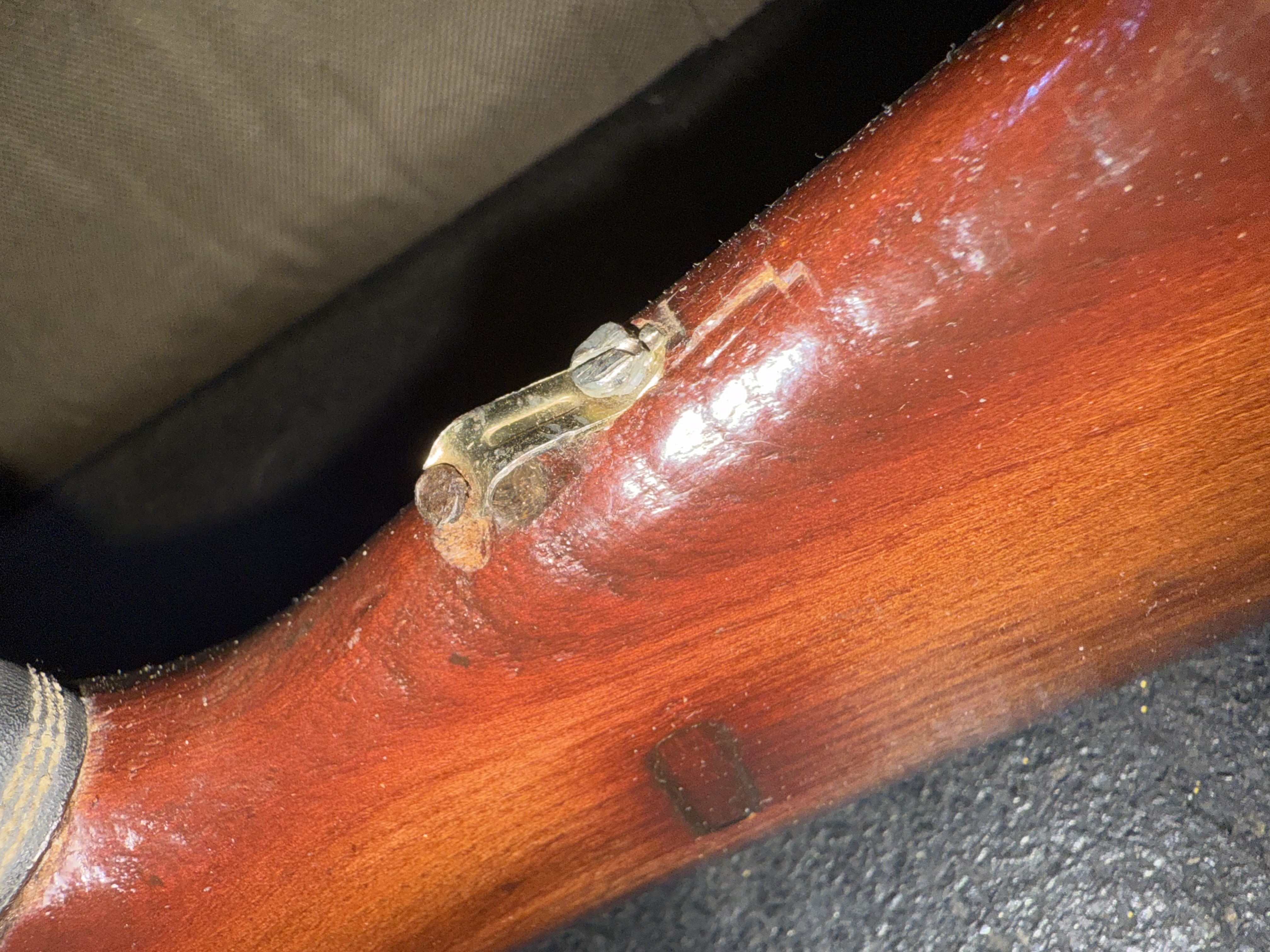

He did point out that the “sling attacment points” looked like they were made from leftover office supplies:

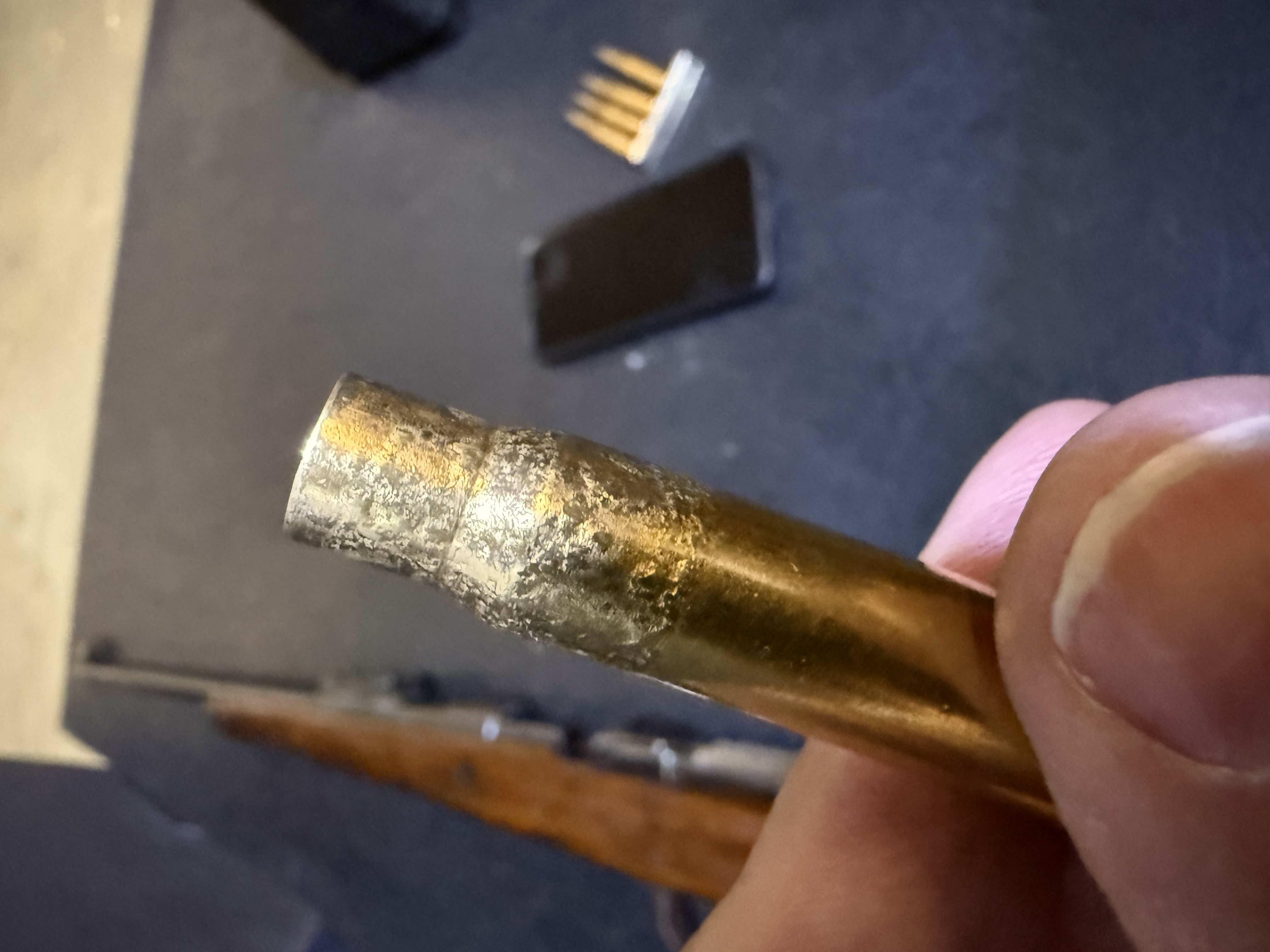

So, I got 5 rounds of S&B 196 grain “SPCE” loaded in the mag of my rifle, ran the target out to 50 yards (minimum for the rifle range), and cranked off the first round.
This thing kicks. Damn.
But then I tried to load the next round… well, the bolt would not unlock. After beating on the bolt handle with a board, and doing some other sketchy stuff, I finally got in opened. You can see what the issue was in the picture above. Obvious pitting and boogered up chamber in the neck and shoulder area in the chamber.
Well… s#!t. Might as well see if it can group. Fired two more rounds, muscling the bolt open after each one.
Not one round hit the 2’x3’ paper at 50 yards.
Well, at least I have a functioning action!
My buddy’s rifle fared a bit better, printing 12” ‘groups’ at 50 yards, but was at least able to cycle rounds without using a hammer. Here is a cool shot I got of his gun running some ancient surplus crap through it.
His “prettier” stock kicked even worse since the buttstock had been thinned to probably only an inch wide at the buttplate. I fired about 7 rounds through his and called it the ‘flinch inducer’.
After I got it home, I looked down the bore to see if the 3 rounds might have cleared things up.
Nope. Guess it’s time to start saving for a barrel
