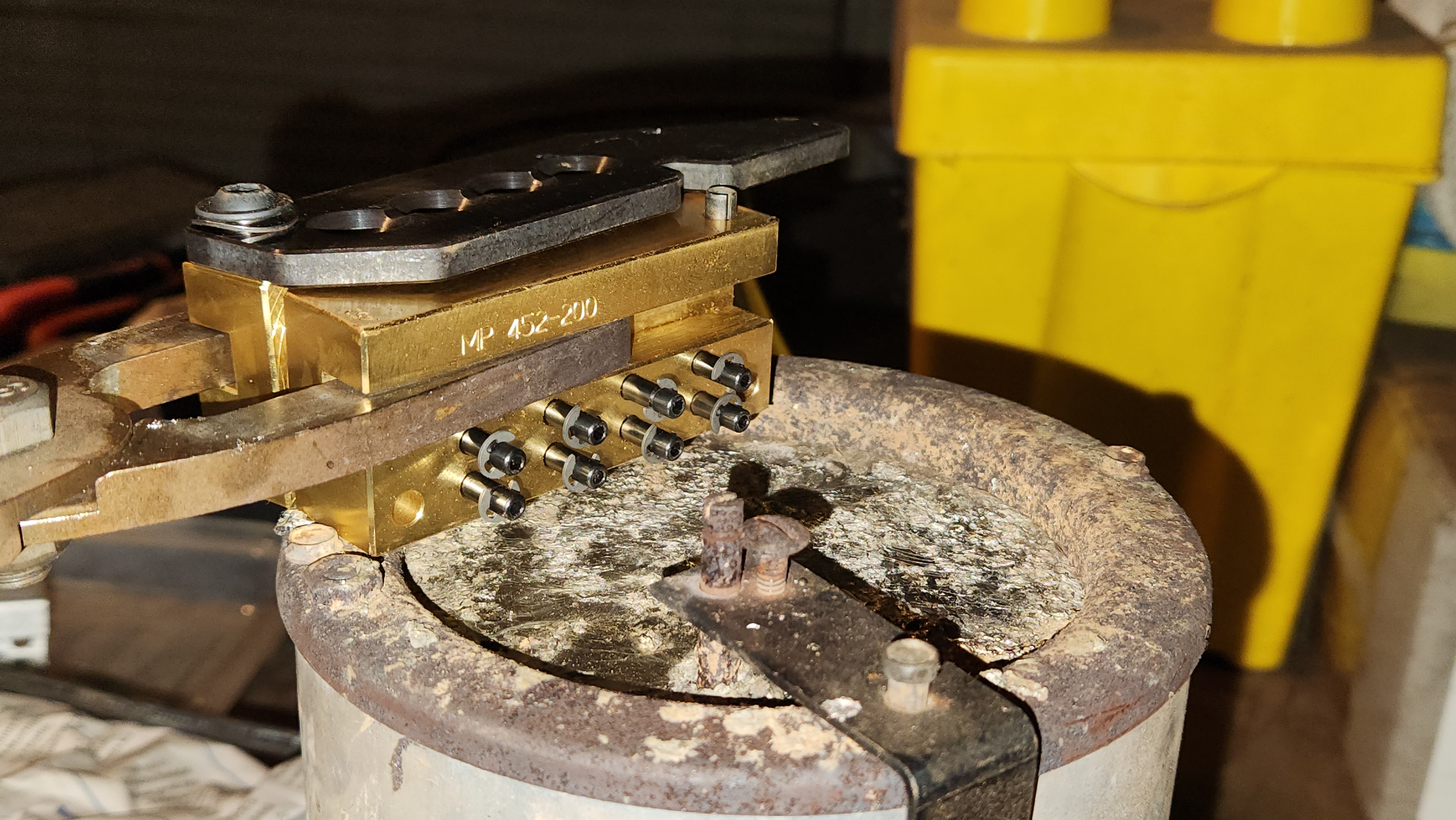

Fired up the pot and tried casting a few. Bullets fall out easily.
I am still looking for the correct temp and pouring speed to make it happy, but I should have it going tomorrow.

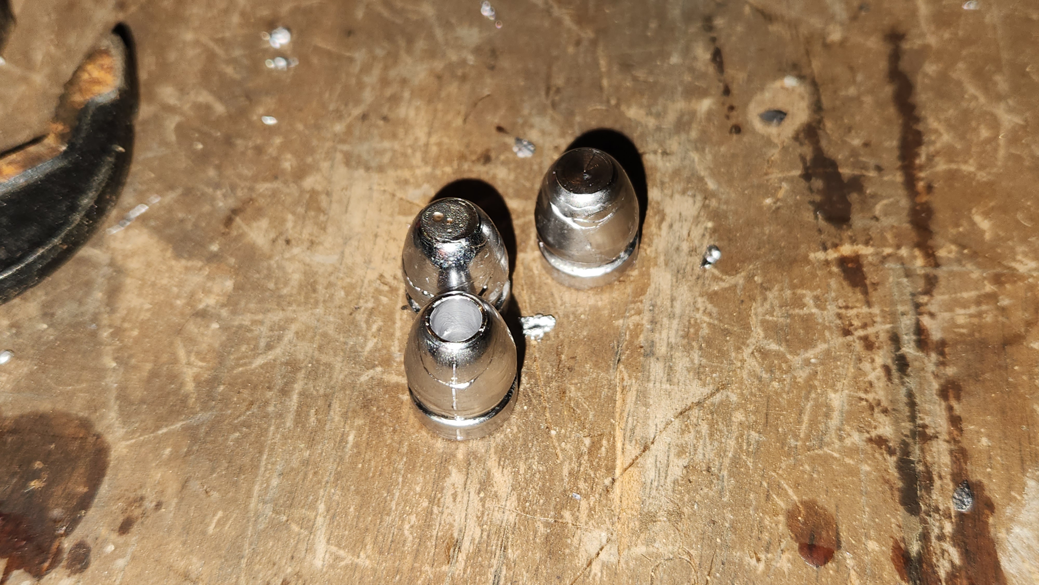

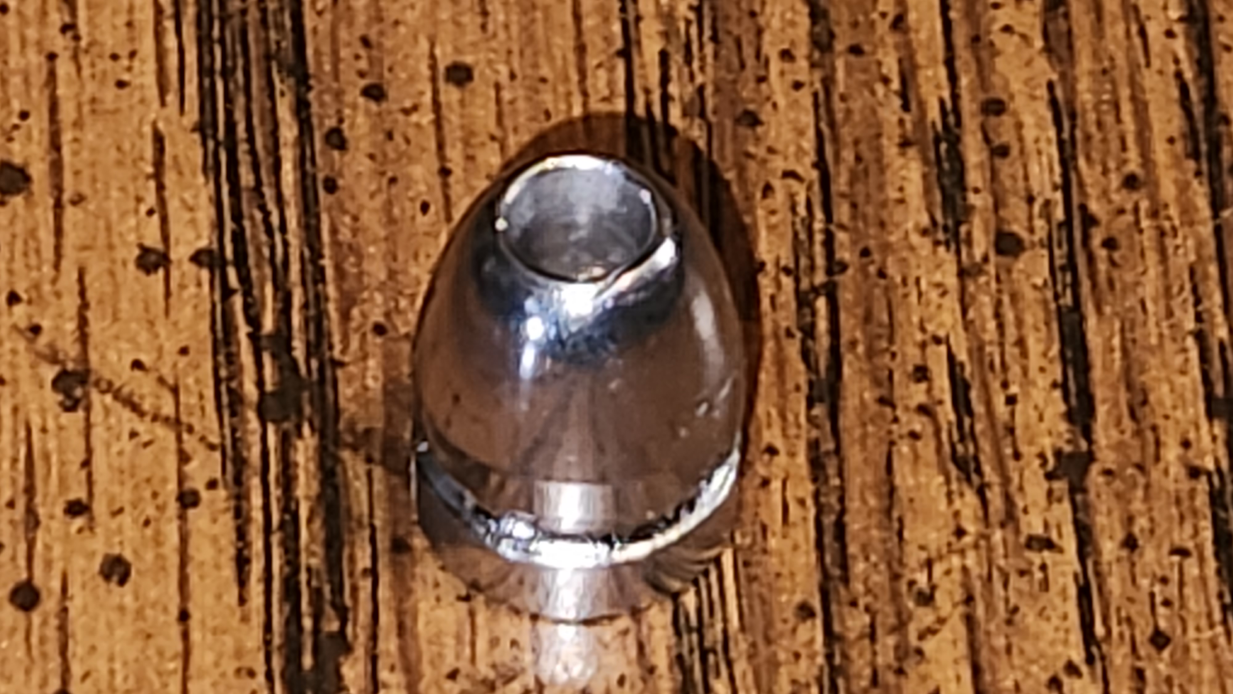

HOLY COW This thing drops some GORGEOUS bullets.
My Nikon has a dead battery, so a crappy cellphone pic is all I've got
Foundry certified 20:1

Concerning the pins, I've got "hot swapping" the pins down.

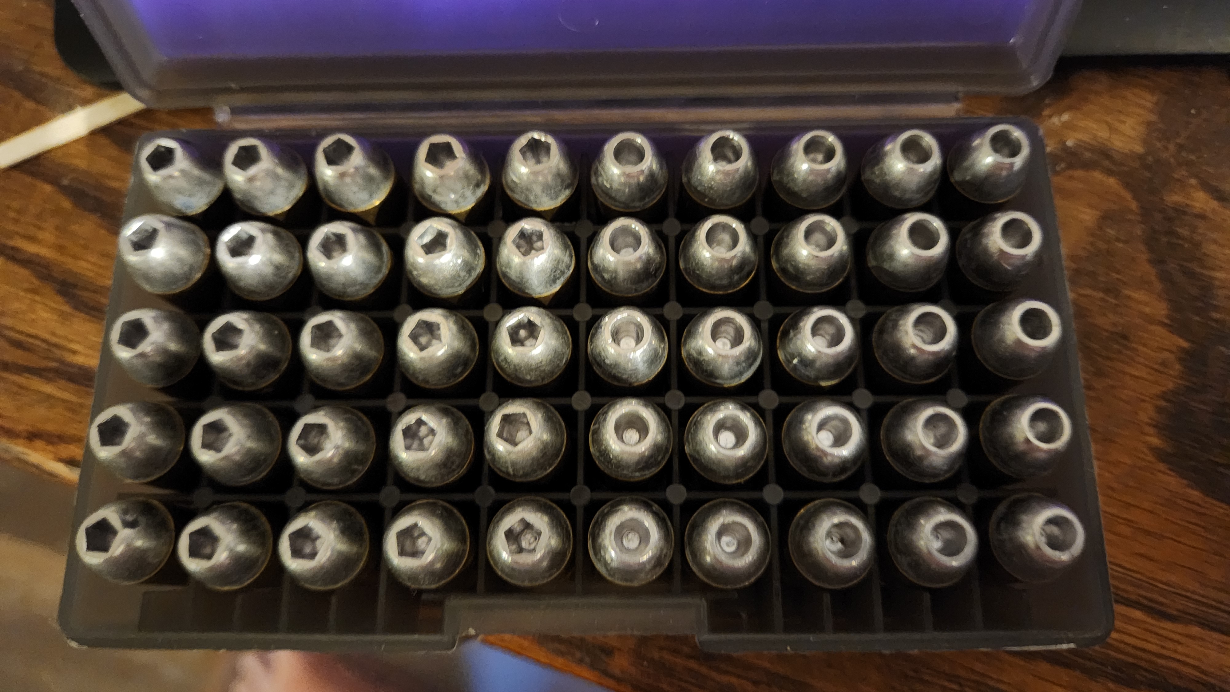

Well, sized and lubed 25 of each, Round HP averages 203.4gr and PentaPoint come in at 205.2gr
Decided on 6.2gr of Unique, my "GP load" with the 200gr RFN is 6.5gr

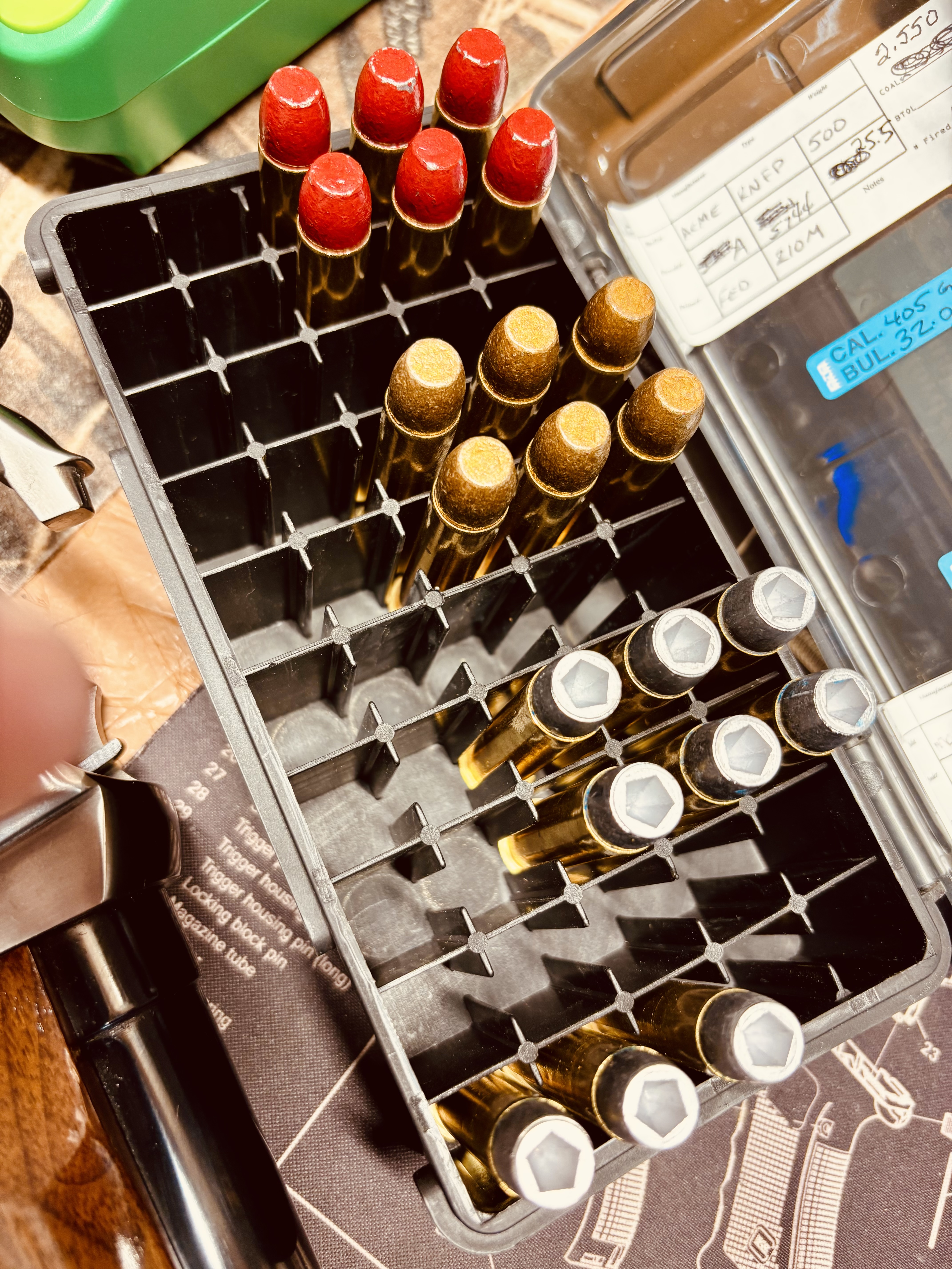

I loaded some 320gr cast gas checked bullets from Matt’s in my 45-70 Sharps. They had the penta style HP like that. At 2120 FPS, they are EXPLOSIVE!!! I recovered a chunk of lead and the gas check inside the second jug. Combined, they weighed 82 grains. Probably a good thing to run them at slower speeds.. :D

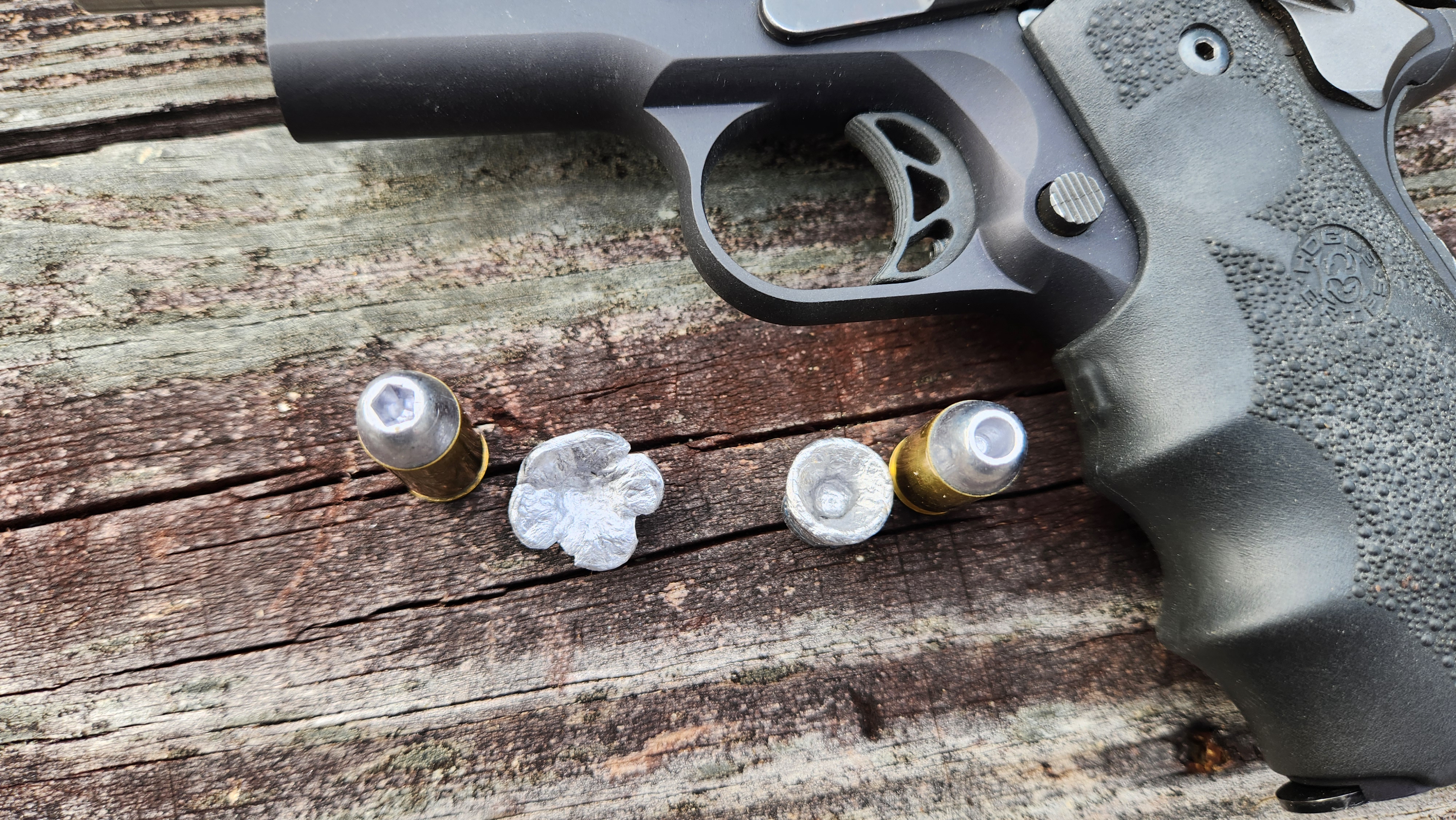

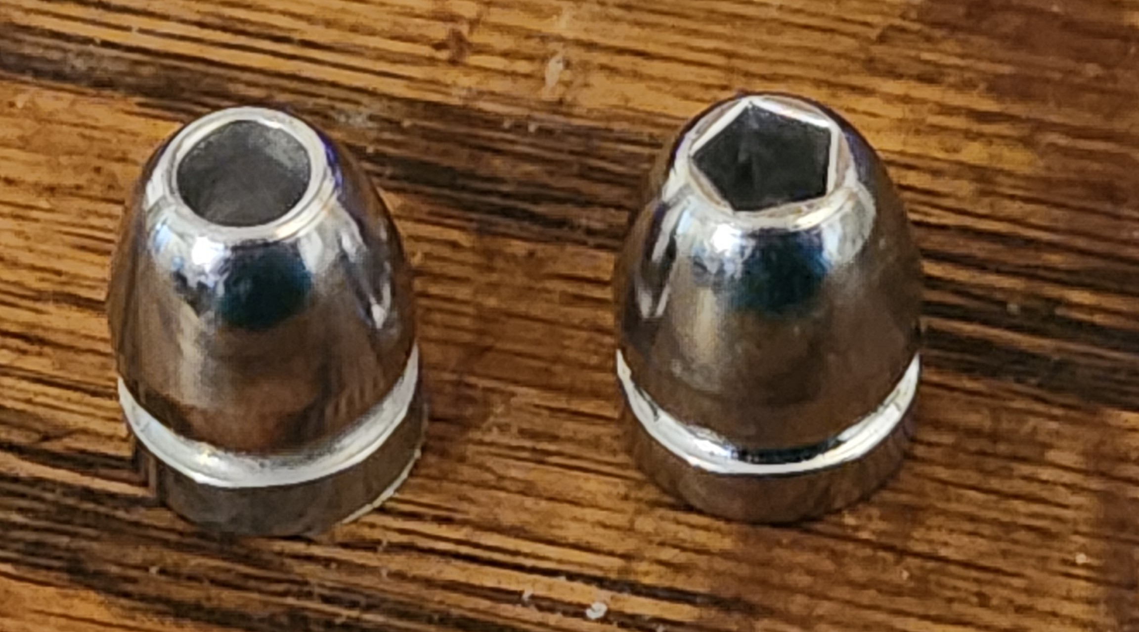

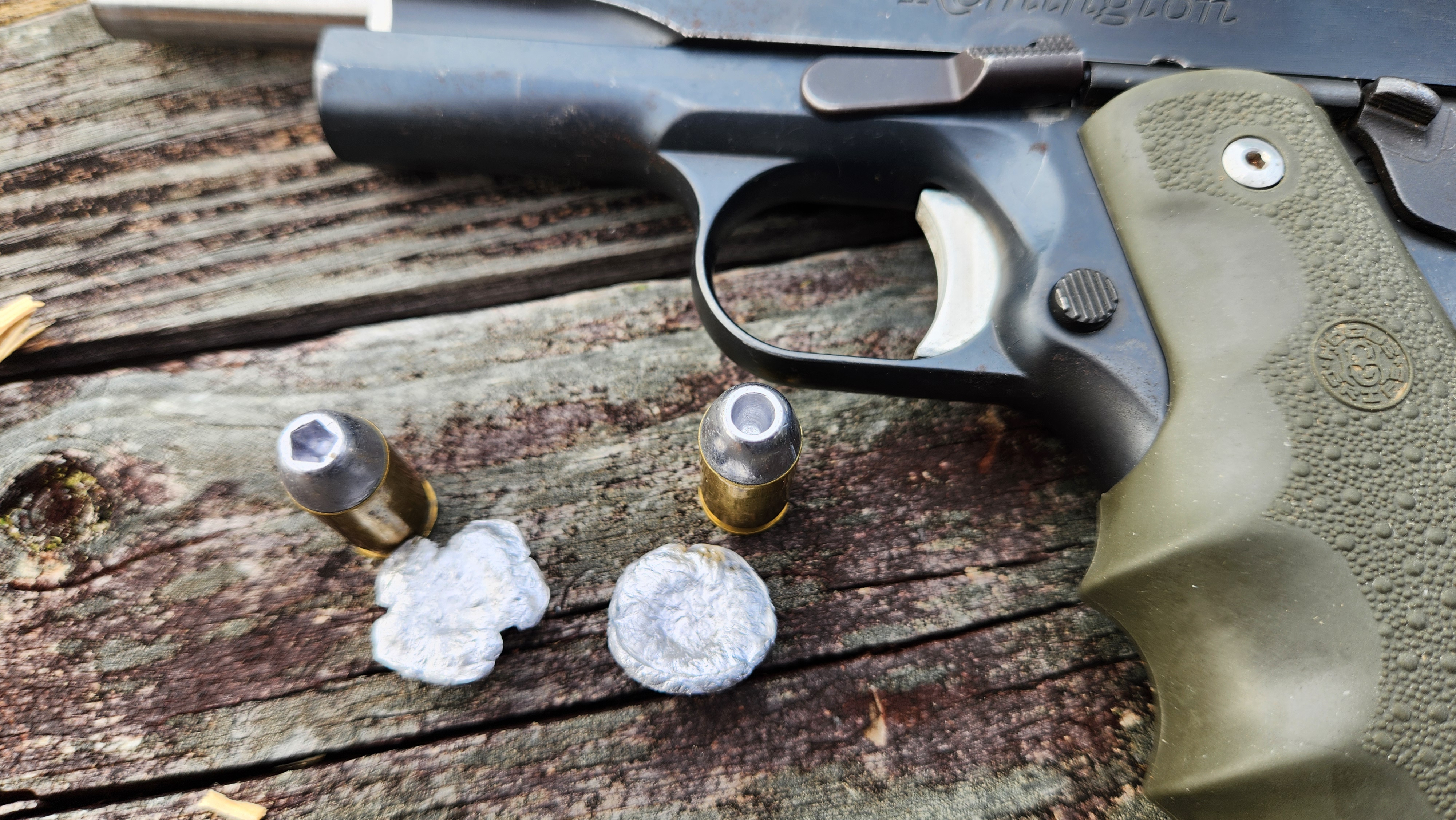

Well, that was interesting. From my 5" gov't model 937 fps. From my 4.25" Commander 860 fps averages Proof that barrells are a breed unto themselves. I would not had figured that 0.75" of barrel would yield a 77 fps difference. Concerning the PentaPoints (PP) Mixed results, first one from the 5", zero expansion and straight through my 16" block of 10% ClearGel :o
First PP from the commander, 10" penetration and nice expansion. I scratched my head and decided I HAD to try another through the gvt model, There's no way a faster cast lead bullet should expand LESS than a slower one into the same medium. Second PP from the govt went 9" and expanded nicely
Regular HPs, first through the commander. Minor expansion, 14" penetration. Through the gvt, NICE expansion and 12" penetation.
Now for 2000 quick words ;)
An unfired round is next to its fired version, black grips are the commander.
While the 2/3 of the PPs that expanded did so quicker than the HP version. The one zipping through with no obvious expansion, from the wound channel, gives me pause. While the HP from the 4.25" didn't expand as much as the PP, it DID expand. The 1/3 PP that didn't expand from the 5" greatly reduces my desire to use them as my all purpose bullet
