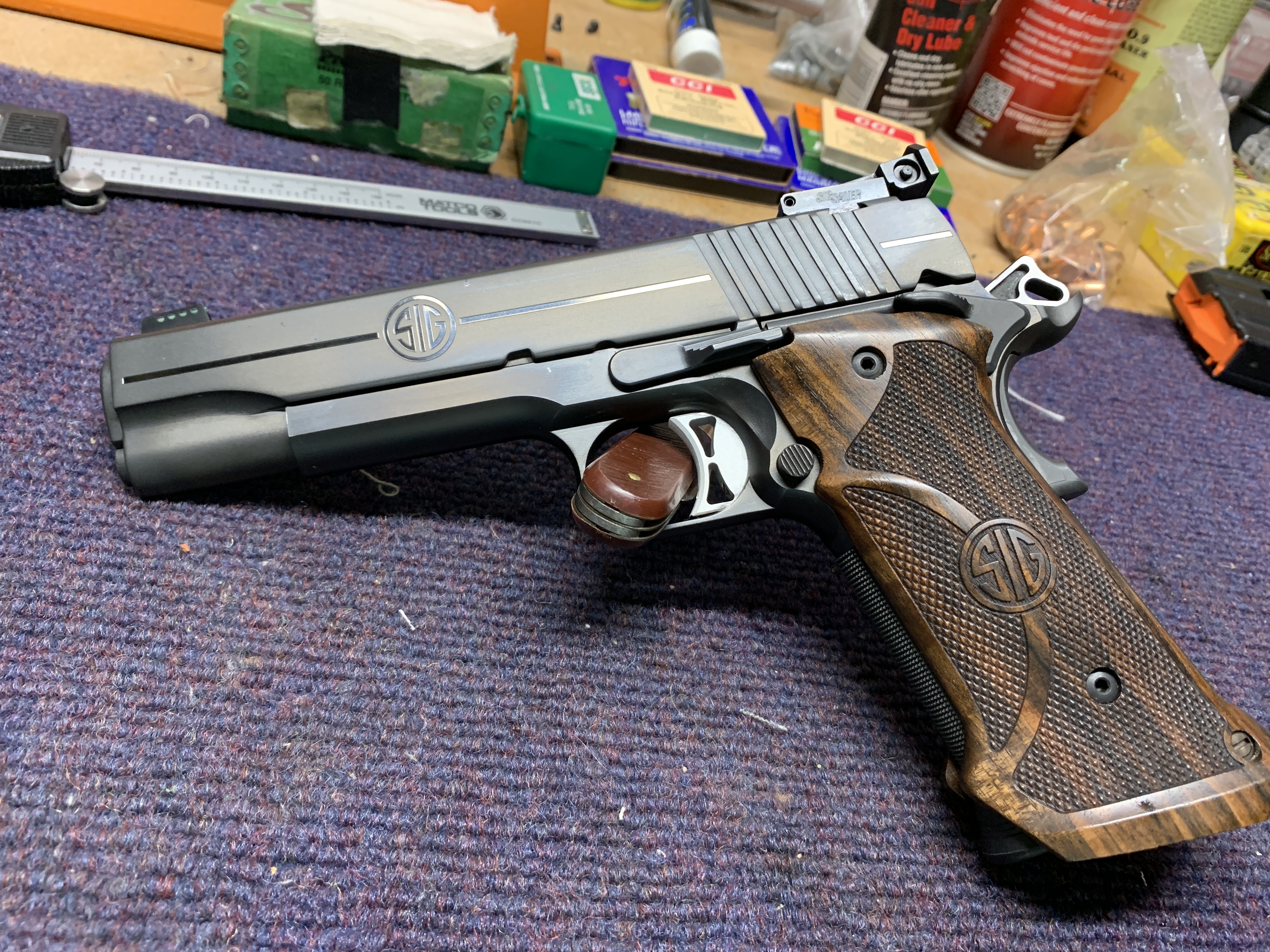

my money's on the 1911 to win the race ;)

GrapeApe wrote: ↑Thu Jan 08, 2026 10:46 pm my money's on the 1911 to win the race ;)
Oh I'm sure you are correct but it's a curiosity. The 325 is more fun though :lol:
1911 is kind of a BBQ gun so it does not get out much.

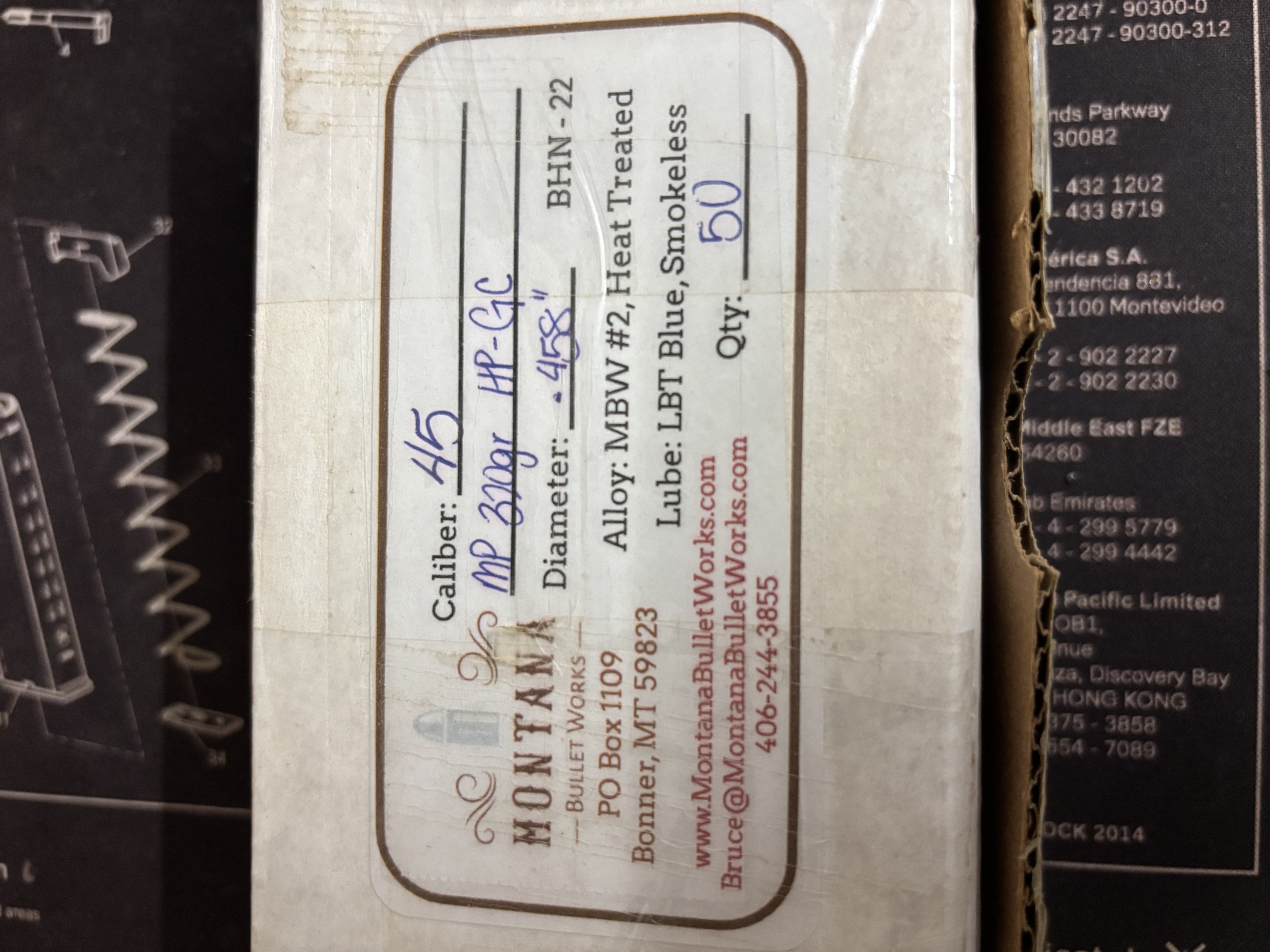

Jay wrote: ↑Wed Jan 07, 2026 2:48 am I loaded some 320gr cast gas checked bullets from Matt’s in my 45-70 Sharps. They had the penta style HP like that. At 2120 FPS, they are EXPLOSIVE!!! I recovered a chunk of lead and the gas check inside the second jug. Combined, they weighed 82 grains. Probably a good thing to run them at slower speeds.. :D
After it was pointed out to me that Matt’s doesn’t offer the bullet I mentioned, I double checked and have to post a correction in case anyone was interested in that bullet. I was mistaken and those bullets were actually from Montana Bullet Works. It appears they are no longer in business. I’m unsure if someone else has taken over the business or if that bullet is available any more.
Jay
Posts: 413
Re: New mold ordered (Oh BigSlug...)
Post by Jay »
After attempting to go to the website on the box, here is the message that comes up.
