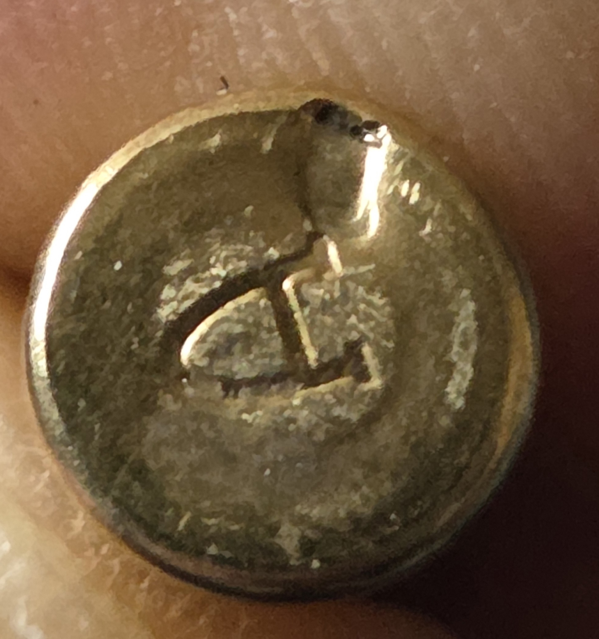

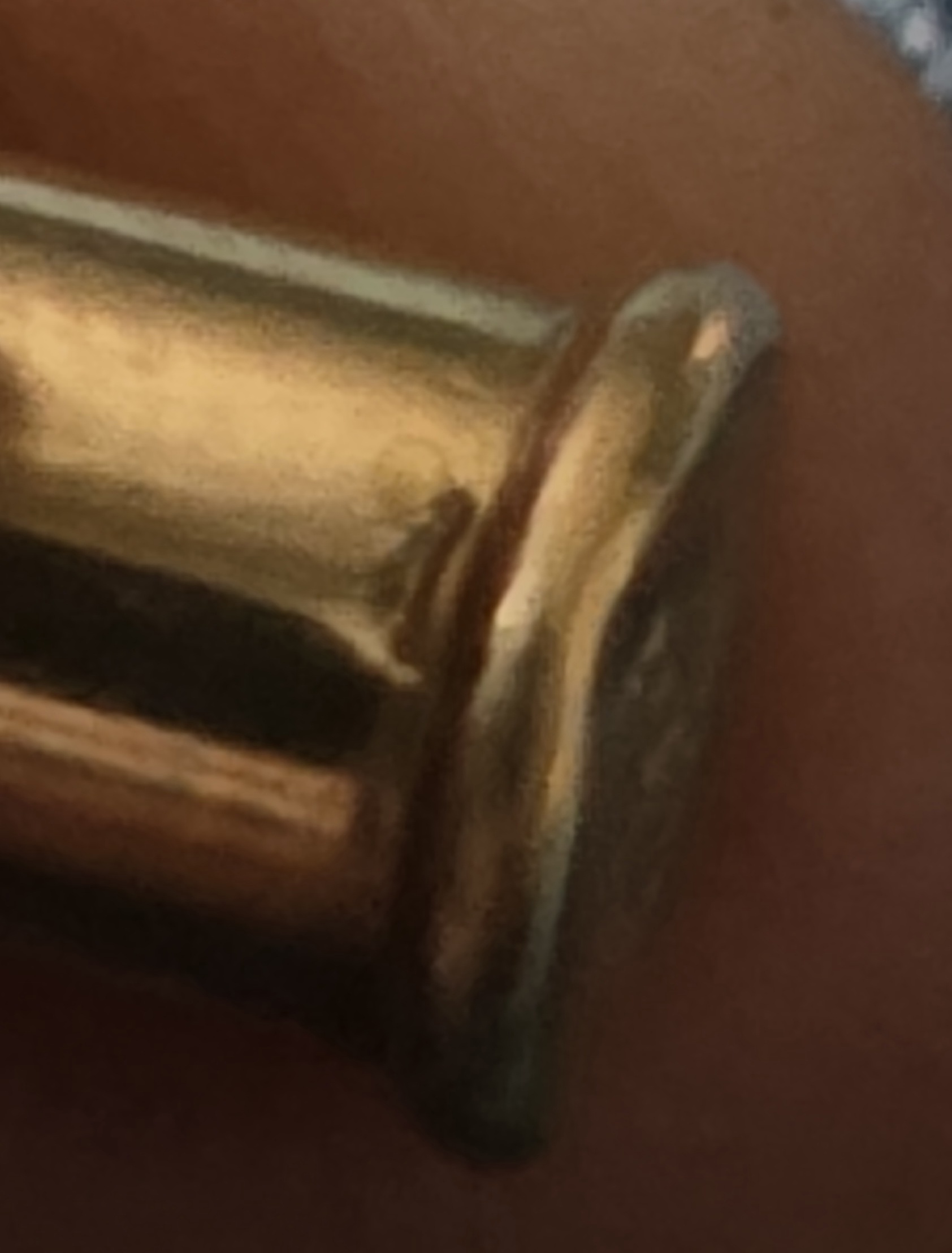

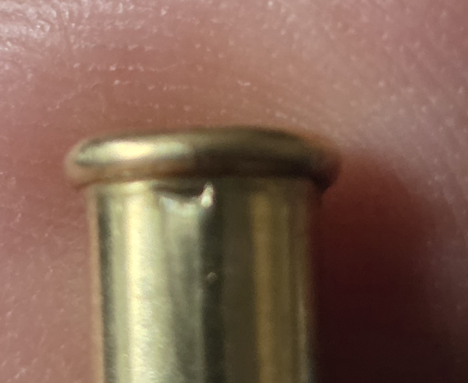

A fired case showing the backside of the rim and firing pin strike not sure what the backside cause is ?

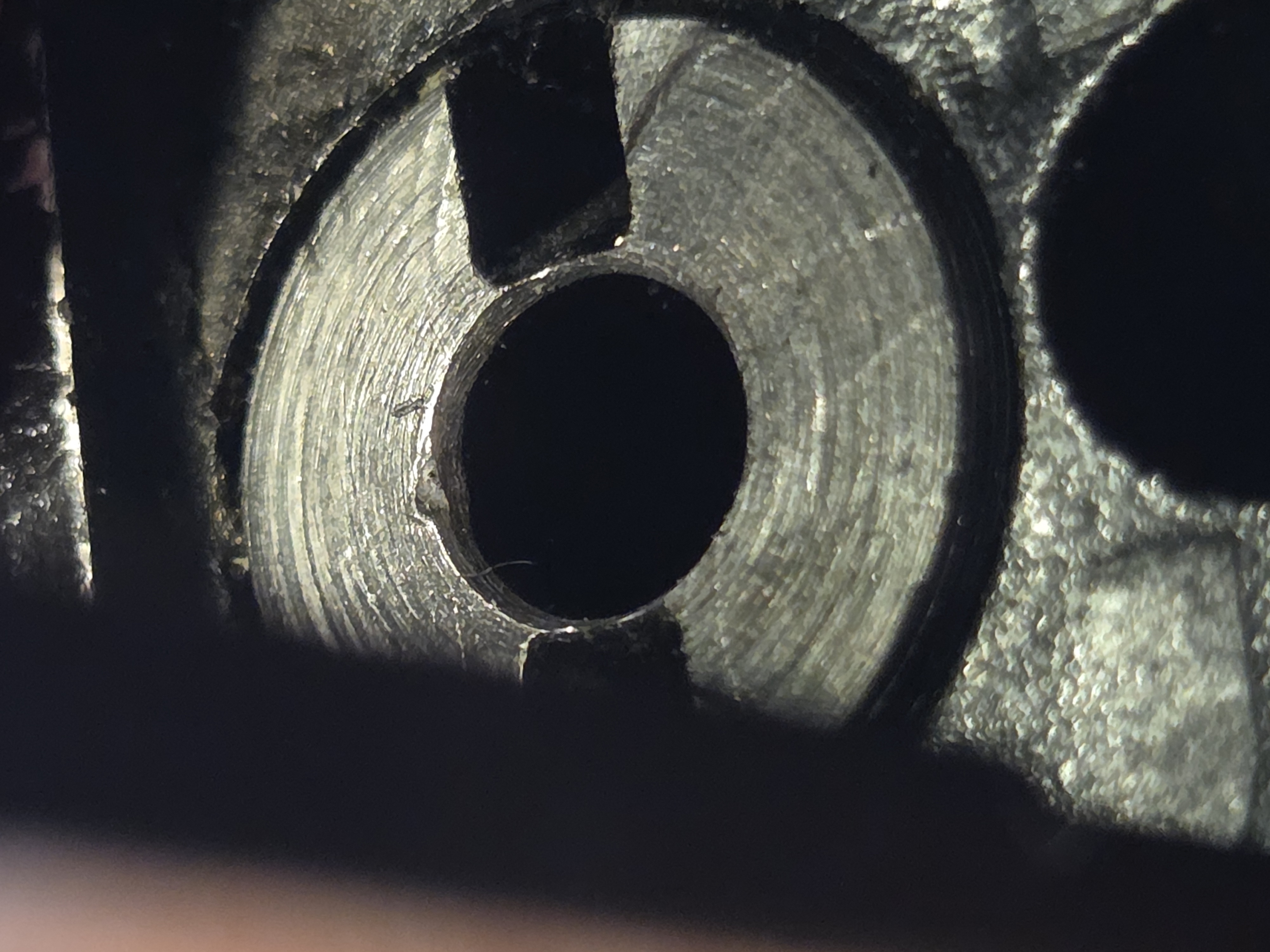

A wag would be that the chamber is slightly oblong, or the chamber has a spot under where the firing pin would hit the empty chamber from dry firing? Just a guess

I'm pretty sure the chamber's been peened from dry firing.
This mark, aligned with the firing pin strike on the rim, seals the deal for me

The firing pin is not hitting all the way to the edge of the rum so my vote is a broken firing pin at the striking edge

Feel for roundness at the back of the chamber with some kind of pokey? Removal of the barrel to gently deburr the hypothetically kneaded metal may be a foregone conclusion, but we'd like to determine the problem before taking that step if possible.
Diameter of brass body before and after firing it? Consistency of diameter - if the firing pin strike is 12:00 and directly across is 6:00, what's the diameter from 3:00 to 9:00? Is the brass swelling symmetrically?

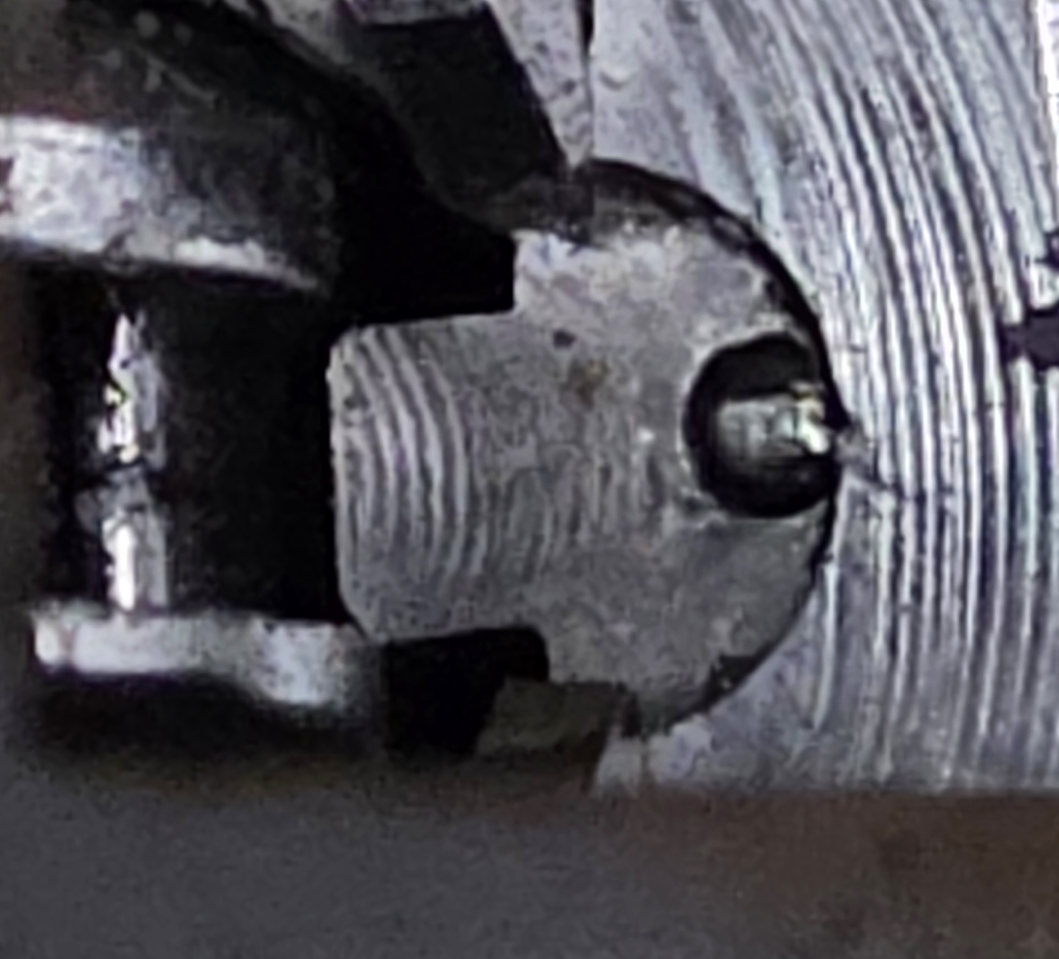

A bit outside my wheelhouse, but thinking in terms of firing pin travel:
There's probably an oblong hole in the firing pin and a cross pin retaining it in the bolt. Is the pin bent or the end of that hole which serves as a stop surface "wallered out"? Either of those would allow excessive forward travel.
OR. . . is the back of the chamber the designed-in stop surface?

Looks like it's peened just enough!!!!!
Firing pin look good to me.
Firing pin hits 12 o'clock
Ejectors at 3 and 9
Rim diameter does show wider in the 6 to 12 diameter reading by a couple thousandths

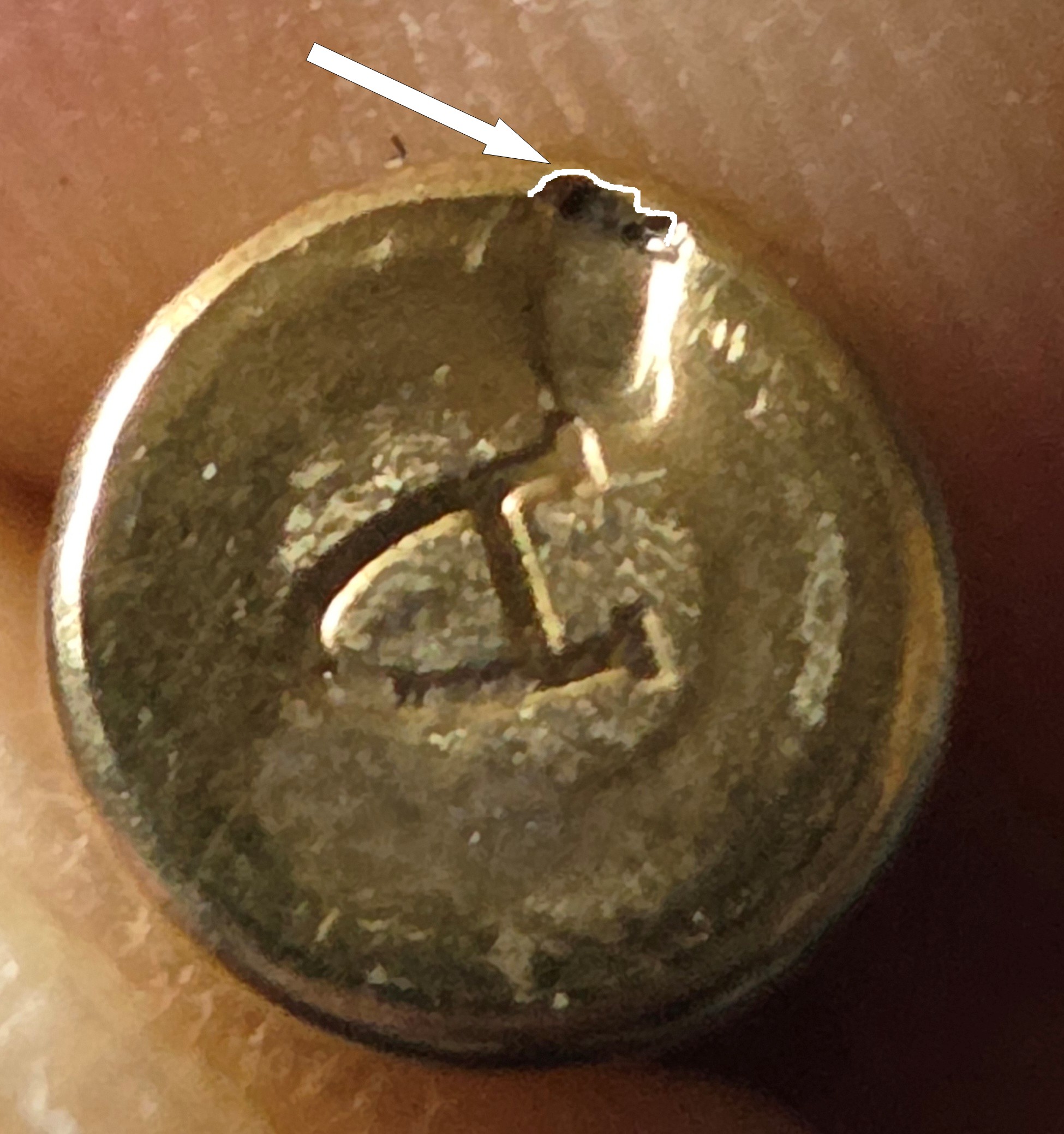

Have another look at the first pic showing the firing pin strike on the brass.
The top is scalloped and does not contact the full rim.
That indeed may have been caused by dry firing.
I looked for a spent 22 brass but didnt find one in my bag. But look at one from another gun you will see a sharp rectangular indent that covers the entire rim. If dry firing it will be the outer edge of the firing pin that takes the damage from striking the face. Could be 2 problems. Firing pin and chamber breach.

Enlarging the first pic of the chamber you can see the peened area at 12:00

I would agree, dry firing damage to the chamber and firing pin. The pin doesn’t deform the rim of the case, all the way pout to the rim. The pin should be flat all the way to the top edge. The picture of the chamber seems to show a little deformation.

It wasn't hanging up at all on unfired rounds.
Figure just enough of a burr inside the chamber to stop extraction on the fired round.
I Took it apart and Im pretty sure I swaged it back.

To me, that "ding" on the end of the barrel means the FP has taken some damage.

If it's not damaged, they sure picked a strange shape to mill the top edge of it.
It still seems to work, so it's not "terminal damage" though
hardened, could also mean "brittle", at least compared to the barrel steel
