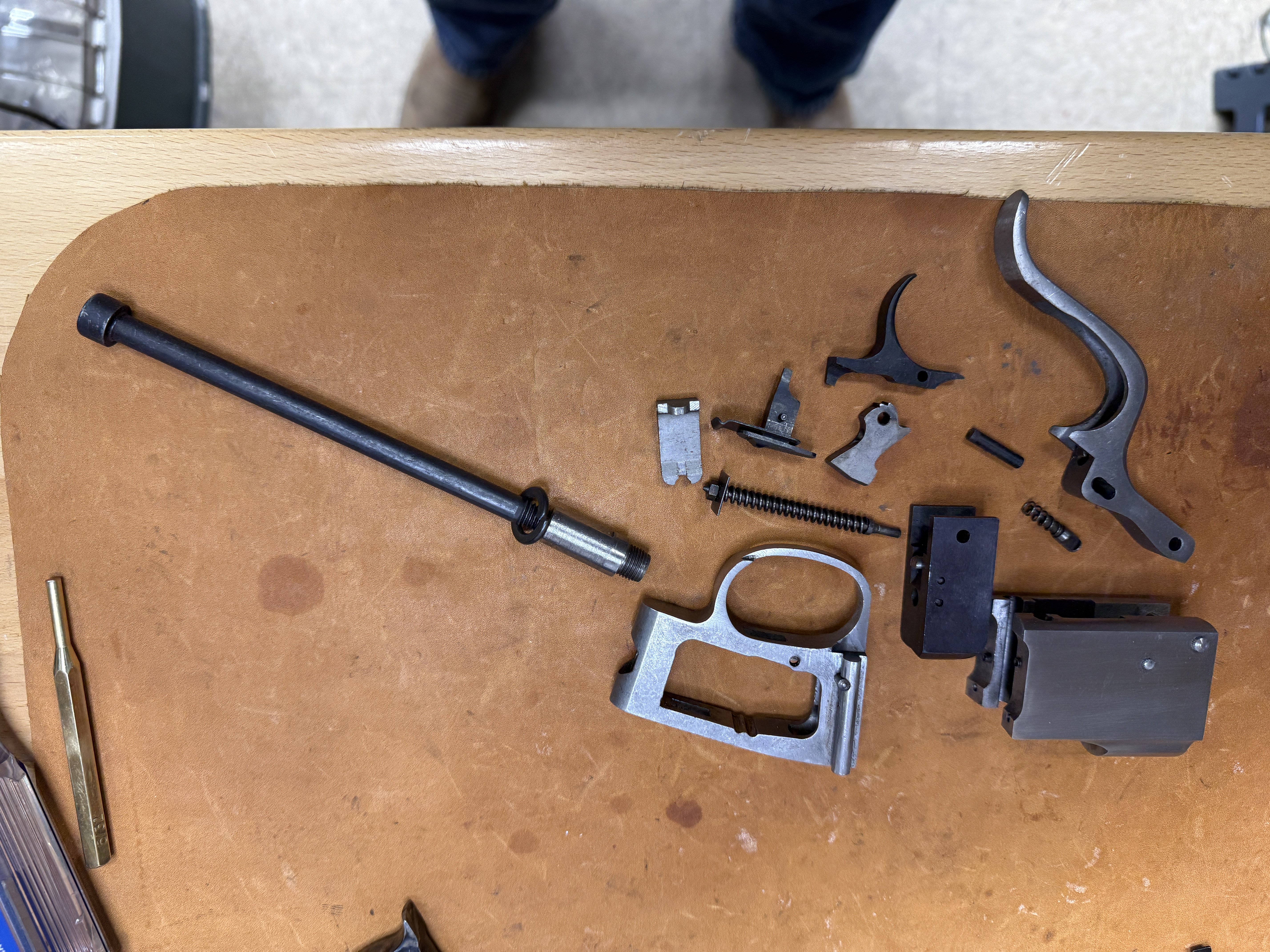

I cant wait to see what ill be working with. I can't say 100%, but I'm assuming that you could probably go with any BP cartridge that you wanted to, within reason. Apparently they're popular to do in 45-70 from what info I could find. That alone would be pretty sweet. Ill know more once I get hands on it.

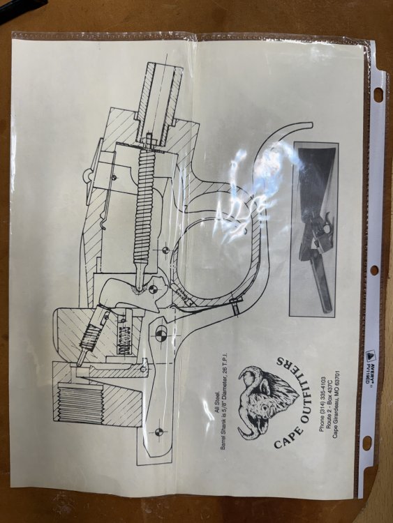

How long have you had this project on the back fire? Cape Outfitters has been out of business for a while.
Posts: 1338
Re: Not ready for unveiling, at the planing/build stage...

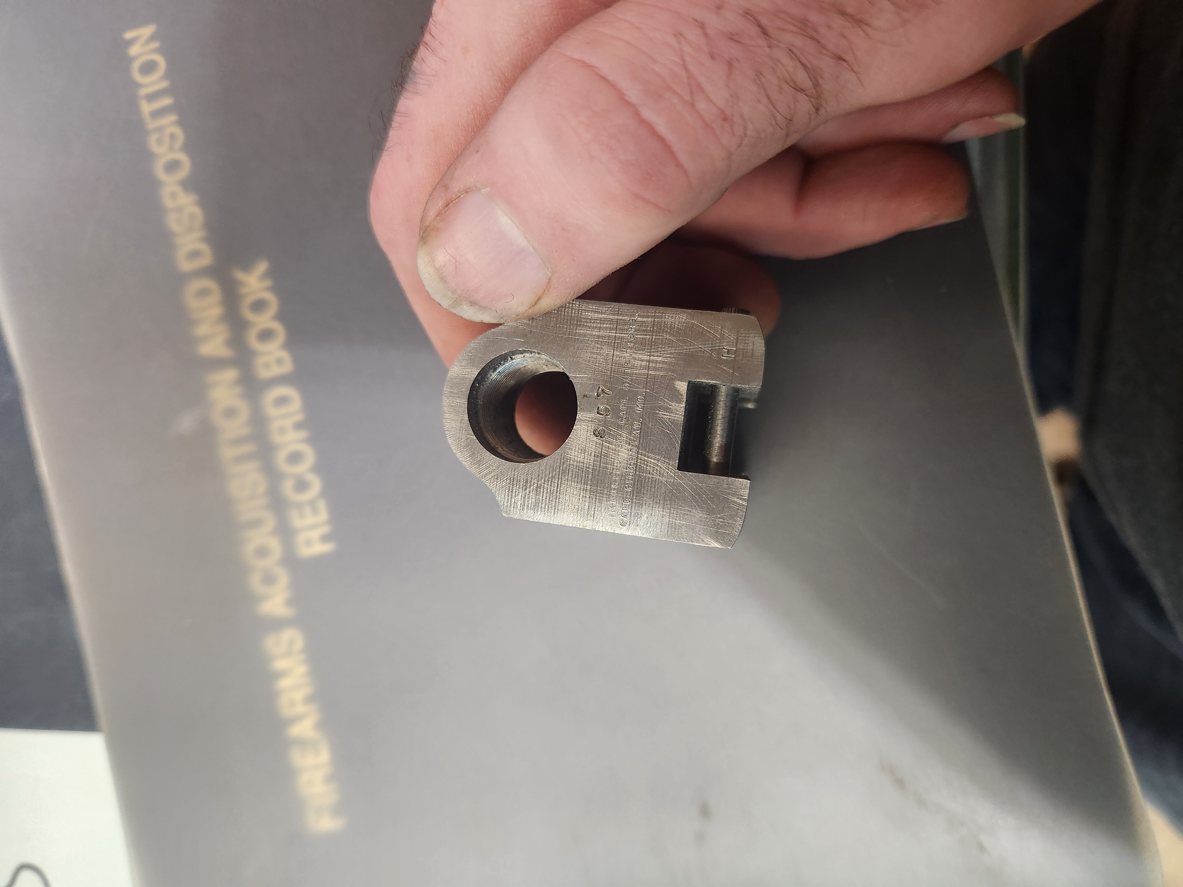

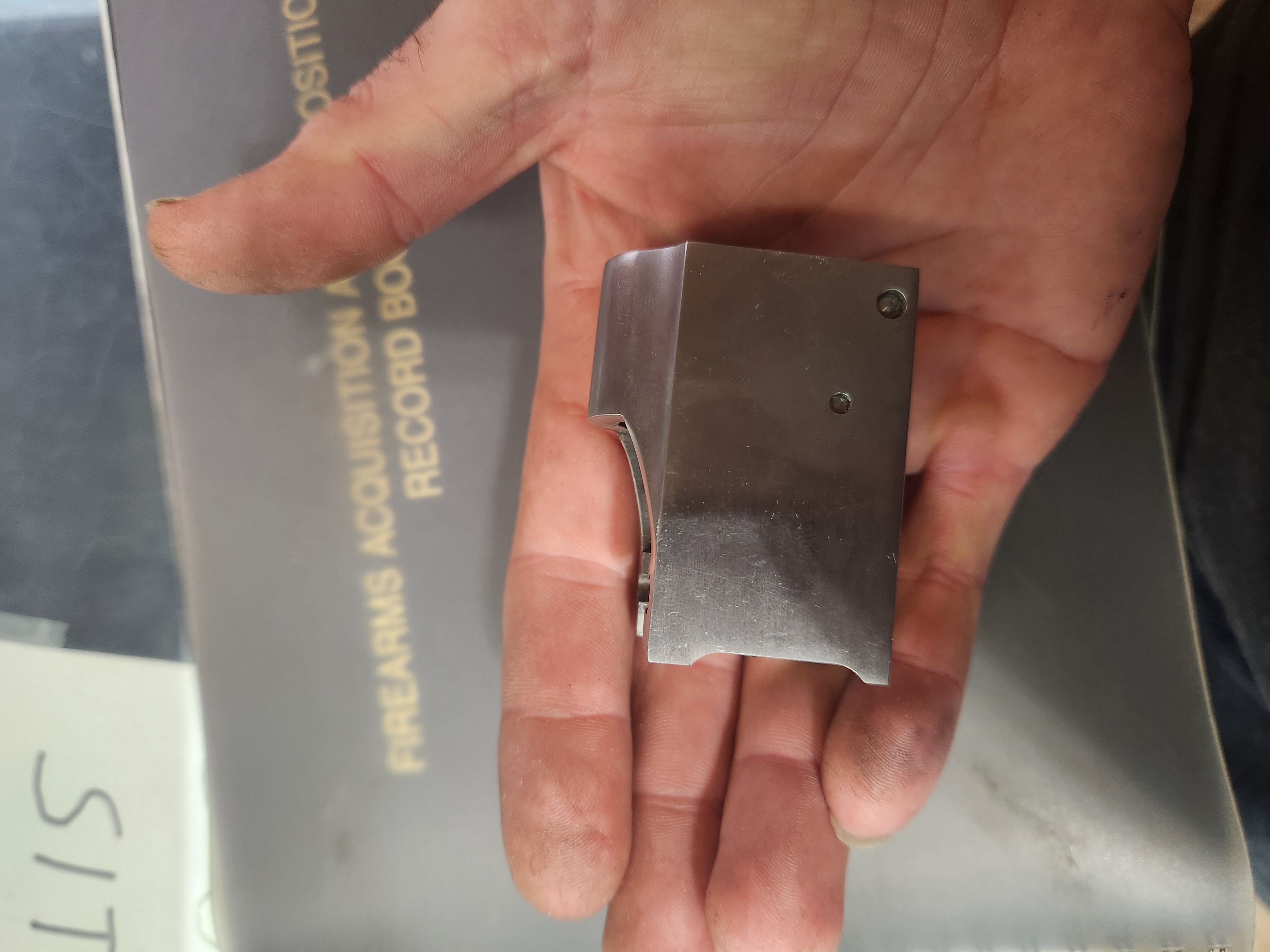

So I'm thinking anything 50 caliber is out of the picture. This tenon is small, like 5/8ths small. It's a cute little receiver though.
