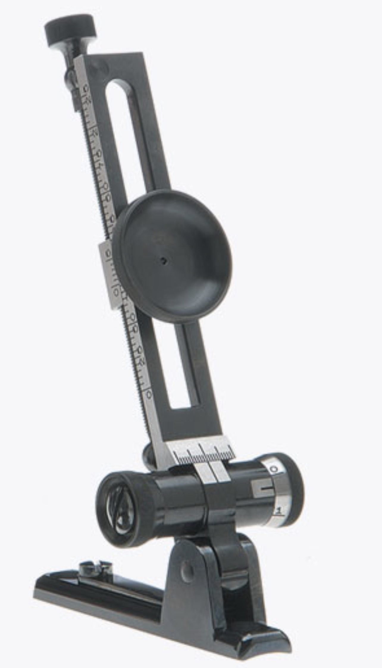

Anyone have this sight or similar? One what for launching Volkswagens at long distances?
If so, I have some questions on some measurements. Have an upcoming project

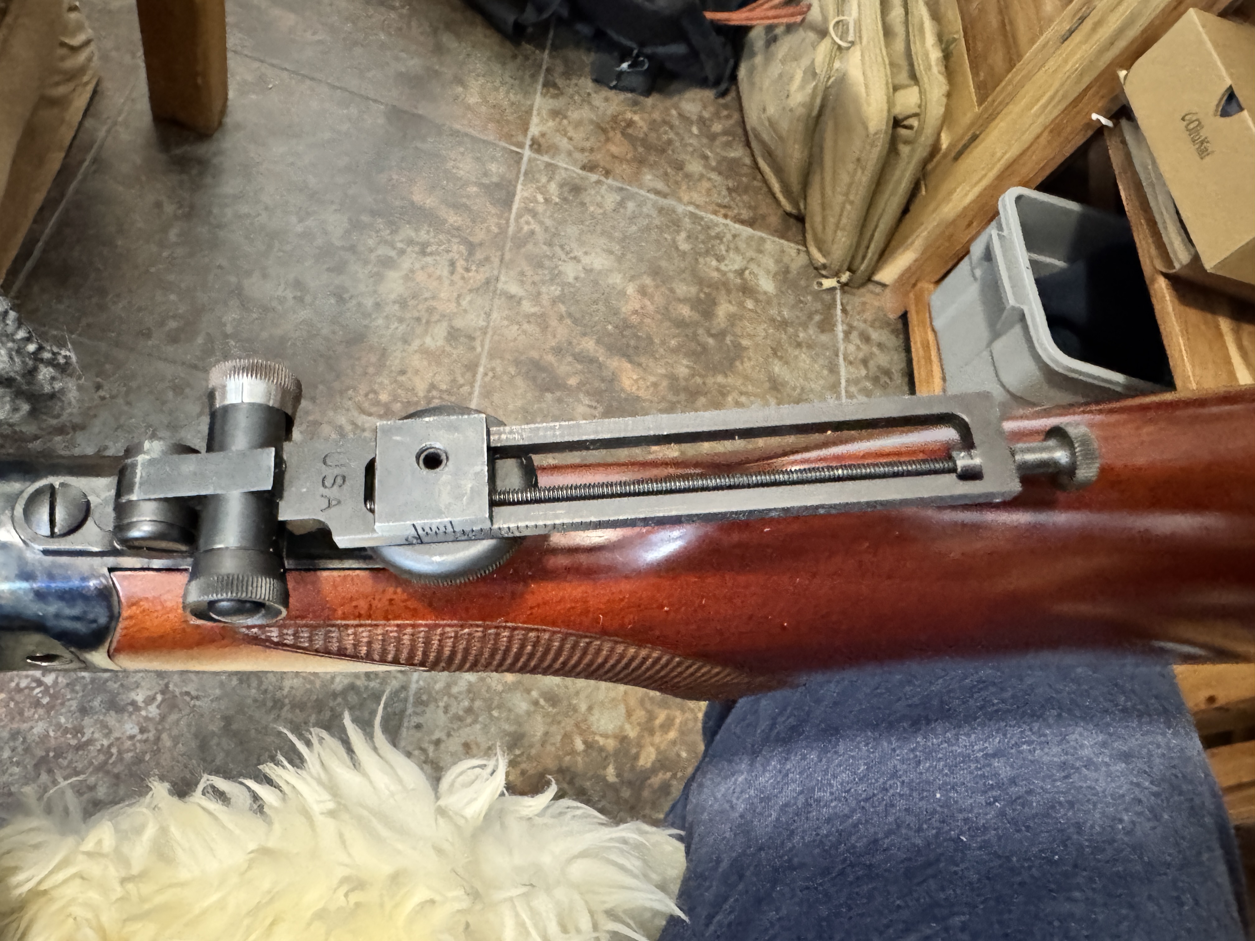

I have 2 similar, one frome Lee Shaver and the other a Montana vintage arms. Both on C.Sharps 1875 models from the Montana make.
Posts: 1871
Re: Hey Sharps guys got a question.
I have dad a Montana Vintage Arms sight on a sharps. I run mainly Lyman’s and Marbles now. MVA sights are worth every penny for repeatability and durability.

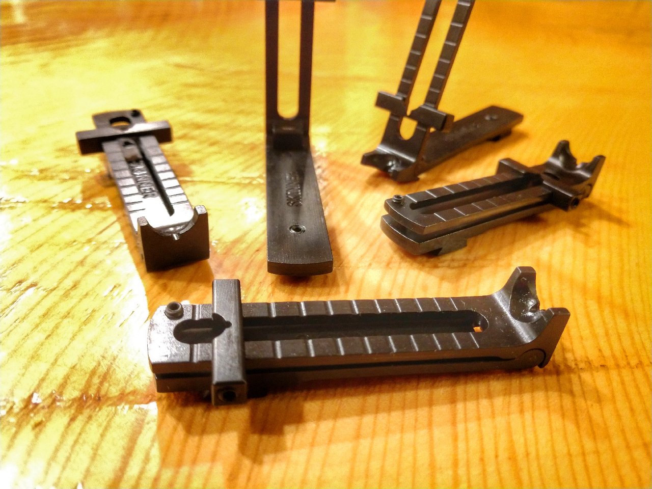

If you're taking the trouble to make one, copy a model with windage adjustment. Just a thought.

https://montanavintagearms.com/product/101-mid-range/

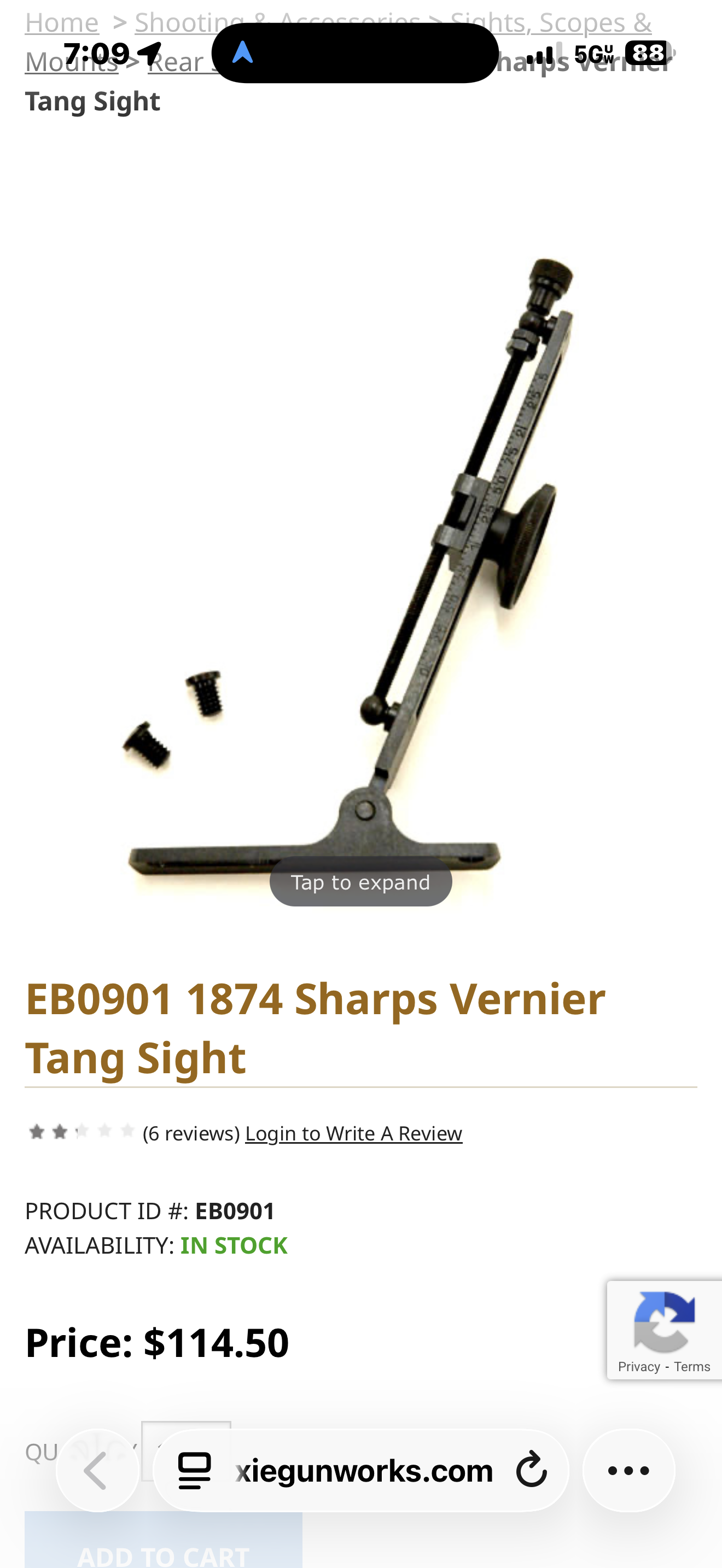

Buffalo Arms is a website you'll want to visit. As you've discovered, there's windage adjustment to be had.
These are pretty much my Dad's toys - can't give you brands. Obviously height of the stem is going to be important for how far you're trying to throw.
Most of what I've tinkered with is fine thread adjustment - you'll be lining up hash marks; there are no detent click stops.

Make elevation only is cake. The windage adds a ton of pain.

CPJ 2.0 wrote: ↑Mon Mar 30, 2026 7:19 pm So when the sight folds up or down it’s just held in place by friction?
Detents that guarantee a 90 degree to barrel, so the sight snaps into place when in the correct position. They are usually either adjustable on a generic model mount or set on a model specific mount.

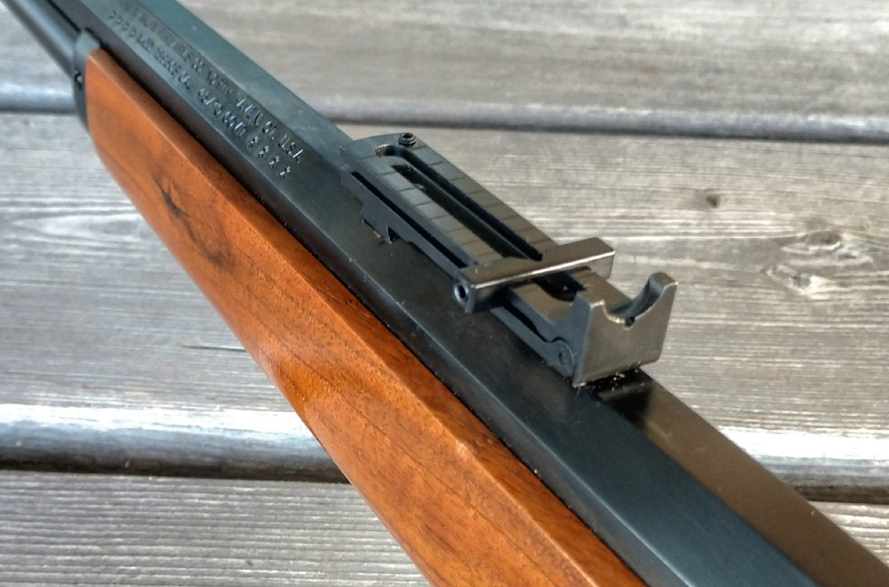

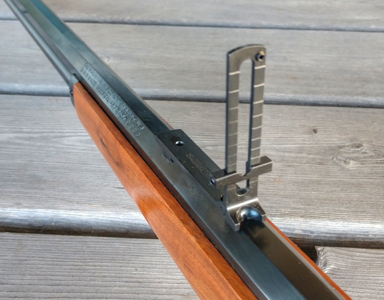

Something like this…
https://skinnersights.com/products/skinner-ladder-sight
Posts: 4471
Still a fair amount of work and can’t fine tune elevation precisely like the other type, but it’s much sturdier (not a bad thing considering the intended user) and it won’t disappoint after it’s on.
Posts: 4471
The small screw in top of the ladder is just there to keep you from sliding the bar off outright until you want to. The screw on the side holds a spring and a small ball bearing to provide smooth friction and detente type stops on the ladder.
Bonus, because it’s closer to the front sight you can get away with a shorter sight and still gain a lot of elevation adjustment, and it’s MUCH faster to deploy and adjust.
AND the screw on the actual part that slides into the dovetail can be loosened to adjust for windage which beats the hell out of a brass punch and hammer at the range.
