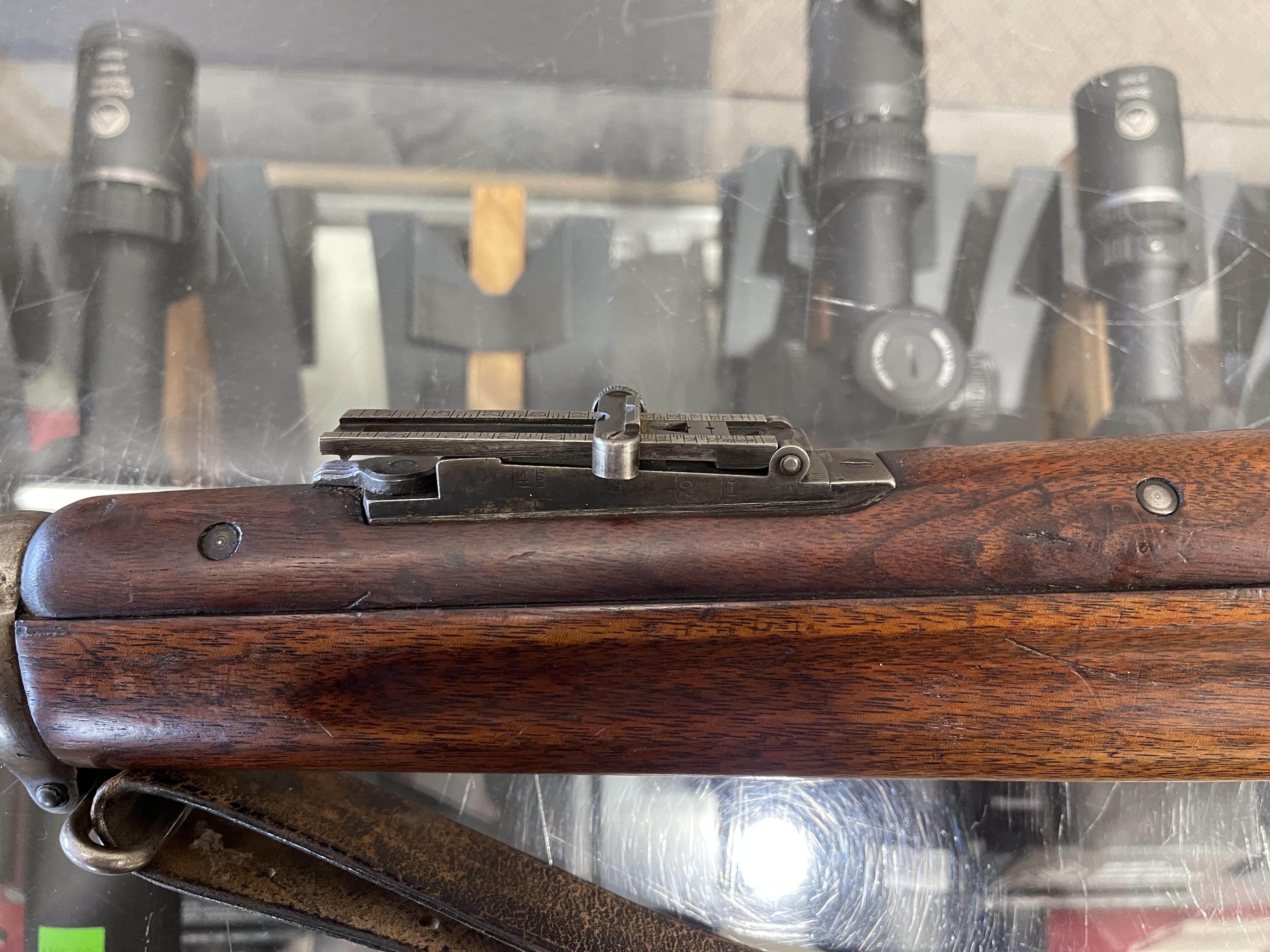

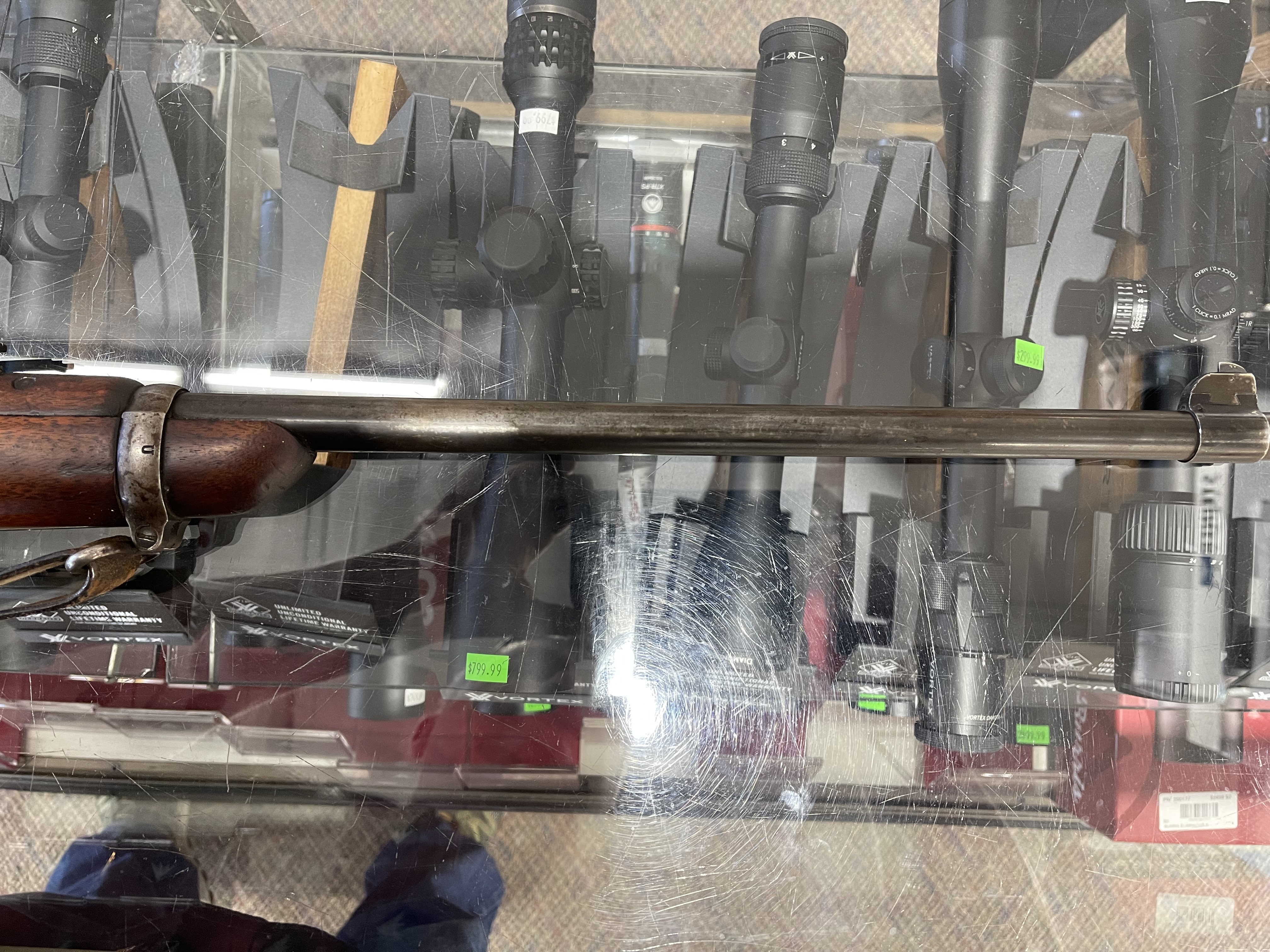

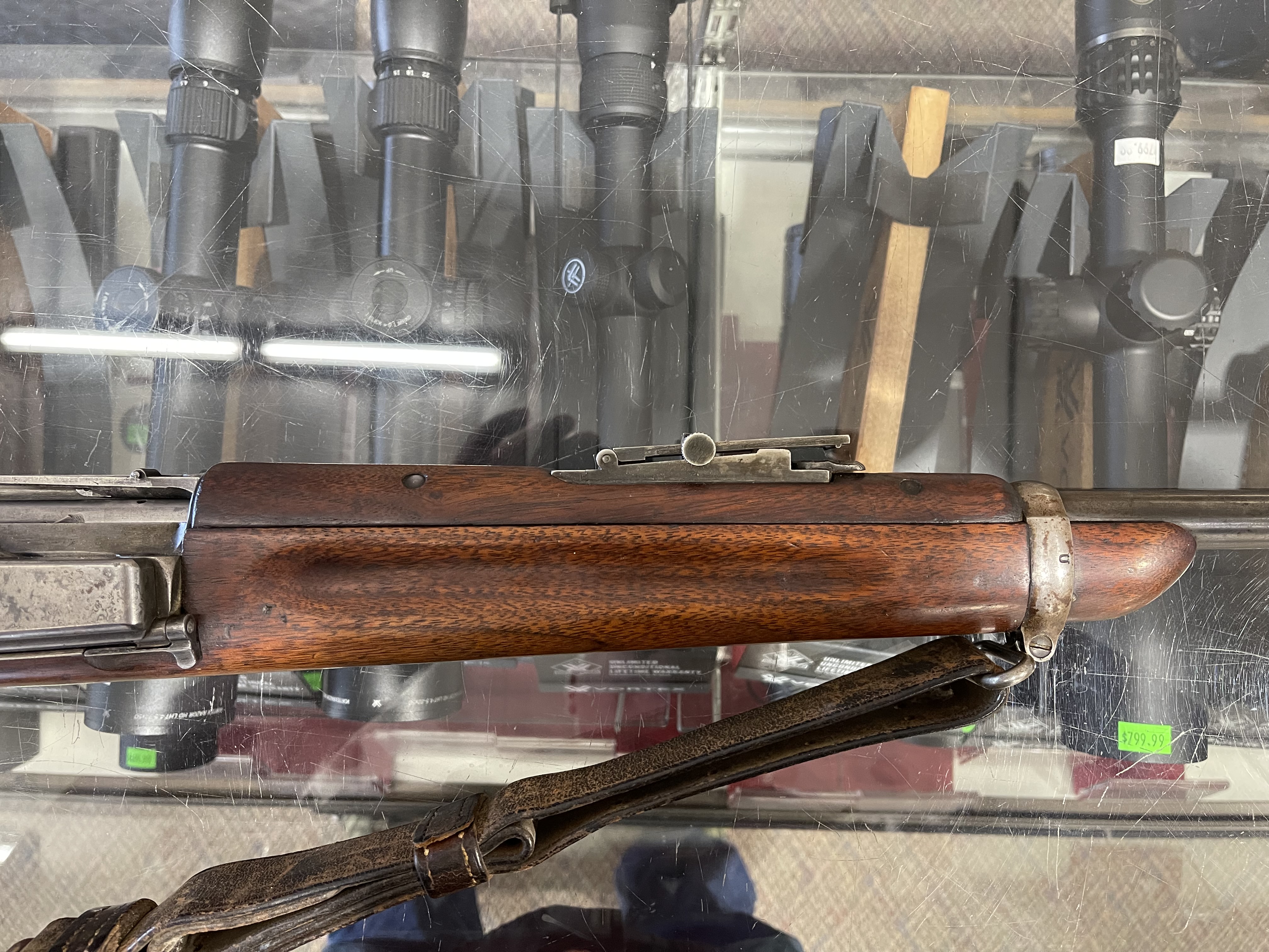

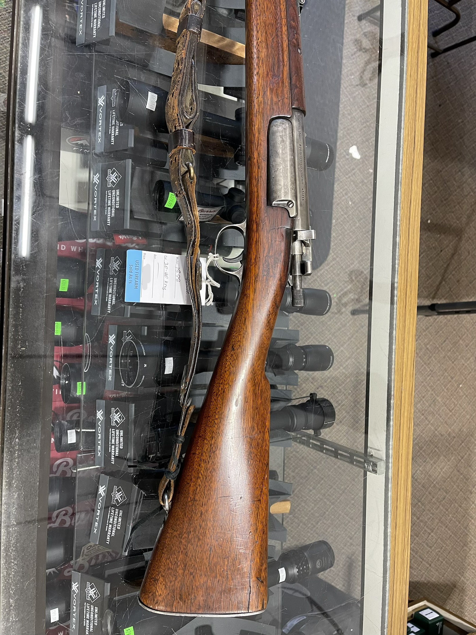

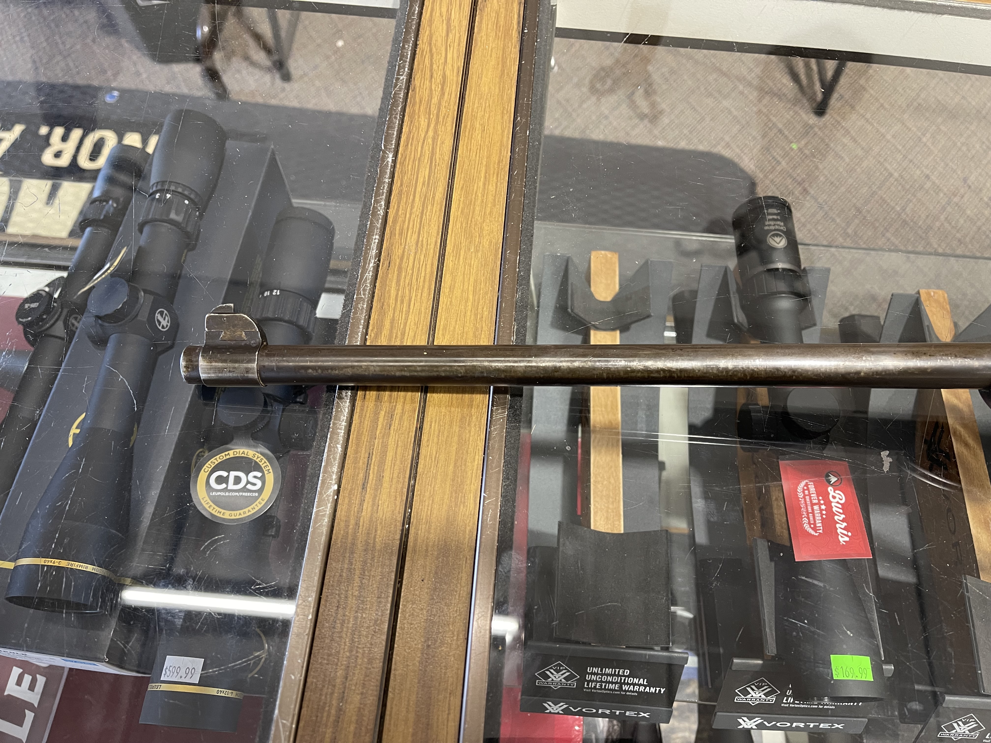

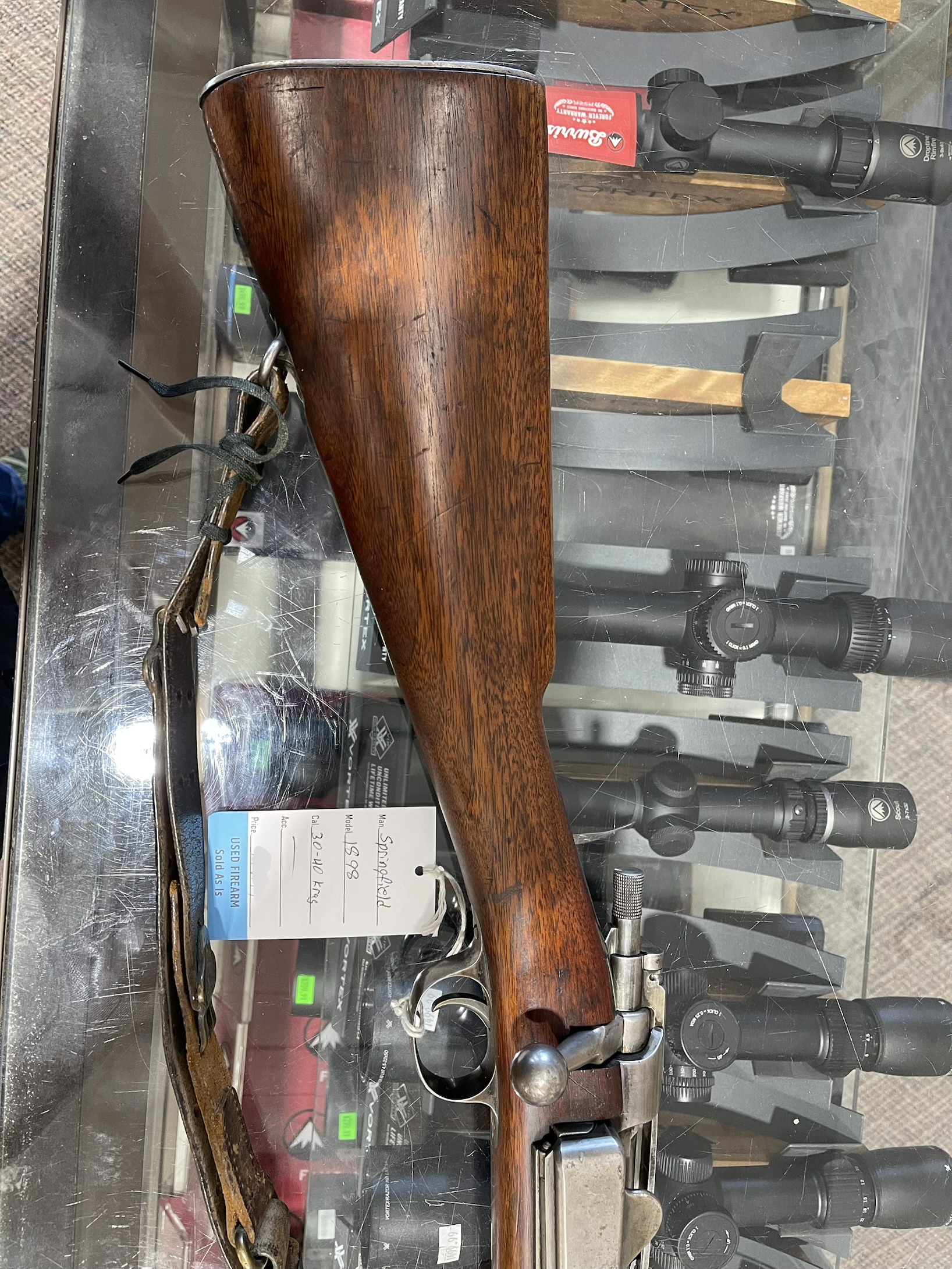

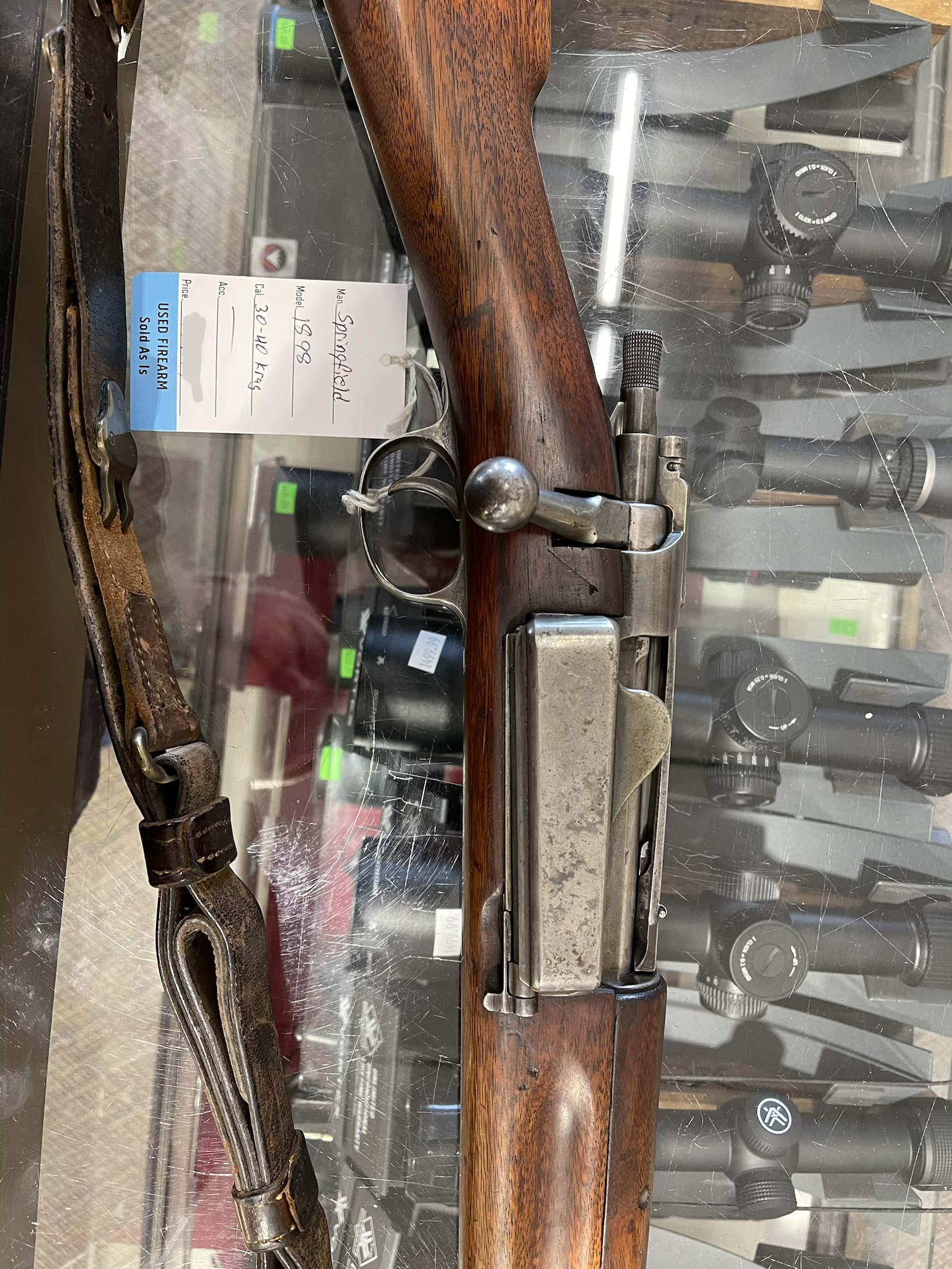

So what’s this? Has a 1901 sight 1902 cocking piece…. 22” barrel. What say you? Oh it’s “in the back” for inquiring minds….

Not a Krag expert or even close to one by any means, but your big question is "Is it an original carbine, or a cut down?"
Doing all of three minutes of surf-research, it looks like the carbines used a single point saddle ring on a bar at the back of the action on the left side, sooooo. . .probably a conversion (sadly, that seems to be most of them). Also, the forend in front of the band doesn't look quite right in the profile.
Rear sights. . .C&Rsenal did a vid or two on the Krags that would be worth your time. I recall a good bit of back-and-forth having gone on over deciding between the over-complex and expensive Buffington target sight and things that were simpler and more rugged. Some variations may be the result of that rather than accidental parts swaps.

I'm no expert but have seen a fair number, and refurbished a few sporters, a friend hunted with one. Your's looks original even with the mixed date parts. My guess this is a late production rifle. The kraig had a short 11 year service life and in 1901 they would hvae been working on their replacement, the Springfield 1903. The Kraig had a short service life because of it's rotary magazine, the Mauser stripper clip was a lot faster to reload and it's cartridge was more powerful. The government sold off it's inventory quickly and cheaply so many of the rifles didn't get the respect they deserved. The action is slick and the cartridge was good for deer and elk out to 200 yards. Too many of these guns were shot during hunting season then put back in the closet for another year without cleaning. Because of the corosive ammo of the day there aren't many of these rifle around with good bores.

Is there a filler piece for where the cleaning rod would have been ?

No it’s a carbine stock, no ring, but a true carbine stockJunkCollector wrote: ↑Wed Aug 05, 2026 4:12 pm Don't know jack

Ok, Krags are a weird thing. Short life but repurposed a lot.
Because that one is cut down and w/o a saddle ring does NOT mean its not a factory Krag. Many were cut for prison use and for Philippine troops. Some went to WW1 for rear echelon, US troops. Others went to NG. You can rabbit hole the sights to stock to receiver, gather all the information that there is available, and still be wrong as to provenance.
100% guess, but I would put that one as a repurposed prison rifle.
Get a 30 cal 200-220 gr bullet, and lob it at about 1600 fps with 4895. The LOOOONG bullet can help a lot because the Krag bbls were not known to be all that symmetrical. They are 308ish most of the way through the tube.
Action is like rubbing 2 plates of glass with KY in between though.
