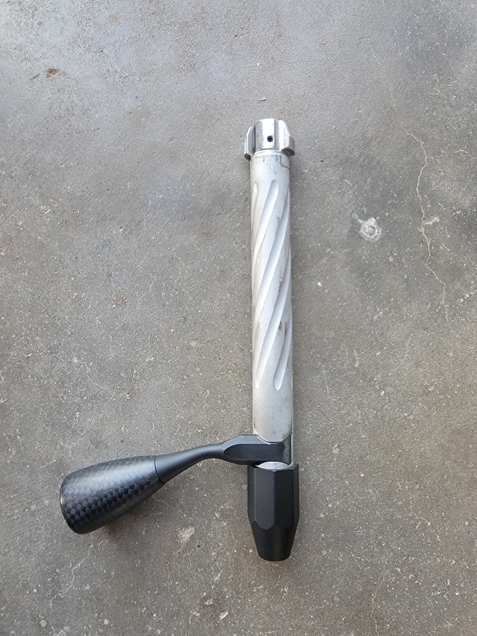

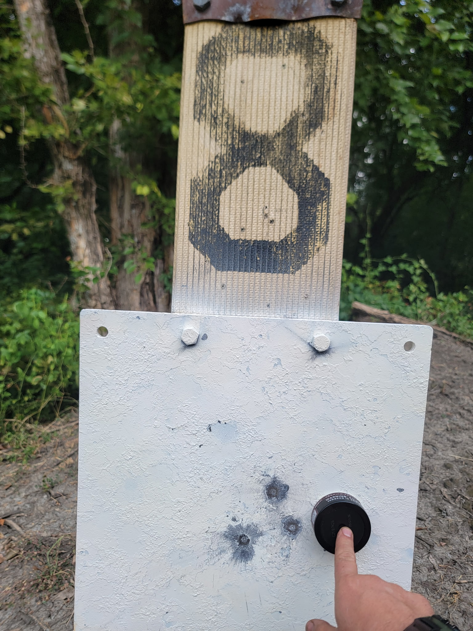

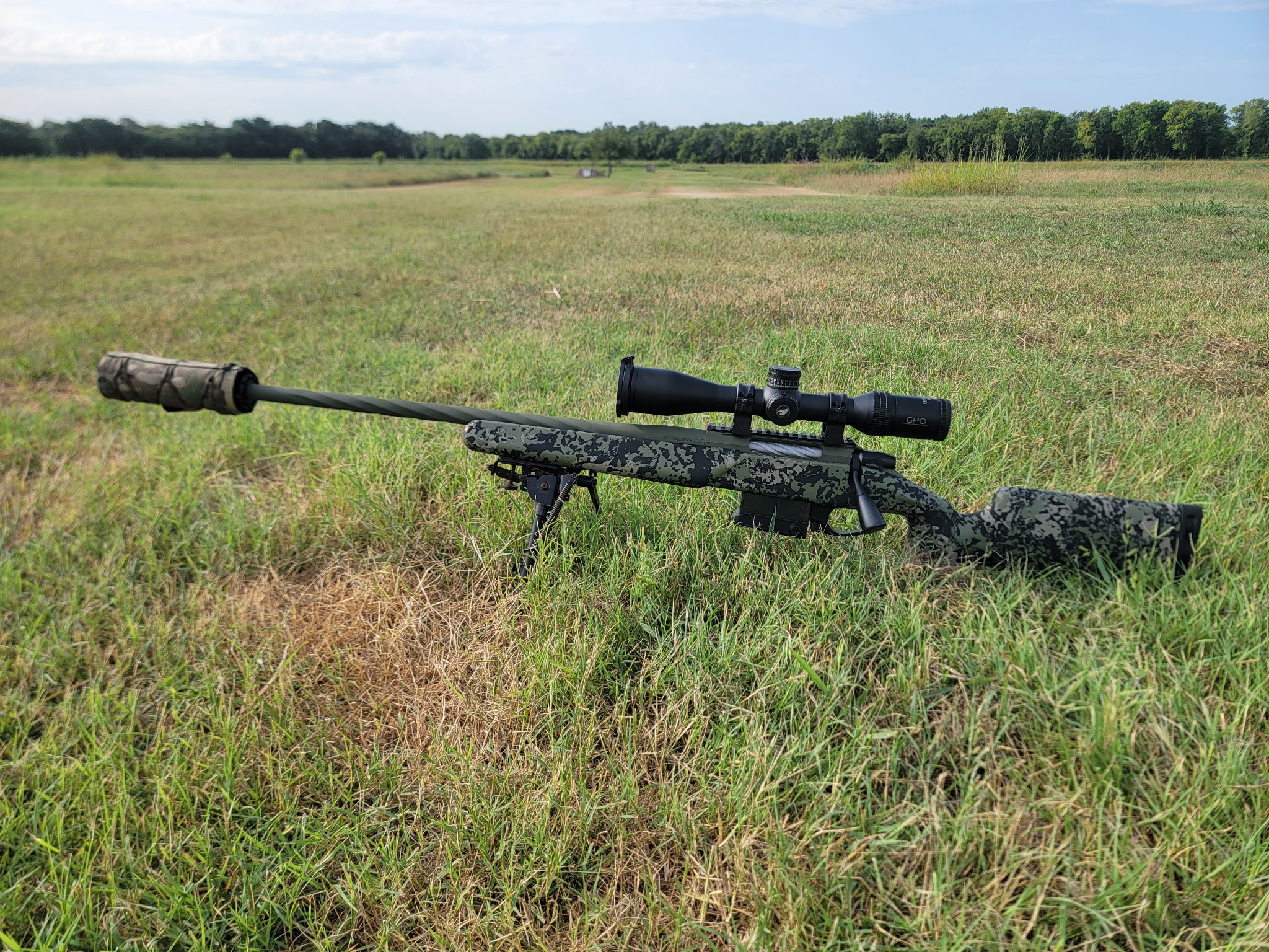

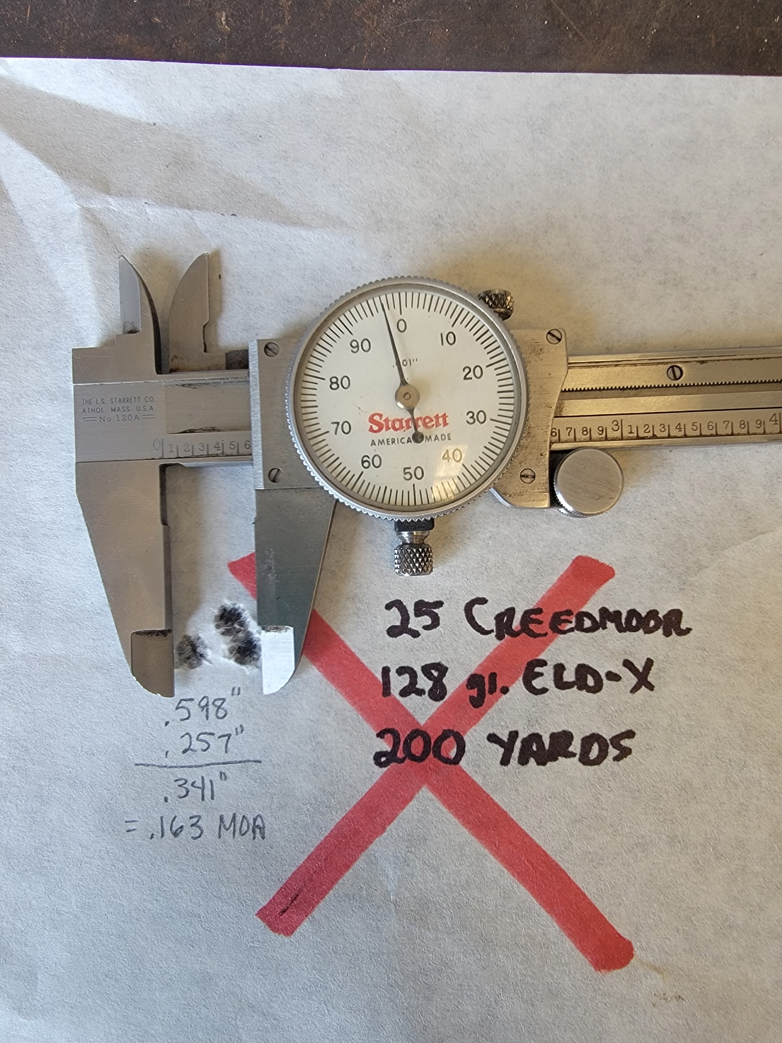

My new rifle and load work is done. Nothing short of outstanding. Doped to 800 yards which is the furthest distance of my gunsmiths range.
Caliber 25CM
Action - Left-handed SS Tikka Action
Stock - Iota LH Tikka EKO Textured finish in green olive color pattern. Iota is the stock maker for Horizon rifles
Flush cups added to the stock
Barrel - 22" SS Krieger 1:7.5 twist with sprial hex flutes which is wicked cool looking if you ask me
Trigger - stock for now will be set to 2 lb crisp
Aftermarket metal Tikka CTR, not the factory plastic bottom metal
After market SS swept bolt handle with carbon fiber bolt knob
After market SS Bolt Shroud
Bolt will be fluted in a smaller spiral hex pattern
Barreled action color Cerakote Sniper Green
Bottom metal, scope rail, bolt handle, bot shroud and mag release Cerakote black
Scope - GPO Centuri 3-18X44mm SFP MOAi reticle
Scope rings - Area 419 Hunter rings
Suppressor - Omega 300 DT

Well it shoots better than I can see and hold.
Winner
Posts: 1822
Re: New Rifle build is done, outstanding range report
That’s awesome!
Posts: 2942
Looks to be a well built hunting rifle.
Posts: 699
Looks great! I may just have to buckle and toss my T3x CTR into one of those stocks.
Posts: 530
In the fun zone...
Posts: 4372
That is a very nice rifle!!! Congrats on a successful build.
Posts: 1822
Outstanding!!!
Posts: 1395
Great build, congrats
