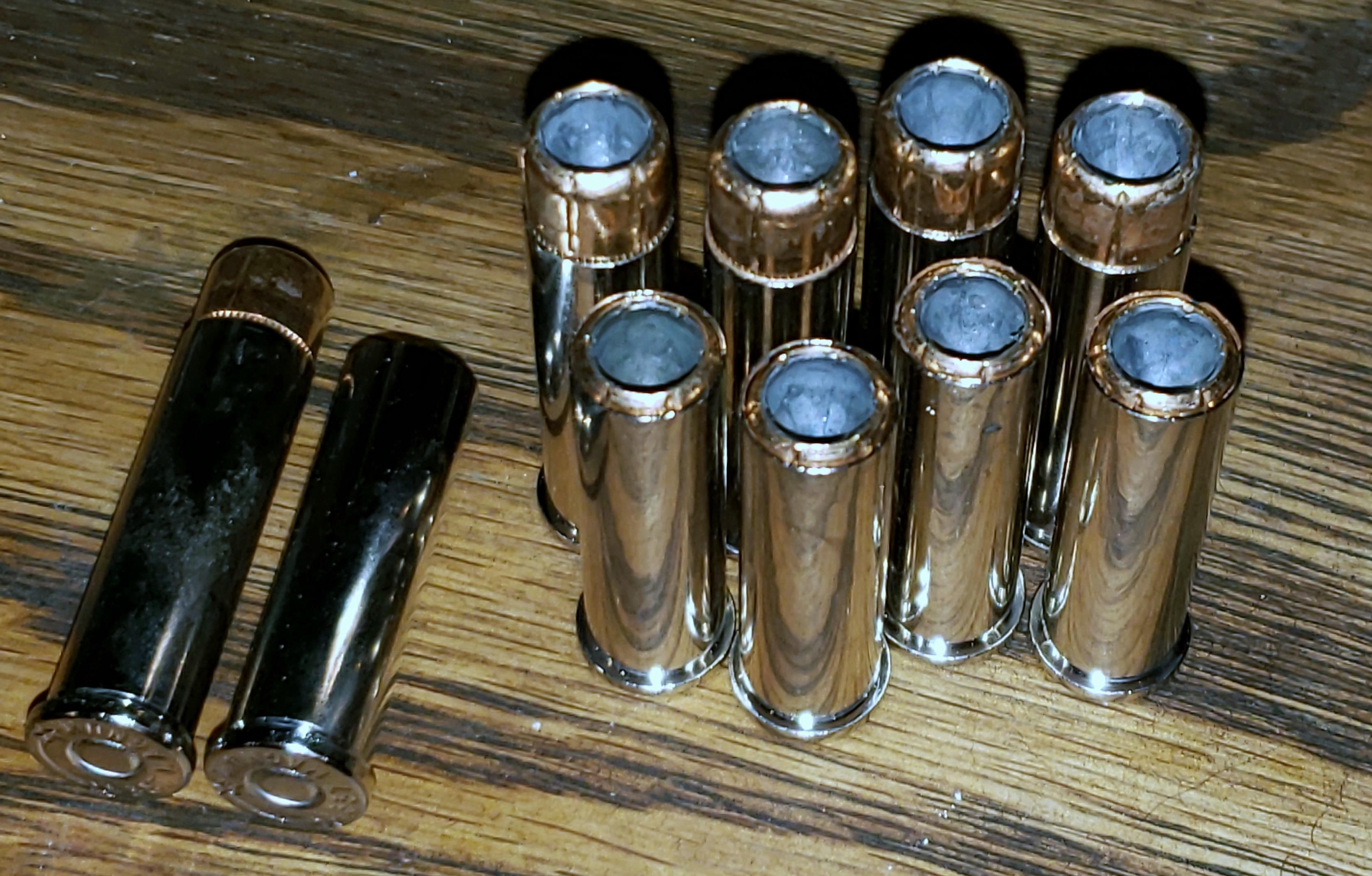

I have fired the HBWC loaded backwards into water. They do not expand at .38 Spl velocities. This is more about seeing if they are more likely to tumble with the weight at the front or at the rear.

However, if you do want a HBWC that will expand bigly at low velocities, Matt’s Bullets is what you seek. In .45Colt, it opened up to damn near an inch in diameter in Clear Ballistics:

bullsi1911 wrote: ↑Tue Sep 15, 2026 2:52 am I have fired the HBWC loaded backwards into water. They do not expand at .38 Spl velocities. This is more about seeing if they are more likely to tumble with the weight at the front or at the rear.
Oh I’m not thinking .38 spl velocities. I can make those into laser beams from a Ruger .357 😈

I stocked up on the left over HST HBWC from the 38spcl +p when Fed dropped them.
Accuracy SUX, but they expand and hold together nicely even at magnum velocities

bullsi1911 wrote: ↑Tue Sep 15, 2026 2:59 am However, if you do want a HBWC that will expand bigly at low velocities, Matt’s Bullets is what you seek. In .45Colt, it opened up to damn near an inch in diameter in Clear Ballistics:
https://www.mattsbullets.com/215-Grain- ... p_171.html
Between the Hydrashoks, and HSTs, I'm pretty well covered on reversed HBWCs
Back in the day, they used to warn about pushing the swaged ones too fast. Probably not an issue with the plated ones though
It didn't take much Unique with the flush seated ones in the magnum cases

The swaged and any soft cast bullets are a problem at magnum speeds because of severe leading. Plating and powder coating make it a non issue like I mentioned with the .458 bullets I’m running north of 1500 fps.

Maybe. Depends on the lead alloy they're using.
Tin will mix with lead pretty much like water and soap. Tin will make the alloy tougher and "chewier". It will harden the lead, but at a really low rate for the amount you need to add. If you want really nice expansion at handgun or BPCR velocity, you use what we call a "binary" mix of lead and tin only.
Antimony hardens lead a lot more efficiently than tin, but it doesn't mix in as easily (that's a foundry-only job) and has a crystalline structure. Depending on how much is in the mix, bullets can tend to shatter on impact, or the thin bits comprising a hollow point's nose can start breaking off, leaving the base to penetrate on.
Old school wheelweights are about 2%-3% antimony and 1% or less tin. A pretty common mix is to take wheelweight and add 2% extra tin. Makes for a pretty tough mix that you can get some expansion out of a magnum handgun speeds. Guys running slower will go 50-50 wheelweight and pure lead, then add some extra tin to get the mold to fill out better, and yeah, more likely to expand at sub-1000 fps.
Commercial cast bullets not intended to expand tend to run harder (A.) to avoid getting dented up in shipping and (B.) antimony is a lot cheaper than tin. Your HBWC's don't have a thin enough skirt to be likely intended for expansion, and the plating will add more hardness still. Dunno. If they're soft enough, that thick skirt might give some gradual expansion, which could be a good thing. My guess is they're stay un-deformed.

Umm NO,
with the swaged HBWC loaded backwards and pushed hard, the fear was "shooting through" the "skirt" and ringing your barrel.

I question this. In order for you to turn the inny into an outy, the resistance of the bullet moving through the bore would need to be greater than the pressure required to blow the butthole out of a wad cutter. Methinks this just may be folklore

Have never seen a case or heard of this before. I think it would have to be a super soft and thin "cup" to even get there. But hell what do I know. The only issue I ever had with swaged bullets were with a box of cold swaged .45 230Gr RNs that I got for free from a friend and being unwilling to throw out anything I decided to use them for SASS in .45 Colt cases. If I pushed them even at relatively modest speeds these things would lead the barrels of my vaqueros something fierce. I did make hundreds of mouse fart loads out of them and shot them for years at the ranch whenever I had kids that wanted to shoot big bore cowboy guns.

CPJ 2.0 wrote: ↑Tue Sep 15, 2026 4:01 pm I question this. In order for you to turn the inny into an outy, the resistance of the bullet moving through the bore would need to be greater than the pressure required to blow the butthole out of a wad cutter. Methinks this just may be folklore
Quite possibly, but I know for a fact that the same writers that supported loading them, gave warnings about it.
If I could find my boxes of 70's-80's GA and Shooting Times, I could direct you to exact writers

Skeeter Skelton in his "Hipshots" column in the mid/late 70s
Slight correction, it wasn't the base going through the skirt, it was blowing THROUGH the base he was worried about, my apologies.
Same basic result though. Next round Fubar
Find his 1974 article titled "The .38 Special: The One You Can Live With"

Hornady swaged HBWCs backwards, too slow to expand, didn't tumble
