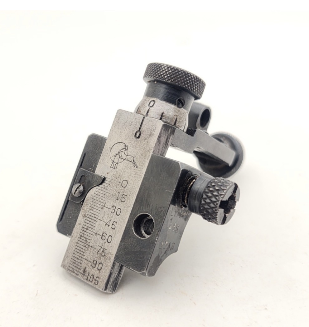

I picked this up to flip.
Apparently these are gold
Big Al may have known not sure what happened with him ?
I don't see how it would attach
It seems orientated wrong.
With windage seems to be a #38 varient.
Anything I look up seems wrong
Help
Some pictures maybe it's just brain cramp
Help

You only have half a sight.
All you have there is what's called the slide assembly. The dovetail with the deer logo and elevations marks on it inserts into the base which is bolted to the rifle's receiver. The base will contain a push-button quick-release that engages on the threaded elevation stalk. This allows you to separate the slide for transport, cleaning etc... The base will have an adjustable pointer that you can set on the "zero" mark once you get your load dialed in which gives you a quick return-to-zero ability when re-installing.
Depending on the model, some of them will attach to the receiver's right side - - notably the Lyman 48's which are for the Mauser-based actions where the left side of the receiver is occupied by the ejector/bolt-stop assembly.
Odds are, that slide will fit into the base for a wide variety of right-side Lyman models.

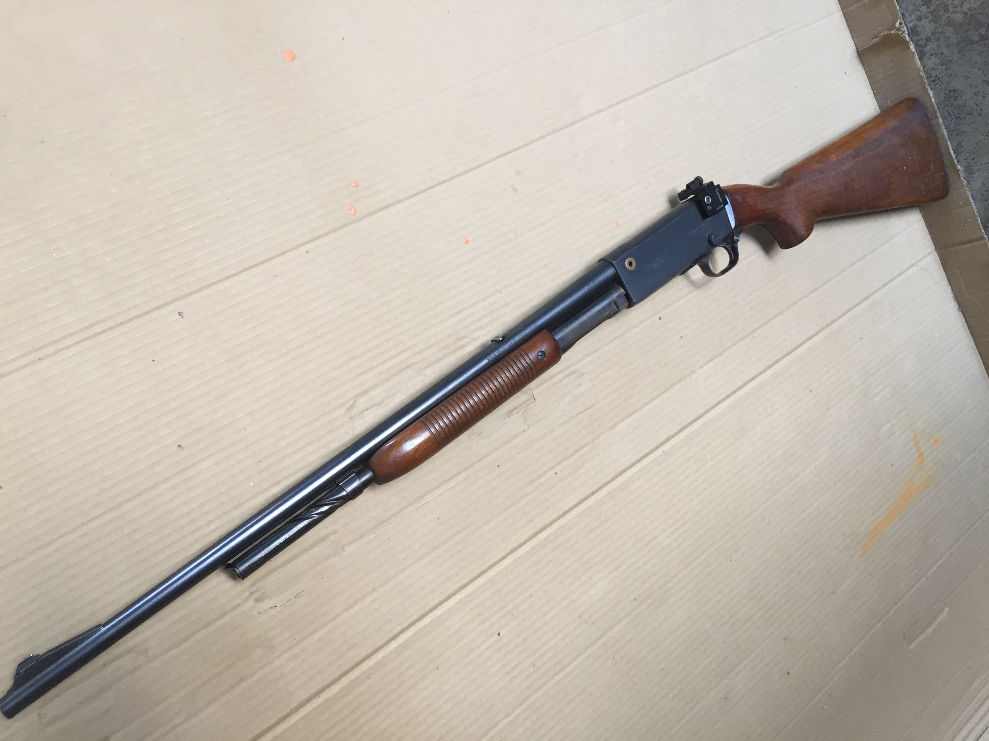

The gun would have been a remington model 14/141
I get it...now to figure the gun
Re: Lyman 21 C ......I can't figure it out
I can help there, what do you need pics of?

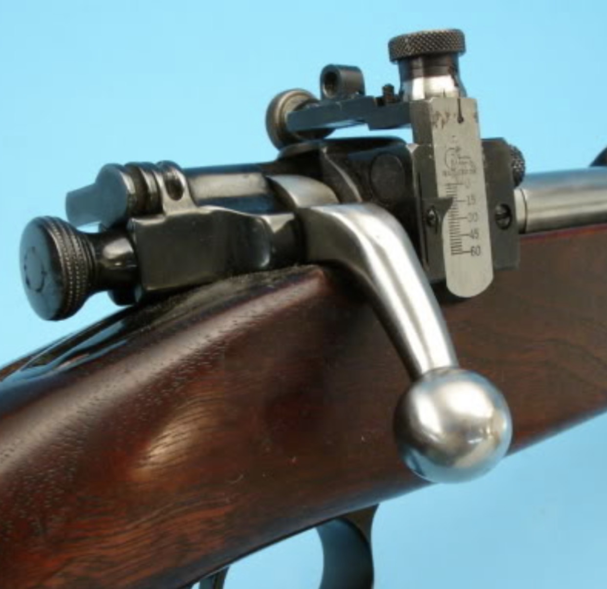

Obviously not the same sight but probably comparable in form and function.

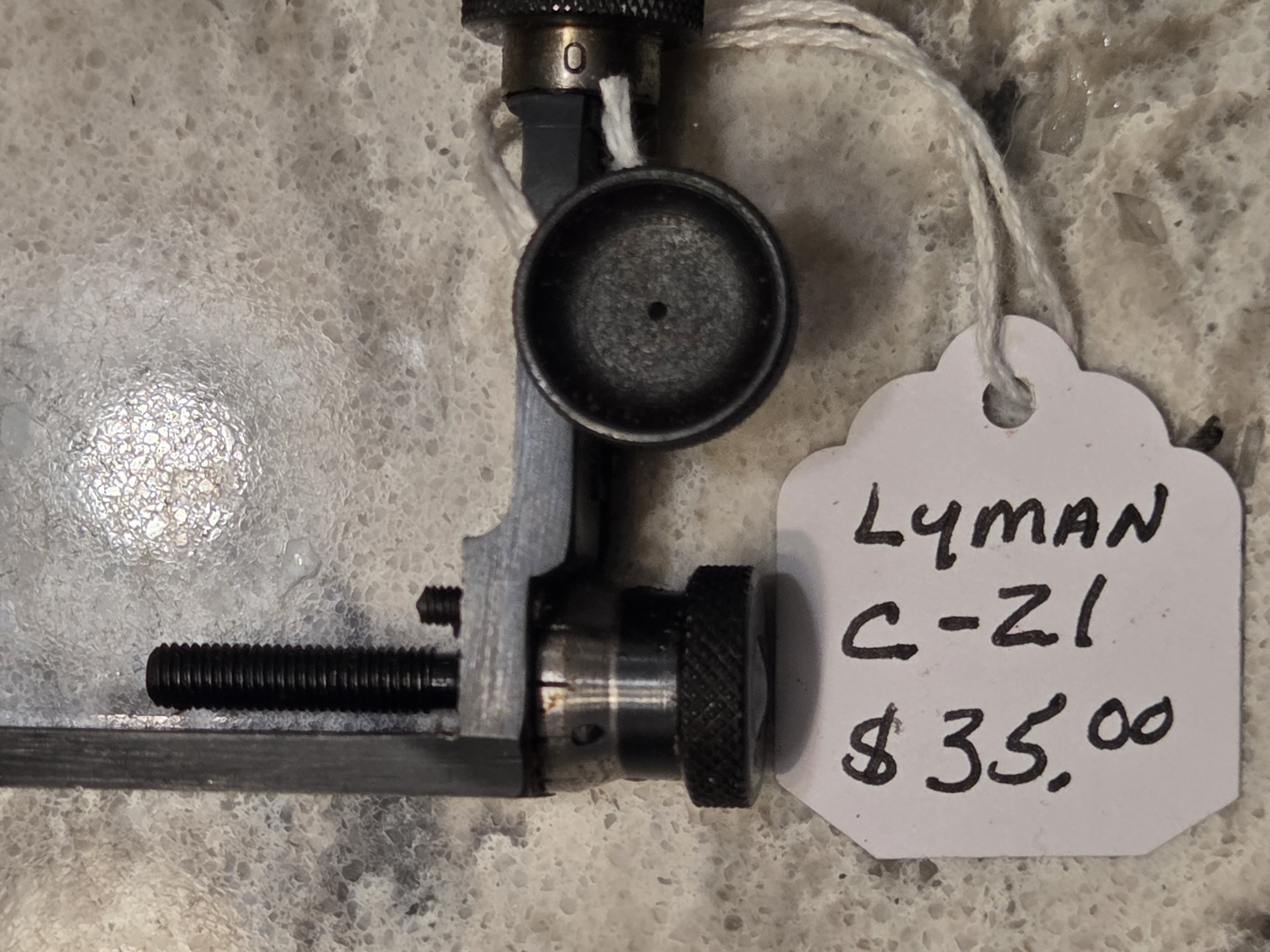

I found this in a few of the searches
It's half of an odd duck
It's definitely marked as a 21 C
The 38 varient has windage
Mounted on the right hand side was only the remington model
Lyman No.21 - patented June 25, 1895, and originally intended for the Winchester Model 1895. Later it was adapted for use on Winchester Models: 1886, 1892, 1894, 53, 55, 64, and 65; Marlin Models 1893 and 1895.
Lyman No.38 - patented July 25, 1899. Originally adapted to the same models as the No.21, with the addition of the Remington Models 14 and 141.
Production for both ended in 1943, as well as for the No.41
He had a few other oddball ones.
One was for an m1
One was for an m1
- Posts: 4368
That’s a Lyman 48, regardless of markings or tag.
Sorry this is a Lyman 21 sight. This is an expensive sight designed for the Winchester 1895 original then adapted….. what you have is as our esteemed colleague said, Lyman 48.
