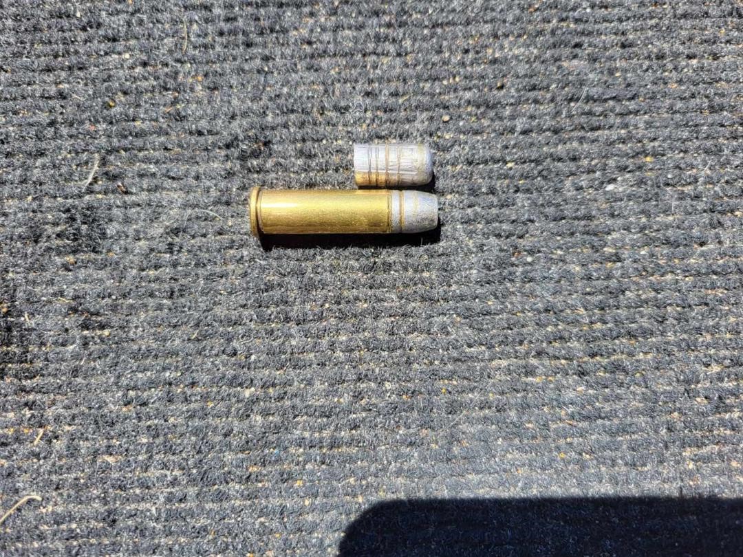

Re: Cast Some Hollowpoints Today
Some of the more recent acquisitions...
Bullet on the right is from one of Veral Smith's (LBT) molds, and it's about the slickest feeding 230 grain .45 Auto bullet you could ever hope for, but. . .conventional lube. After some careful measurements and comparison, I learned that the Accurate 45-230H on the left is samey-same, but with tumble grooves. Ordered it to cast at .452", and one production step omitted.
This one's my creation. I asked Tom at Accurate to take one of his pre-existing tumble lube designs and tweak it to have two crimp grooves for working with either .38 Special or .357 Mag brass.
The hollow points are set to fly into jugs tomorrow. Hopefully, I'll have good news in the evening.

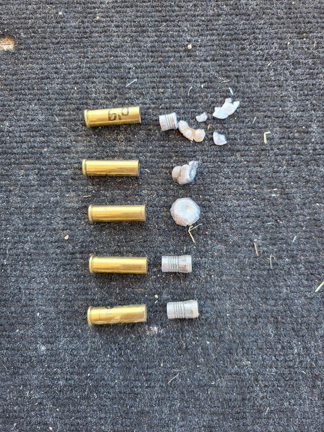

Accomplished some great science with the HP's today:
Top to bottom is fastest to slowest, and I got the full range of effects. Average velocity for the load was for five shots we fired over the chrono after I did the jug bust.
Top: 891 fps. Sheared off the nose cavity and went five jugs
Next: 836 fps. 3 jugs with lopsided expansion.
Middle: 760 fps. 4 jugs with perfect 'shroom.
Bottom two: 669 and 572 fps. Started to push the nose back, but not enough speed to start peeling open. Down in the 3-3.5 jug range.
Also shot the solid from my new mold:
597 fps and five jugs. Shoved the nose backwards and rounded the corners off slightly. Went from a WFN to an ogival wadcutter.
These were all shot in an all-steel Smith 640, but there's a scandium 340 coming. Slow solids for comfort may end up being the thing, but some testing with that one will be required.
The big score for the day is we now have a solid read on the expansion threshold for an alloy mix that we are really liking the behavior of for 1100 fps and less loads. Anything but the truly pokey stuff - it looks like it's gonna do well. Keeping the faster ones together will merely need more tin. Happy days!
836 fps, #2, lopsided because a subsequent jug was torqued by a previous jug impact? That is pretty cool hey.
Negative. One shot. Remove damaged jugs. Anything able to hold water gets moved to the back of the stack to serve as an extra brake. Refresh the head of the line with new jugs. Not sure what went on there.

Looks like you found the right speed. How does it do on accuracy, or hitting point of aim in the little gun?
Pretty much on the sights for the little 10-ish yards of screwing around ammo we had left after the jug and chrono work was done. The 640 and GP-100 on hand had no complaints, but how that's going to hold up out of a scandium gun is TBD.bullsi1911 wrote: ↑Sun Aug 20, 2023 9:29 pm Looks like you found the right speed. How does it do on accuracy, or hitting point of aim in the little gun?
Nice to get there with a pretty cheap alloy. Works out to about four ounces of tin added to 20 pounds of what used to be jacketed bullet cores picked up off various berms to get the mold to fill out.
