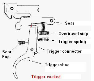

The two inherent issues are (1.) the trigger connector:
The original trigger itself is just a MIM casting - not hard enough to incorporate a sear engagement surface. That's where the trigger connector comes in. It's a hardened steel stamping that rests on the front of the trigger and provides a surface to hold the sear up in engagement with the cocking piece. Guess what holds the trigger connector in place? Nothing but pressure from the two adjustment screws on the front. Nope - not even a dab of glue. Now start to think about what might happen if you start making adjustments that involve backing those screws out. Yep. Your firing pin is now held in the cocked position by a sear that's being supported by a free-floating part. :o
The (2.) issue seems to frequently be that all of those parts in the diagram are held together in a stamped steel box that fits against them fairly snugly on the right and left sides. Get some good old 3-in-1 oil or WD-40 in there and let it dry up for a few years to compromise the normal movement and interaction of those parts.
Basically, you've got a really burly firing pin spring being held to the rear by. . .a not terribly foolproof pile of not very damn much that's supposed to be pushed into place by some very tiny springs in that tight fitting box prone to gunk freezing. It can give a sweet trigger pull and fast lock time when it runs right, but it leaves a good bit of room for stupid to come in and play.
