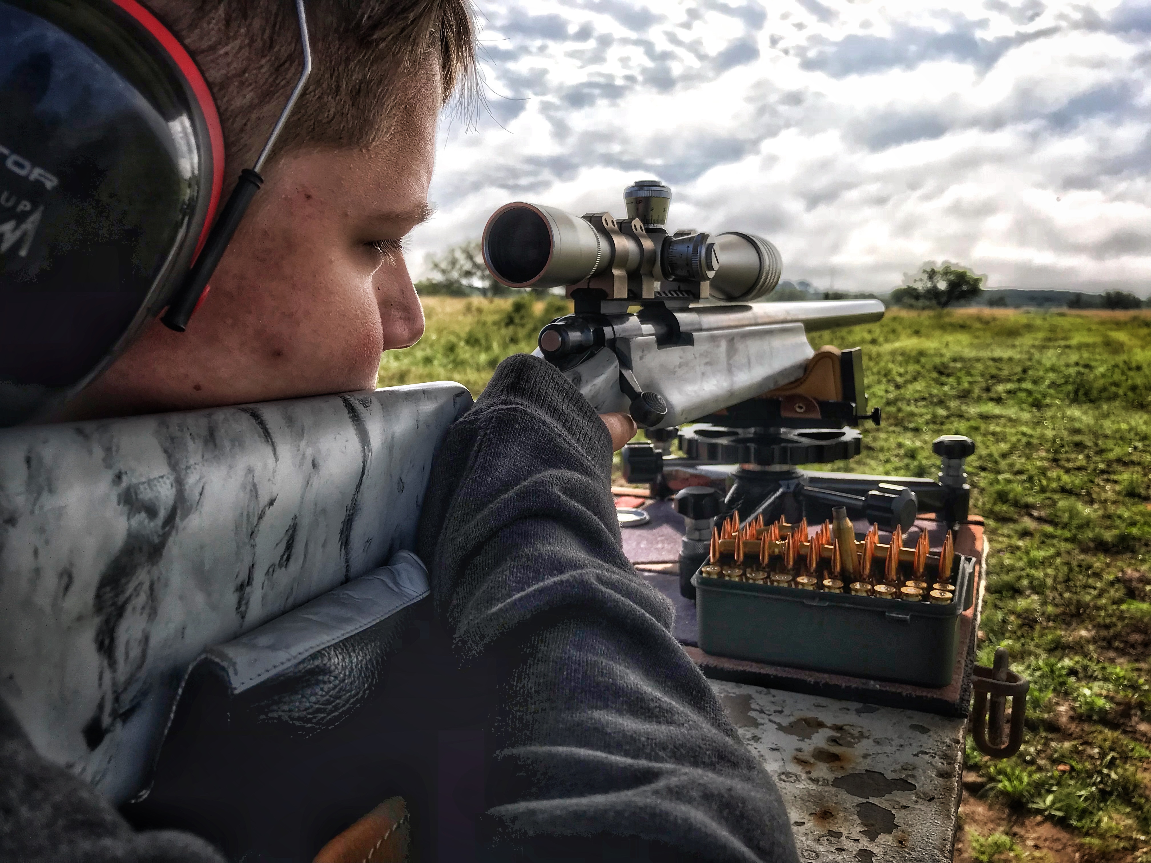

My boy and my father shooting 800 yards several years ago with my 32” Krieger Full Bull .260 Rem on 40x Action w/ 3oz Jewel and McMillan stock.

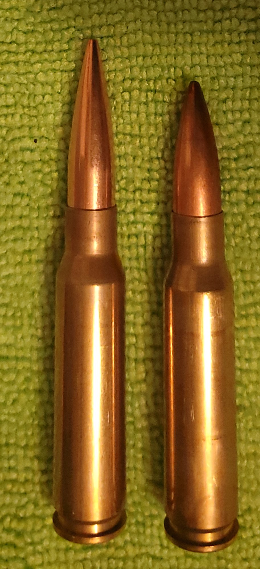

Another important aspect of LR rifle systems is the ammunition used. Below, you see two of my handloads. On top is my 1000-yard match load, consisting of a processed Berger 200gr bullet in a lovingly prepared Lapua Palma case. This one is on its fifth load. On the bottom is one of my test cartridges with a 175gr Nosler CC in a prepped Winchester case. The 175 Nosler impacts by thermometer (tall) target at virtually the same elevation as my Berger 200gr bullets at 100 yards. It's a great method to set up my scope for 1000-yad using test ammo for the initial shots on target.

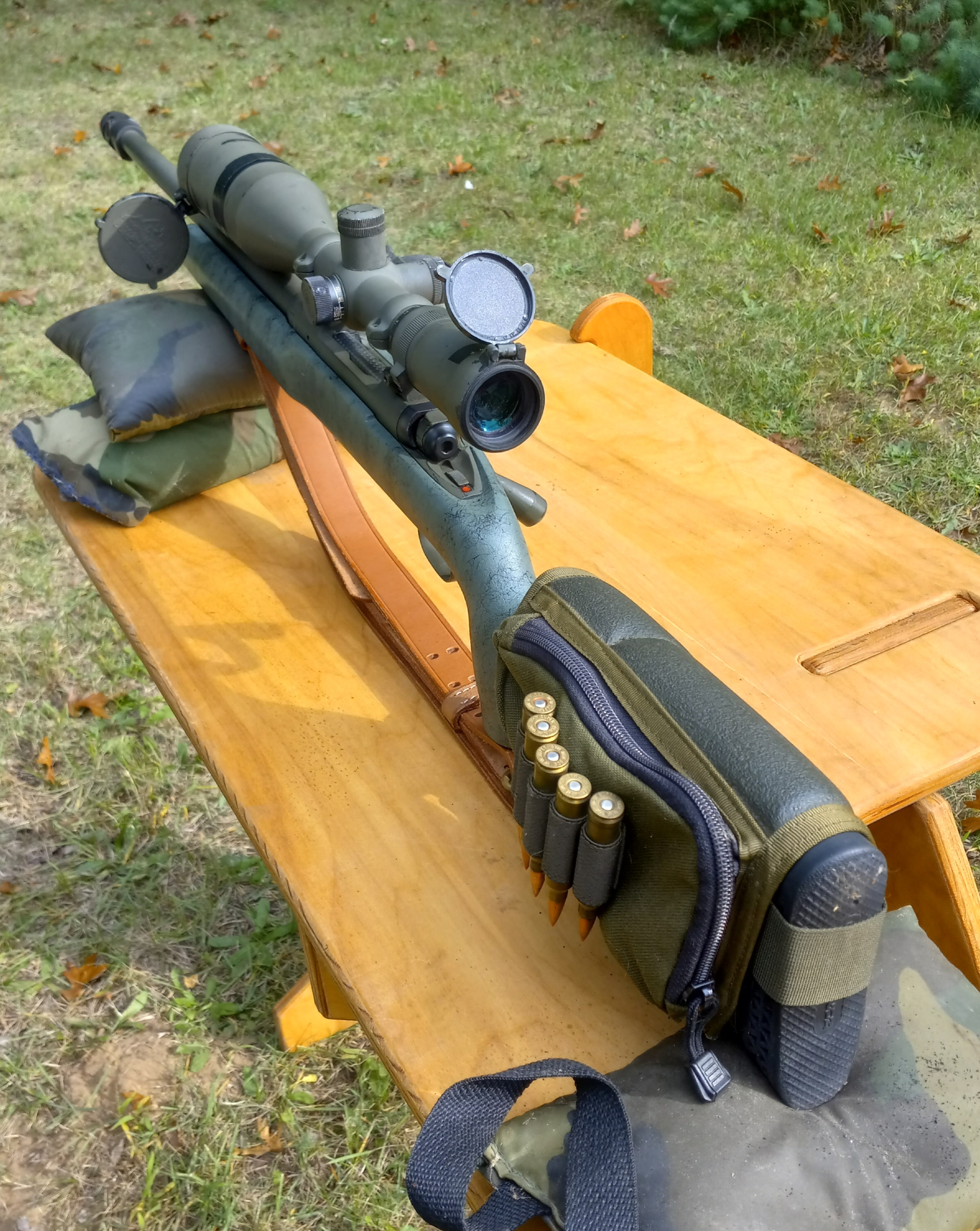

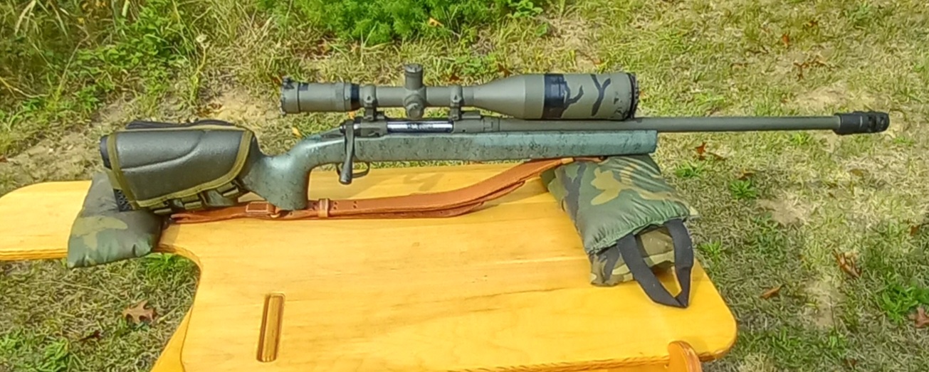

A golden oldie...one of the Savage Sisters
Savage 10FP 20" .308

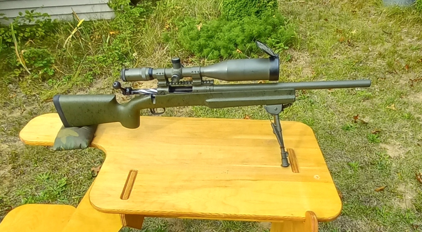

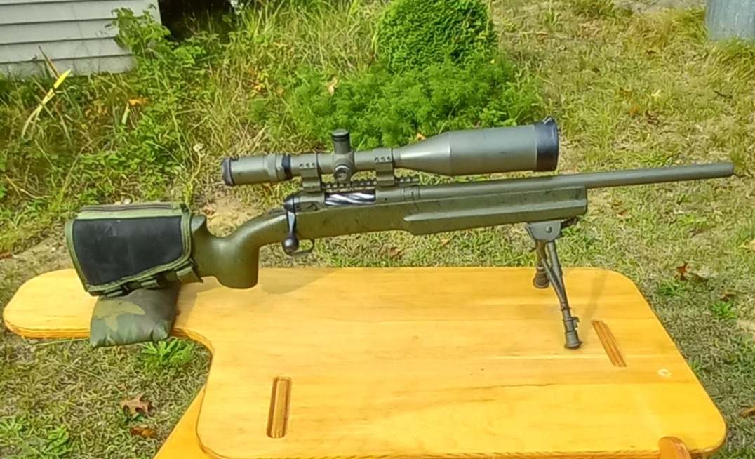

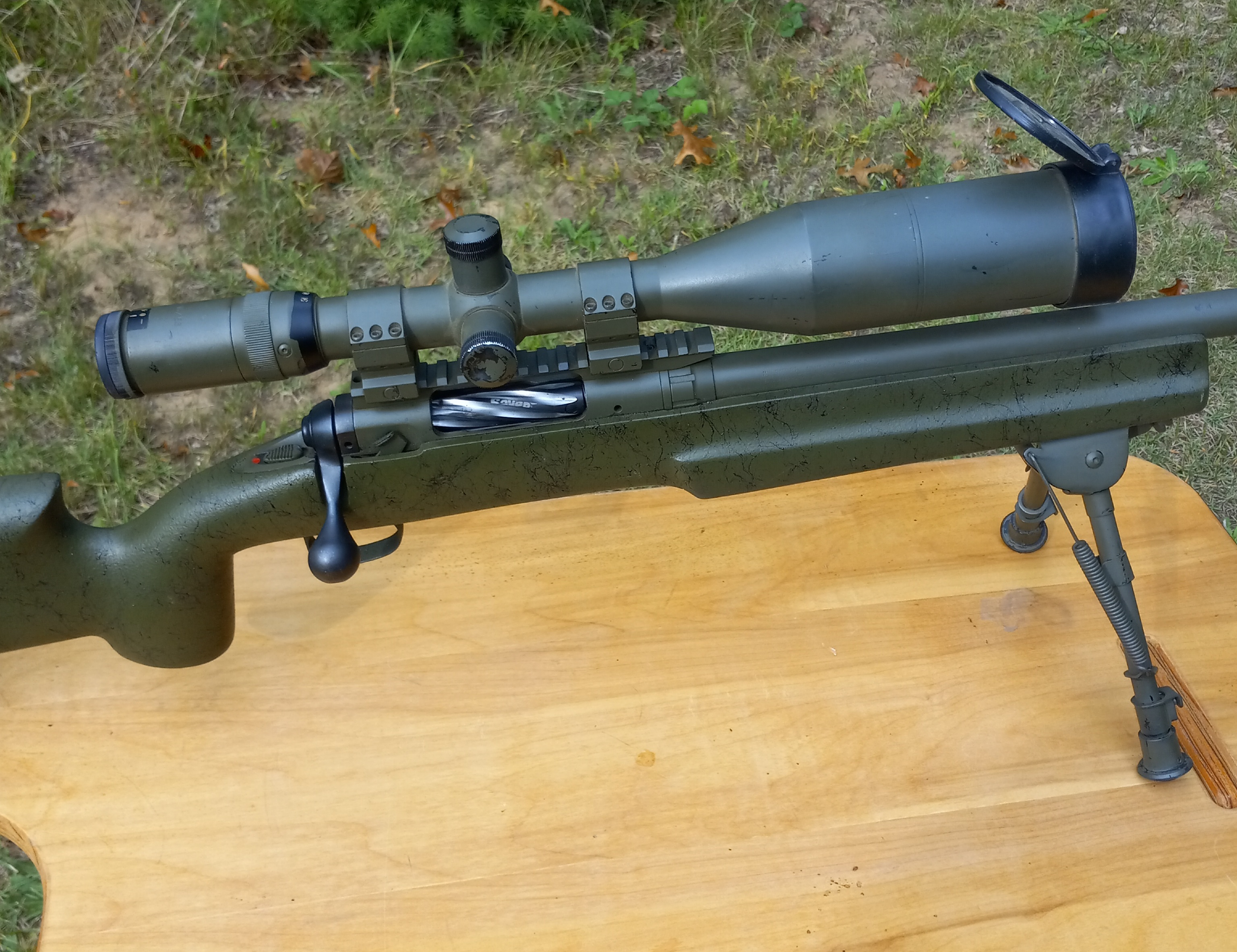

The other Savage Sister...Savage 110FP .300 Win
Mag...

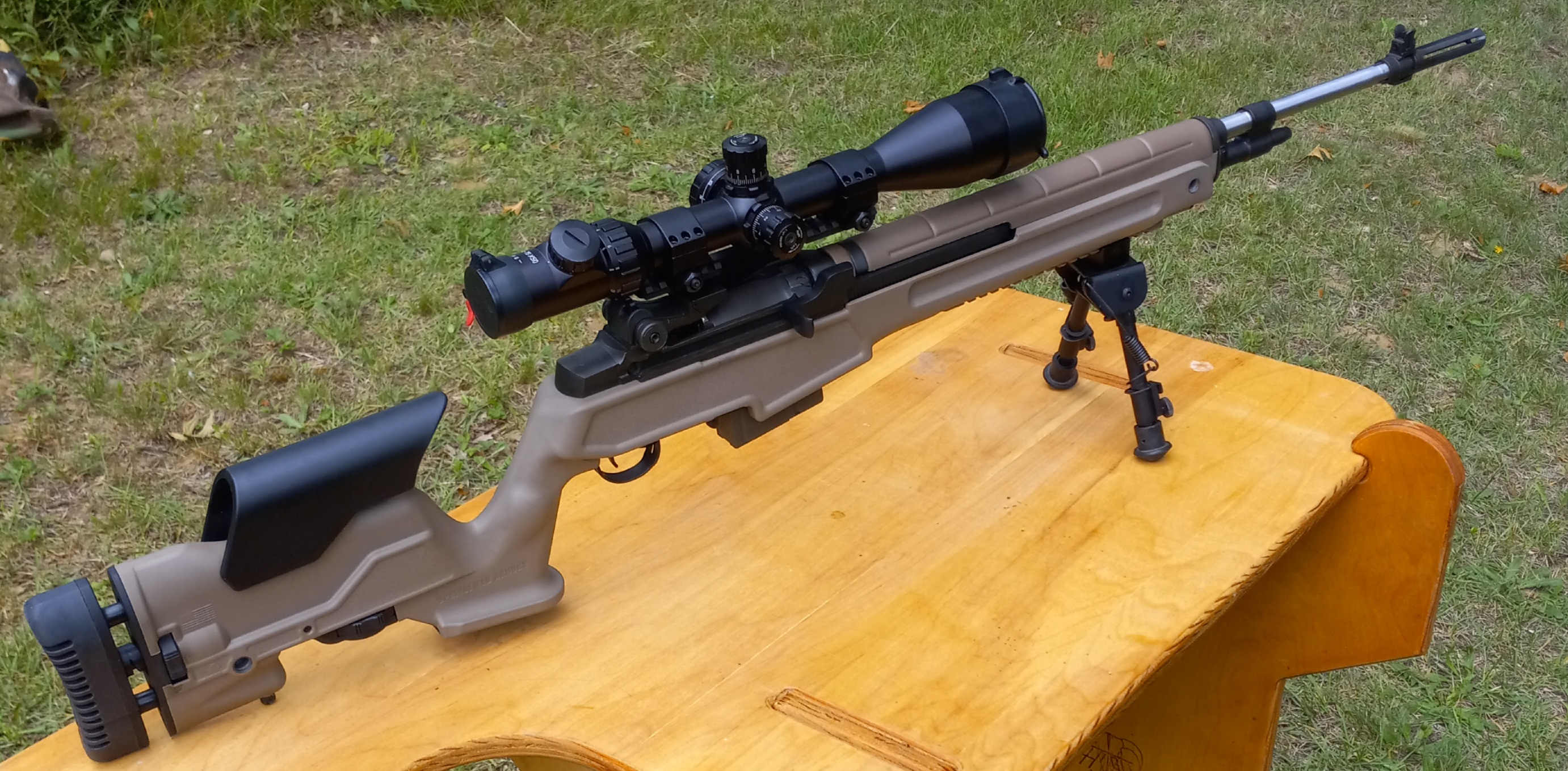

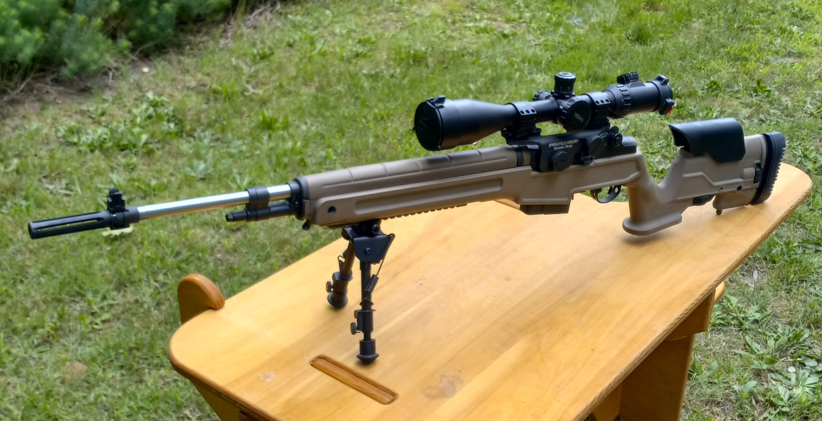

My most recent acquisition Springfield M1A National Match , .308 (of course) in an Archangel stock...I have yet to determine how much of a " long range" rig she is.....

I like that last one you show, Jayhawker. I'm partial to wood for the classics, but that's an interesting chassis and probably help when using the scope.
Looking forward to reading about how it performs.
