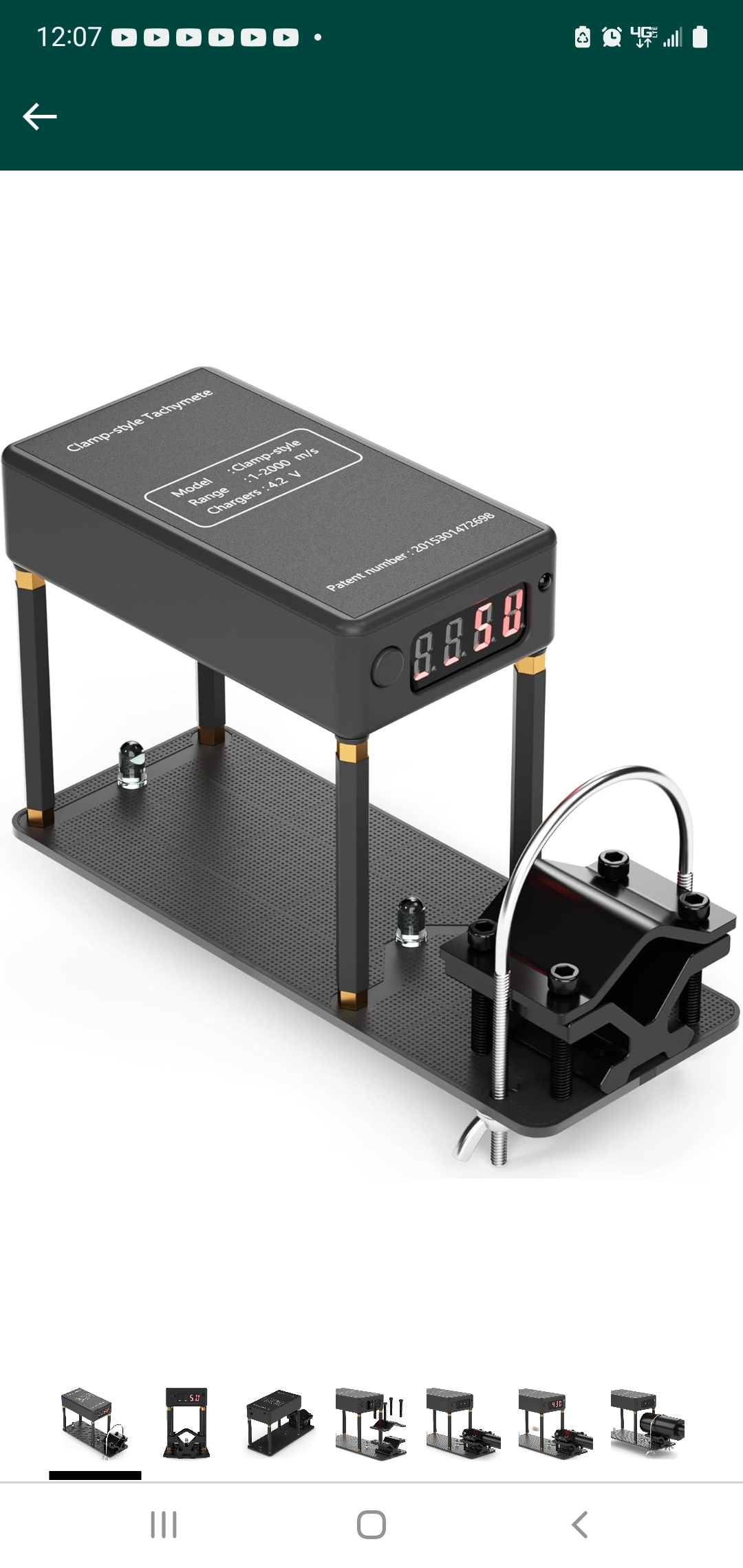

Don't make fun of me just yet, but this thing works great, even on my airguns pushing 1600fps. And I've verified it's accuracy with a magnetospeed and the rcbs shoot through that someone here was kind enough to donate to me.
