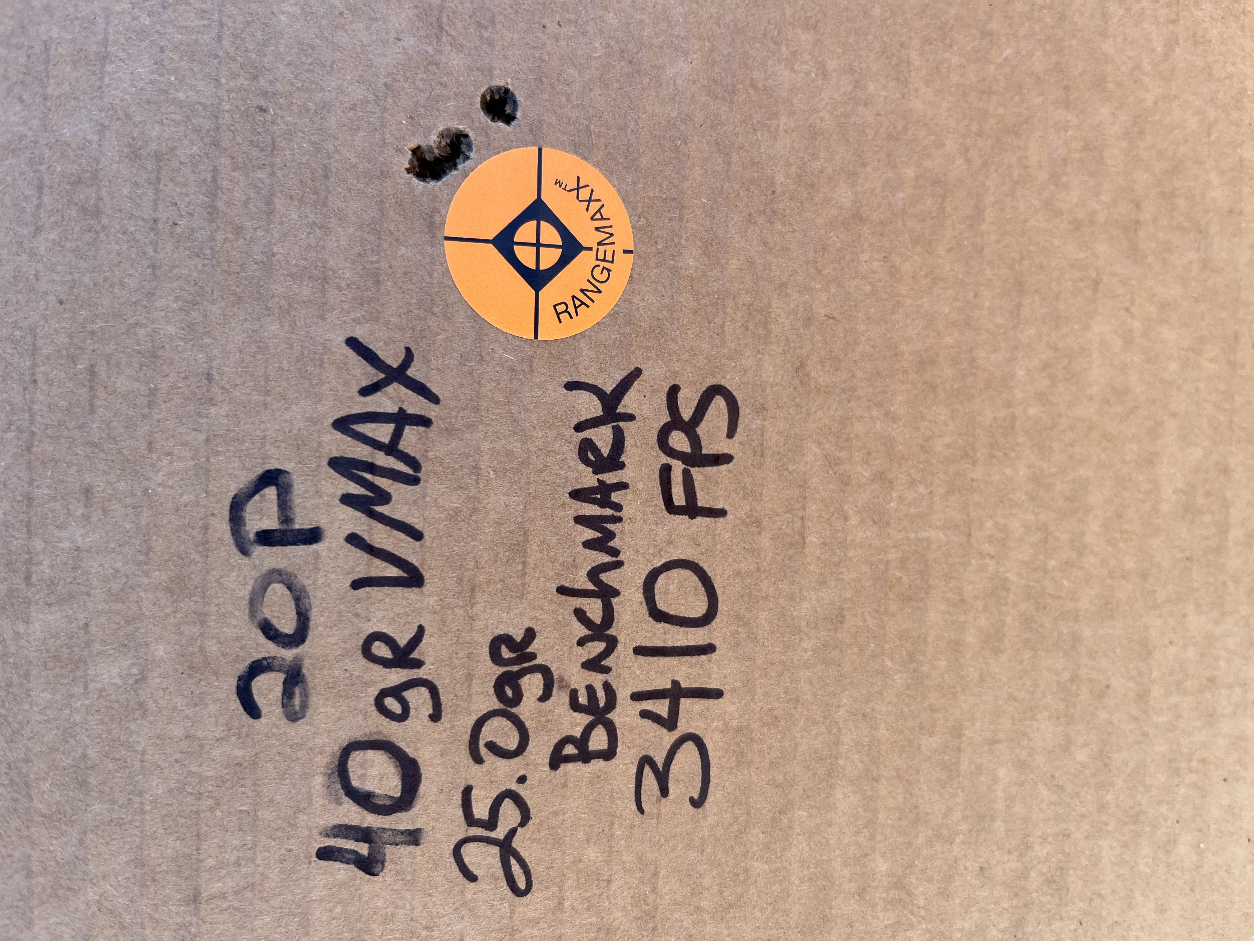

Another test session with the 20. Tried a different powder. Great accuracy, way too slow. BLC2 is looking like the way to go, but I’m at 3600 and only about 1/2 grain more to go before expected pressure issues. I’ll try that. At this point, it’s a 1/2” gun, just need that accuracy node that has speed and precision. Time will tell.
.28” group, 100 yards, 20-30 mph wind from 10-11 o’clock. Too slow…
