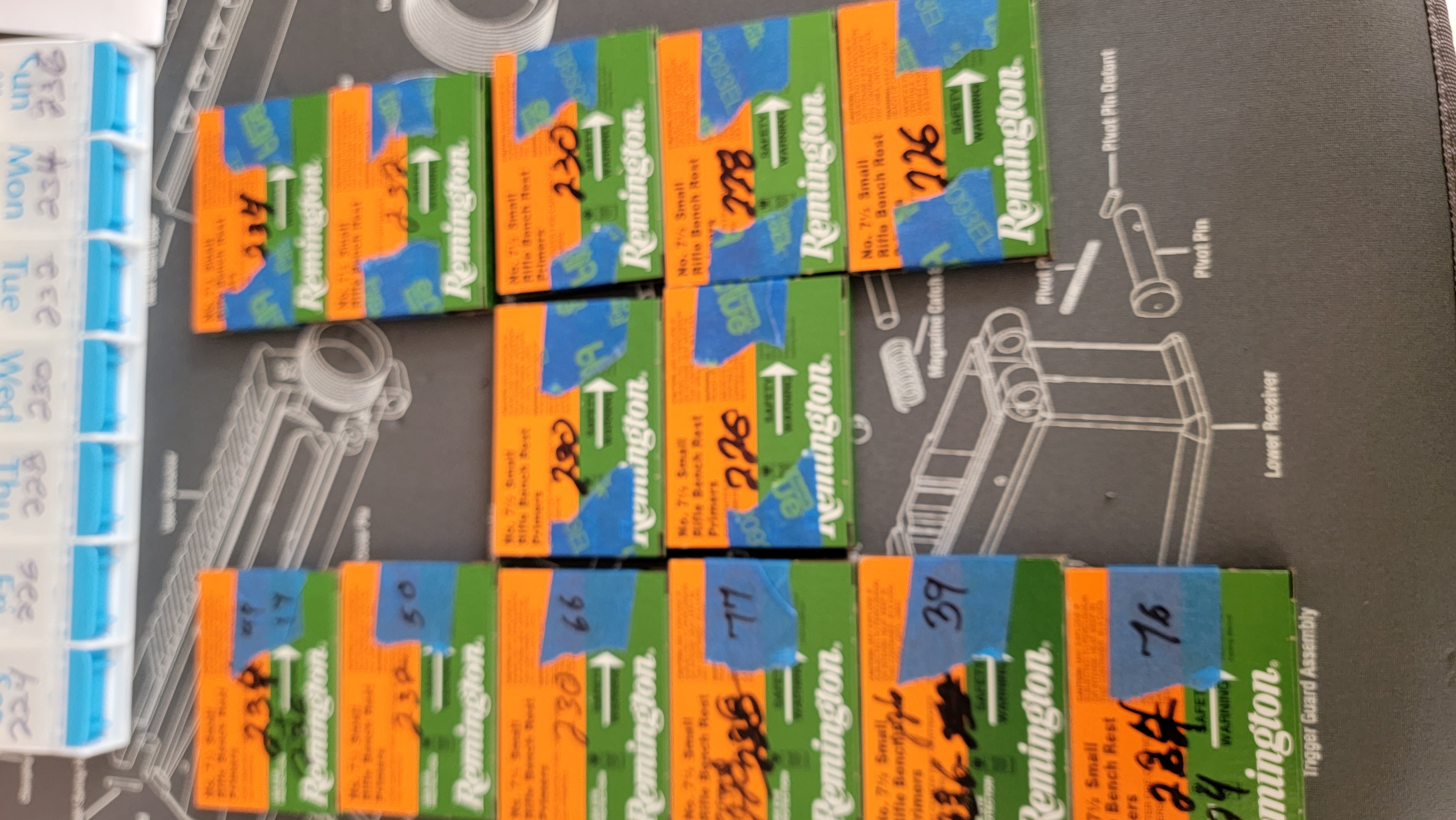

Here is a picture of the sorted primers at the end of the current batch. The next batch of 5000 primers will be sorted when I start getting low here. I do not mix batches.
You can see the pill caddy at the top, or the edge of it, with some numbers written on the lids.
The seven boxes in the middle and right are all full boxes of the numbered weights. The lefthand column is made up of the remnants of the batch. You can see the box on top having two weights in it, .234 and .236, The .236s are fairly rare; 19 out of 2500 or so. I have used a few .236s for foulers, now that I have started allocating cases for that practice instead of dipping into my pure match ammo. (A story for another day.)

Interesting on sorting the primers. Do you think it reduces variability because it creates a more uniform primer flash and powder burn?

breamfisher wrote: ↑Fri Jan 05, 2024 6:32 pm Interesting on sorting the primers. Do you think it reduces variability because it creates a more uniform primer flash and powder burn?
The term used to describe the effect of a primer (and other explosives) is brisance. Yes, it comes from the French word "briser", which means to break.
And yes, you are correct. To explain further, to produce the best performing ammo, you have to control as many variables as possible. By best "performance", I mean, most consistent performance. The variation from one primer to the next may be very small, but at some point, you're going to fire a heavy primer, and the next shot will be a light primer. The brisance of each may be a small differential from the mean, but more consequential from each other. I believe the difference in the weight of the primer itself is due to the variability in the amount of compound in the primer. So, while you may think that .010g is not much on a .230g primer, the compound itself may only be .075 or some such. (Note to self, when next I pull out my scale to load ammo, I will weigh several spent primers and see what's what. Thank you for prodding me on this. I will come back here and update when I do that.
