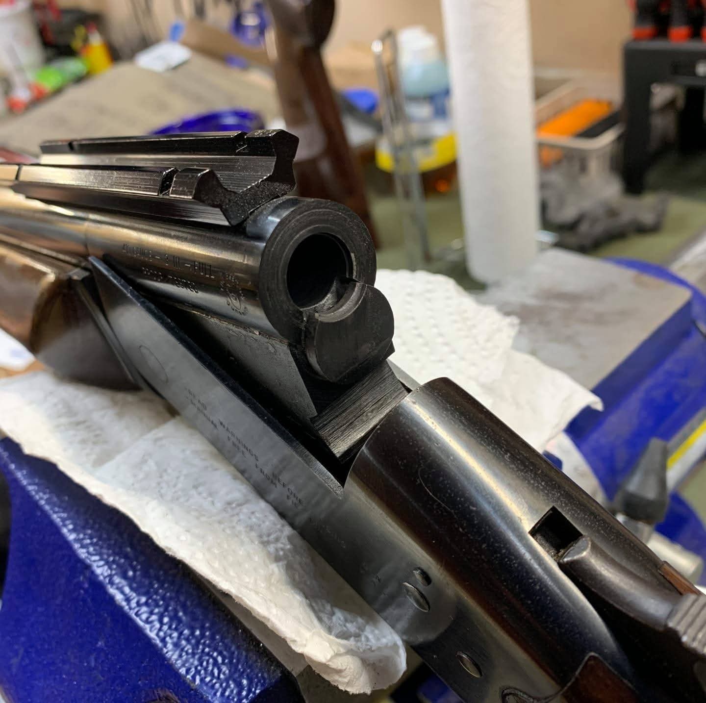

It's actually pretty easy to do. You basically cut the shotgun barrel at about the end of the chamber, bore it out in the lathe with it indicated in and thread it for the tenon of a new barrel, then machine a blank to fit it. I've done a few. The one I liked the most was one that I turned into a 45 Colt that the customer called a Saddle Gun. I'd like to stick with something I already have a bunch of ammo for or something widely available and cheap(ish).

Yep, that's the description I was attempting to give to Wambli. I think you made it easier to understand though. Here's the one I did in 45 Colt. Don't have a better picture but I hot blued it too. Also did one for a guy in 9mm now that I think about it.
