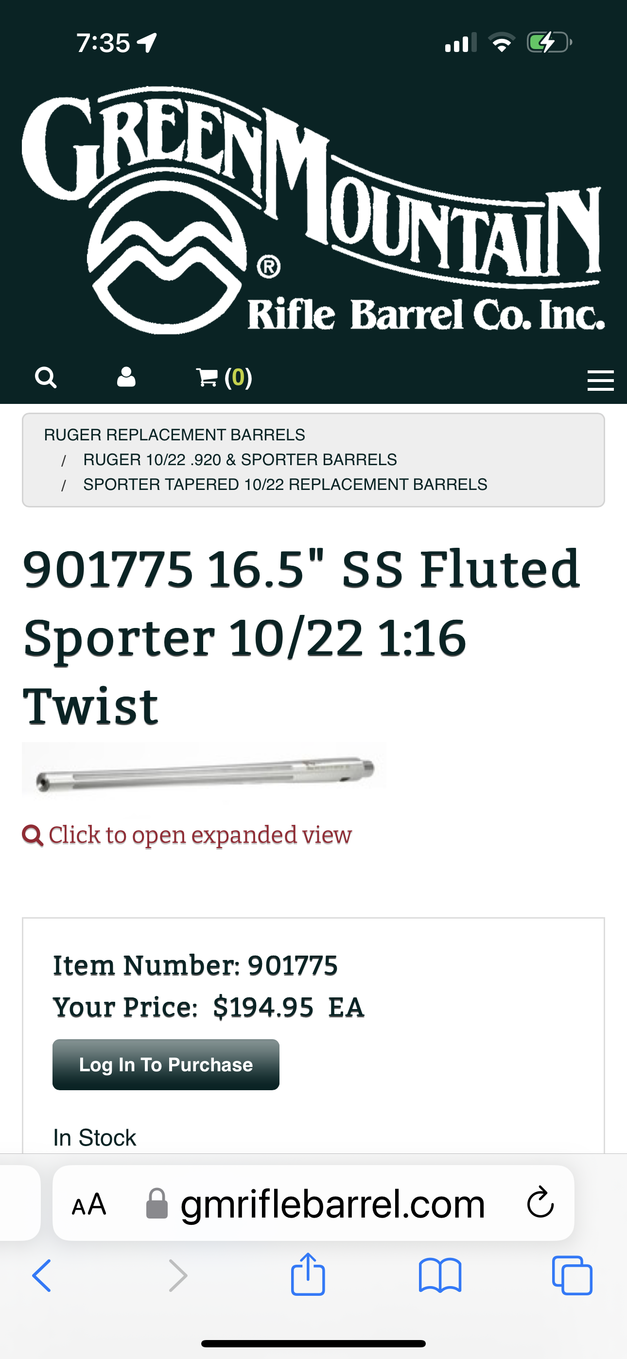

I cleaned the barrel a little better with lead remover and then stuck a bore light down the barrel until I saw no “apparent” coating down the bore.
Showed my friend the results and he said for me to just order him a new Green Mountain Barrel.

Posts: 3026
Re: Ruger 10/22 Issues - Thoughts?
Ordered.
