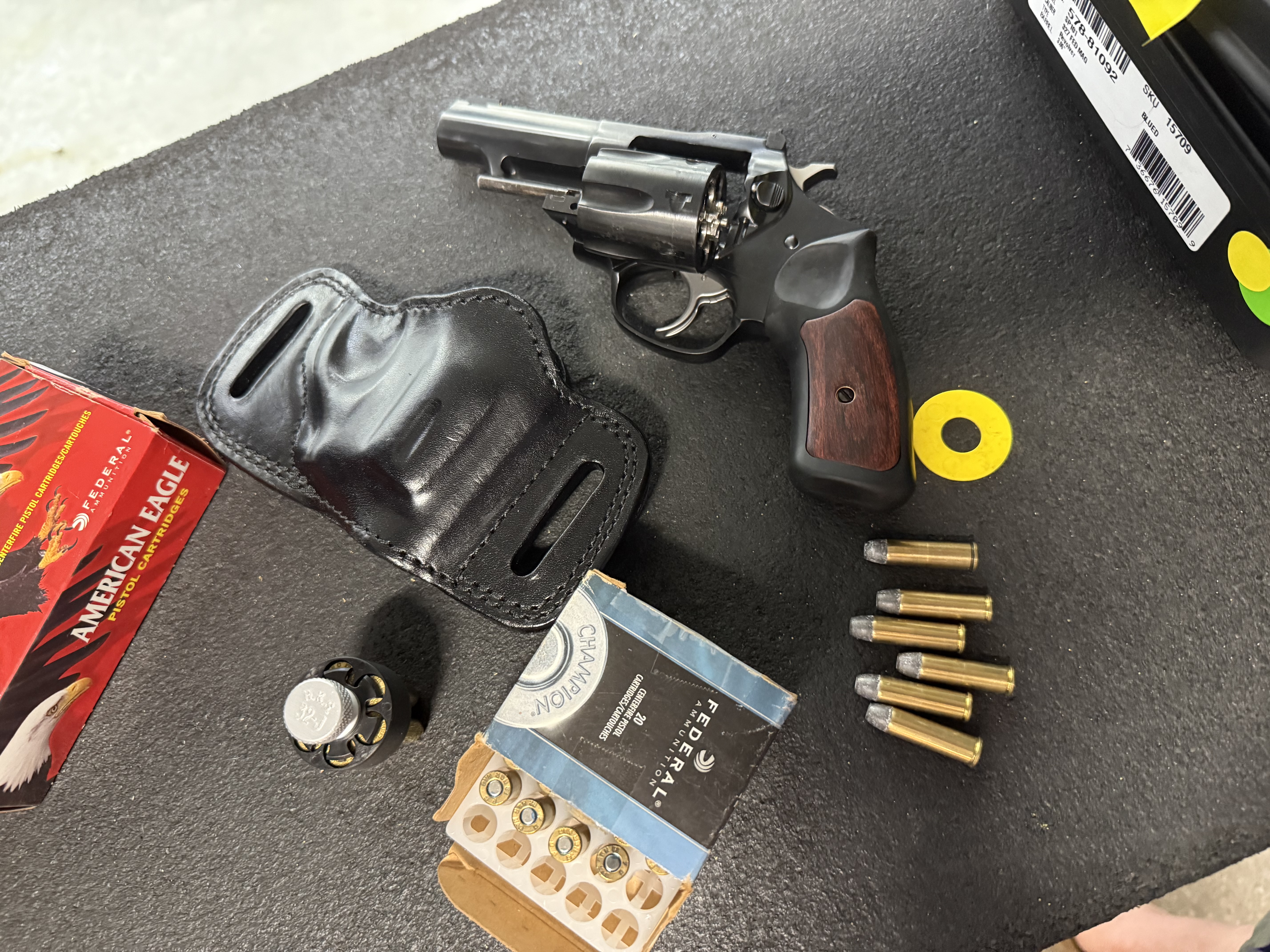

Alright- first impressions. The SP101 is one heck of a handy ‘little gun’. I hav experience with them from some friends owning them, and y brother having one, all in .357. I have always liked the size and ‘heft’ of the gun, d they usually have pretty decent triggers for a small gun. This one is no different. Good trigger, solid, handy little wheelgun.
I did not shoot for accuracy. Everything was offhand, mostly being a function check to see if it worked and how it handled with the mmo I was able to get.
For those that don’t know, the .327 Federal Magnum is technically a “Super Magnum”. It is based off the .32 H&R Magnum from the mid-80’s… but if you go back even further, the genesis of this is the OLD black powder .32 S&W, which was then lengthened to make the .32 S&W Long… which was hen lengthened to make the .32 H&R Magnum…. Which was lthen lengthened to make the .327 Federal Magnum. So, if you wanted to be pedanticit’s actually a super-super Magnum. Anyway, that is the long way around to say that the instruction manuals will tell you this gun can fire four different rounds: .32S&W, .32S&W Long, .32 H&R Magnum, and .327 Federal Mag. BUT… it is a well known fact that most of the guns can also fire the .32ACP since it is a semi-rimmed auto pistol cartridge. So- one gun, 5 Rounds.
All I was able to source in time was .32ACP, some absolutely ancient .32H&R LRN, and a box of American Eagle 100Grain JSP. (see the lead corrosion on the .32H&R?)
The sights were bottomed out from the factory, so everything shot WAY high. Both the H&R and Federal Magnum it to around the same point of aim at 7 yards: (H&R Mag to the left, .327 to the right)
The .32H&R shot an impressive fireball and had very little recoil. The .327 had no fireball, a sharp snappy recoil… and were loud as hell. My brother was shooting 2 different .44 Magnums, and the .327 turned more heads than the .44 Magnum Desert Eagle. Closest I could compare it to was shooting a 7.2x25 which is not surprising since the ballistics are similar. The .32ACP was like shooting an air gun. Absolutely no recoil, very minimal sound, and I have no dea on accuracy. I was just giggling when I shot it.
I also grabbed a “Cal38” holster for dirt cheap. It is a handmade lined leather holster that I got for less than $30.
Website: https://www.cal38.com/collections/ruge ... -snub-nose
Now, for the downside. I experienced some sticky extraction with the .327 Federal loads. Nothing that was a game stopper, just required some force to pop them out. Now, this could be that I took it right our of the box and fired it and the chambers were dirty or had manufacturing gunk/ oil in them, could be the ammo (there are reports of these being extra hot and sticky on line), or (hopefully not) rough chambers. The Pin that holds in the adjustable rear sight also stands proud of the frame on the passenger side, and there is a sharp edge on the frame window that eels like it should have been smoothed at the factory.
All in all- I like this gun- SO FAR. I’ll give it a deep clean, source some more ammo (and a new set of dies) and get it back to the range again soon
