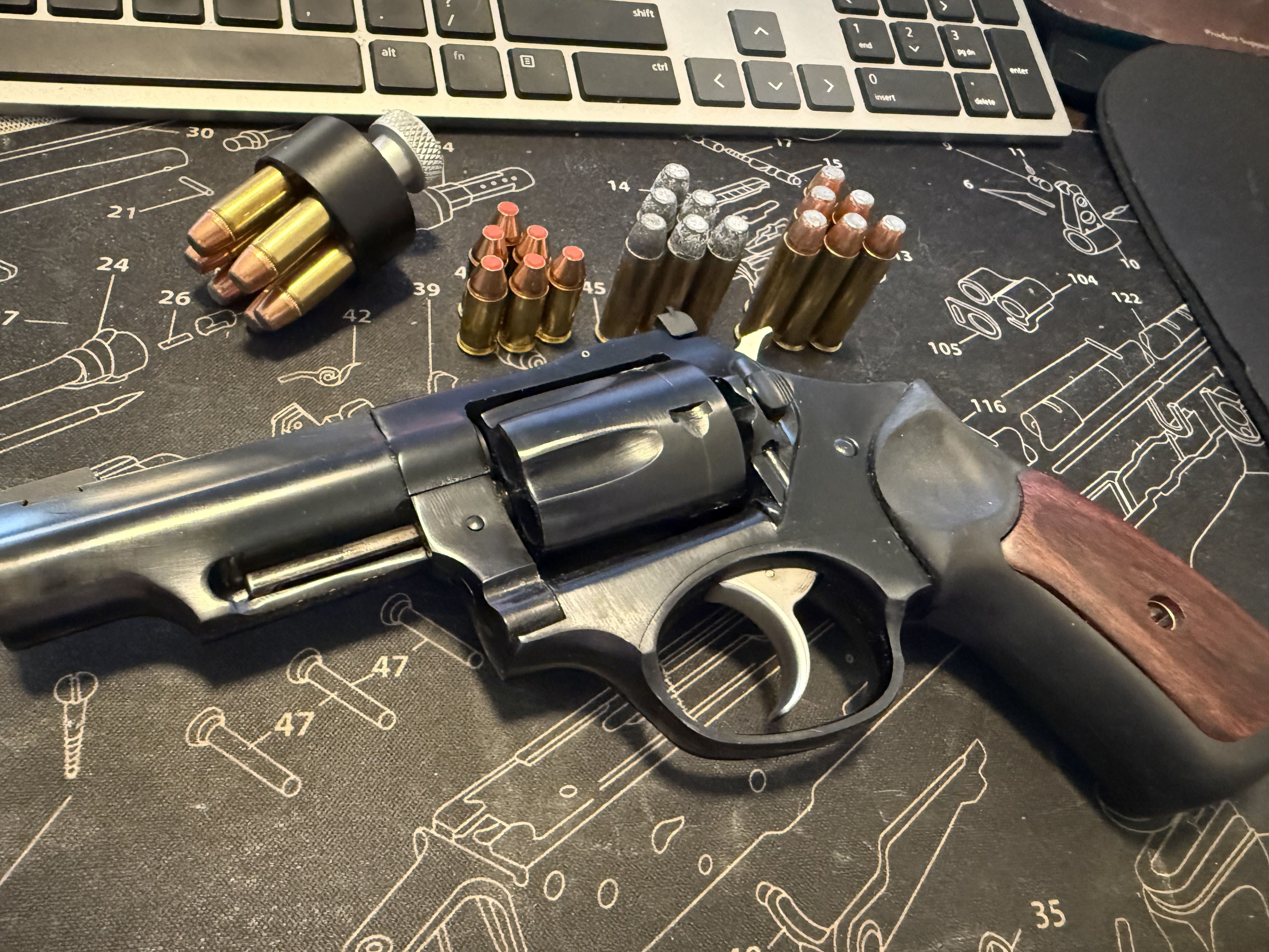

Alright- first impressions. The SP101 is one heck of a handy ‘little gun’. I hav experience with them from some friends owning them, and y brother having one, all in .357. I have always liked the size and ‘heft’ of the gun, d they usually have pretty decent triggers for a small gun. This one is no different. Good trigger, solid, handy little wheelgun.
I did not shoot for accuracy. Everything was offhand, mostly being a function check to see if it worked and how it handled with the mmo I was able to get.
For those that don’t know, the .327 Federal Magnum is technically a “Super Magnum”. It is based off the .32 H&R Magnum from the mid-80’s… but if you go back even further, the genesis of this is the OLD black powder .32 S&W, which was then lengthened to make the .32 S&W Long… which was hen lengthened to make the .32 H&R Magnum…. Which was lthen lengthened to make the .327 Federal Magnum. So, if you wanted to be pedanticit’s actually a super-super Magnum. Anyway, that is the long way around to say that the instruction manuals will tell you this gun can fire four different rounds: .32S&W, .32S&W Long, .32 H&R Magnum, and .327 Federal Mag. BUT… it is a well known fact that most of the guns can also fire the .32ACP since it is a semi-rimmed auto pistol cartridge. So- one gun, 5 Rounds.
All I was able to source in time was .32ACP, some absolutely ancient .32H&R LRN, and a box of American Eagle 100Grain JSP.
(see the lead corrosion on the .32H&R?)
The sights were bottomed out from the factory, so everything shot WAY high. Both the H&R and Federal Magnum it to around the same point of aim at 7 yards:
(H&R Mag to the left, .327 to the right)
The .32H&R shot an impressive fireball and had very little recoil. The .327 had no fireball, a sharp snappy recoil… and were loud as hell. My brother was shooting 2 different .44 Magnums, and the .327 turned more heads than the .44 Magnum Desert Eagle. Closest I could compare it to was shooting a 7.2x25 which is not surprising since the ballistics are similar. The .32ACP was like shooting an air gun. Absolutely no recoil, very minimal sound, and I have no dea on accuracy. I was just giggling when I shot it.
I also grabbed a “Cal38” holster for dirt cheap. It is a handmade lined leather holster that I got for less than $30.
Website: https://www.cal38.com/collections/ruge ... -snub-nose
Now, for the downside. I experienced some sticky extraction with the .327 Federal loads. Nothing that was a game stopper, just required some force to pop them out. Now, this could be that I took it right our of the box and fired it and the chambers were dirty or had manufacturing gunk/ oil in them, could be the ammo (there are reports of these being extra hot and sticky on line), or (hopefully not) rough chambers. The Pin that holds in the adjustable rear sight also stands proud of the frame on the passenger side, and there is a sharp edge on the frame window that eels like it should have been smoothed at the factory.
All in all- I like this gun- SO FAR. I’ll give it a deep clean, source some more ammo (and a new set of dies) and get it back to the range again soon

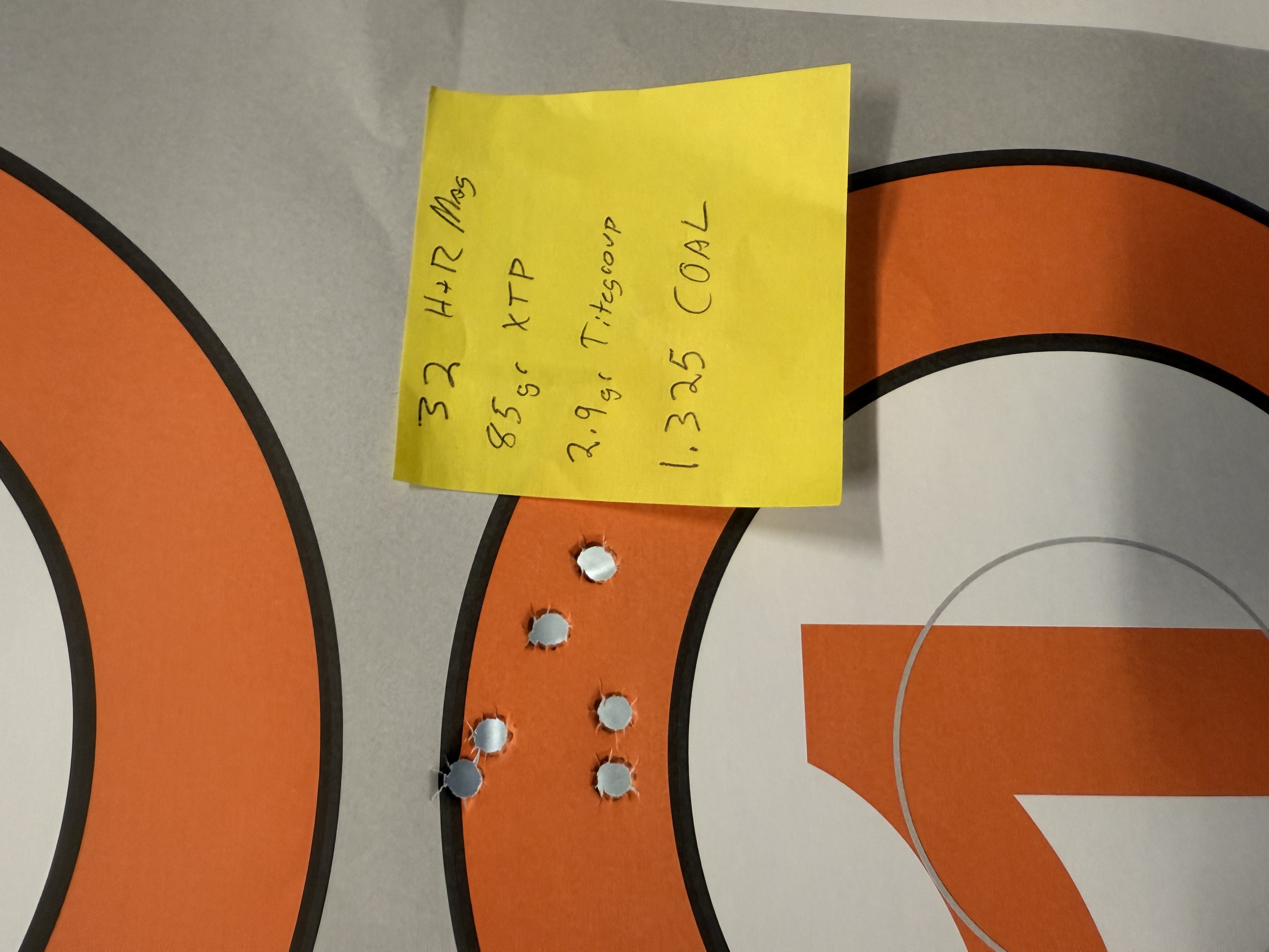

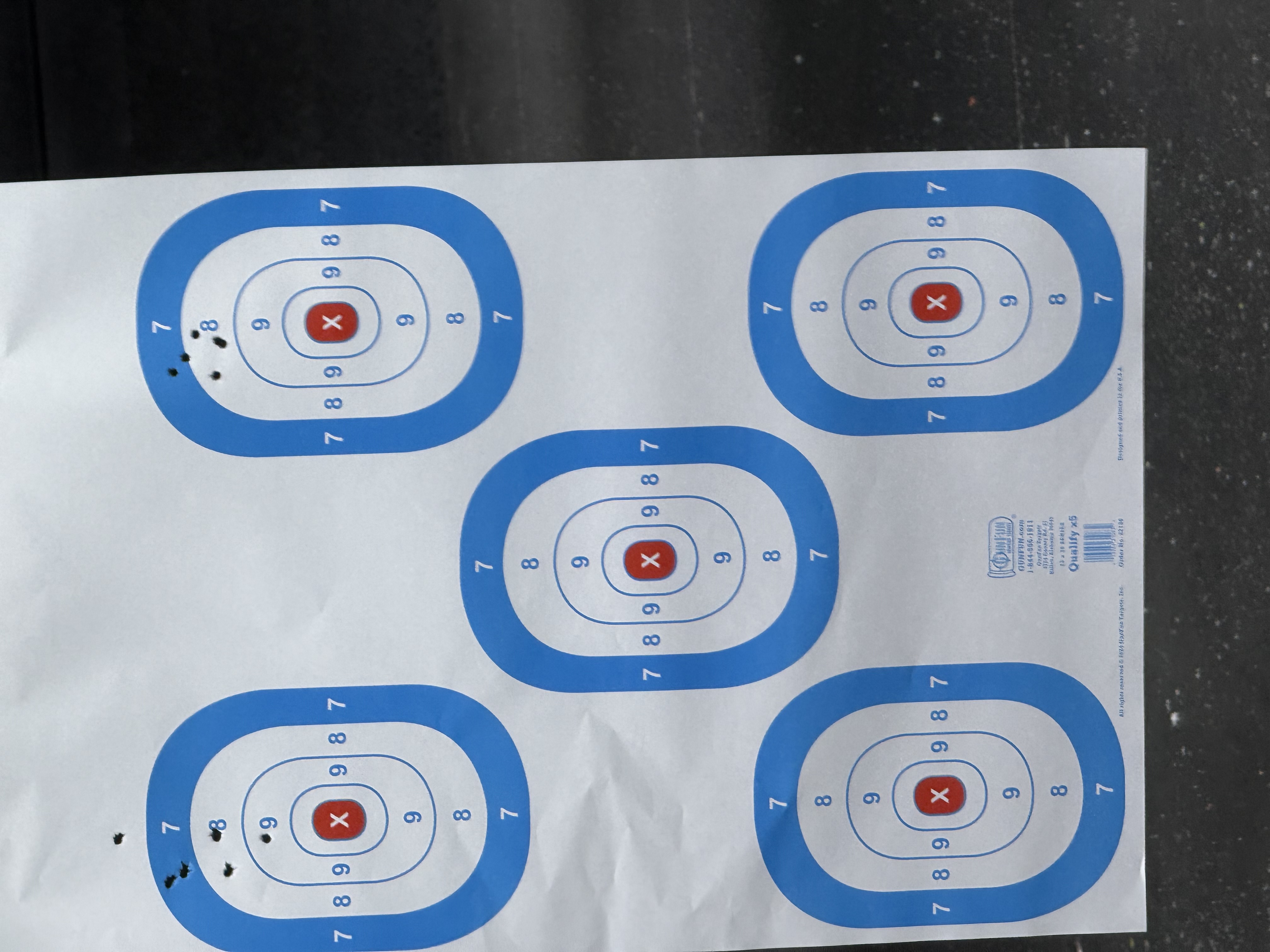

Finally got some time to load up some test rounds and get to the range for testing. All shots are at 7 yards fired with wrists rested on the bench in single action
Super light plinking load in 32 H&R brass. Pretty much .32ACP load levels. Like shooting an air gun. Not as accurate as I was hoping
Another very light load and better accuracy. I may tinker with this some more. Bump up the speed a bit
A bump up in power, and performed pretty well. Definitely spoke with a bit more authority and showed decent accuracy.

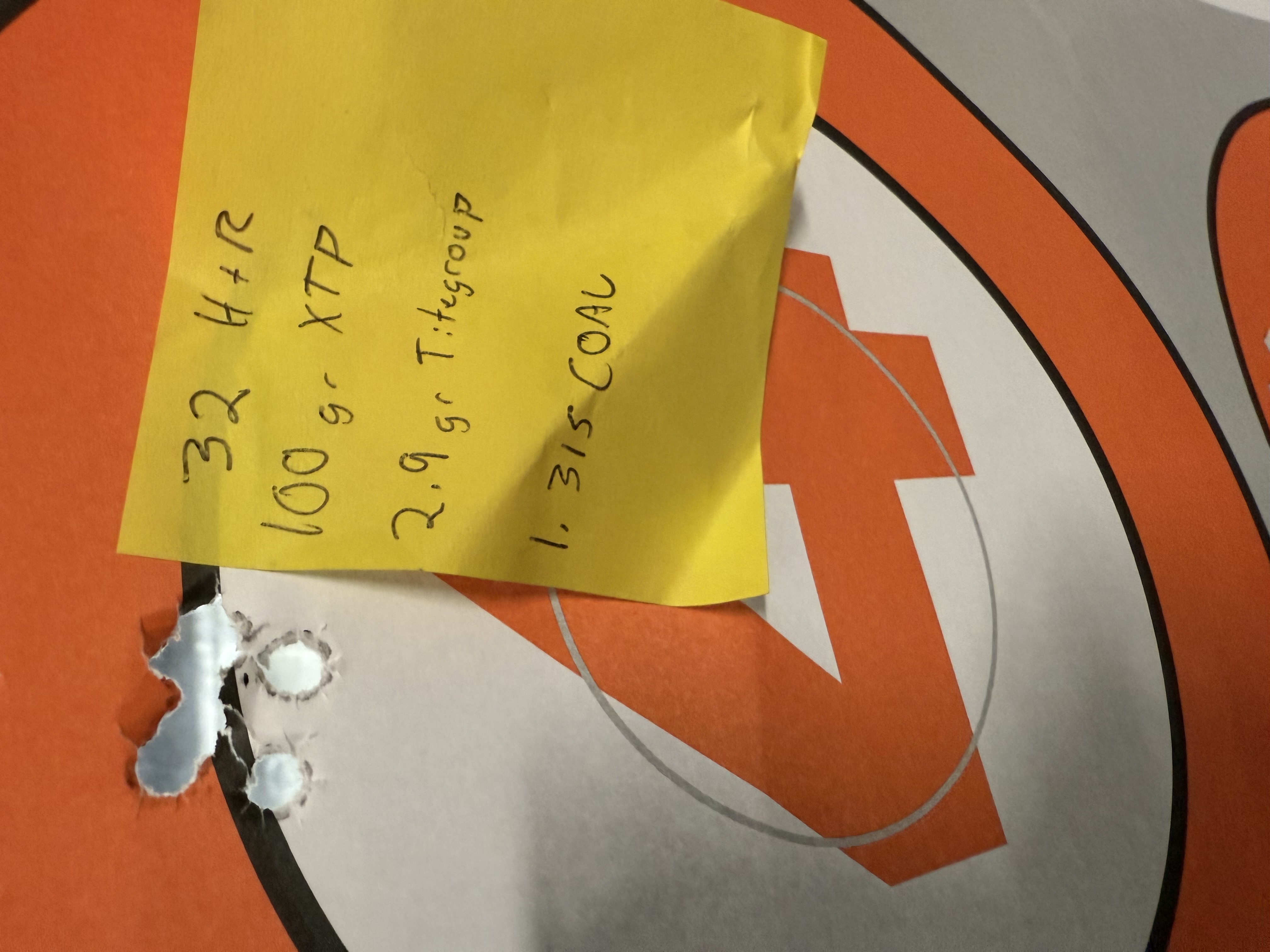

Now THAT’S what I was looking for. Very polite to shoot and great accuracy. I’ll run this into gel and see how it performs

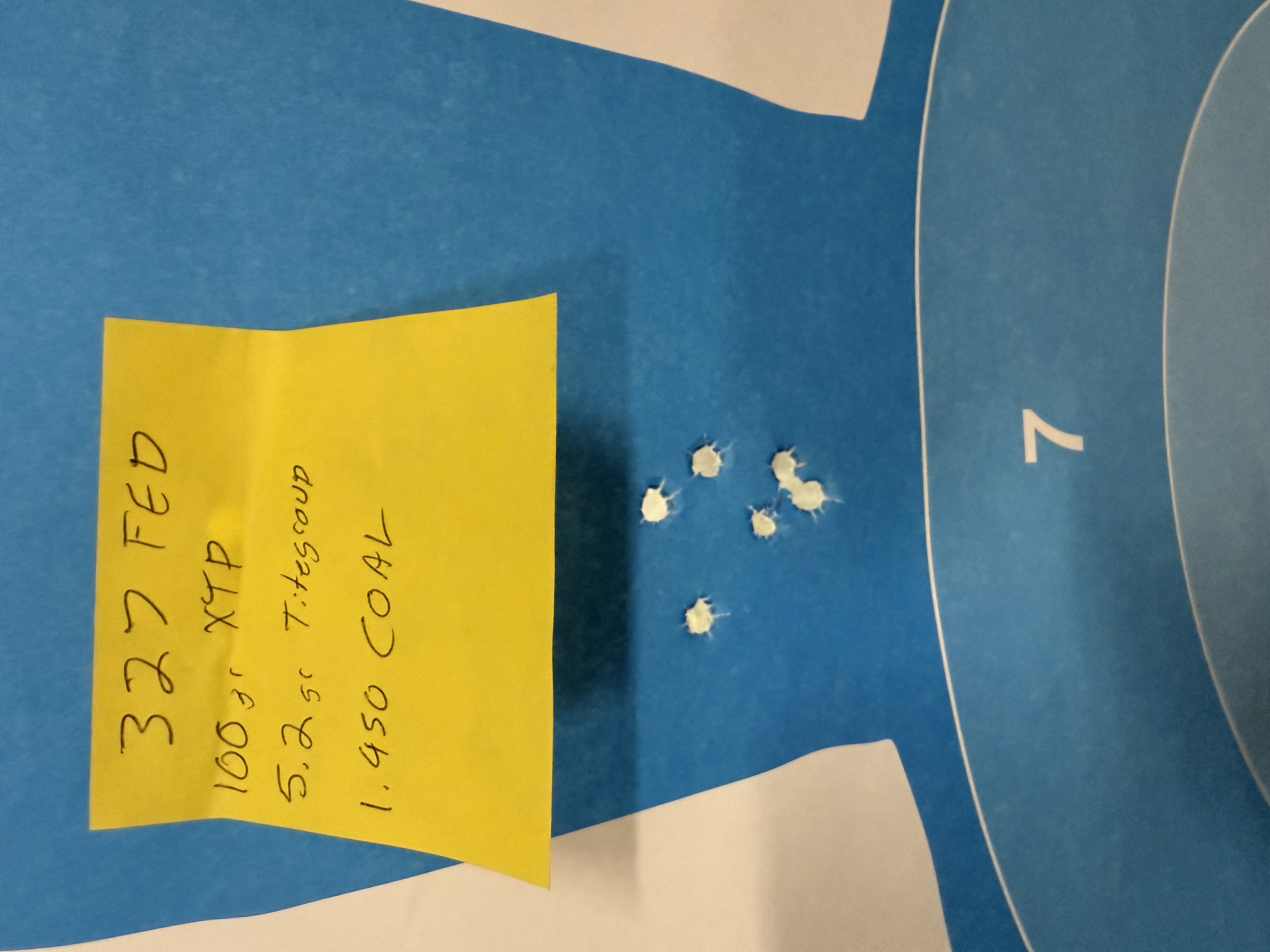

Now into the 327 loads.
Another jump in power. Good accuracy, still very polite recoil, but much louder
I was hoping for a tighter group on this one. I may bump it a tenth of a grain up and/or down to see if I can tighten the groups a bit. Still good accuracy, but I want better. This was still very agreeable in recoil, but loud.

It seems to like 100 grain bullets
Re: I don’t know why, but this was speaking to me
Posted: Fri May 16, 2025 2:06 pm
Interesting results. I have not tried the 100gr XTP's in my .32 mag.
Posted: Fri May 16, 2025 4:31 pm
Good enough for social work but I agree it SHOULD be tighter at 7 yards supported. More science makes sense.
Posted: Fri May 16, 2025 4:50 pm
I wonder what a 115GC cast bullet would do…..
Good shooting
Posted: Fri May 16, 2025 8:33 pm
Elk Creek wrote: Fri May 16, 2025 4:50 pm I wonder what a 115GC cast bullet would do…..
Good shooting
That’s a good idea. It seems to like the heavier slugs… I need to see if it gets even better with even heavier ones. More science needed!

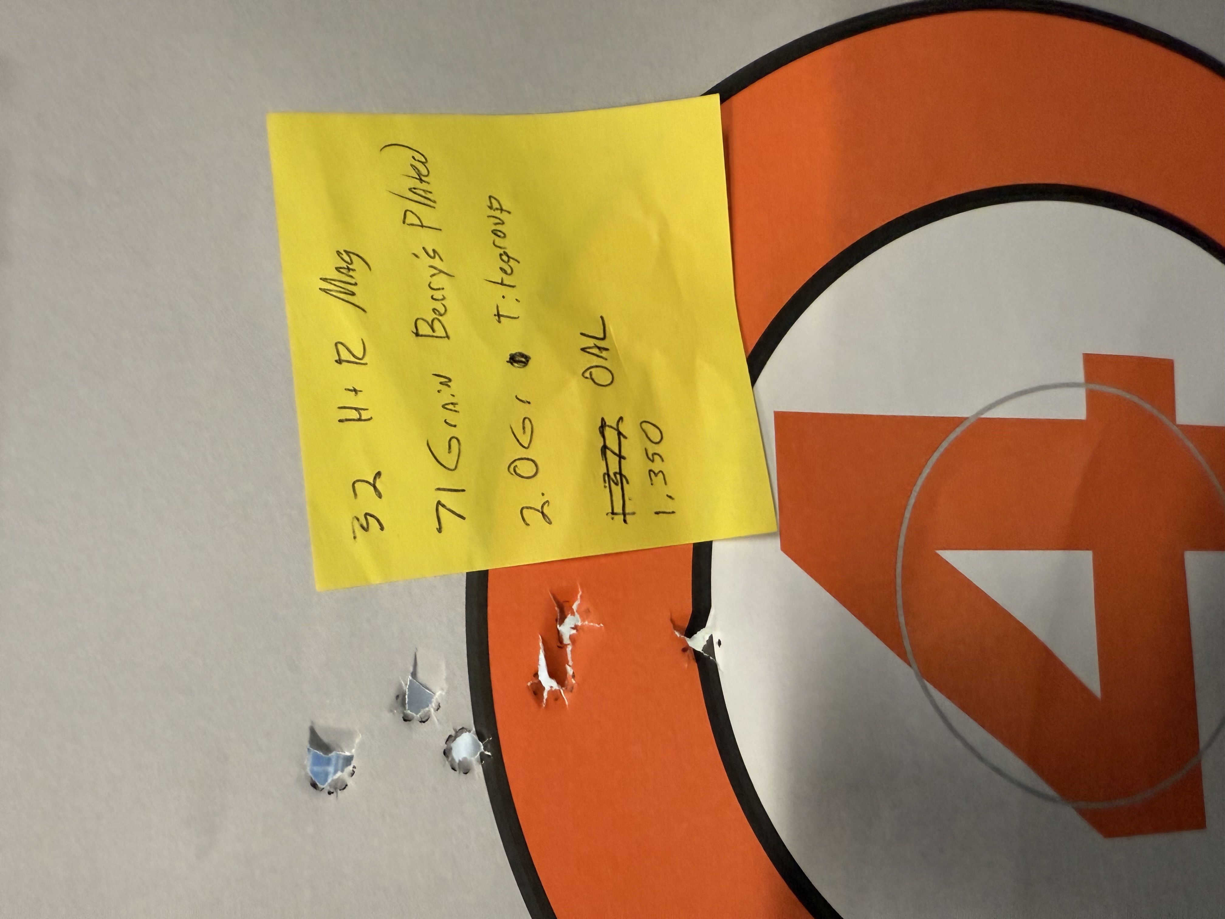

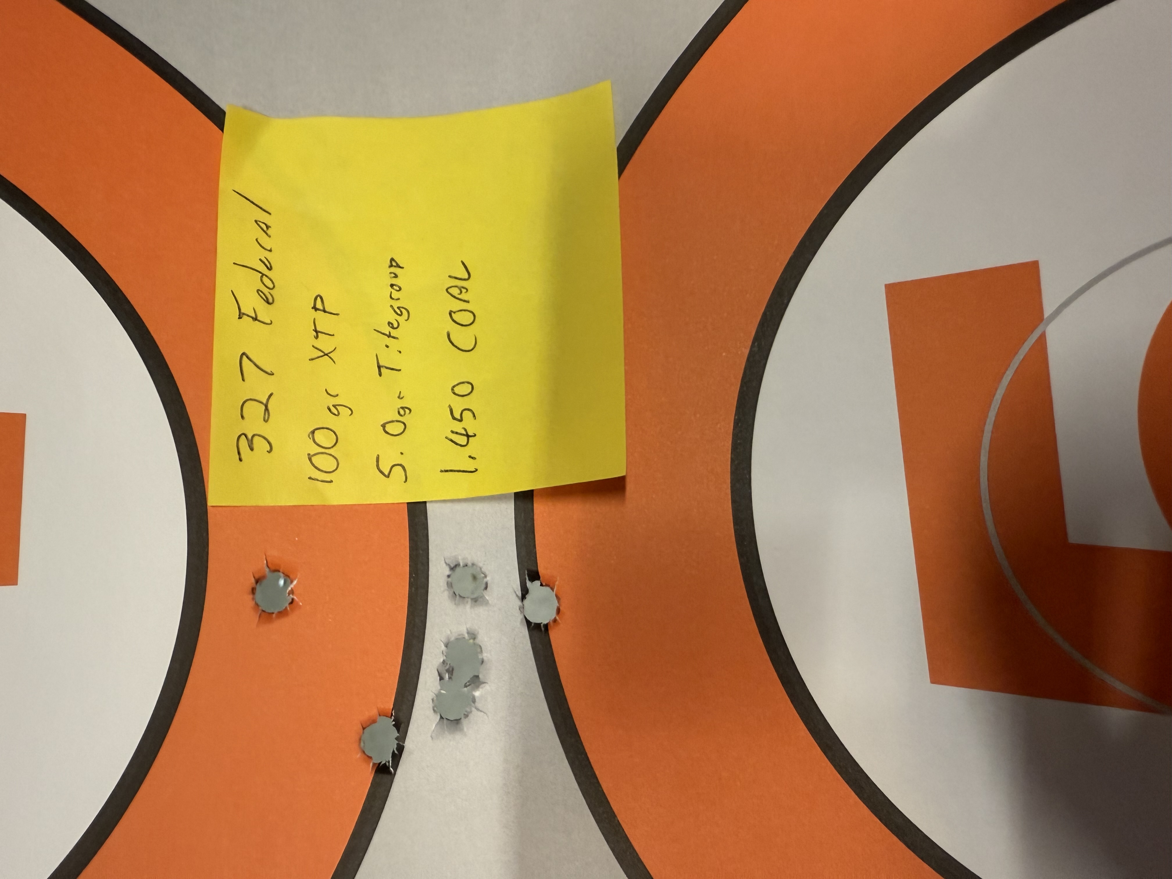

Loaded up a few more test rounds and made it to the range. Did something I never do, and loaded to book max on one of em.
Sticky extraction, flattened primers, and not great accuracy. Scratch that one
1/10th of a grain down. No pressure signs, but still not great accuracy.
Step down another 1/10th, and bingo! This is still a loud little sucker, and had mid range recoil. I think I will load up a pile of these and test velocity and performance in gel. So far, I am happy with this.
