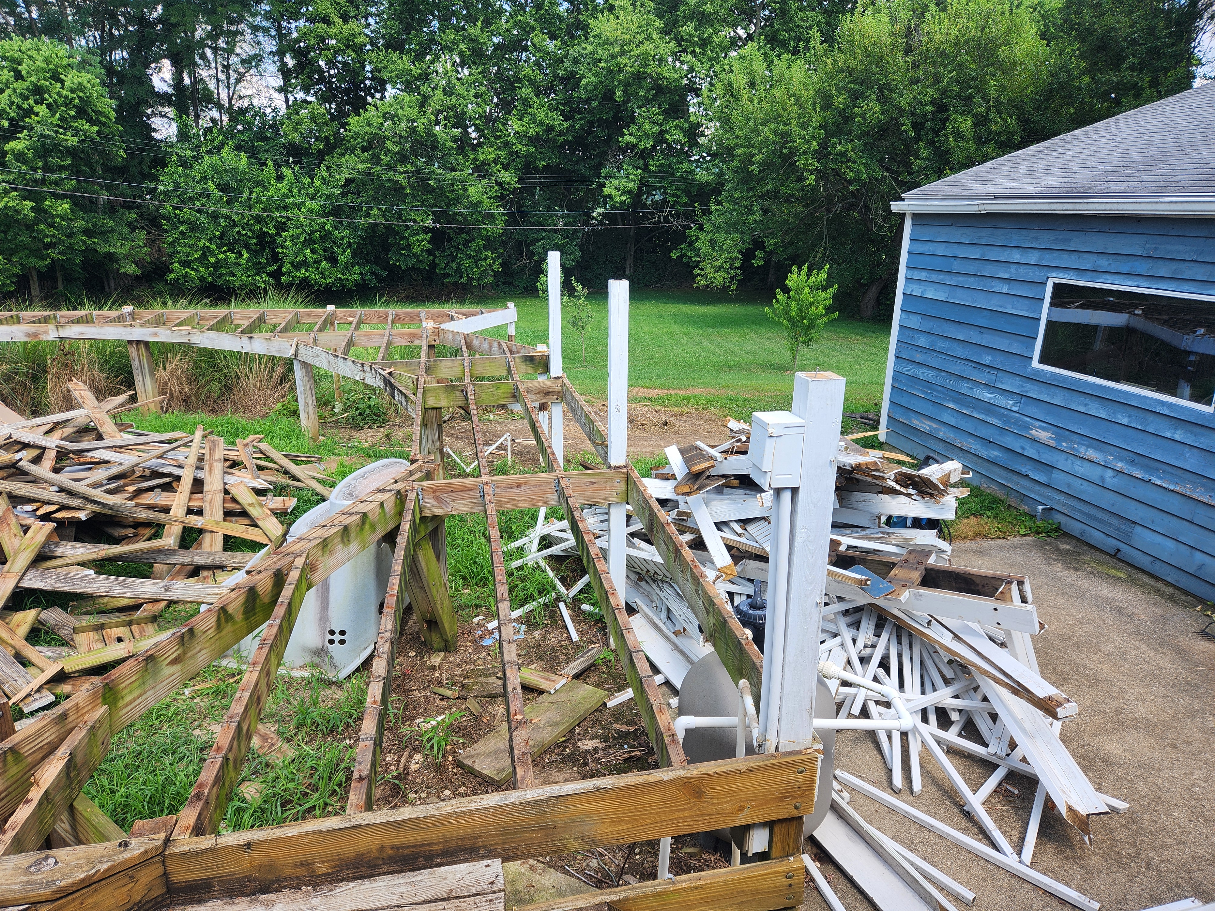

Just an update:

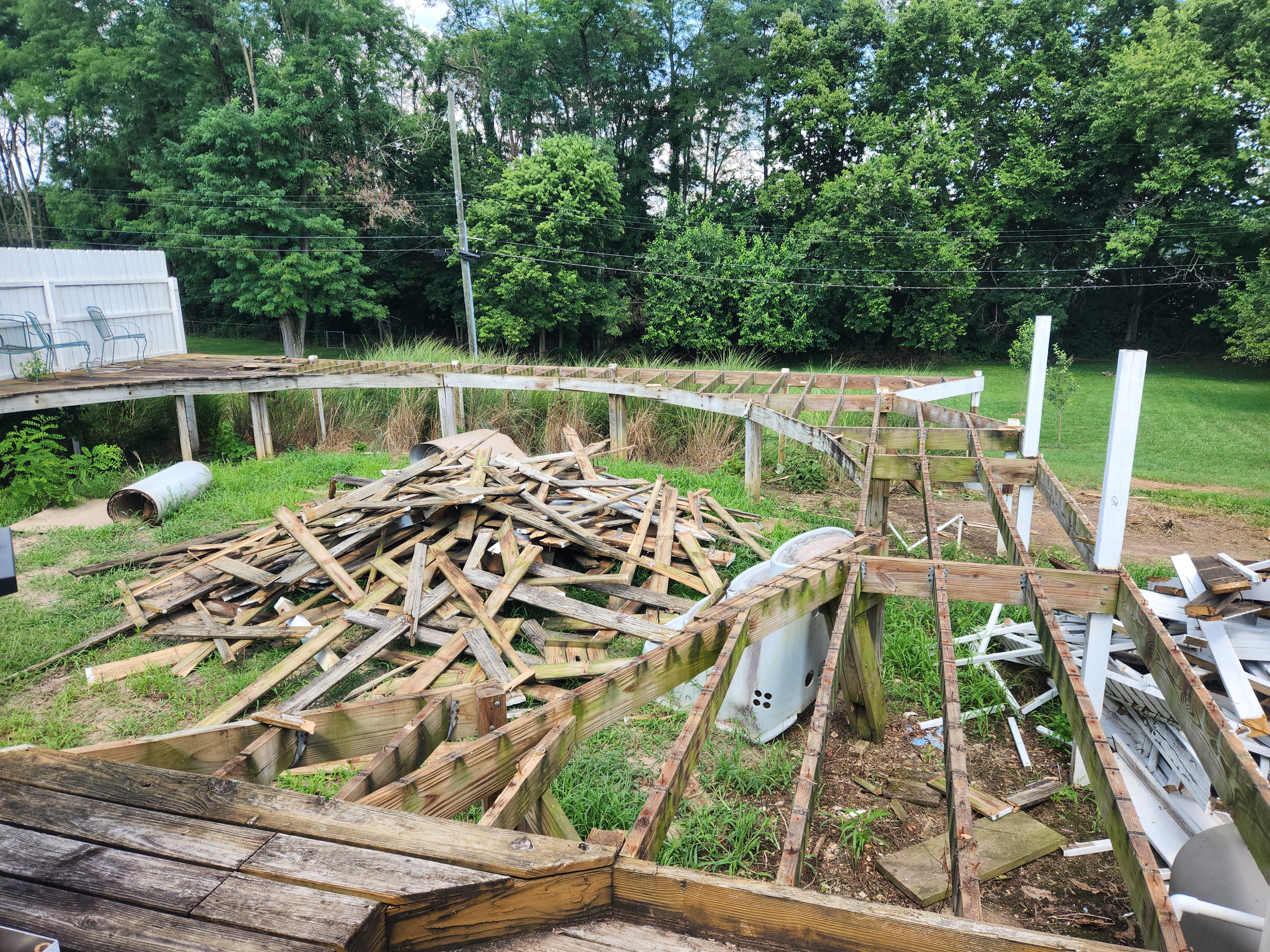

Although we waited for the worst possible weather with it being nearly 100° outside, my son and I (he's 14 and can put in some work) decided to start on the deck. There's a concrete pad between the deck and garage that we've just been stacking the old wood on until we absolutely need a roll off dumpster.
The dumbass that built the deck put the railing spindles literally about every 5 inches so there were a TON of them. We started with taking down the spindles and railing yesterday along with all the supports, etc... Today we got the gazebo down which turned out to be alot easier than we thought it would be. I thought I'd have to climb the thing and remove the shingles, boards and all of the framing from the top down, but it's pretty steep and pretty damn big for a gazebo. Turns out that a garden tractor has enough torque and weight to pull down a whole gazebo with 6, 4x4" posts 😄. Now we get to cut it up out of the yard but at least it's in the shade.
Also found out that you have to have a building permit even if you're directly replacing a deck or structure that you just tore down 😒

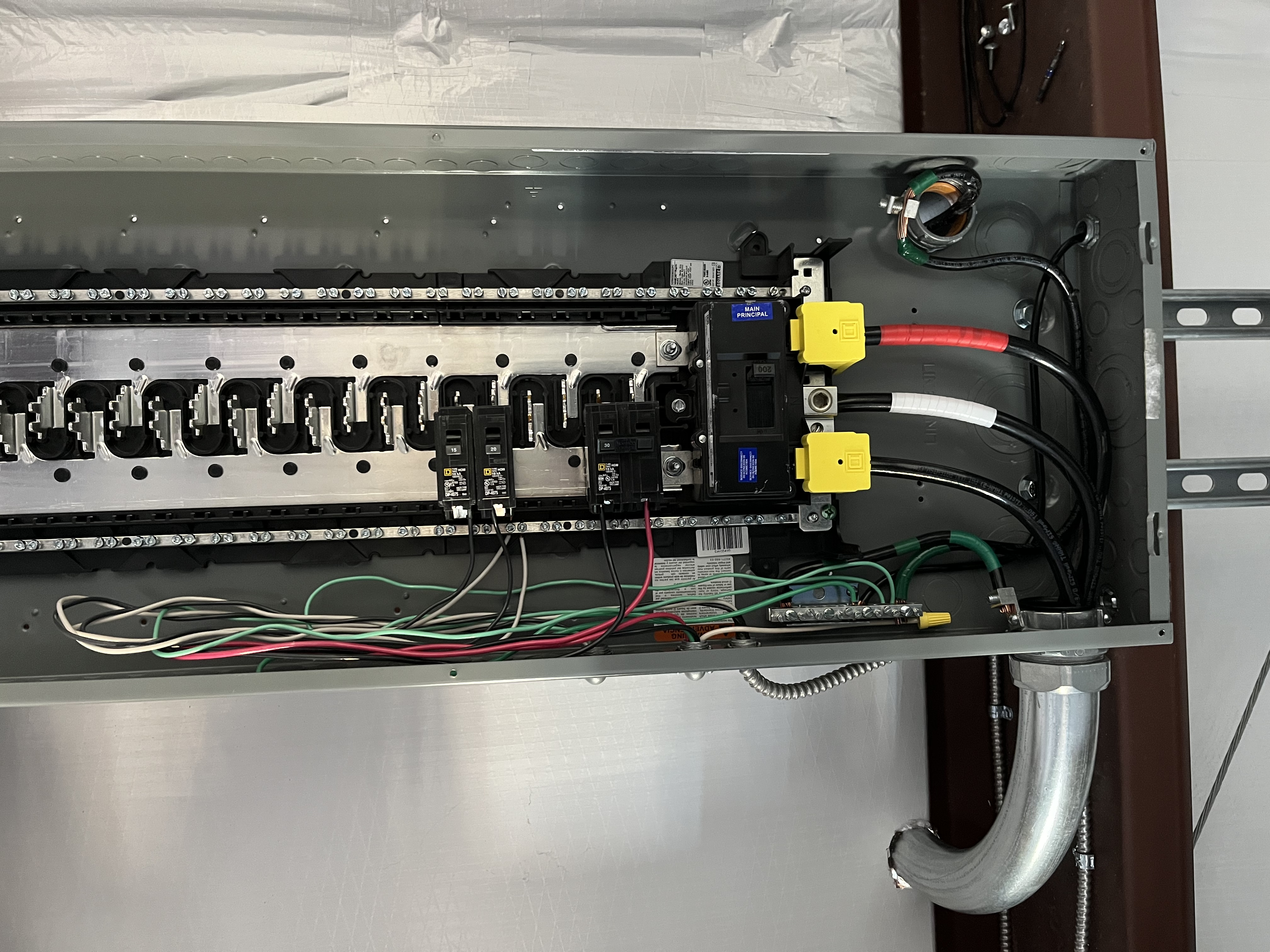

Also, on my electric, I hand drew the electric plan for my permit on one of the overview pages from my building plans. Because it’s required for the permit. It included the service entrance, panel, two outlets, four indoor lights and one outdoor light. Which I installed and had inspected and passed inspection.
The inspector knew I was full of poop as soon as he looked at it. I put in a 40 space breaker panel and it’s a 200 amp service, just to my shop. Once the inspector passed it and left, the real work started…

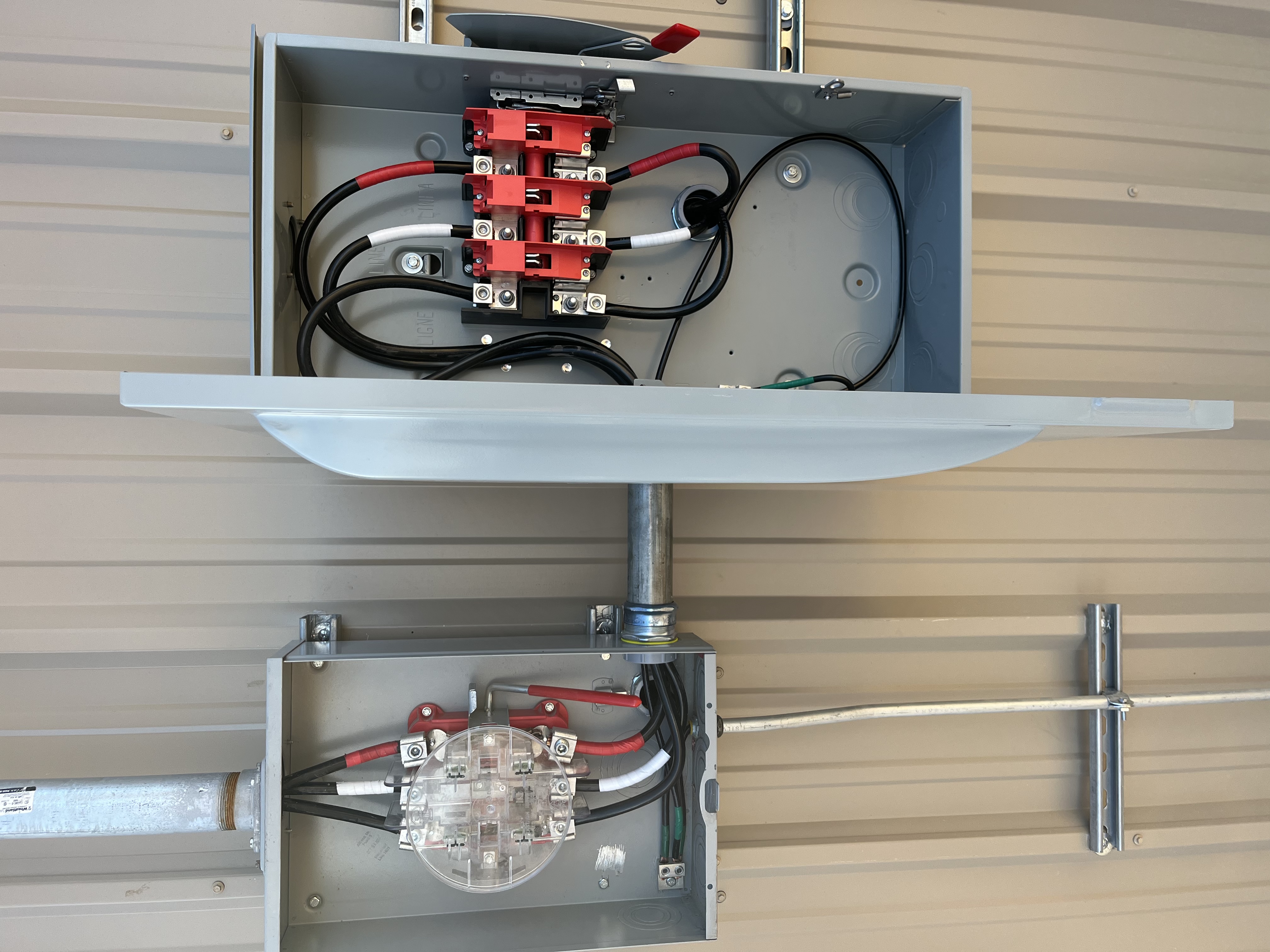

There was two things that held me up on the electrical. First, code says when it’s a new pour foundation, you’re supposed to connect your ground to the rebar in the slab. I had that in and told my concrete guy it needed to be there. One of the guys took it out and tossed it aside right before they poured. When the professional electricians installed the service, they put in one 8’ ground rod outside. That didn’t meet code, so it failed inspection. Code says when you don’t ground to the foundation on a new slab, you have to install two 8’ ground rods, 10’ apart, connected by 4ga bare copper wire, three feet deep. So they had to come install that and also had to change the mast from 1 1/2” to 2” conduit for 200 amp service. Then it passed inspection.
But then the elec co wouldn’t connect the service because they didn’t install an external disconnect switch. Not required by code, but required by the elec co in case of a fire. So I installed that myself, got it connected and it was done.
One thing I did wrong, and the inspector warned me against, was using electricians from another state. They weren’t familiar with code in my state.
Here is what I ended up with, after redoing much of what the electricians did. With temporary light and outlet breakers in so I could work in there at night. It’s a lot more cleaner now.

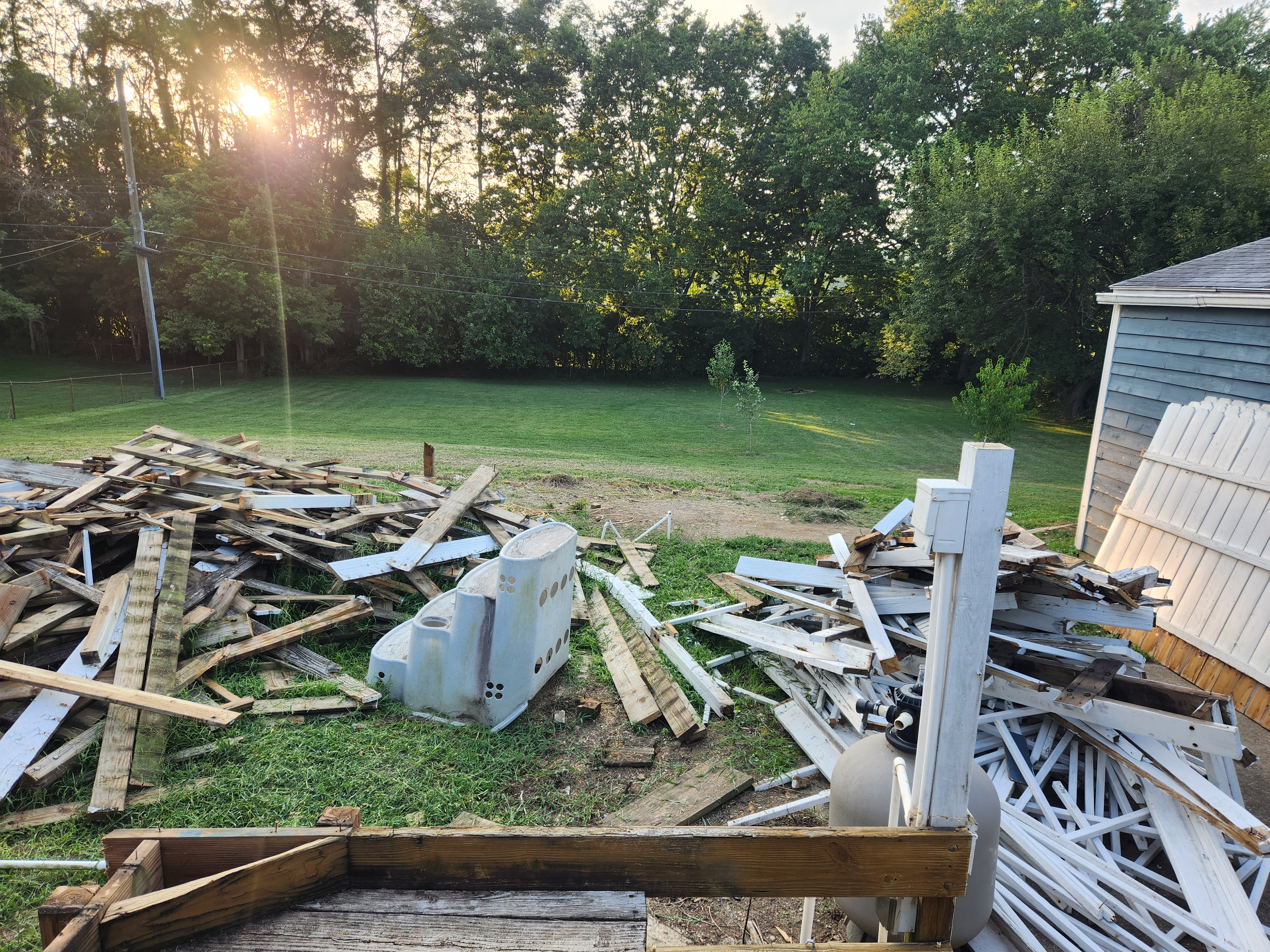

Progress. Again it's just my 14yo son and I but I couldn't ask for a better helper because that kids a work horse. We got started on pulling up the deck boards and I owe a beer to whoever it was that recommended the special pry tool for it. I got one on Amazon and it works amazing. My son was using my 4' pry bar and preferred it. The guy that built the deck used some deck screws, some nails and drywall screws. I even saw some sheet metal screws. He also used roofing nails for the joist brackets. You can see how shoddy and crooked the framing is. I don't know how he ever passed inspection. Oh, we did all of this in under 2 hours.

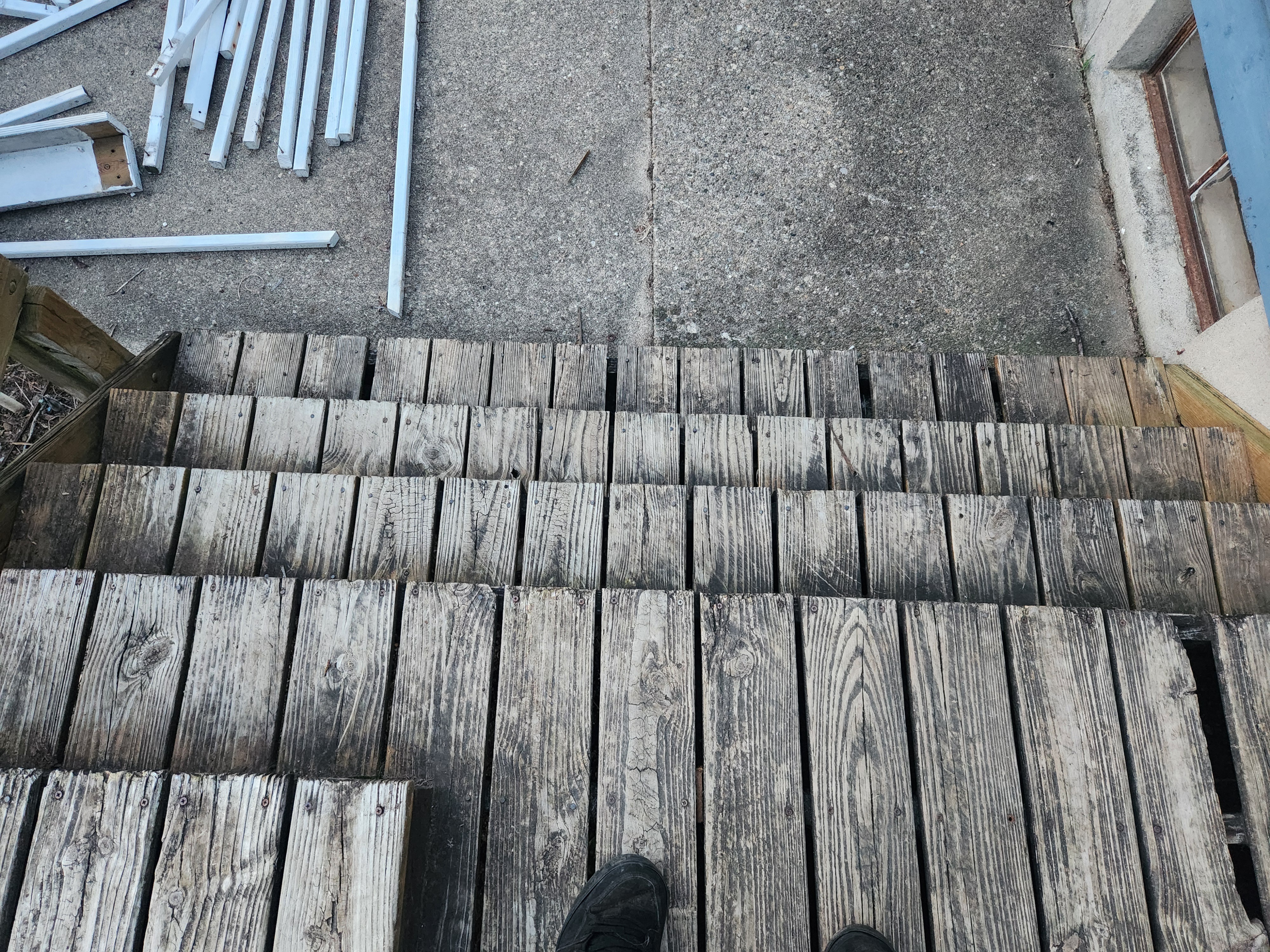

What kind of smooth brain builds steps like this? Talk about making more work that looks like shìt.
Posts: 1798
Re: Giant deck removal (probably a Jermey question)
To cheap to buy more lumber and used the scraps in a way that they fit.
Posts: 1339
Didn't consider that but I'd bet you're correct, especially after seeing how he used spare siding to angle the gutters to mount.

Necessities to remove a 1600+ sqft deck:
4' prybar
Deck board removal tool
Chainsaw
Sawzall
Child labor
Tractor
Plenty of sweat and cursing the previous homeowner.
I absolutely hate that I'm going to have to dig up the ornamental grass bushes (because they're in there real good). I've always despised those stupid things but got most of them cut with an electric hedge trimmer until I gassed out today. I'll be getting a dumpster soon but have no idea what size I need. The backyard grew quite a bit.
