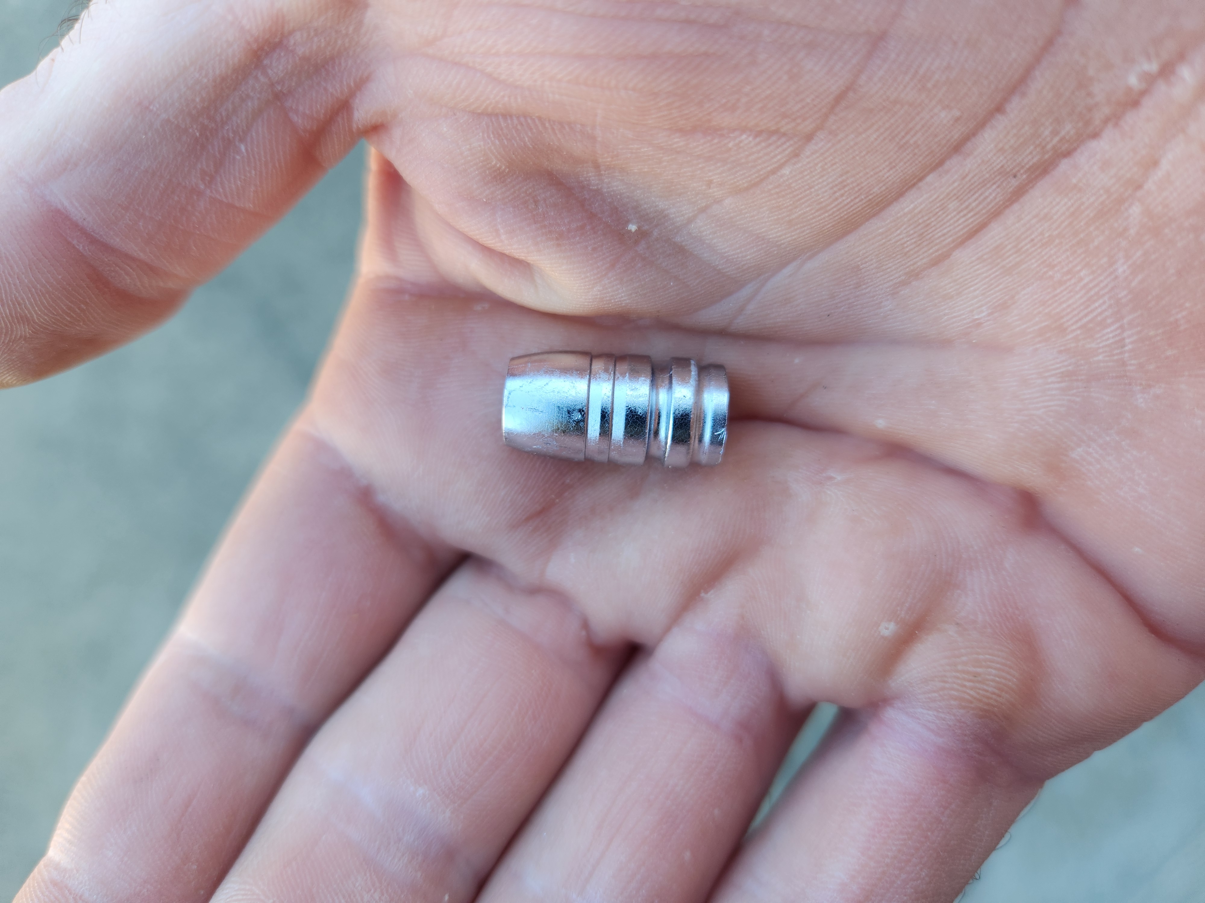

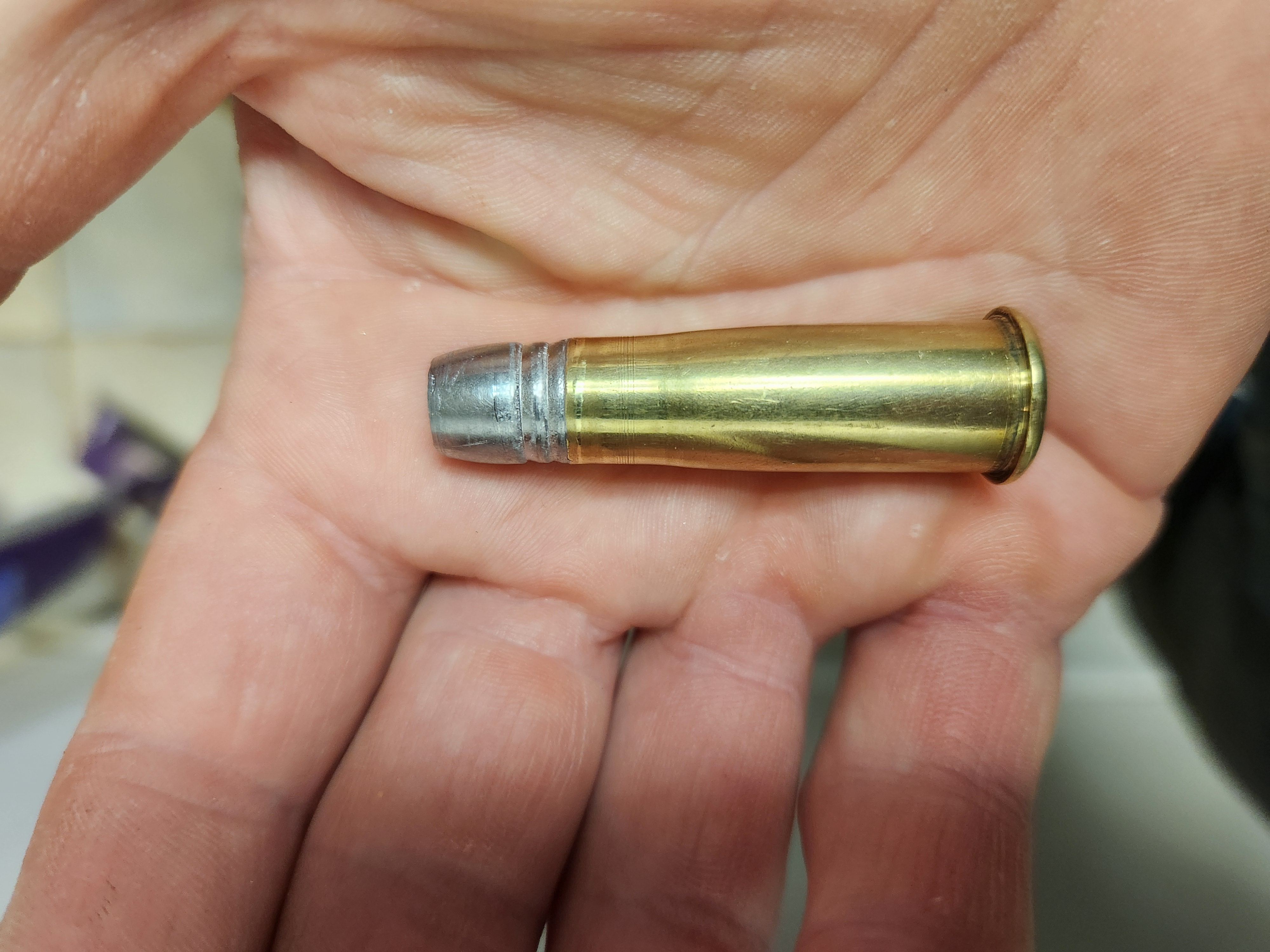

Update to the 41 Swiss:
I finally gathered up everything I need to make this work but found out some interesting things along the way. Although it's a .41, it uses .429 diameter bullets. It's difficult finding them in 325 grain so I ordered a bullet mould. I feel like I did pretty good once I realized you had to heat the mould up before casting them. I ended up using 10 grains of Unique but am pretty sure I can increase that quite a bit. I obviously had to go through expander balls and annealing to get to the point of even having usable brass, but hey it worked. I also ended up making a case trimming stem to get them to equal length. I also figured out that you can run a 500 S&W case through the 41 Swiss die 😆. It's the wrong rim diameter but it works if you don't mind knocking them out with the cleaning rod. Sorry if I'm all over the place but I'm just now getting over the kung-flu after 9 days.

Dude
Are you going to do some research and fab a custom cleaning rod? Maybe brass?

I could, probably will but just want to get it to the range. I've only fired it into my testfire drum so far.

That looks like the LEE 310 gr .429" mould.
I've got both the 2 and 6 cavity model of it

You're right, it is a 310. I forgot by how long it took Grafs to deliver the damn thing. Guess I got it mixed up with the weight of factory 41 Swiss.

I didn't realize you'd stated a weight.
I wasn't trying to correct you, I was just recognizing the bullet, and, in a roundabout way, asking for confirmation that it was the bullet I thought it was.

Eh, no big deal either way. I'm actually glad that you stated what bullet it is or else I'd have it ingrained in my head wrongly that it was a 325.
