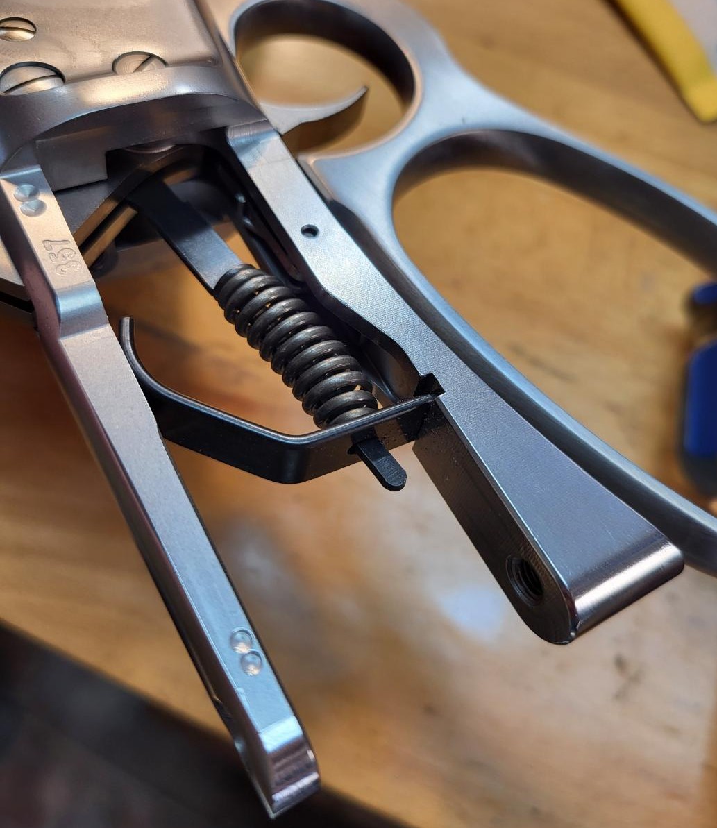

Interior and build-up pics for the interested parties:

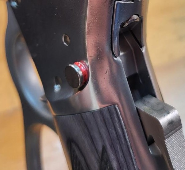

Our wise shoe salesman once said, "Nothing is safe from stupid". Lever actions are no exception:

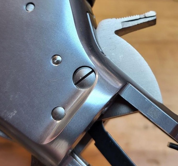

Fortunately, stupid can sometimes be removed:
The safety deletes are easy - pull set screw from rear, take out safety to the right being careful not to lose the little ball detent, replace with the filler, lightly re-install set screw, turn the "screw" slot until the ball kicks into a dimple drilled for the purpose, tighten set screw fully down. Done.

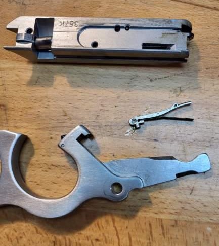

Needed to take the actions the rest of the way down. As you'll see, the interior finish is REALLY nice, but the leading edge of the loading gate on both rifles had an unacceptably sharp burr. One of them actually had some dried blood on it - probably from the poor sod who test fired the rifle at the factory. A quick bit of file work took care of that, but here's what I got to study:
Bolt, ejector, and the front of the lever. The ejector is of the same 2-piece construction with the separate leaf spring as the original JM's and Remington-builds. Still contemplating the Wild West Guns 1-piece "Bear Proof" unit as an upgrade, but as these are just plinkers, I may way leave well enough alone.

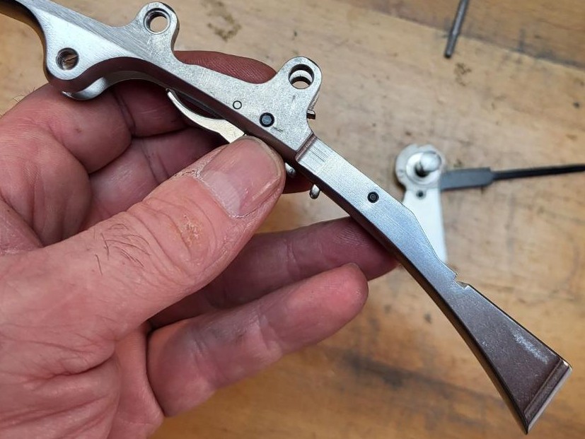

A good shot of the really smooth finish on the receiver tang. Right or wrong, I tend to judge gun manufacturers on how they finish the stuff you CAN'T see. Being Ruger, sure, these are investment cast, but they're still doing final polish, and it isn't the rough, sand-cast look we've come to know on the inside of a lot of their past products. If you look close at the upper left corner of the photo, you can see "357" - the castings for these receivers seem to be caliber-specific. Bolts and elevators are caliber-marked too.. The elevator, hammer spring tang, and its retainer are blackened, probably carbon steel. My guess is that the blackening is some kind of modern, rust-resistant melonite/tennifer/DLC, but without a deeper study, I wouldn't swear to it. In the meantime, I'd suggest all concerned treat it like something that might rust.

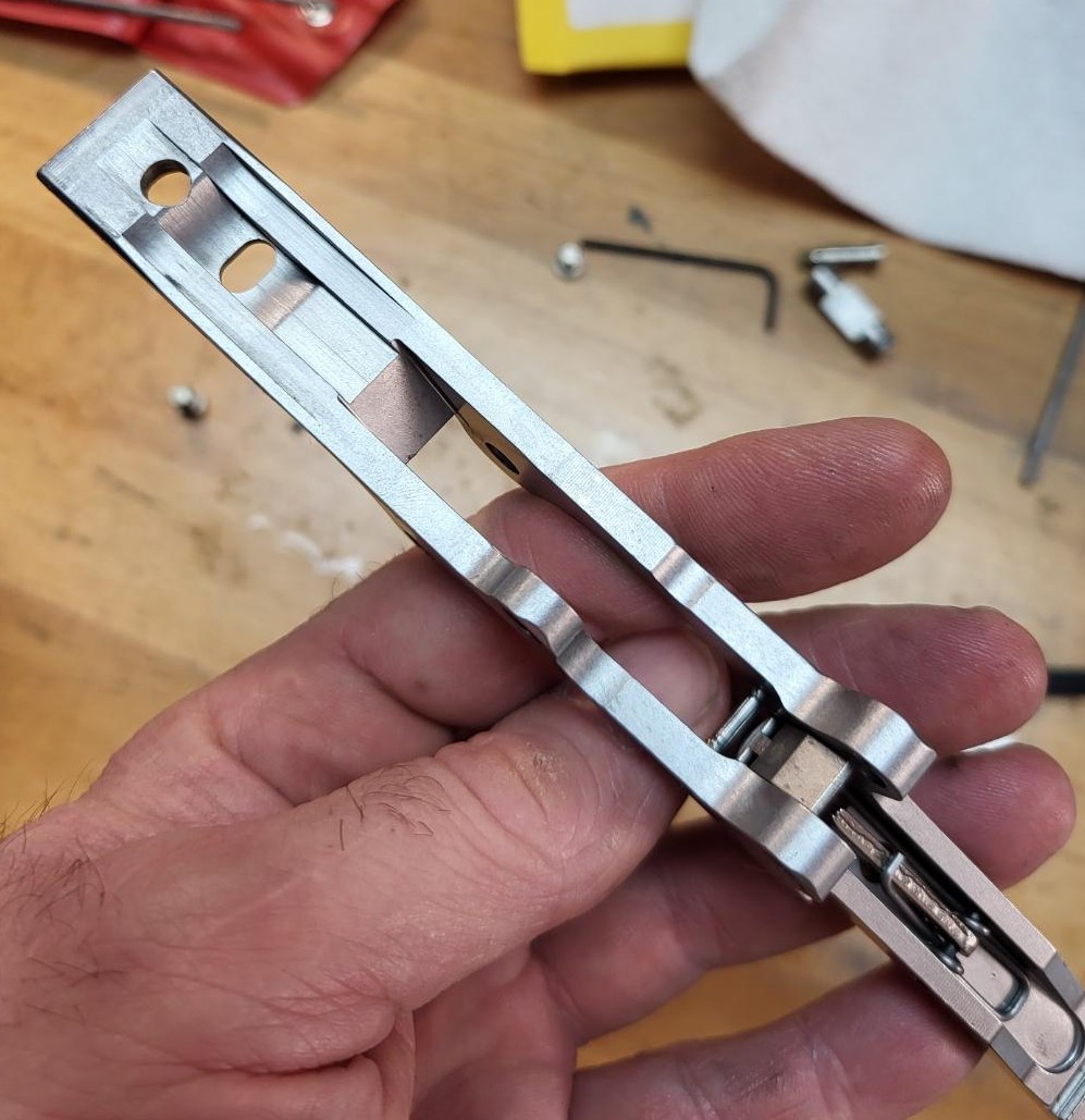

Side and top view of the interior of the lower tang / trigger housing - same nice attention to detail on final polish. As an aside, I got a trigger gauge on both of them, and they're both a little south of four pounds.

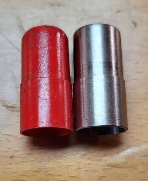

Soooo, really impressed with what I'm seeing. Stainless followers are on the way to replace the red plastic. Ranger Point is also sending their finger knob replacement lever screws - that's a part that frequently needs re-tightening, and the replacement allows rapid removal of the bolt for cleaning without a screwdriver. Should be a nice upgrade.

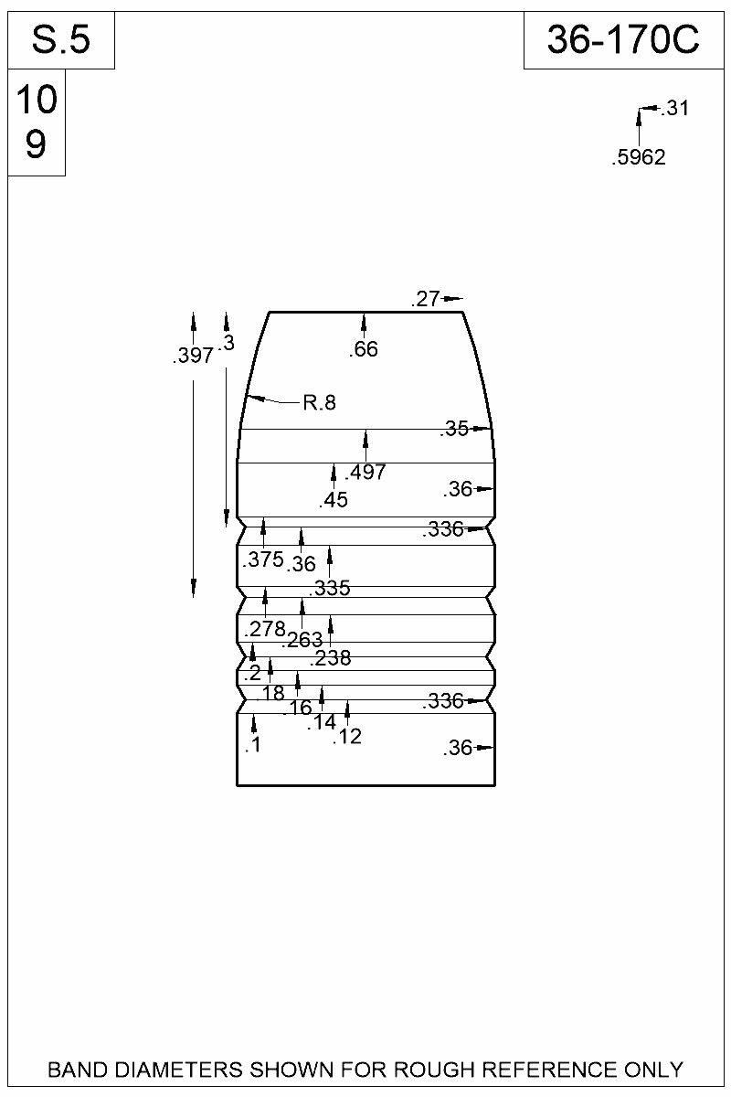

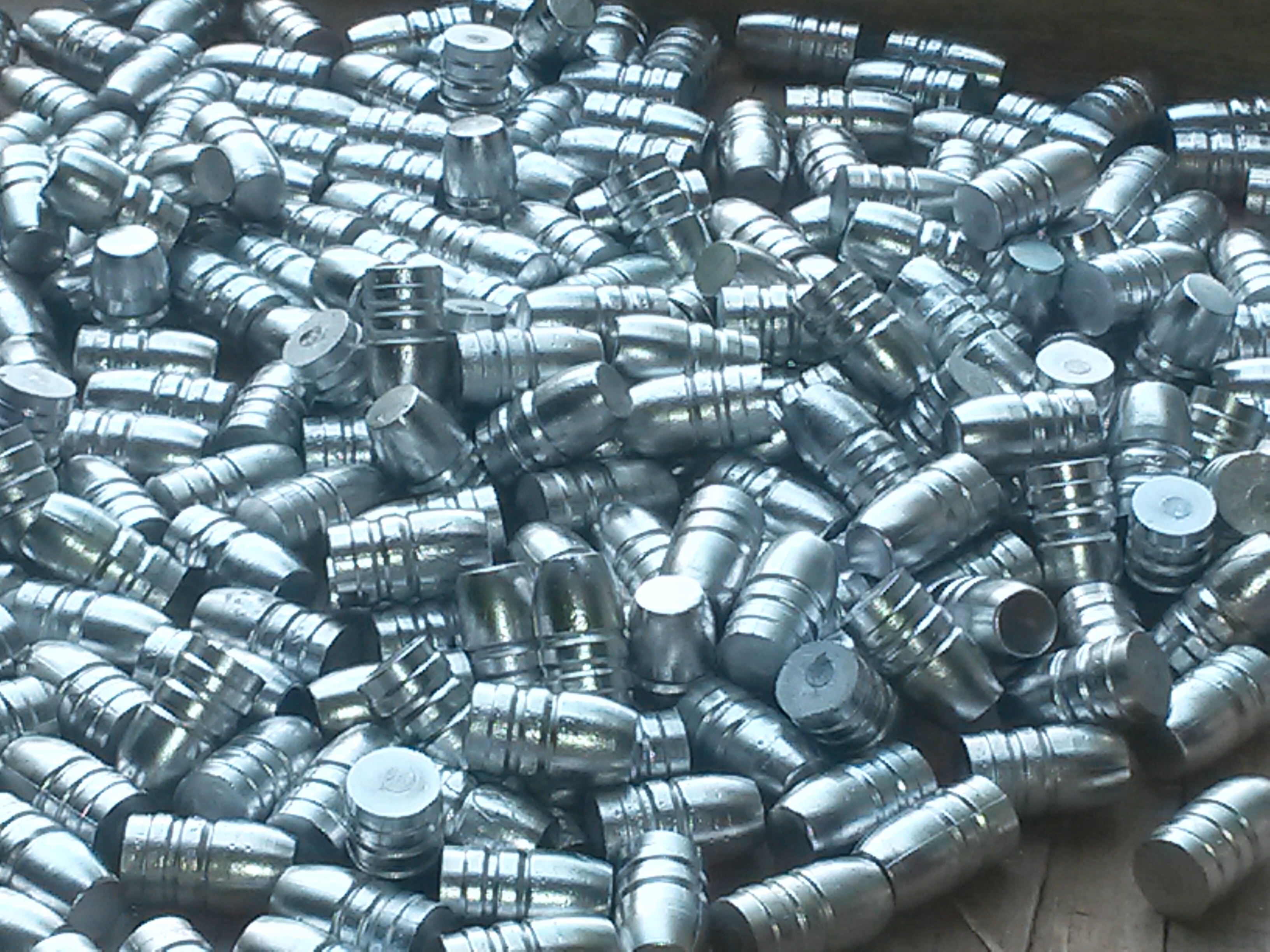

Let me know if you'd like to borrow my LBT 164 LFNGC mould.

Quite similar, but no GC. No bueno for my uses
And you are quite welcome. I know you seem to be a fan of Veral, so I figured I'd offer the only one of his moulds that I own
Re: Archimedes Said: "If Your Lever Is Too Short. . ."
Yeah. . .Veral did my first Martini Cadet mold, my own copy of his 45-230LFN, and several molds for some of Dad's older/weirder. He walked us through the early stages of learning to measure and fit for this stuff. I had hopes, but it sounds like the anticipated 4th edition of his book is not going to happen after his passing. A real shame, as the 3rd edition - while a treasure trove - is a product of the early P.C. / tractor-feed, dot-matrix printer / hand-drawn sketch age. . . for which I guess I'll treasure my copy even more now, because that pretty well describes me too.
But gas checks are something that I avoid for every cartridge that I can get away with not using them. I rate attaching gas checks as a whole lot more fun than trimming cases to length, and it's way ahead of having my teeth drilled, but it's still pretty low in my Pantheon of Jollies.
That said, Veral's molds ROCK, and ROCK HARD. Treasure that thing!

And the parts keep comin'!
Followers: Plastic out. Stainless in.

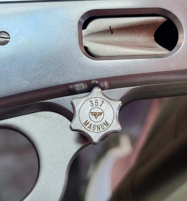

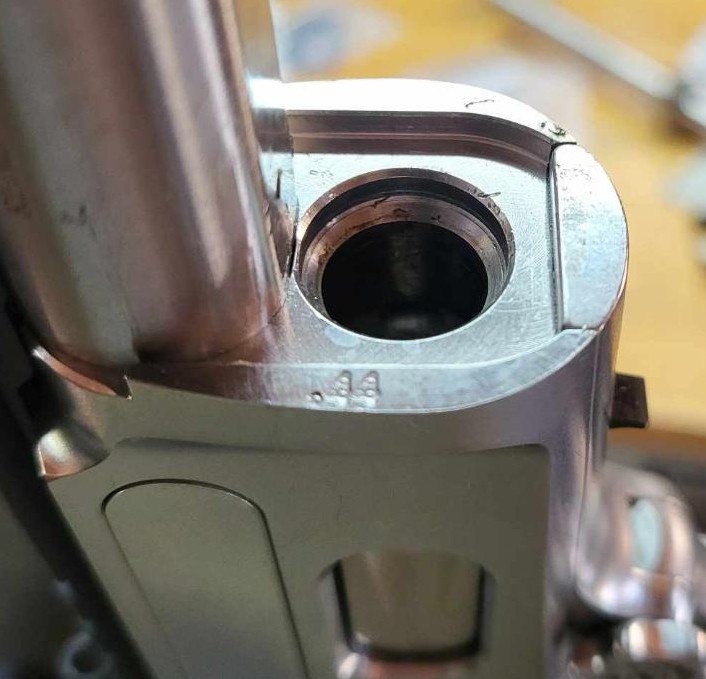

Got the Ranger Point quick takedown lever screws. These are nice: the need for a screwdriver for removing the bolt is gone, and they have an o-ring to serve as a lock-washer so you don't have to keep snugging it down.
Had to pull the forends to change the followers. Looks like Ruger caliber-marks the receivers up front too. Guess they want to make really sure the assemblers get it right.
Just out of curiosity, what did you pull the fore end? I usually just pull the magazine plug screw, pull the plug, take the spring out and easy peasy.
The front of the magazine on these goes onto a stud/socket which received the plug's retaining screw. This is attached to the barrel which comes into the magazine plug by about half it's diameter. You have to take the forend cap off and pivot the forend down so that the mag tube can lift off that stud/socket. Only then can you take the end plug out.
