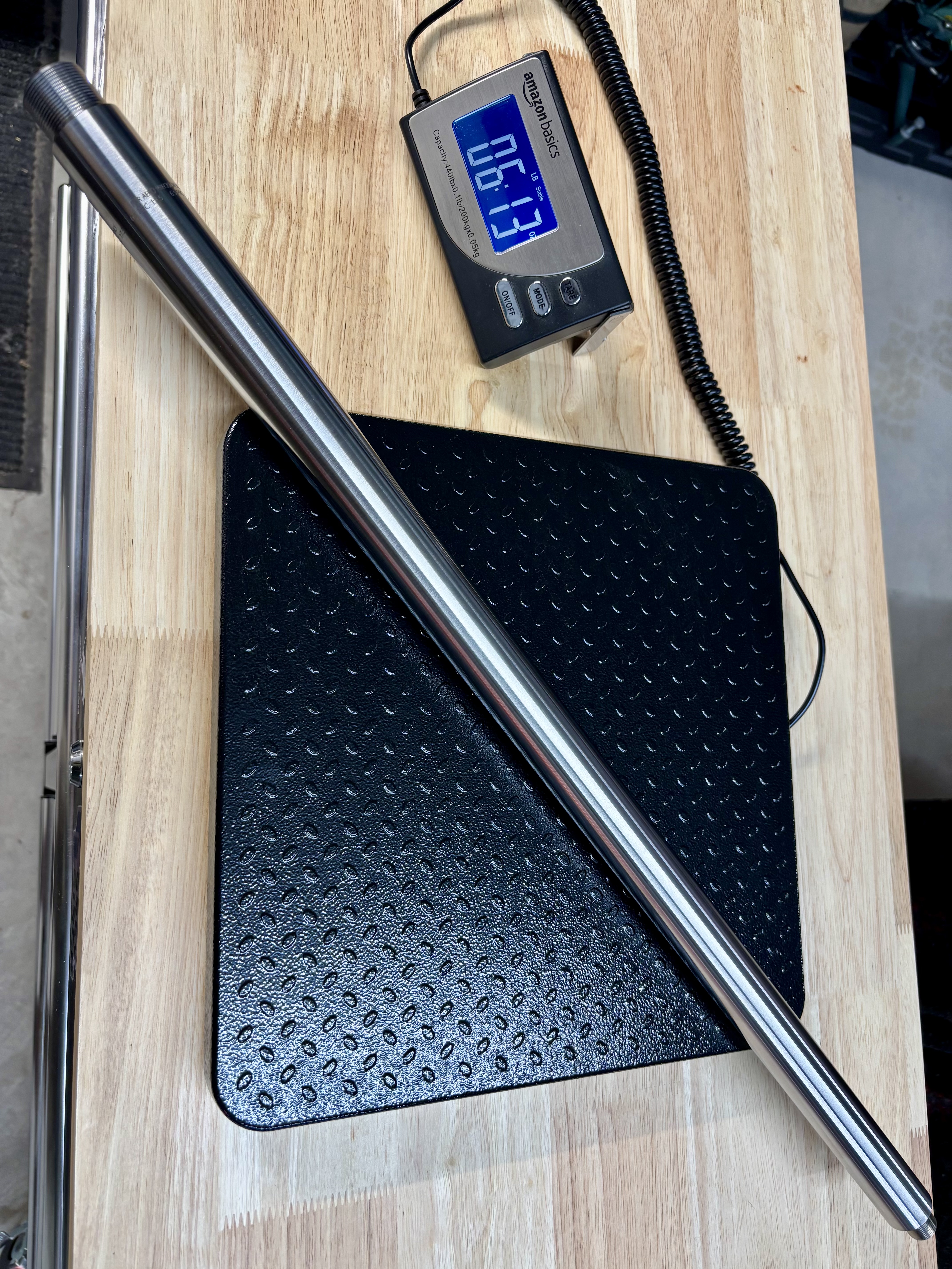

The barrel got here. But all I can do at this point is look through it and yell pew…
Slightly lighter than expected. A touch under 7 pounds.

Jay wrote: ↑Mon Jun 30, 2025 2:44 am The barrel got here. But all I can do at this point is look through it and yell pew…
Ha! I'm at the other end of the spectrum. I have rifles that weigh 6 lbs 13 oz including scopes.
